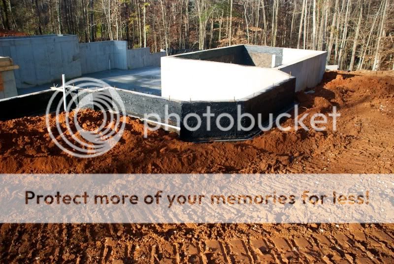

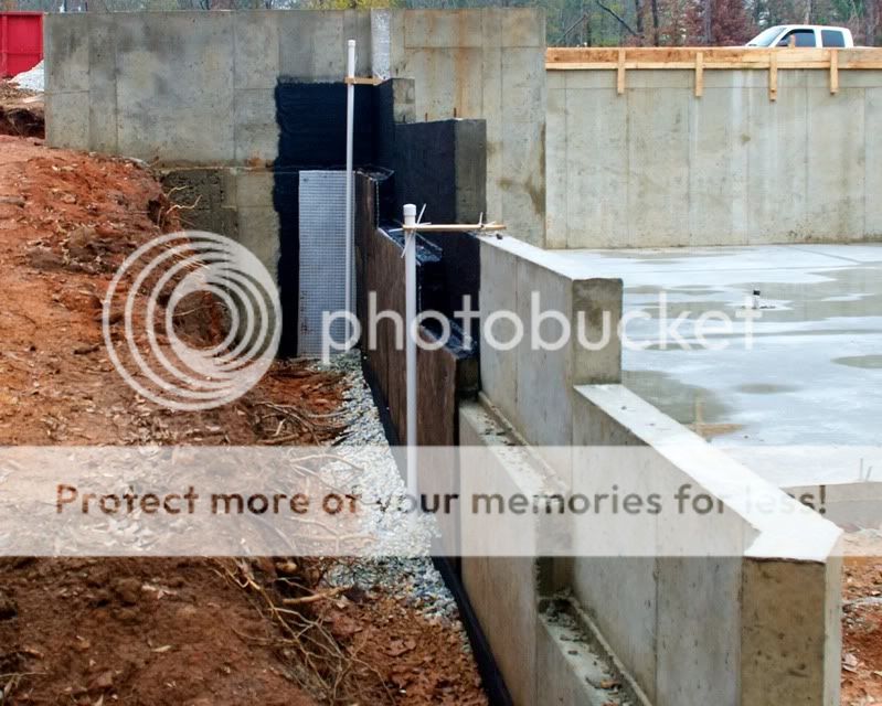

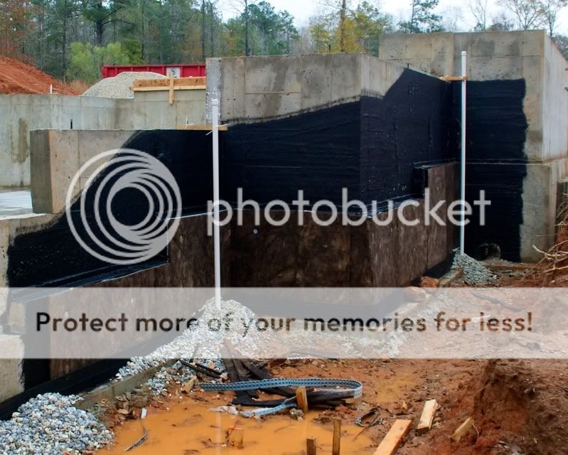

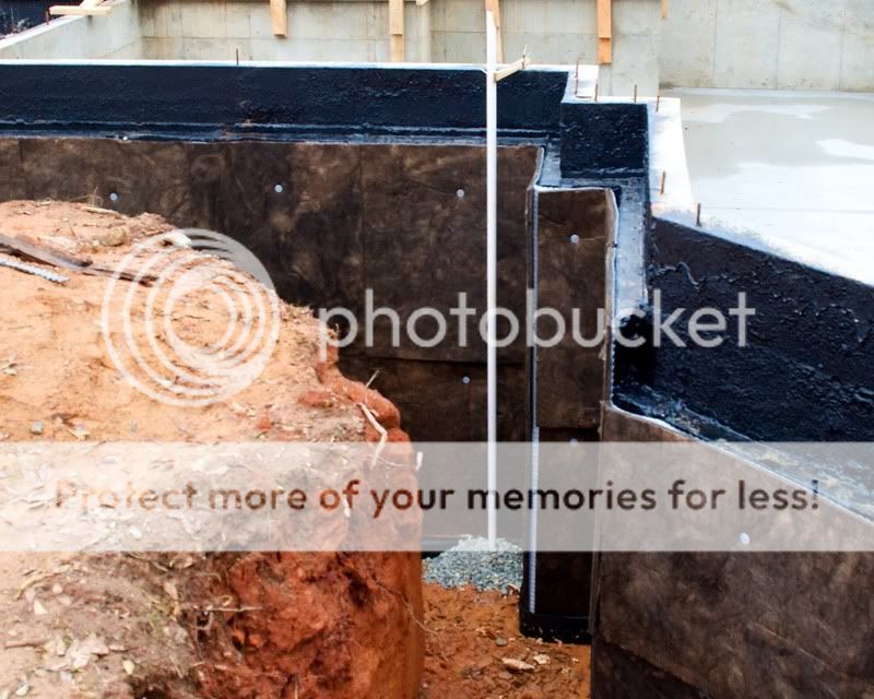

After quite a bit of deliberation. I decided to go ahead and put some pipes in so that I can get some copper sulfate down to my drain tile. I think TMcG is absolutely correct that it's not necessary, but it's one of those things that only takes a little time to do now, and would be near impossible to do later. I'd rather have it and not need it than need it and not have it.
All I did was get some 1-1/4" PVC and drill a bunch of holes in the bottom 6" on one side of the pipe. Then I stood the pipe up on the footing with the holes facing the drain tile, and covered the bottom with gravel. The idea is I can pour copper sulfate down there and it will drain out through the drain tile and kill any roots that have worked their way in. Again, I'm doubtful it will even work, but it sure can't hurt. Heck, I might even be able to use these to see if there is any water standing at my footer later. here's a couple of pics of the pipes installed, and yep, we've had quite a bit of rain so it's extremely muddy!
Front of the house near the woods
Back of the house near the woods
Back of the house near the garage
And here's the part that will likely make the whole waterproofing business actually work. Here's the gravel that will be used to backfill around the base of the walls. There were four big trucks that showed up while I was there, and I'm sure there were at least that many that had already been. This is a lot of gravel!!!

When are they delivering / installing the weeping tile pipe? I don't understand exactly how your vertical piping system will reach into the weeping system and kill roots. If the plan is to use some sort of "T" connector between the 1.5" PVC and the weeping pipe, you must make sure that the connection is also covered by the protective sock as to not allow soil infiltration that will clog your weepers. Anyhow, good luck over the next week with the backfilling!
Great list! Thanks for taking the time to do that! I've got several of those checked off already, but some some of the others I'll mention to our builder. I'm afraid we may be a little too far down the road for some of it, however.
The drain tile is actually already in place. It's the dark black band at the bottom of the walls. It's an engineered product that's not like a typical drain pipe you would see in most installations (here's a link). I'm just guessing, but I'd say it's about 6"x1.5". It's similar to the dimpled membrane, but with larger raised portions plus it has a geotextile filter fabric wrapped around it. They make a special connector that you can use to connect a pipe to this, but they're a bit tough to get. So I just set the pipe next to the drain tile, and I'll hope that any water I put down the pipe will take the path of least resistance through the drain tile. It's not a perfect solution, but it's the best I could come up with. Originally I thought they were planning to use an actual pipe, and I intended to do exactly what you mentioned above.

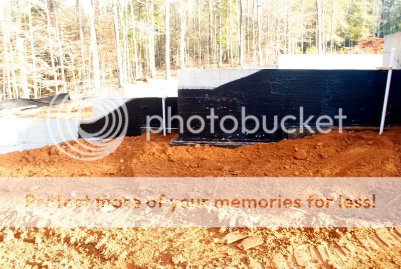

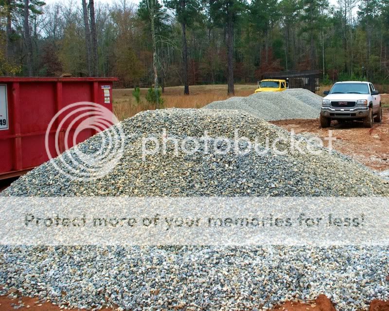

They were supposed to finish backfilling today, and framing should start tomorrow!!
I wasn't planning to post any pics of the backfilling because it's the same pictures except with more dirt, but I know how you guys are! So, here's the back corner near the garage.
And here's the front near the walkout end of the basement

That drainage board is pretty slick - and I can see where it would be a big advantage (from a time and materials standpoint) vs. a traditional weeping tile pipe. I have bookmarked this product as a potential "required material" should I ever build again.
The house looks great so far! I bet it only takes them about two weeks to get the house under roof. It's really amazing how fast those framing guys can fly!

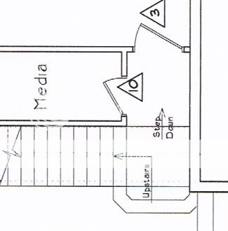

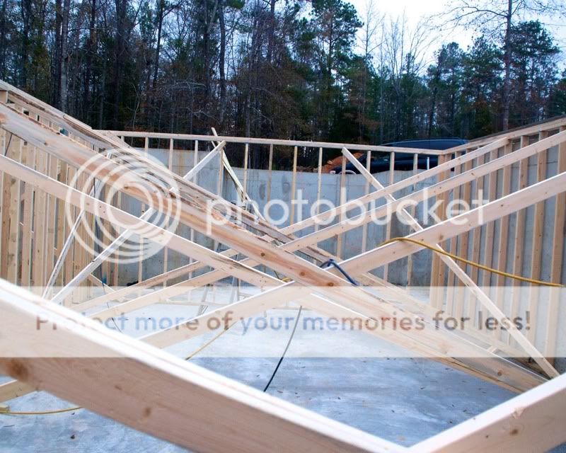

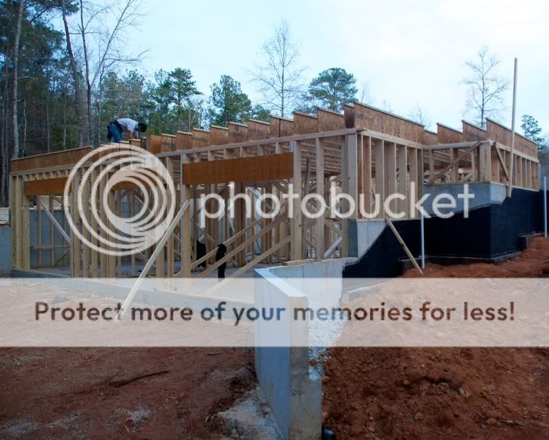

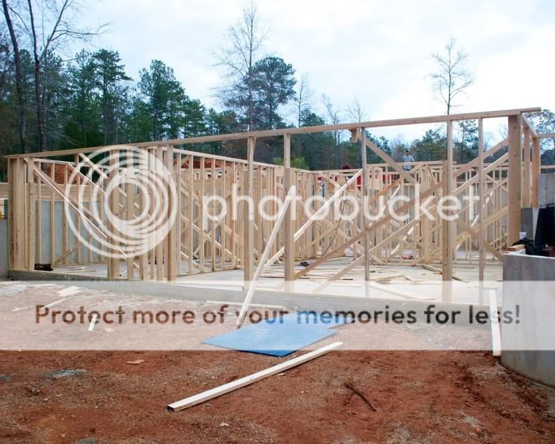

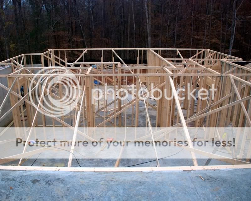

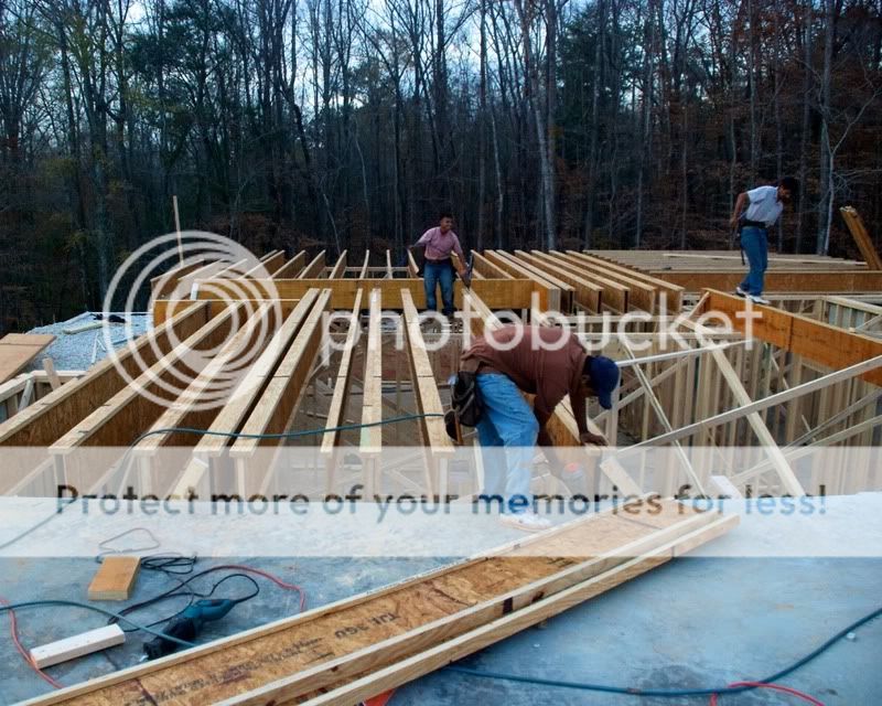

So here it is! The post that's not just about dirt!
Today is officially the second day of framing, but they got a late start yesterday, and spent most of their time laying out where the bottom plates would go. Today, however, they got most of the basement framed And it was only 3 guys! They said half their crew was at another job, so they were moving a little slow..... Wow!
Without further ado, here's a pic looking at the walkout portion of the basement
Here's another looking over the basement standing in the garage. It's a bit hard to get oriented in the picture, but the garage where I was standing to take this picture is up 9' or 10' from where all the framing is. The horizontal board at the bottom of the picture is actually the top plate for one of the walls in the basement (one of the outside walls of the theater, actually).
And here's a shot standing at the back of the theater looking at the screen wall..... It's not much to see yet, but I'm still proud
The first thing I noticed when I walked around the basement today, is I'm really glad we went with 9' walls. It makes the rooms feel larger than they are. So, as everyone on the site has pointed out, it's a good idea to have the ceilings as high as you can afford (within reason of course).
The next, is the stairs come out a little closer to the exterior concrete wall than I would have hoped. The hallway between the bottom of the stairs and the entrance to the theater is going to feel a little tight. The gears are already turning, and I'm thinking about taking some space out of the media closet to open up that area a bit. I'll have to play around a bit with my Sketchup model and see how it looks.

Well, we've run into our first frustrating snags in the build. Before we get to that, I'll give you a few progress photos, though
Here's a picture from the garage. Directly in front of where I'm standing is the theater room.
Here's one looking at the walkout portion of the basement. Really the only addition is the engineered flooring system.
Now for the bad news. First the framers decided to build the landing at the bottom of our steps a little different than the plans called for. Our plans showed two steps and then the landing going from the basement floor up. This put one step down from the landing going into the theater. Here's a shot of the layout to make it a little more clear.
They decided to move the landing down one step to eliminate the step down going into the theater. The downside to that is it makes the landing pretty short at about 38".
Here's a photo of the offending opening. What you see is the corner post of the media closet, but that gives you a good idea about the space the landing will have. So when you come down the stairs you'll be staring at the wall on the right. Thoughts on which alternative you would prefer, anyone? I've got another thread going as well, but I still haven't made up my mind.
The next thing has my blood pressure through the roof. Apparently the engineered flooring designer decided that we needed a 24" beam going through the theater room to support a point load on main floor. The other beams that you see in the pictures are 16". This means that there would be 8" of beam hanging down into my 9' ceilings! Nobody bothered to ask if I was OK with that, either. After I mentioned it to our builder, they went back to the flooring designer and they've decided they can get by with an 18" beam there, so I only lose 2" of head room. The only other alternative would be a steel beam, but we'd have to have another company design it.
Any thoughts?

My plans call for notches in the garage wall. The trusses (presumably) will sit on the garage slab at the top of the concrete basement walls instead of dropping into the room. The depth of the engineered trusses don't matter at that point (mine are 20") because it just raises the first floor instead of lowering the basement ceiling. I still loose 4" from the basement floor slab, though.
I think if the sub-contractors aren't following the plan, your builder needs to take responsibility and insure that they do (including redoing things if necessary). Easier and cheaper for everyone if you accept their mistakes, but I don't think you have to.

Correct the stair framing errors, Mistakes happen, it is your job to demand they be fixed according to plans, I suspect the builder has a sub doing the framing, in that case the correction isn't going to cost him a nickle.
If you think it is narrow now imagine what it will look like if you finish the wall facing the concrete.

I actually considered raising the first floor, but because no one bothered to let me know ahead of time, it's really too late. It would require tearing down all the beams and adding 8" to all the walls in the basement. With the 18" beam alternative, once I add clips and channel on the ceiling I'll only be losing 1/2" rather 2".
With regard to the steps, on one hand I'm glad the framers were paying attention to what they were doing and trying to make a change that would benefit us. On the other, I wish they'd asked ahead of time. Because as you said, right now we are strongly considering having them rework it to match the plans.

I don't know anything about construction, but I wonder if they could add more trusses (tighter spacing) to avoid having to run a beam?
My trusses are supposed to span 22' 6" without a beam... maybe I should triple check that.
