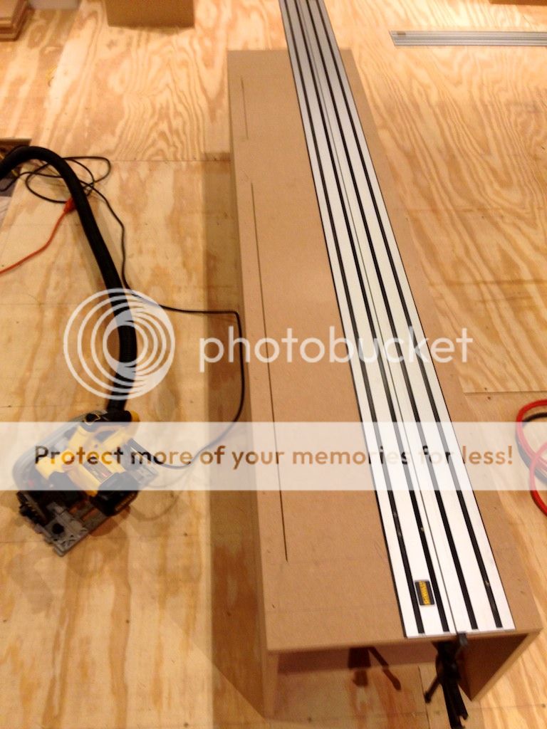

Here's a little something for mfusik. EDIT: Hmmm… Now I have to get the link to work again EDIT: Got it
I suppose there are two things of note about the video. First is I'm using the foam to cut on. The video explains it all there The next is notice my left hand. After some trial and error, I realized the MDF was slick enough that the track wanted to slide. So I started using my free hand to put a finger or two on the track to keep that from happening.
This cut was at a bit of an awkward angle, so not my best performance. I'll blame it on performance anxiety
http://youtu.be/xvUzjfx7Mmo
You actually wear the respirator huh? lol. I always find it harder to breathe with it on. Thus I use the cheap old pain mask things, or just take my chances.
You can fabricate an air cleaner system/dust collection system with a few box fans and a hepa filter/microparticle filtersheet for a furnace and some bungee cords or duct tape that will keep the air clean and remove the MDF dust.
Something like: (I didn't really search but microparticle filters are easy to find)
http://www.walmart.com/ip/3M-Filtret...ilter/10719986
24"x24" seems to fit right on for me.
Or you can do like I do and blow the fan into another room or out the window... lol.
That saw looks really sweat! I really need to buy one. I do so much projects I need it. I really do. Plus if LilMike and I do this "neighborhood wrecker" it probably will pay for itself just on that one project. I'm strong with the table saw, but less with the circular saw. A track saw makes my circular saw obsolete. Miter saw + Track Saw + Table saw. That's the combo!
I wish everything didn't cost money. I think I'll try an talk my dad into buying one. Then I can borrow it... lulz.
BTW- I am using that foam board trick. That's just too slick. All my saw horses have slices through them, I usually just use the saw horses and accept the fact the top gets sliced. Every once in a while I'll brad nail down a fresh layer of pine or something and start fresh. (or just build more horses). I used to buy those metal horse brackets to quick assemble saw horses with just 2x4 but those are pure crap. PURE CRAP. They never work good for me. I get ten time better results just guessing the angle and using the table saw to cut the angle into the wood and just screw them together. Takes like 2 minutes. I always wanted a nice light weight set or pro grade horses but I always knew I'd cut them or trash them, but perhaps your foam board trick is the ticket I need.
You ever see those stack able horses Cowger made in his thread? Those look fun too.
MDF is slick enough to make the track slide, can you clamp it down ? Either way that's way easier than ripping a sheet through the table saw, or hacking it with a hand saw. Even with the laser guide it's never as good. I've got my eyes on craigs list for a panel saw, but perhaps I'l consider the track saw instead.
There is surprisingly little dust. I have the saw connected to my vacuum, and it collects probably 95% (or more) of the dust. If you notice in the video there is a little puff of dust that escapes when the saw cuts through the end of the board. That's really about it.
But yeah, I wear the respirator. Over the course of 20 years of working on various dusty things my allergies are gradually becoming more sensitive to wood dust. I think Norm Abrams said if you need to wear a mask even if you don't have allergies, because if you don't wear the mask, you WILL have allergies.
lol. I guess I am lucky. I've cut plenty of MDF in closed spaces and gotten soar throat countless times. I try to be mindful, like this last project I went out to the drive way and open air. But in the winter it's tough, I live in NE. It's cold and snows like 3 feet sometimes.

But that all seems WAY HARDER than using a hole saw with the block clamped and using a drill press. If you don't have a drill press you can probably just clamp and use a drill too.
I'm a hole saw whore... so I'd do that for a few inch holes. You can buy a hole saw for a drill cheaper than a jig, and it would be easier to cut a perfect small hole using that versus a router and jig IMO.
otherwise use a zip tool.
I have this: http://www.homedepot.com/p/Ryobi-18-...P530/100007658
Works super awesome provided the material being cut is soft, like that foam stuff instread of wood. Or even a softer pine. I used this to cut all the holes in my light cans in my basement out of the drop ceiling tiles and it was easy and worked great!
But I also tried using it on 3/4" MDF and not so good. It eats blades fast, so a router or a drill is better with MDF.

There are Track Saw clamps available. They work great when you need perfect. Occasionally, I just reach
for spring clamp, and catch an edge
I sold my radial arm saw after the first week of owning the Track Saw. It sure sees a lot of use. Fantastic tool!
Today I used it to cut drywall. Needed three 4' strips of 5/8" drywall at 1 3/8" wide. I cut on some plywood, and
got perfect cuts. Lots of dust, not something I'd try inside.
I was actually thinking of using one of those templates for making a rosette. It occurred to me that I've got a few bits that might make a neat profile if I used the plunge base on my router and routed a circle just over the diameter of the light bezel. Thanks for the info on the circle cutters! Just what I needed.
And yes, they do make clamps for the tracks. I used one when cutting the holes in the column fronts. Here's a pic from a few pages back. You can see the clamp at the bottom. Spring clamps are a good idea as well since they don't take up as much space below the material.
The only problem with the clamps is you need room under the piece you're cutting for the end of it. So then you have to work off a set or horses. Working alone with heavier sheet material, it's just easier to work off the floor. Fortunately, God saw fit to bless me with an extra hand that's just perfect for this sort of thing
I wipe the back of the track and the MDF sheet with a "damp" cloth... no slip, sliding away Gus...

Here's a link to the lights. I got them from Home Depot. So far they are working well. They are pretty bright and the color temp is a close match to my perimeter soffit lights. My only complaint is they buzz a little on the dimmer, and like all LEDs they dim to around 10% and then cut off. Fortunately, the plan has always been to use these for lighting during entering the room, and I'll dim them to off first. So the buzzing won't be an issue, and dimming all the jump to off won't be as noticeable.
The great thing about these lights is they are about as shallow as you are going to find for this much light output. They can also be installed just about anywhere. My inspector had zero concerns with them being mounted in a completely enclosed coffer with the junction box being mounted directly to the drywall. It would be hard to find a lower profile lighting solution.
