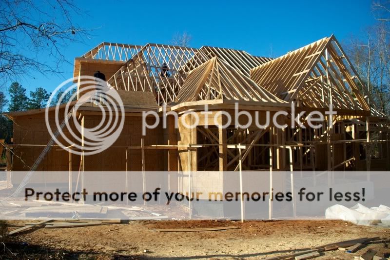

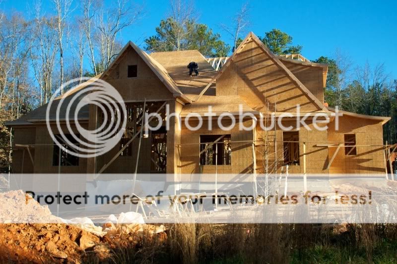

Here's the latest progress!
They should have most of the decking on my the end of the day, and possibly the felt on as well.

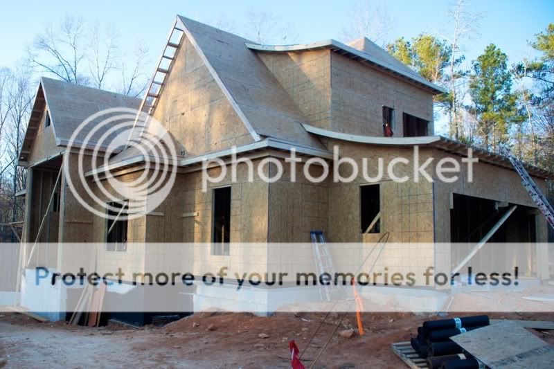

Here's the front, we had to make a bit of change to the gable on the right. The plans didn't quite agree with regard to how the roof line passed through that room. So we had to make a decision about the shape of the gable. We opted to go with a "triangle" as opposed to having the short vertical part to the wall that you see in the picture.
And the back,

Looking great JPA! Nice touch on that roof line.

Yes, good choice going with the "triangle". Is that a curved roof line on the side room? Nice touch.

Make sure those valleys are well flashed, otherwise I see a leaky roof in your future.

Thanks guys! Yesterday was the first time I got that funny feeling where I wondered if anyone else would think my house looks nice or if it would cause a WTF reaction Of course, I guess we're going to be living in it, so it shouldn't matter, right?
Tony, yep that's a curved roofline on the right. I wondered how they would do that. The answer, cut it out of a long 2x16..... I guess I should have seen that one coming.
BIG, this guy does really good work, and one of the things I noticed on some of his other houses is the way they flashed around windows and such. Along with flashing the valleys, they're also going to add a ice/water membrane (can't remember what it's called) to the area where the two roofs nearly meet between the porch roof and the gable end to prevent water that gets under the the shingles there from causing a leak. I sure hope they're on their game the day they do this roof, though. I sure don't intend to be up there fixing it if something leaks! Maybe 10 years ago. Now I think I'd be afraid to get off the ladder

WTF is all of that roof line shenanigans going on, man do you even have a plan for the roof line? Looks like it was just all thrown together!
Well actually it looks really nice. Well done on the "triangle" I think you made the right choice.

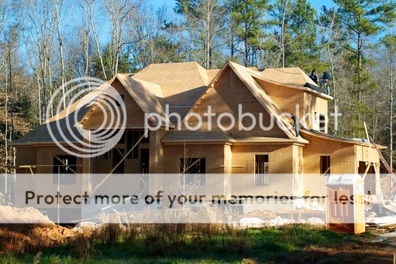

So here's the end of day update. Here's another shot of the front with most of the decking on. They've already completed the tails on that gable. As a side note, I'm pretty sure the guy that put the decking on the front of the porch gable used several of his 9 lives putting up one of those sheets of OSB. It was sort of like watching a three stooges episode, but with a man and a partial sheet of OSB. It would have been comical if the guy hadn't been 25' in the air. I finally had to quit watching because I knew I was about to see a man die

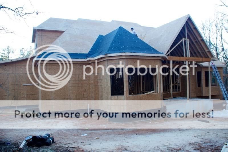

And a shot of the back. You can see they've just started putting down the felt. They tell me it will take them another couple days of work inside the house to finish up the framing. So we're pretty close to beginning the HVAC and plumbing.
I'm really amazed at just how much different the house looks once it's constructed compared to the drawings.

I can't believe how much they got done today!!! Those guys move so fast.
I see in your earlier post that they were going to do a Water & Ice Shield adhesive membrane on the lowest perimeter of the roof and in the valleys, but I see they are attaching felt paper in the bottom picture. Is that correct? I know the Water & Ice Shield needs to adhere directly to the OSB roof decking.

I'm not sure if they intended to use the Water & Ice Shield in all of the valleys. They just decided to use it where the roof from the gable on the front meets the roof from the front porch. The concern was that during heavy rains, we could possibly get some water back under the shingles and flashing there. When I stopped by today, they only had three or four rolls of the stuff, so I can't imagine that they plan to put it everywhere.

FWIW, the W&I Shield is typically used in all of the weakest spots of the roof, where water is most likely to enter....which means the first 4 feet (width of the roll) of any roof line / edge plus any valley / inside corner where aluminum flashing would normally go. Looking at the slopes on your roof, just imagine the rushing water of a heavy 'bama rain running down and that water momentum carrying up the other side of another room slope - even if it is just 6 to 12 inches of momentum. And putting it around the edge of the roof is just good practice as this is the most vulnerable to driving wind, rain and gutter back ups.
My father just replaced his roof last summer and this is what they did for his home for these reasons. They didn't use it everywhere, just the susceptible spots of any roof edge and any valley /inside corner under the flashing.

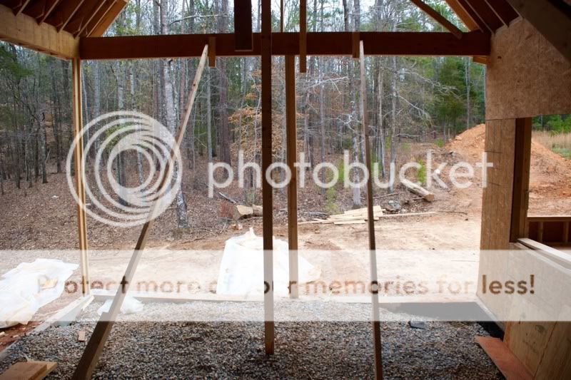

Now that they are working inside it's going to be harder to come up with interesting pictures, but I'll do what I can. Here's a shot from the living room looking out over the back porch. The window on the right is in the dining room. You can probably guess by now that we wanted lots of windows!

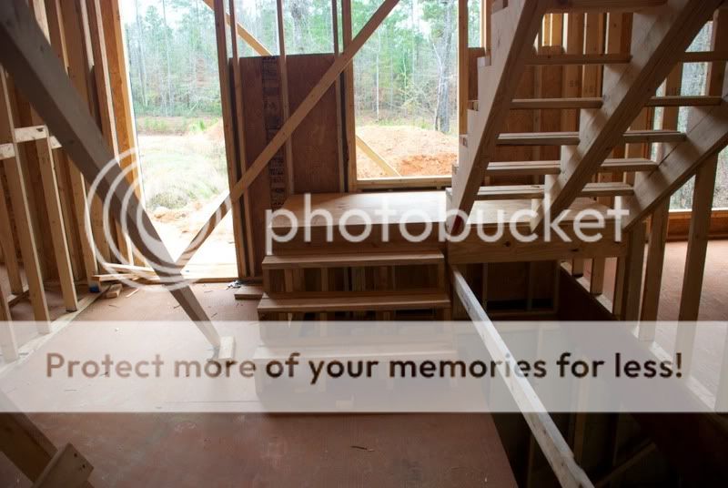

And here's one of the stairs in the foyer. the opening on the left is the front door. The landing going up to the second floor has a window on it. The opening on the right goes down to the basement.
