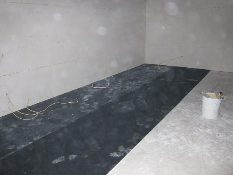

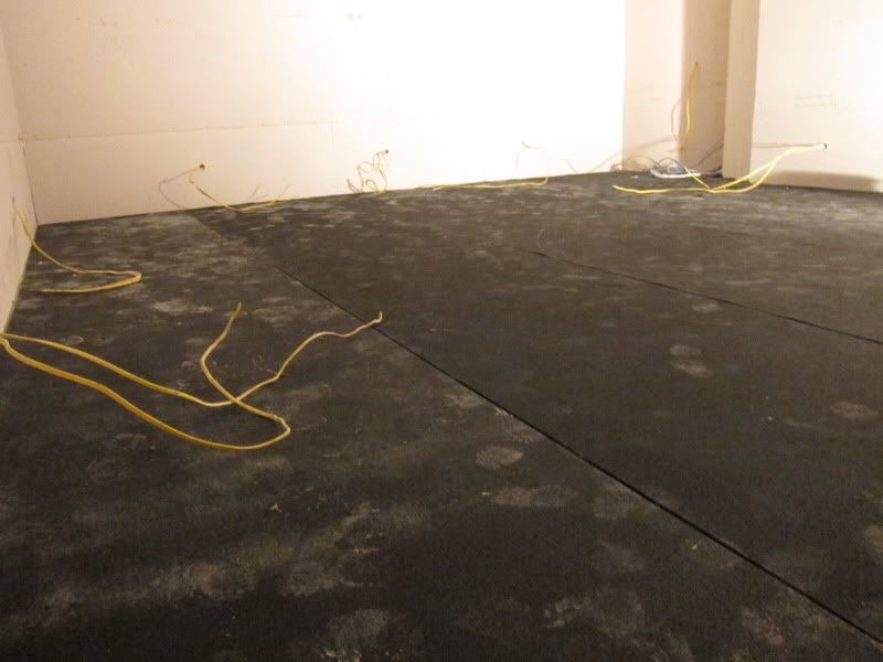

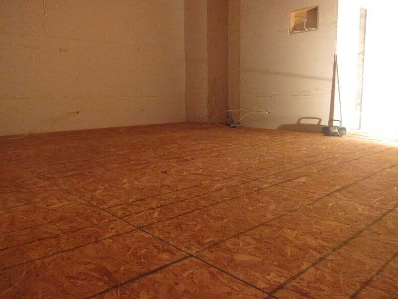

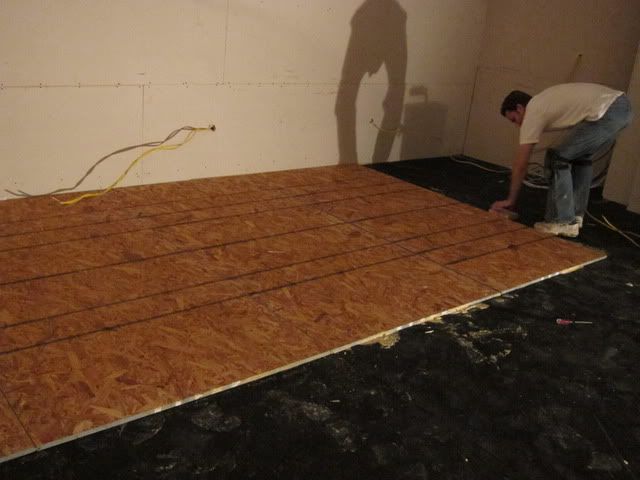

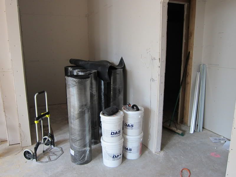

A little more progress this weekend. I laid down the acoustic rubber mats and 3/4" tongue and groove OSB for the subfloor. Both with troweled adhesive.
Here are the supplies:
Starting to lay down mats:
Mats down:
OSB coming in one board at a time:
OSB installation:
Tools for ensuring proper adhesion of flooring:
All done:
Drywall crew is scheduled to seal corners of room and in between floor and wall tomorrow, as well as standard taping and bedding. I am hoping that we are on schedule for construction of the stage and riser later this week!

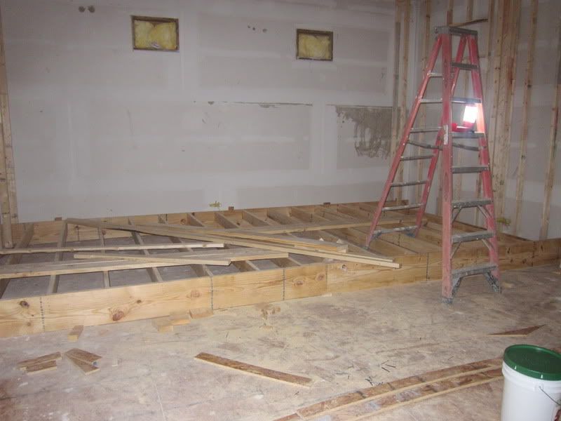

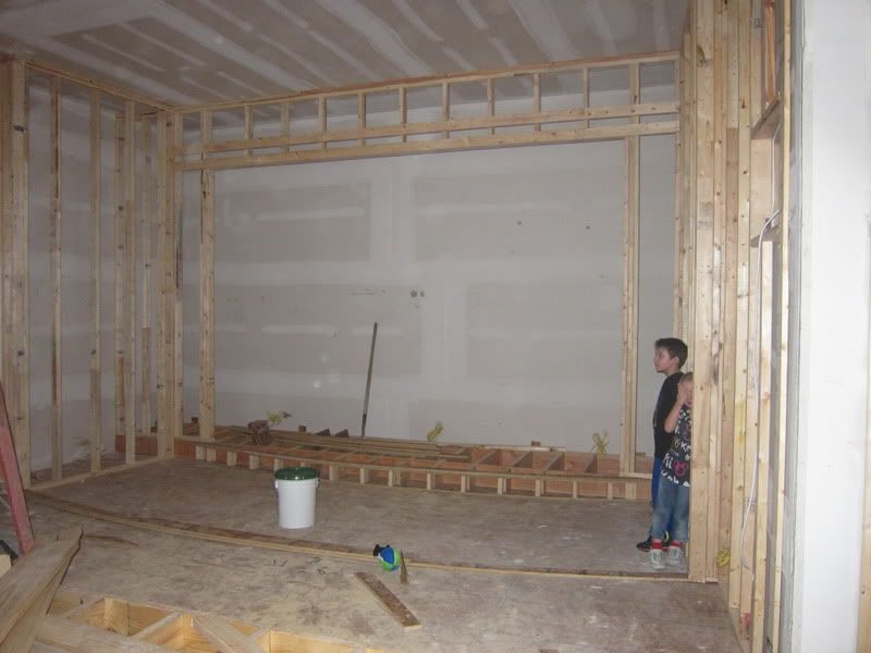

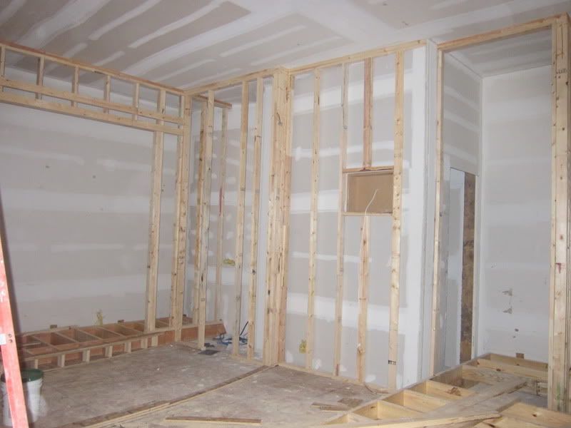

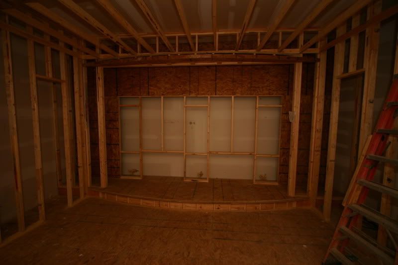

Framing on the interior room started today. I cannot describe how awesome it is to see a room that you've only seen in 2d for almost a year finally come to life in 3D! Very exciting.
Stage:
Riser:
Side wall:
Entrance:
Front wall:
Tomorrow we are set to fill the stage with sand and riser with insulation. After that, they will be framing the ceiling. More pictures to come. . . .

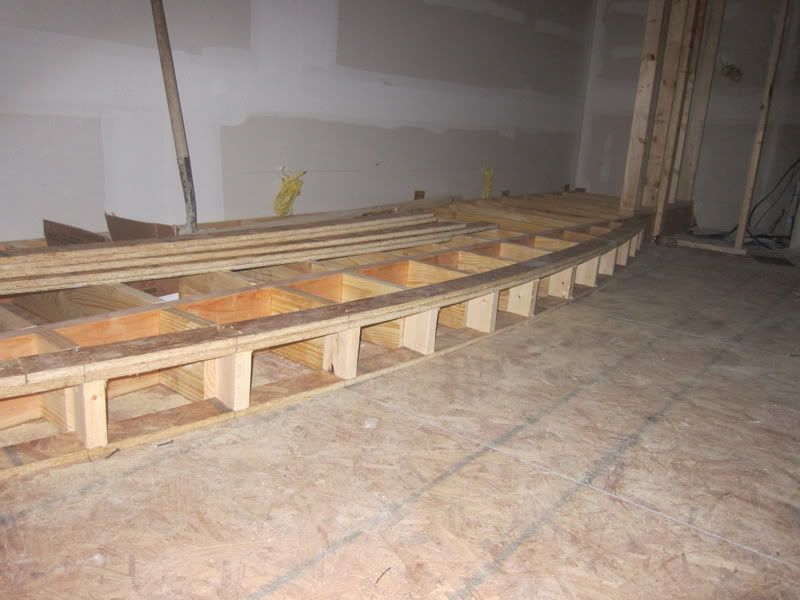

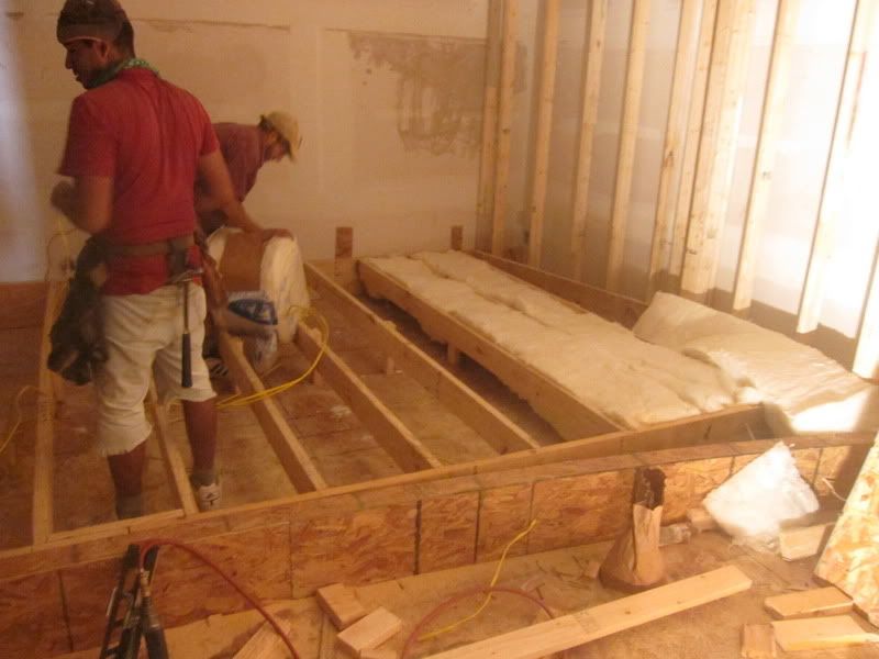

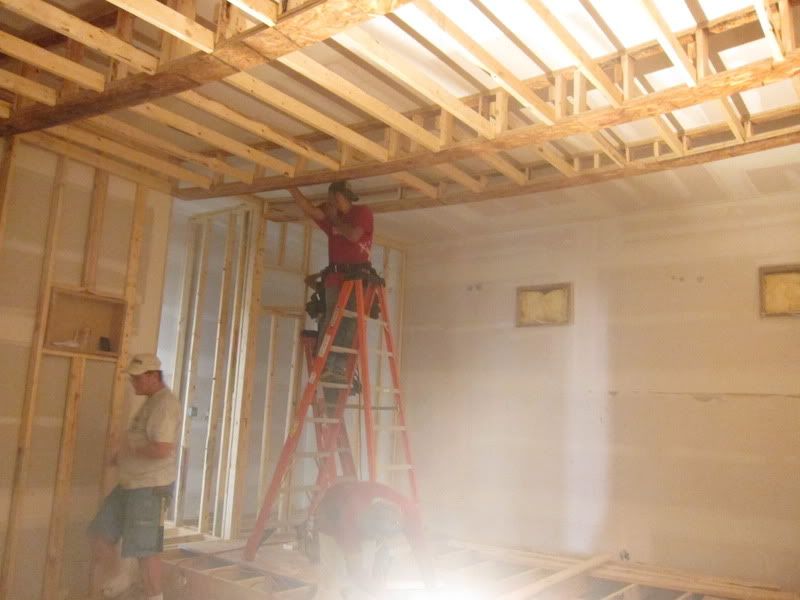

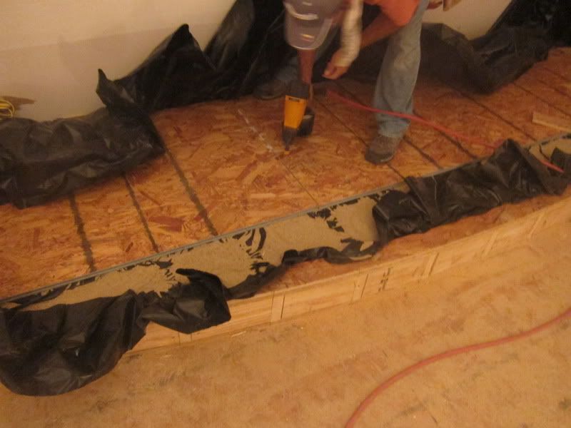

More progress today. Staggered ceiling framed, stage filled with sand and decked with three layers of OSB. We also ran electrical through the riser and filled it with insulation.
Ceiling in progress:
Stage in progress:
Riser in progress:
View from back corner:
Framers will be back on Monday to finish. Then, we pull wire and HVAC through the isolation shell into the HT.

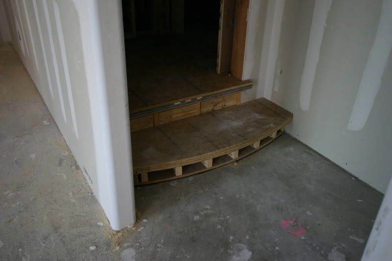

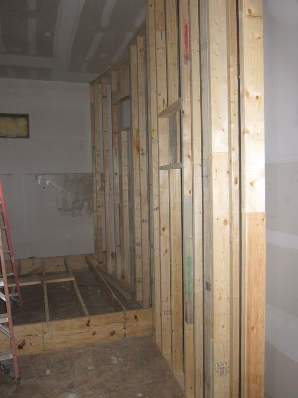

Done with 2 & 1/2 days of framing the interior room. It was a blast to see the HT start to come to life. I took some photos with a wide-angle lens of the progress.
Steps going into theater:
View from back wall:
Riser step:
Baffle Wall:
Hope to get all electrical and AV wiring set this week. Then, insulation and drywall next week.
