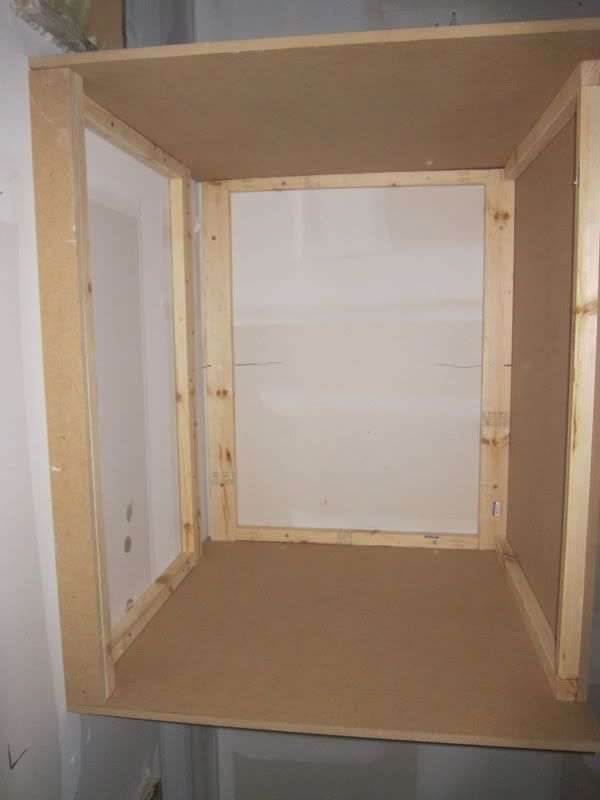

This week we got the recessed can lights installed and I built a hush box for the projector. I installed all of it except for the bottom. I still need to line it with insulation, cut the window, and install the hinging bottom. Here are photos:
View from underneath

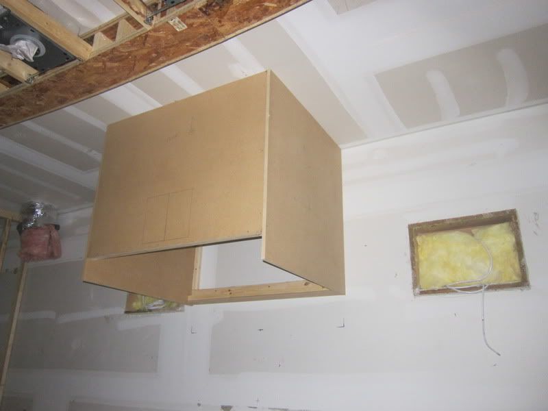

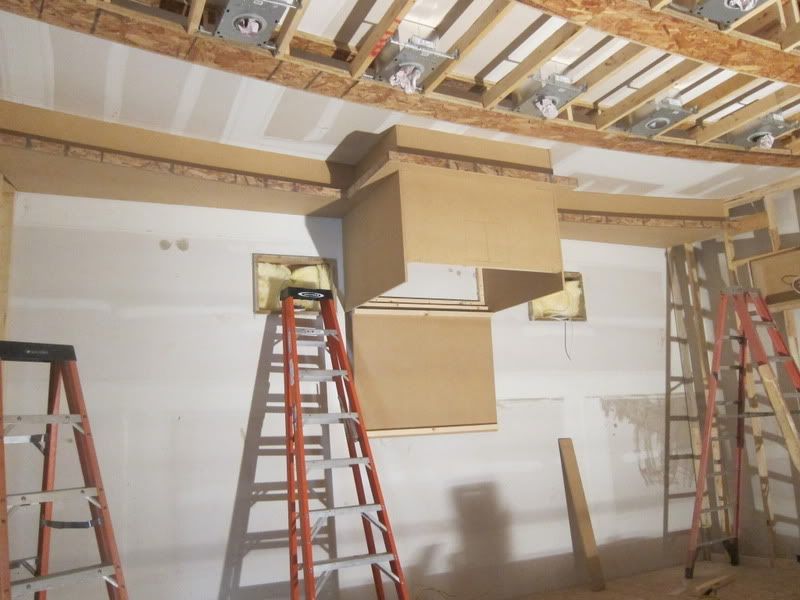

Built the rear HVAC return soffit, attached bottom of PJ cabinet, and installed LED tray today.

Interesting position for the rears on the back wall....very close to the box

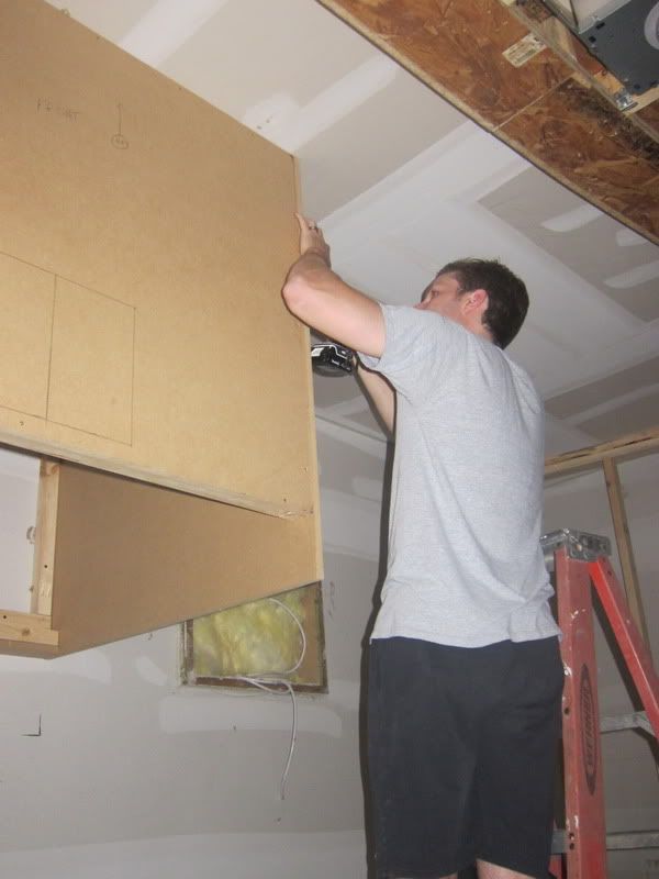

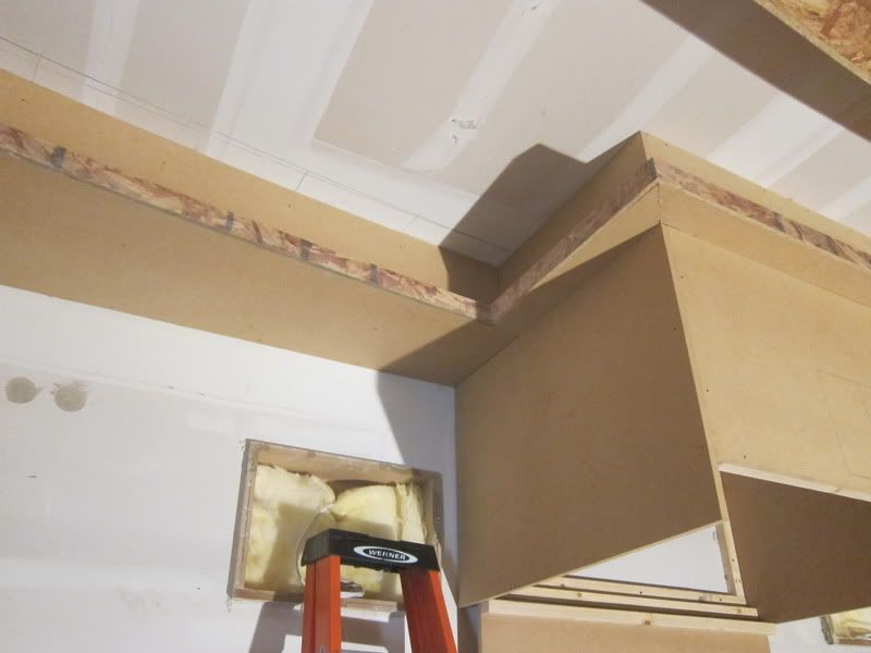

Yeah. . . Not a happy moment when I discovered that they were not centered properly in the room. So do I rip out two layers of DD & GG? Or just live with it?
They will be covered with fabric, so they won't be an eye sore. But I am unsure of how much it may impact the sound. Thoughts?

Is the projector hush box in the direct line between speaker and any seating position? If so, I would move them. Rather do it now, than wait and do it later when you have more work to fix. If not in the direct line, you'll still have some reflective waves that weren't considered during design. Send the question to Dennis in this case.
What did the original drawing specify?
Well, Dennis has been adding as we go along. The problem came when the framers had to find the center of the room before we had the isolation shell or interior walls built. The missed by about 10 inches. Dangit.

The room is simply too nice to compromise. I don't think it is that difficult to cut out part of that back wall drywall, move your speaker over, and patch up the hole with new double drywall/GG.
I would go ahead and bite the bullet if it were my room.

Interesting, I'd have thought the speaker should be below the height of the hush box....even if it is a foot or so from it....highlights my complete lack of knowledge about it.

Bite the bullet and reposition the speakers, Did you really need that big of a hush box? What is going in there?

The projector/lens is 36" deep, 21" wide, and 15" high. Lens must be placed at a height equal to top of screen. Additional width is required for air intake/exhaust plumbing.

The surround array speakers are monopolar compression drivers. They must be mounted high and aimed downward into the listening area to reduce the distance delta seat to seat in the listening area to avoid large SPL differences between seats.
