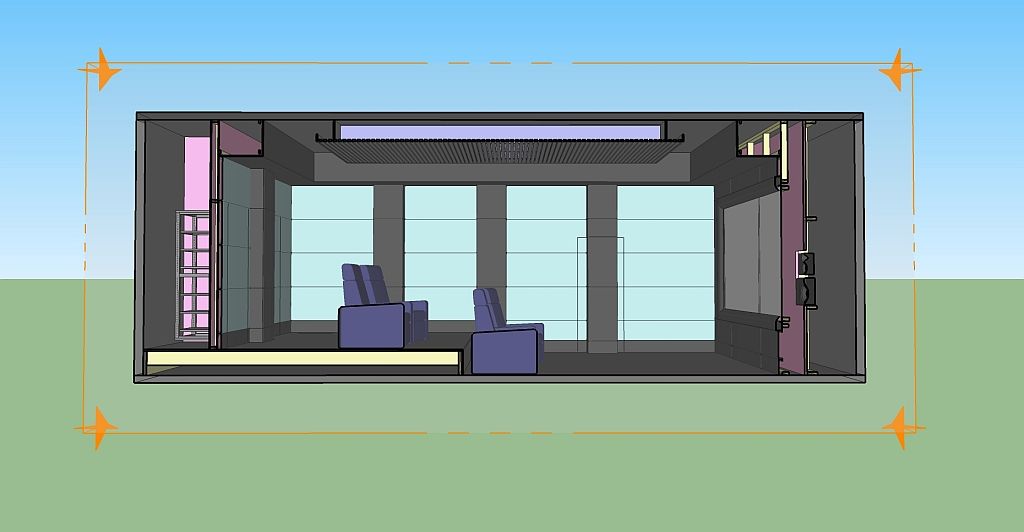

Apologies for the delay. I seem to have lost subscription to my own thread and didn't get an email.
As to the speaker height - Sketchup knows all !
I hope this helps.
Cheers,

Hi Pete,
No probs, thanks for the reply
It looks like the tweeters are at the center of the screen and aimed at the second row. Is that where you sit?
Cheers.
Gary

Gary,
Yes, that's pretty much correct. My preference is the second row, but that's not really due to the height of the LCR.
Not surprisingly the front row tends to provide more direct sound from LCR and less surround. The back row changes the balance slightly.
But this is not really from the change of vertical listening angle. Moving up and down in the room (front, rear, standing) makes very little, if any, perceived difference in the FR.
I think the Procellas do this very well.
Cheers,

Righto. Did Dennis design the second row as the MLP?
I might try some testing (maybe some measuring if I'm keen) to see what difference slightly off axis makes if i have the speakers a tad higher.
Cheers
Gary

Gary,
I didn't specify an MLP to Dennis, so I understand that the design is intended to provide the best uniform performance over the entire room.
By the time I had the room calibrated I knew which was my seat, so the calibration certainly aimed to please at the MLP !
Cheers,

If I have the acoustic center of the speakers at the middle of the screen, that puts the tweeter between the ear level of both rows, so assuming the vertical dispersion is much the same, the audio at each seat should hopefully be similar. Sounds like a reasonable compromise. Thanks for your help
Cheers
Gary

Peter: How did you deal with the unfinished space on either side of the column/door? I did not find a photo to show that.
While I can't put my L+R speakers behind the screen (without spending an outlandish amount of money), I am going to move them closer to the wall and see what i can do to get the visual side of my room to look a bit like yours -still my favorite of this style.

Hi Chuck,
I don't have a photo handy, however it looks just like the model -
Small panels either side of the column attached to the door. Very time consuming to get right !!

Thanks. I have "room envy" every time I look at your thread (and others that have a similar look). Until I saw your room, I was perfectly happy with the "recording studio look" of mine. The pull of this addiction hobby never seems to let up!!
Also, are there some posts on this thread that go into the detail of your ceiling "cloud"?
