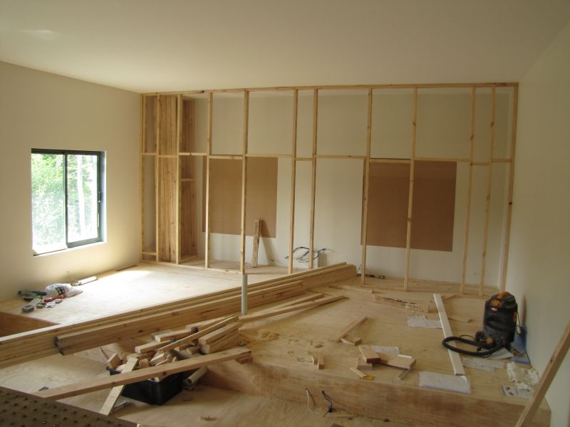

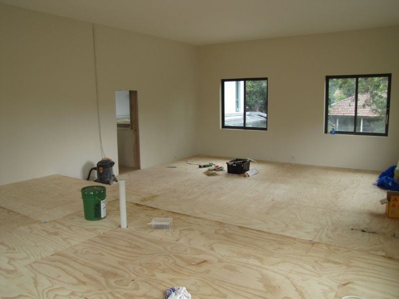

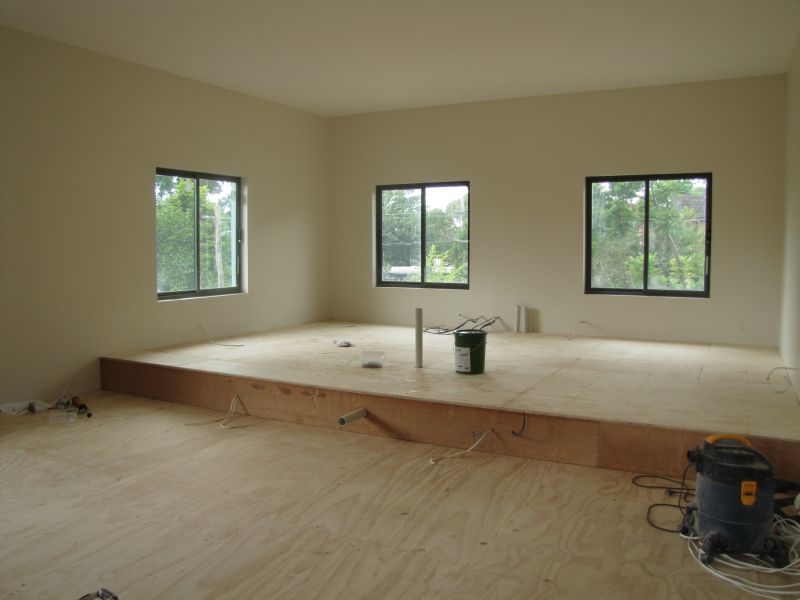

Riser is framed, insulated, first layer of ply finished, second layer of ply + GG on going ...
Cheers,

Thats an awesome space but have you got windows all round?
The windows will be permanently closed off. We put them in for external appearance, future use, resale etc. There are also BCA / Occ Cert issues as well.
Cheers,

Ok, makes sense. Was just trying to figure out where you where going to put stuff lol. I bricked mine up ; )

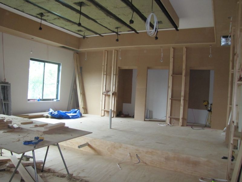

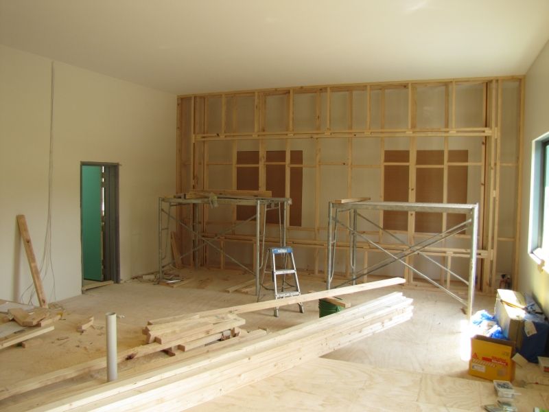

Four of six windows plugged, baffle wall framed, screen wall framed, equipment room framed, one of the doors in ...
Oh ... and Gerben from Procella has been around for a look and given it all the official seal of approval !!

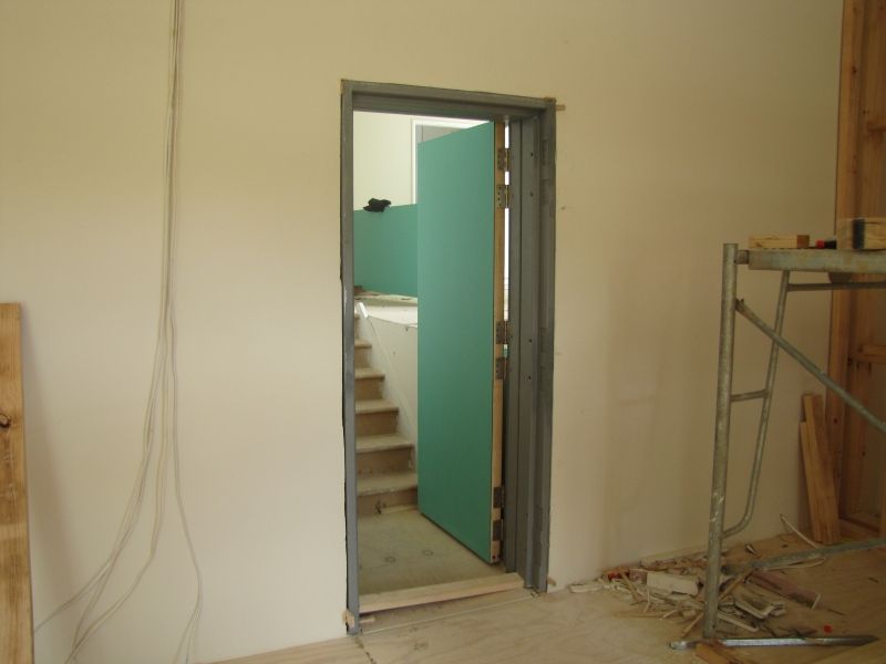

Hi Peter,
Yes ... if you look closely at the bottom of the door you'll see two black dots ... they are the buttons for the twin (!) drop down seals. There are also additional seals to be added inside the steel frame to the jambs and head. You can also just see the gap between the two steel frames ... one attached to the garage / theatre and the other to the house.

Great photos Peter. Those doors are engineered and built like a tank. Coming along real well. Won't be too long now. If you need a hand with anything, please yell out.

How does the drop-down door seal work & where do you get them? I have about a half inch gap under mine... Inkeeping with the aussie theme, I posted some gardening photos
I suggest you look for a local door specialist ... search for fire and acoustic doors ... and they should be able to advise. My drop down seals are rebated into the bottom of the door, but they can also be attached to the face of the door.

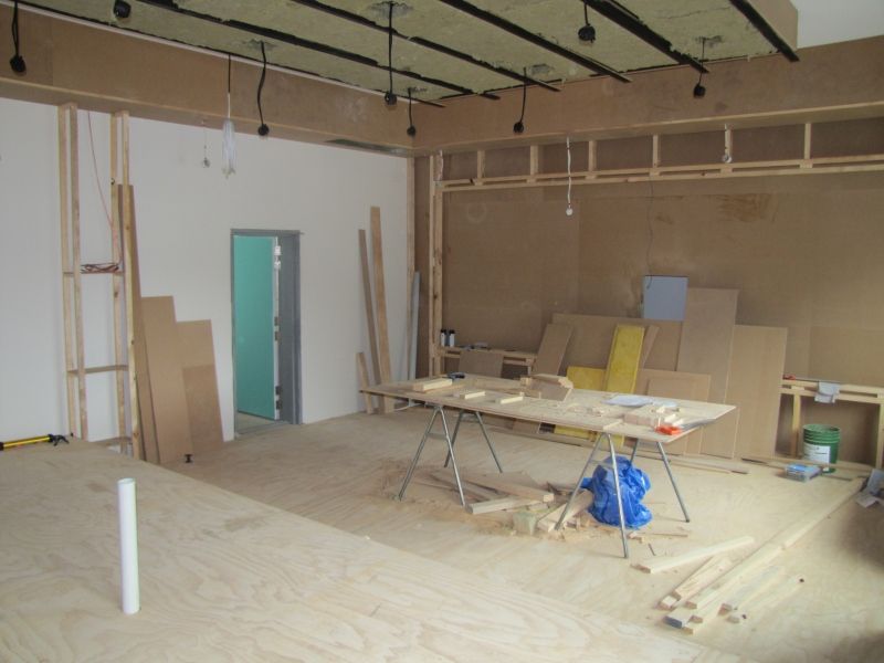

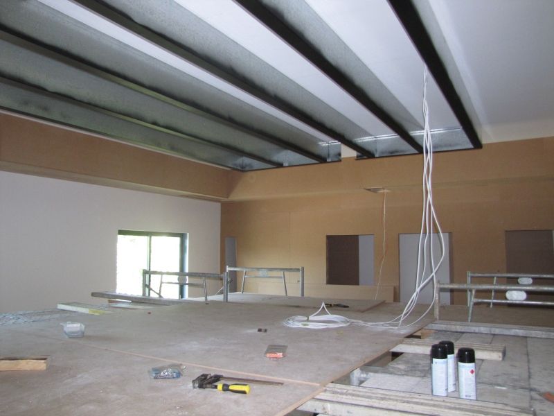

Baffle wall is sheeted, equipment room is partially sheeted, soffits are framed and nearly fully sheeted, ceiling baffle framing is started ...
Very happy with the progress !

Whats going in the ceiling baffle? thats huge/deep
Hi Peter,
Overall the baffle is about 300mm deep. The face is 50 x 25mm slats with 15mm gaps between them, running across the room. Above that is 150mm thick rockwool with air above that.
It's good having a 3500mm high ceiling, as even with the riser and ceiling baffle I'm left with 2900mm clear.

Uber bass trapping.....nice!

Bass absorber baffle is finished, soffits finished, ceiling baffle insulated, downlight wiring done, speaker wire in, column framing underway, one speaker hole cut in baffle wall ...
Cheers,
