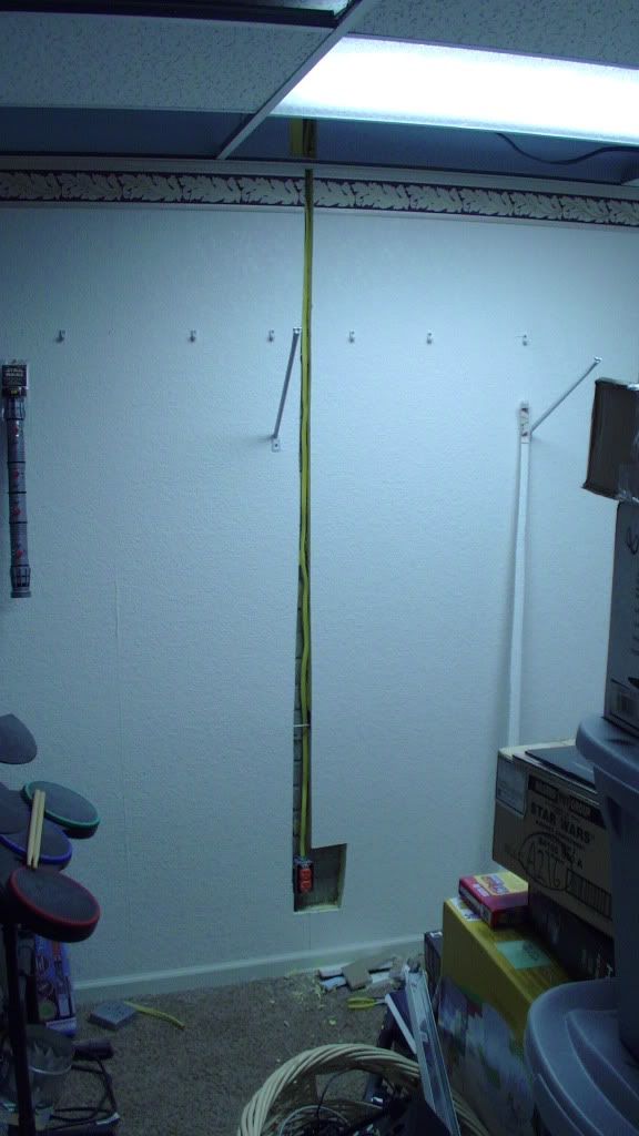

I actually started my project last week before the 4th but I just now got to posting this. But before I give an update on where I'm at, I'm going to give a description of what the theater will be.
I know some of you moan and groan at 3D, but I really enjoy it and there's more chance than ever of that experience improving. A while ago there was no easy way to do a Bluray dual projection 3D experience without having to do some work on the feature and then playing it through stereoscopic player. But now, even that player gives the capability to play it straight from the disc. That might work and it might not. If not, I'll do it the other way I was doing it. Anyways, it will be a full 1080p dual projection circular polarized theater. And, it will be a scoped theater (2.40:1) as well. I'm hoping to do it for 3D as well but that might be an experiment at the moment since I'm not able to buy a Panamorph (which doesn't do 2.40) or a Prismasonic (which does), but that might be an upgrade later. For now it'll be DIY prisms. It will also be a 7.1 system with a Tuba Home Theater Low Profile to give it that really rumbling blow that you would get in a real theater, and I will also build all the speakers. The walls and ceilings will be double 5/8ths with Normal Green Glue application. The walls will also have acoustic treatment as well using fabirc frames and wall coverings with rigid insulation.

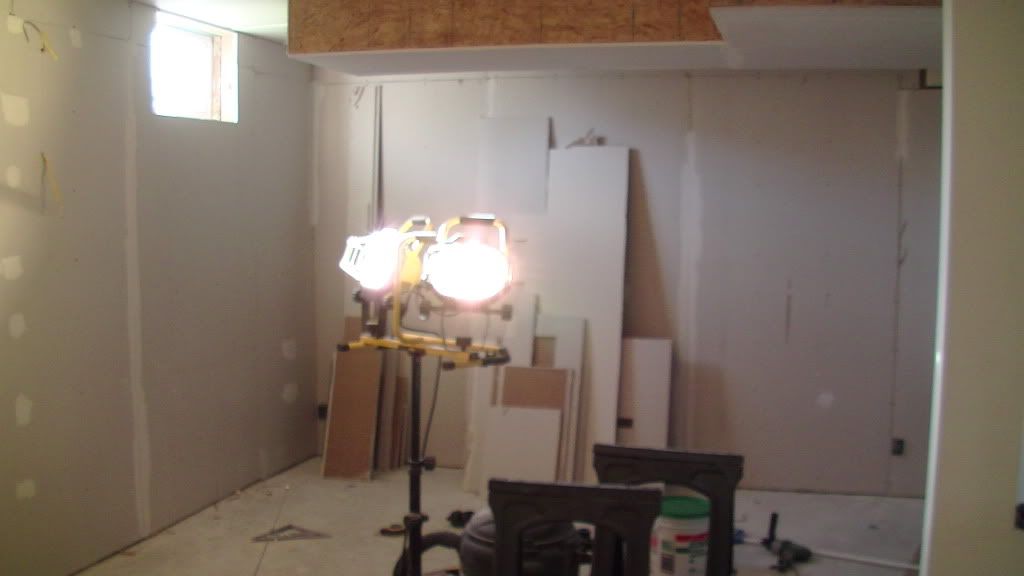

So, on to the updates. This is what the space looked like before.
Front
Back
And the basic design from the side.

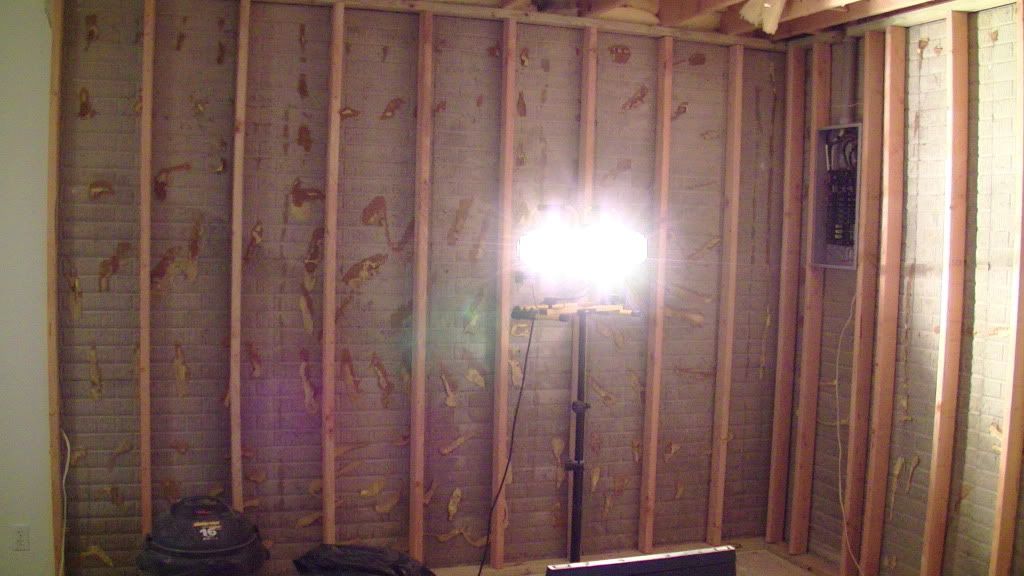

I stripped the walls and ceilings bare to start from scratch. I will be reinsulating the walls and ceilings to help with the cool Nebraska winters and come soundproofing from the rooms above.

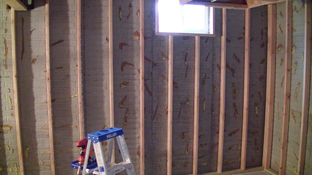

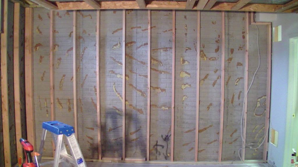

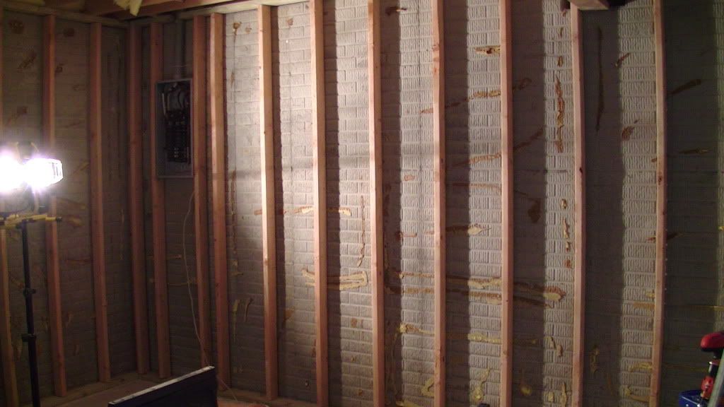

The walls were actually finished being framed a couple of days ago. Here they are:
Front Framed
Side Framed:
Back
And here are the dimensions I'm working with. The back wall is 11.5', side wall is 22.5' and the front wall is just over 13'. I don't have a pic of the other side at the moment, but it's the area for the boys and in the back left is the PC room. I'll have my media server in there and maybe the rack as well.

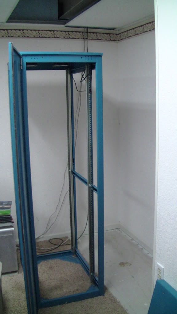

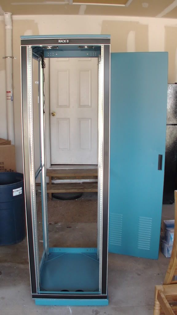

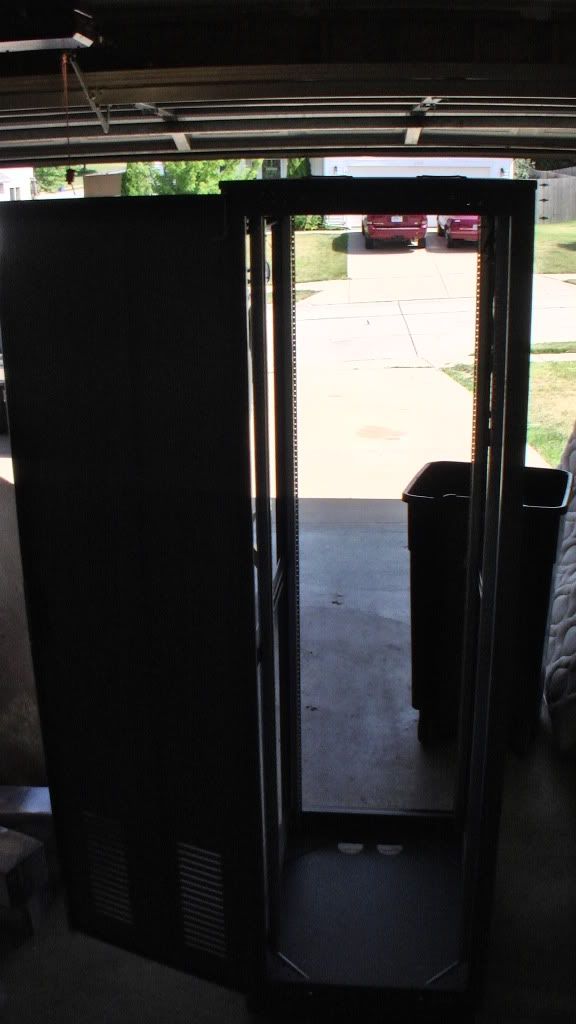

Yesterday I picked up my server rack from Craigslist (great place to find things for repurposing by the way). Right now I'm posting from work and can't post any picks but I'll do that tonight when I get home.

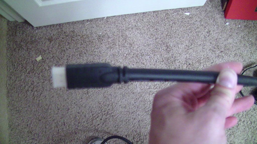

So, here's been the bulk of my time issue. This theater will be a dual projection 3D theather capable of watching blu ray 3D through two projectors. Now, I'm not certain who has looked into doing this on a large movie screen but the only "correct" way of doing this that's available from the market is by using a single projector that costs a lot more than need be, doesn't have the same quality as dual projecting images does, and oh yeah, you have to pay 150$ dollars for each glass. Ummm... no. Let's do it the way the professionals do it and the way it's been done for most movie theatres and theme parks and has had a lot better success. Dual projection! Oh, wait, there are no commercial software or hardware bluray players that do this. Hmm, so how to do this. (Ok my rant is over).
So, I knew of Stereoscopic player and that it could a large variety of files and configurations and people have been using that software for a long time to do dual projection 3D. But no one has used it for 3D bluray movies. But, I'm very computer savy and video savy so I didn't give up. I found that I could rip the left and right video files from the disk AND keep the lossless audio in an MKV format (which is supported through Stereoscopic player but using third party codecs). I don't have my theater up and runnign (obviously) and I want to test everything to make sure it works.
So, on Wed I set up both projectors and started playing one of my converted videos and it starts up fine in one window and then you need to switch it to fullscreen to have both screens playing it. I switch it over aaaannnndddd, nothing. Just black screen, not frozen, no loading visible, etc. Mouse even still moved across the screen. And it went that way for the better part of 3 hours. So, now I'm working on that problem which isn't making me too happy because one of things I really want for this theater is 3D in HiDef. Fortunately, I know this way of doing it does work and it just means there's some kind of oddity about why it won't work. So, I have some things left to try out tonight. If any of you have ideas that would be great. I've also posted it here.
So, tonight I'm probably going to play with the projectors because tomorrow late afternoon til evening I'll be doing the wiring while in the afternoon I have to put the watercooling into my computer that runs this whole theater.
I'm just hoping to clear this problem up before too long so that I can continue in confidence, I guess you could say.
Edit: Pics for server
Front of Server (kind of hard to see)
Back of server

I did find the solution to the Stereoscpoic player issue. It turns out that I had accidentally set the output to Stereobright Dual Output which may or may not be oversaturating the workload of the files. I'll have to test that so that I can send any bug info to Peter Wimmer. But if I set it to regular Dual Output, it works flawlessly and beautifully. So, I was certainly ecstatic about that. Oh and it does work fine on both Bluray 3D files and the left and right files that I've been using as well.

Which server rack did you buy? There have been quite a few posted lately. Is your gear rack mountable? If not, the cost of shelves will probably run you more than what you paid for the rack.
What are you doing for HVAC in that room?
nebrunner is offline
post #15 of 96 Old 07-26-2011, 10:10 PM - Thread Starter
ImmortalJman's Avatar
Location: Davenport, FL
Posts: 199
Actually, I'm not sure which brand it is. I just know that this will accommodate my future media server which will be a 4U rack that fits this cabinet. It will also accommodate all of my equipment which some of it I will certainly have to buy the shelves for, and yes they are expensive but required. It's the same ones that I use at work. I'll post dimensions later.

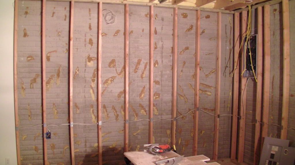

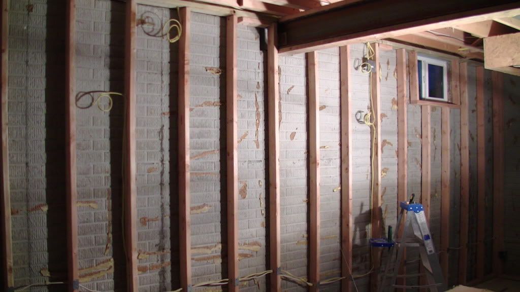

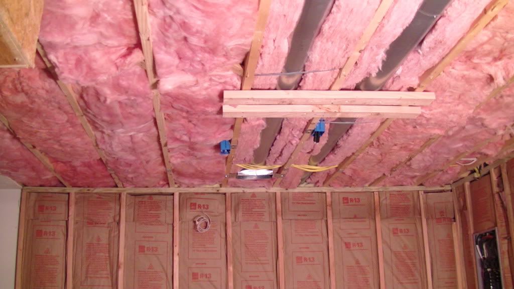

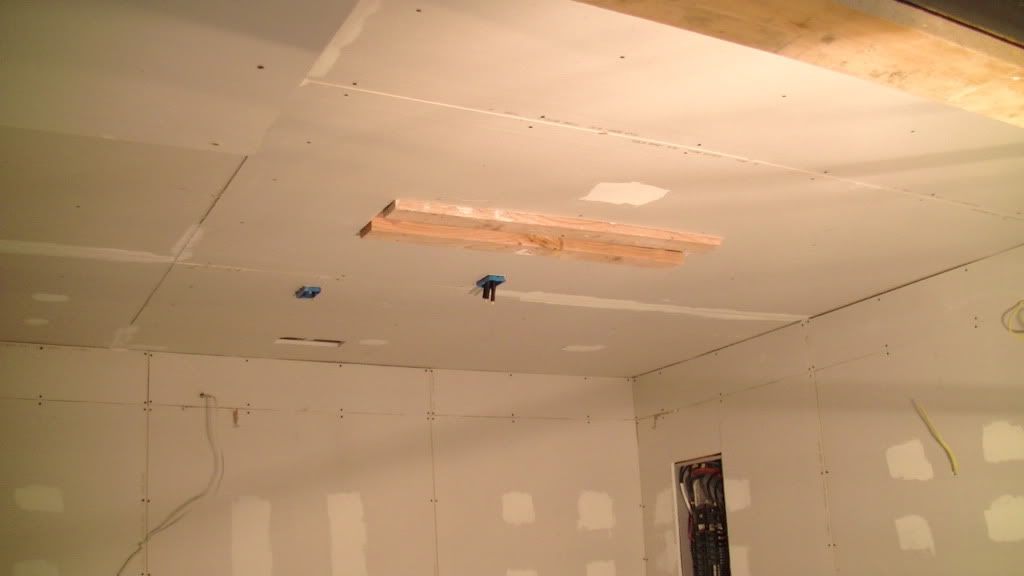

So, I've not done any updates in a while because I had not really made much progress on the electrical and didn't really have anything to share. But here it is.
Side done with wiring for sconces and rope lighting above
Back
Not too worried about good patching on this area because another layer will be going on it and then the fabric frames as well.
Isolated Computer Outlet: This socket is completely grounded on it's own all the way back to the service panel and is 20Amps. This should ensure plenty of dedicated power.
Server Area Ready: The rack will also have two of it's own isolated 20 Amp receptacles. The wiring above it is already done, I just need to clean the floor up and move the rack into place.

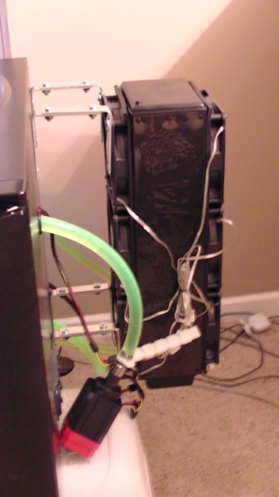

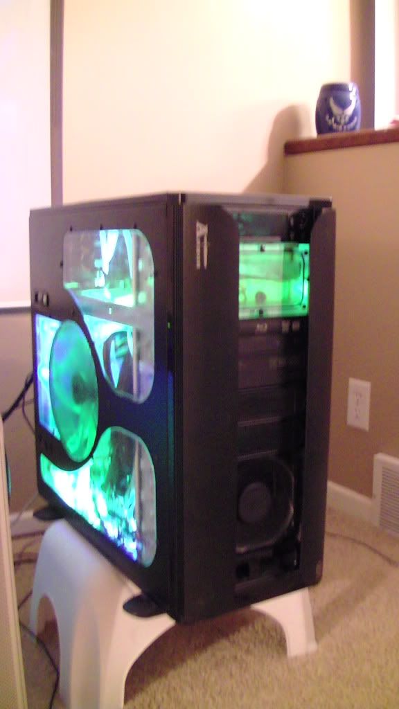

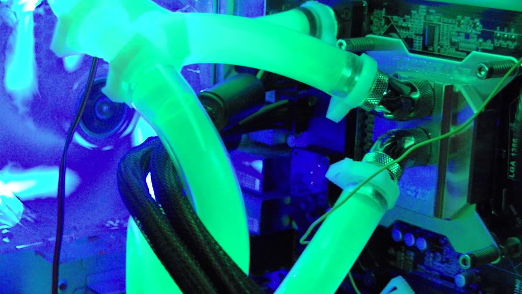

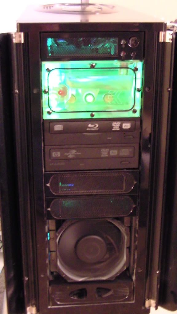

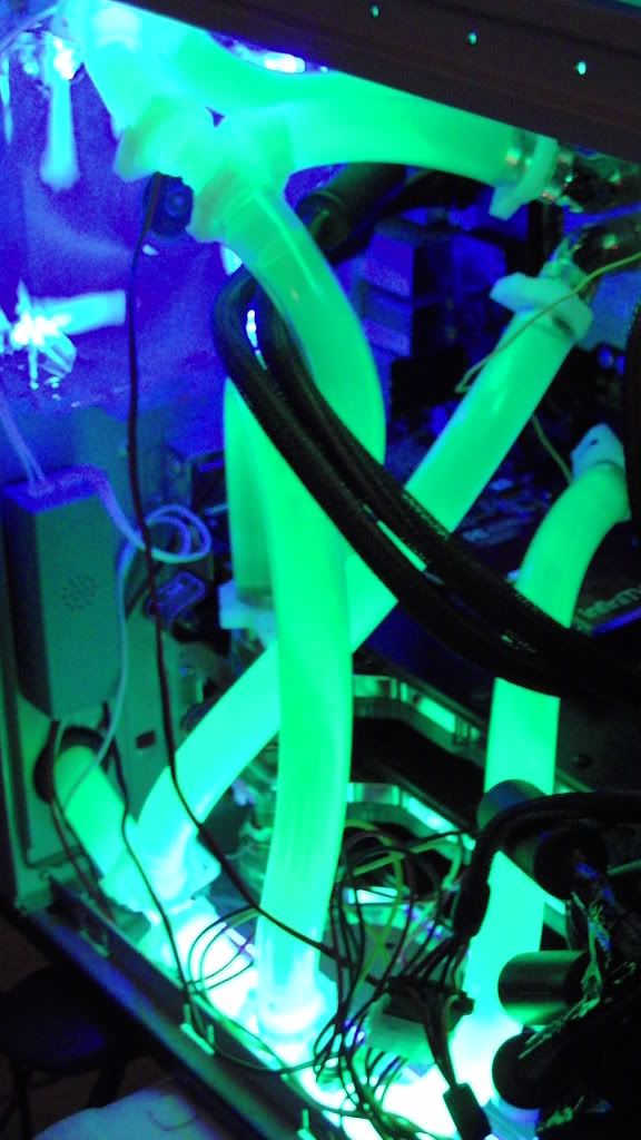

But, most of what took me so long was my final mod to my Media Server Computer. If you've read the previous post you might guess that I would need to have a lot of power to run this theater. My other computers have been liquid cooled and this one couldn't be the exception. So, I finally took time to do it. And it definitely took a while considering the complexity of this build.
This one shows just how cool my UV reactive dye looks in the computer with the UV lights on inside.
So, this is where you can see why I made the decision to liquid cool on this one as well. I have three power hungry video cards that give off plenty of heat and sadly, even though the board sports a lot of cool features, it also has the down side of having every video card next to each other. So, the fans weren't really getting enough air to cool them down. When I'll be running Crysis 1 and 2 in 3D and any other fun games, it will require some heavy loads. These are 3 AMD 6950's. The awesome thing about these cards are the sliding switches which gives me two firmware possibilities. And the 6970 are just a firmware change. So, I was able to flash all the cards to 6970's and saved myself $100 per card. Not bad hey?
This is cooling an Intel Hexacore chip. It's not overclocked yet, but I soon will. It's pretty sweet to see handbrake encoding with all 12 threads.

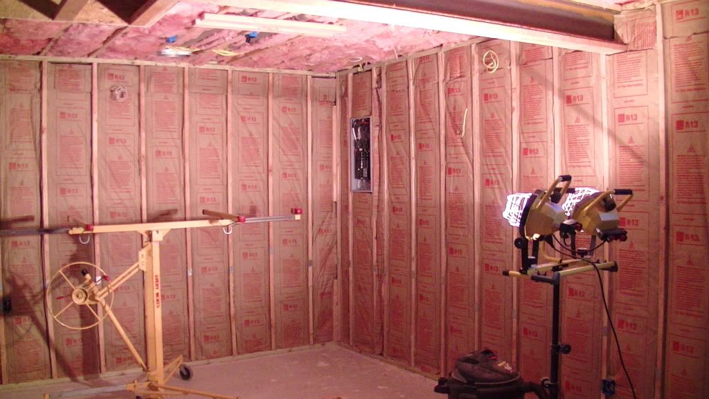

Next step is insulation which I just bought and is sitting inside my garage ready to be installed. I'm not sure just yet when I'm going to start installing it but it should be soon.
I chose to do the speaker wiring between the drywall and the fabric frames for two reasons. One, I didn't want to worry about having the electrical lines right next to the speaker wires and two, it'll be easier this way. My wires are actually going to run down the length of the I beam that sits under the house running the length of the basement. It will run right into my soffits making it easy to route it around the various speaker places.

Nice computer, mines' water cooled also, I need to get some shots of it in my building process

As for updates, I got the basement cleaned up and now I'm ready to install the insulation. I'll try to do that on Monday hopefully.

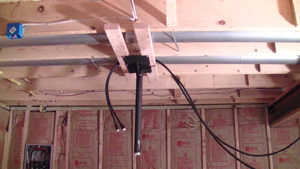

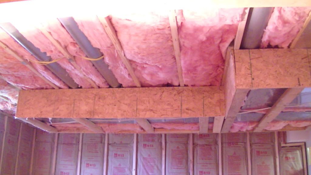

Well, I feel like I've made quite a bit of progress even though it's just the insulation that I've completely finished. It's just that extra step that makes you feel good getting closer. I've also finished the first layer of drywall on the ceiling but I won't include pictures yet until the whole first layer is finished. I plan on starting the walls tonight but I have some other woodworking projects that I have to do so that might have to wait until the weekend.
In the meantime here are some pics of that itchy goodness.

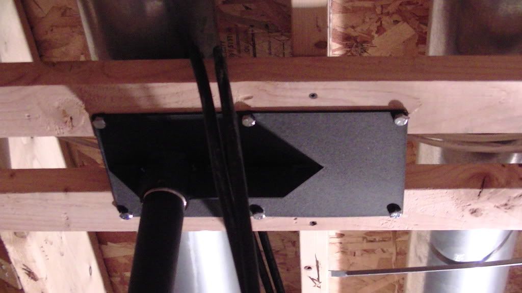

I also remembered that I reinforced the projector area for the mount. I took some 2x4's and mounted them across 3 joists and drill the holes in them for the mount plate and then put T-nuts on top so that I could just screw in the Hex bolts. It worked beautifully.
Oh, I almost forgot. Since I had to cover up the ceiling and all I thought it would be a smart idea to remember pulling the HDMI cable to the projector mount area as well. Since the length was going from my computer room to the main theater area, it had to be a really good thick cable for good transmission. Over 50ft in fact. I will still have to do some tests to make sure I don't need a repeater. The gauge is 22.
And up close to give you an idea of the size. This was a beast to pull two of these at once. I forgot to take pictures of the pulling but I ended up using the handy space on the side of the I beam supporting the house. I bought some 2" PVC and slid it along the side of the beam to make for a much easier wire pull, which is also where my speaker wiring will go through once I'm done with the drywalling.

I just finished putting the sealing around the bottom of the wall plate today and tomorrow I'll be putting up the wall which won't take nearly as long as it did for the ceiling. And for anyone doing the ceiling, it definitely was worth it to rent a drywall lift. It was pretty cheap to do as well.

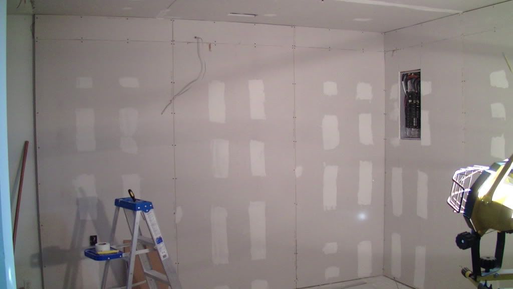

The drywall went up as expected. No real surprises came up. Although, I did see something strange on my side wall and felt that something didn't look right when I realized that I had forgotten cut a hole in the insulation earlier for one of my sconce electrical lines. So, luckily I figured that out just in time and was able to easily take down that piece of drywall and do the required work. But it did make me look more carefully around the room to see if I had forgotten any other access ports or electrical holes I should have cut out but didn't. And gratefully, that was my only mistake. Now, this is my first time doing any drywall project on this scale and I was quite pleased with the results so far. So, if I can do it, anyone can.
I accidentally started covering the fasteners when I realized that I don't need to do that on the first layer. I did however fill the large gaps where the drywall didn't exactly line up. So, that means today I might do some mudding. For the first layer you don't have to do taping with it if you're putting up another layer of drywall, which I am. So here are the requisite pics.
And a closeup of where the projector mount is. Since it was a very close fit and the second layer is going to butt right up to the bottom edge of the backing I decided to wait before I put my capping on the projector mount area.
