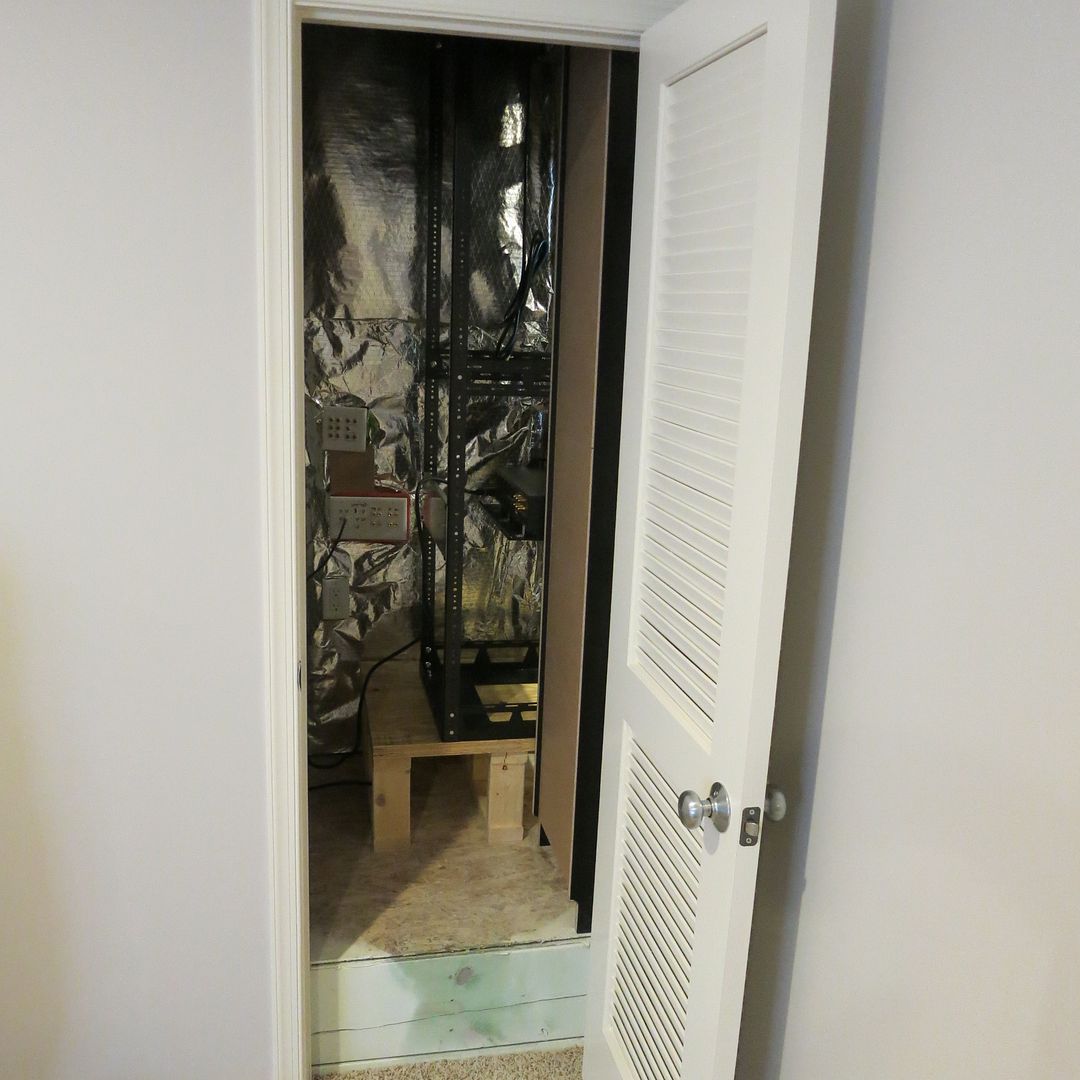

Here's a shot of the equipment closet that I designed. It's wired for 9.1 sound, 1 HDMI + 2 Cat5e to the projector location, and 4x Cat5e to the house's network. And it also has it's own 20amp dedicated circuit to power everything. The white "tube" you see at the top right of the pic is the conduit that goes all the way to the attic for future proofing. The floor is raised so it's at the same level as the riser inside the HT. And I also have them to use a "vented" door for air circulation too.
I'll be cutting a hole at the right side of the drywall for the rack after I moved.

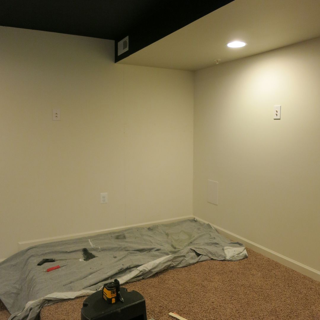

We finally got the keys 2 weeks ago, and in the progress of painting & moving in.
Here's the latest pics of the HT:
I'm about to start to paint the screen wall & the ceiling in black (Mouse Ear Flat) like my old HT.

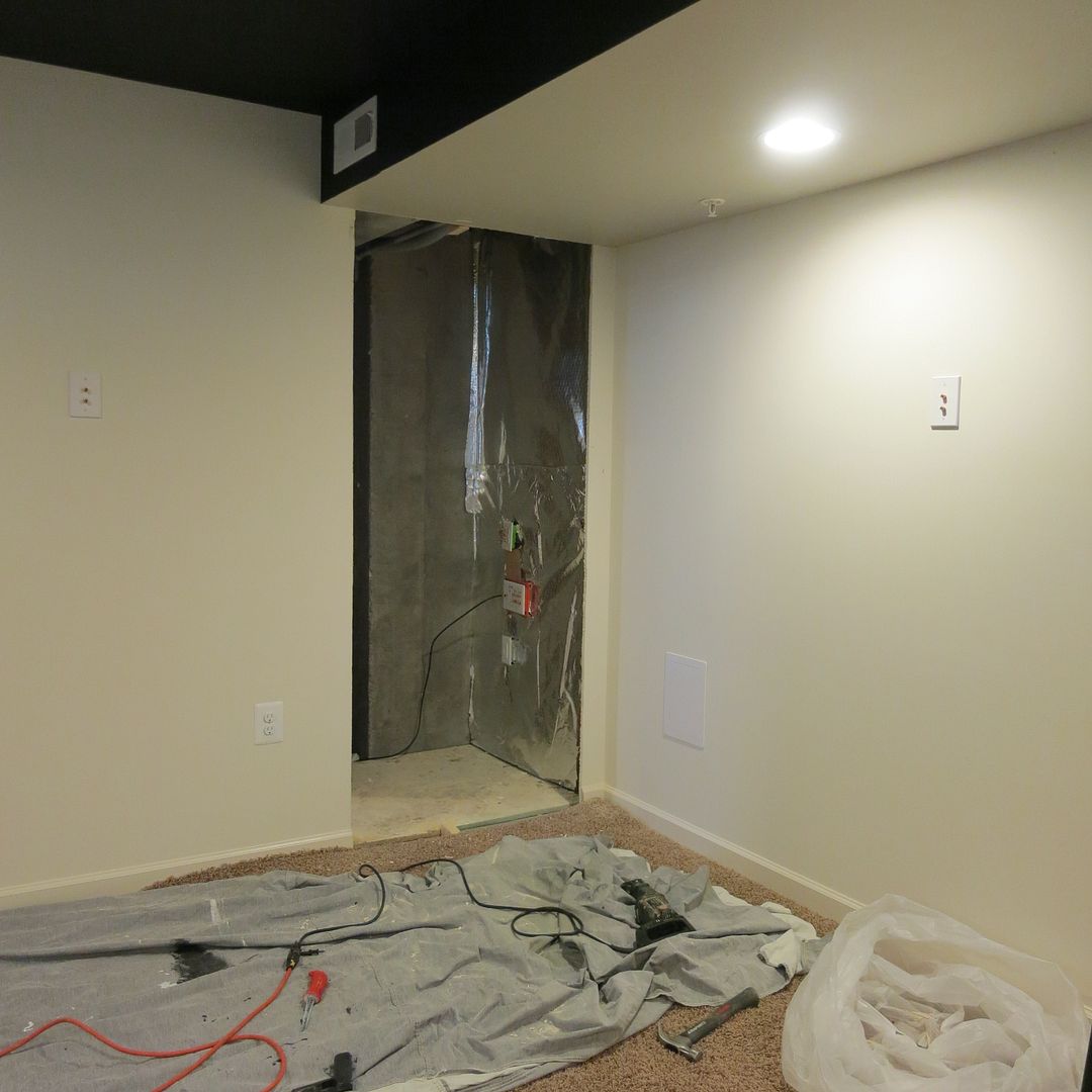

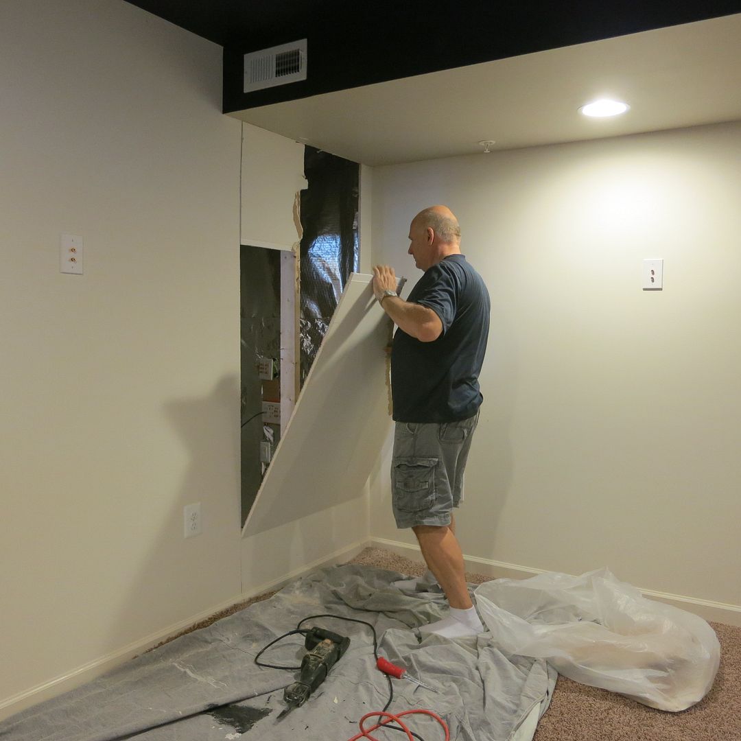

Gary decided that the time had come to start with the minor surgery required to turn his "builder built" theater into another great theater. I got the call to offer some support with tools and encouragement to start ripping into a perfectly good wall.
1 PM - a perfectly good wall

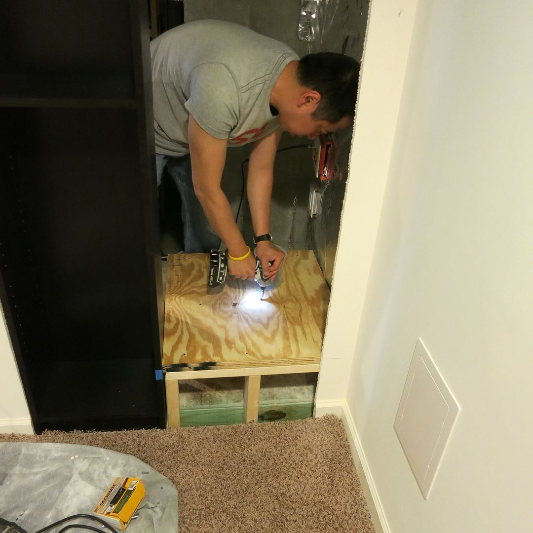

Gary wanted proof that I was there, I'm in trouble, he knows how to work my camera!
A hole

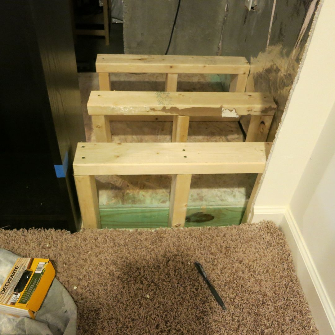

We wanted the rack to be the same height as a Ikea bookshelf that will be along the side so we needed to build a platform raising the Middle Atlantic rack.
I let Gary play with my tools and probably sold another Impact Driver
A platform needs to be tested

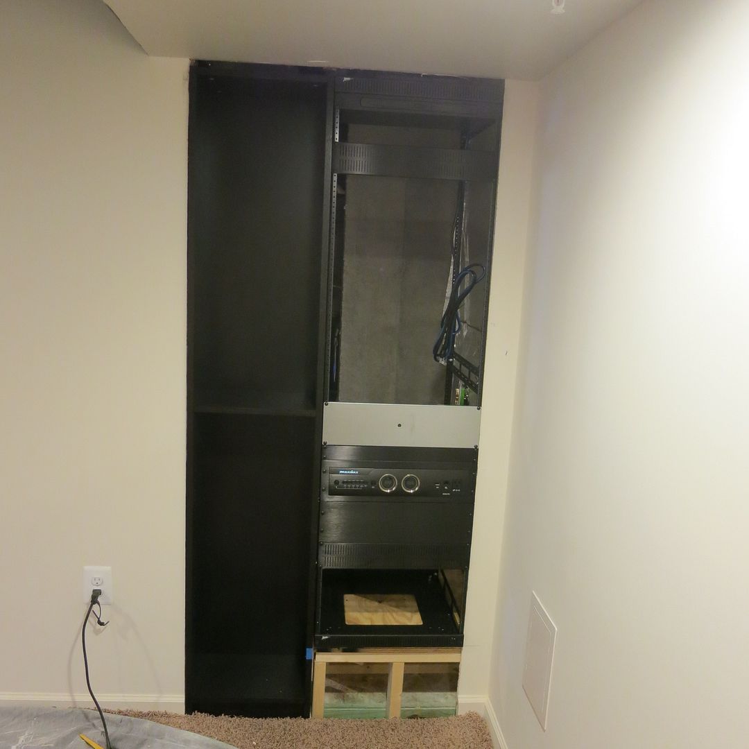

A test fitting of the the bookshelf and the rack. Final securing will happen when the wall treatments go up.
rear view
Finished at 5PM

Thanks to Big/Jeff for his creativity & accurate measurement, now I could have a decent size bookcase/Bluray rack right next to the MA rack!! biggrin.gif
