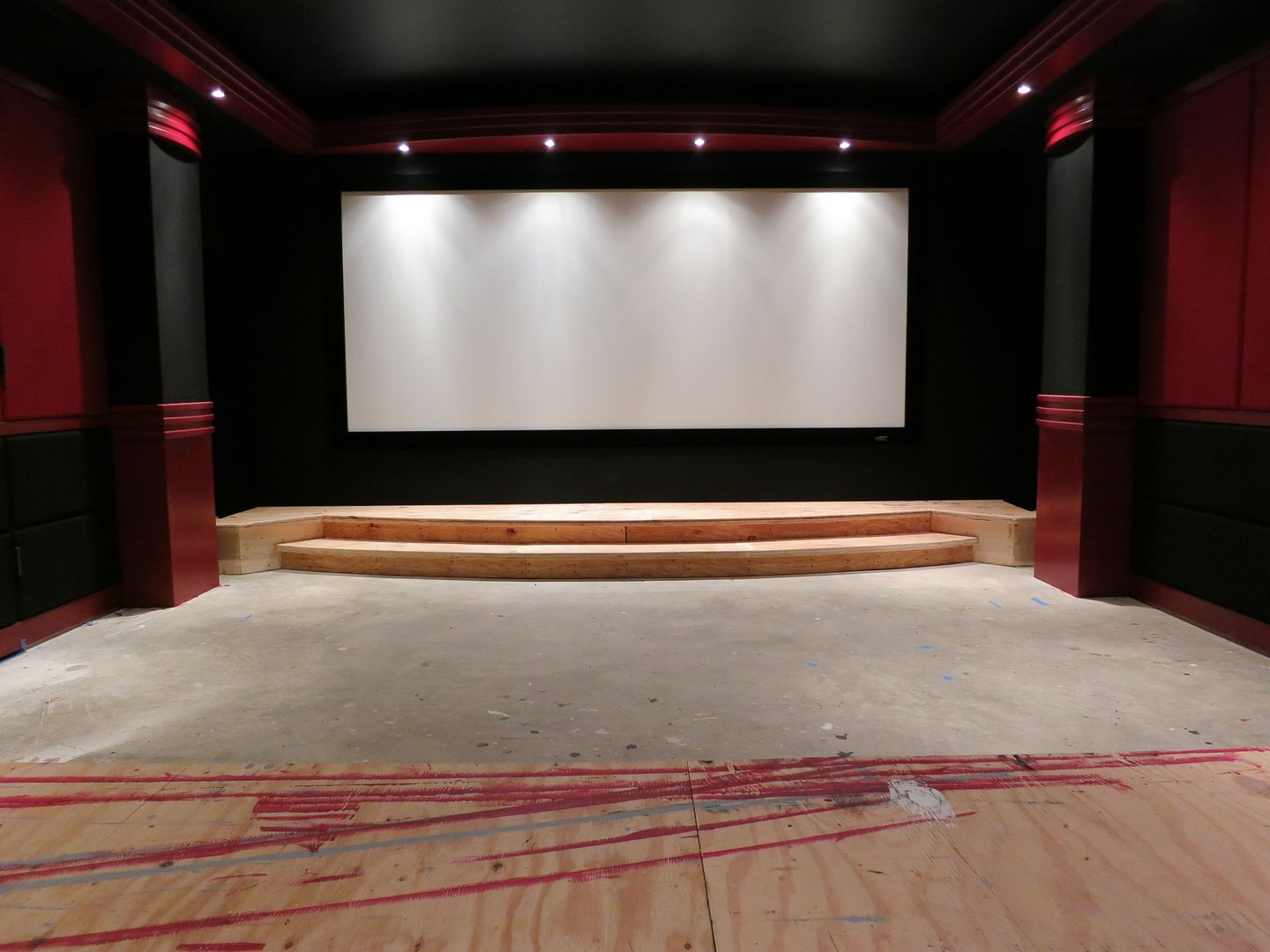

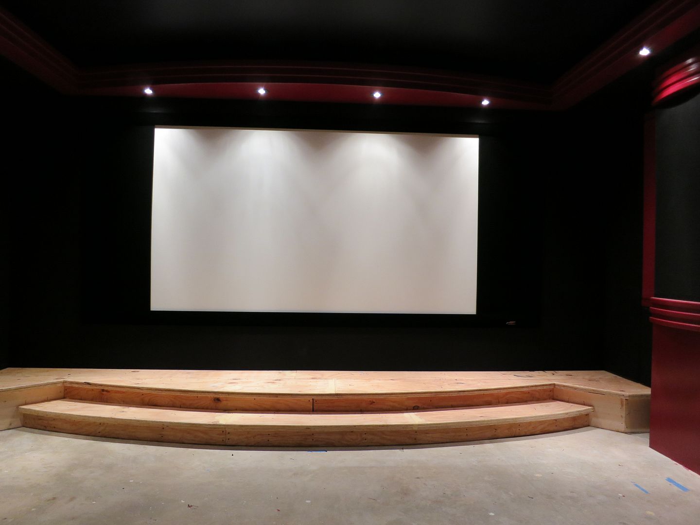

Damelon and I did a bunch of odds and ends today on the space working through a list a small items until the carpet and projector arrive next week.

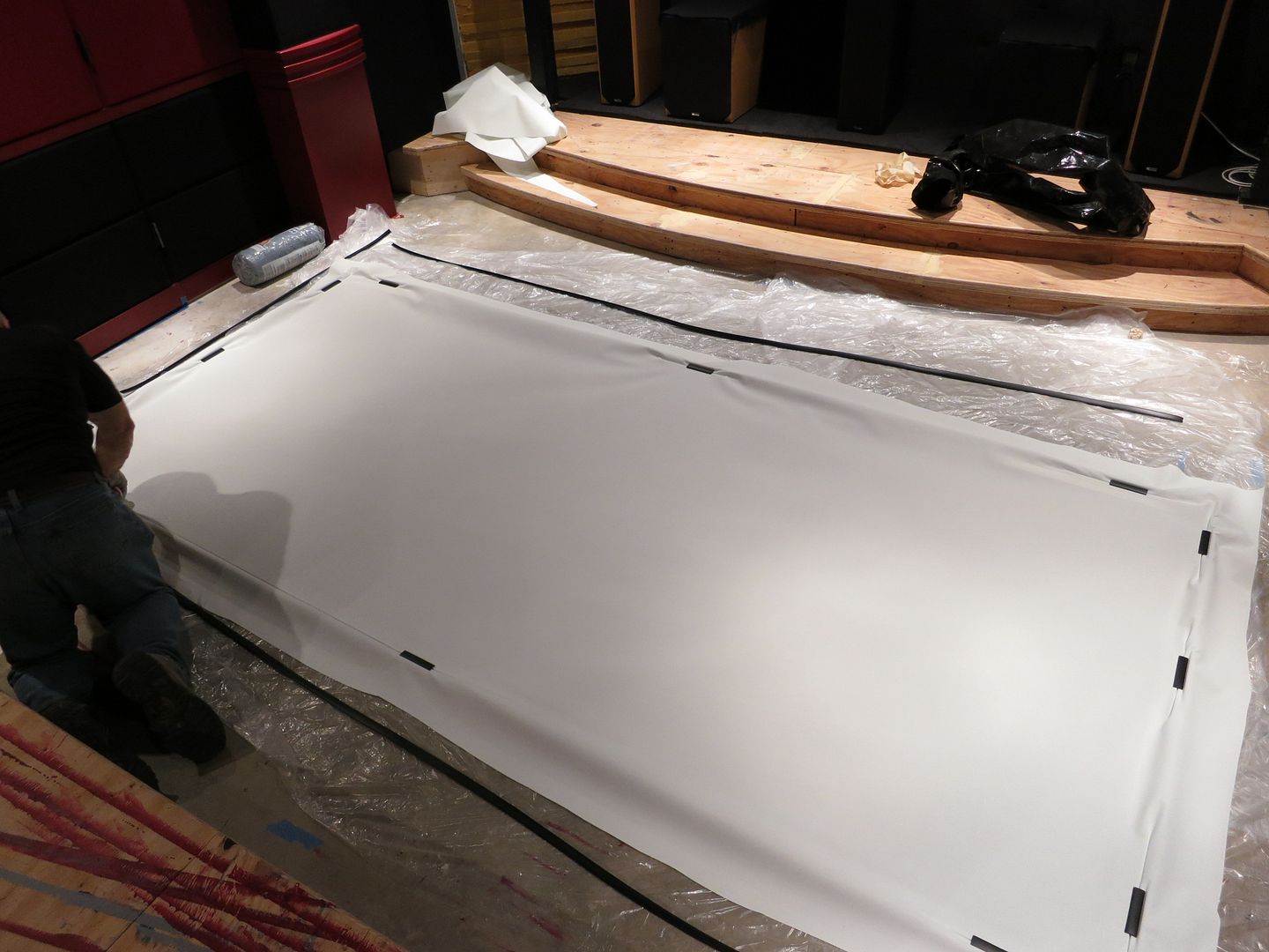

One big noticeable item was putting the fabric in the screen.

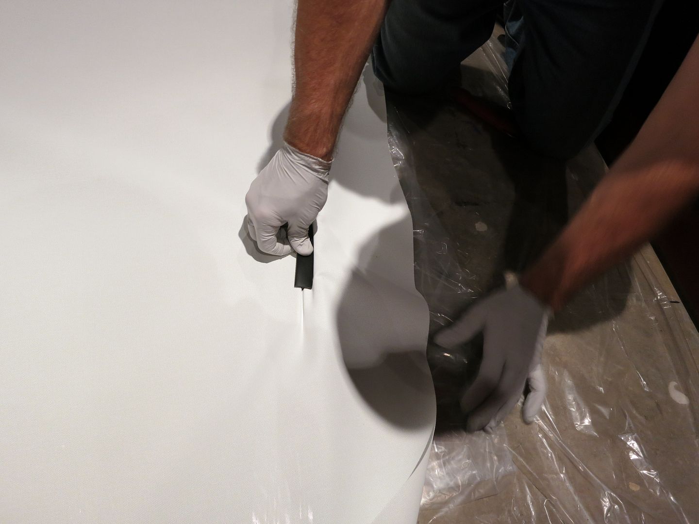

On SMX screens the fabric is attached by inserting splines into groves in the back of the aluminum frame. First you put in 12 little lengths of spline and then you come back and replace them with full length splines.
They send a little pizza wheel to force the fabric into the grooves
then you put in these temporary splines
In Twelve strategic locations
Then you go back and put in the full channel length splines
When finished the screen goes back on the false wall framing.
Shot with the 16:9 masking panels in place.
Then the full scope screen.
Later this week we should have FINAL FINISHED photos with carpet and chairs.
