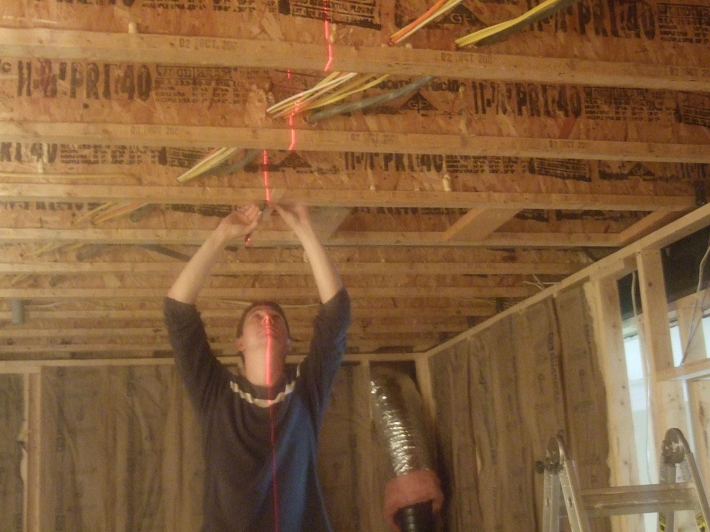

Weekend Update.
Here is what 2 guys and a couple of dogs got done in 14 1/2 hours this weekend
Resolved three framing issues, moved the rack rough in up, anchored a loose wall and added some missing cripple studs over the door
Removed existing ceiling lighting circuits
Finished the remaining 80% of the insulation, R13 walls and R19 ceiling. Unfaced insulation where there was and existing insulated wall with vapor barrier in place, faced everywhere else.

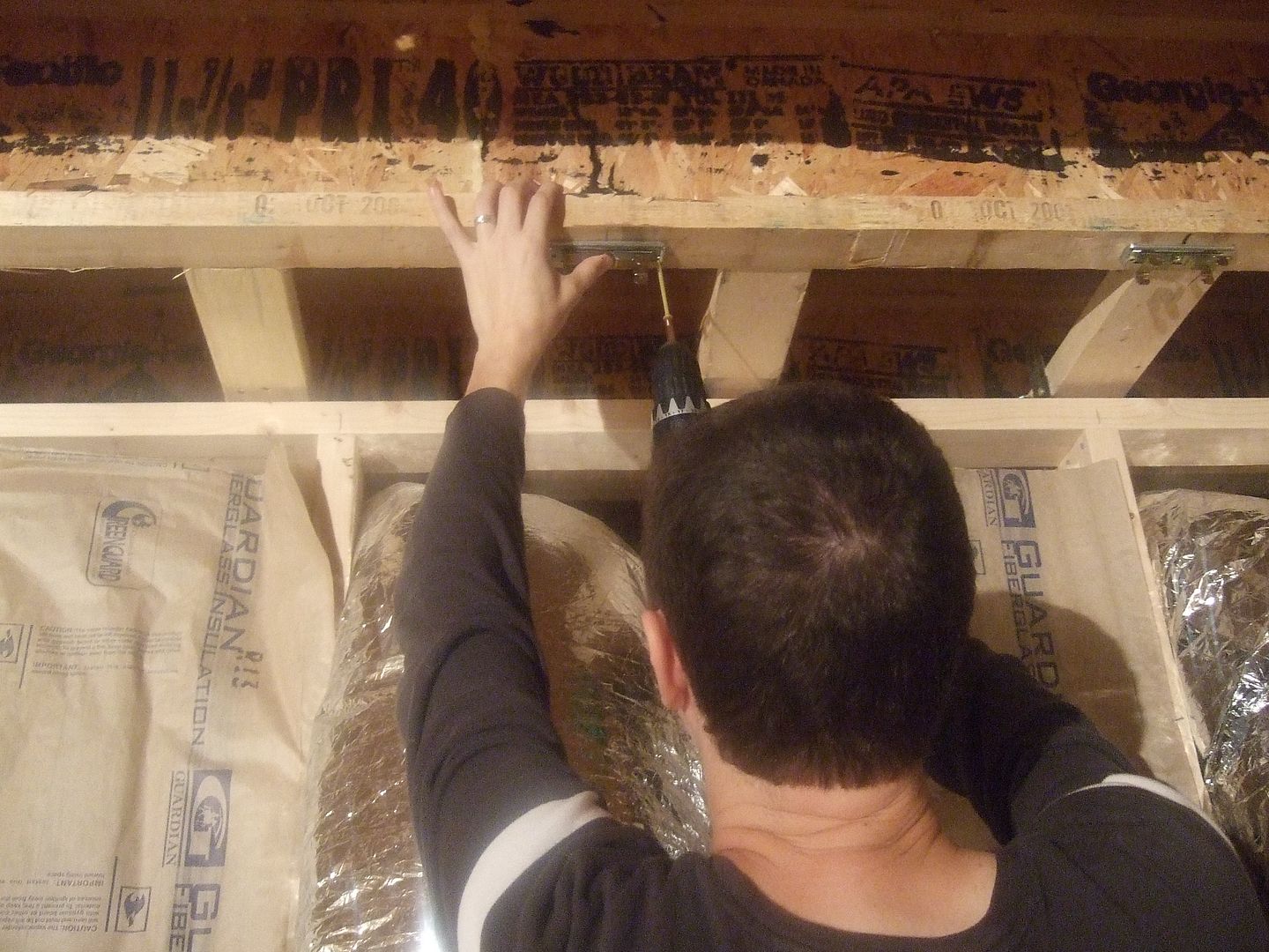

Installed RSIC-04 clips between the top plate and ceiling joists in the theater and the equipment room

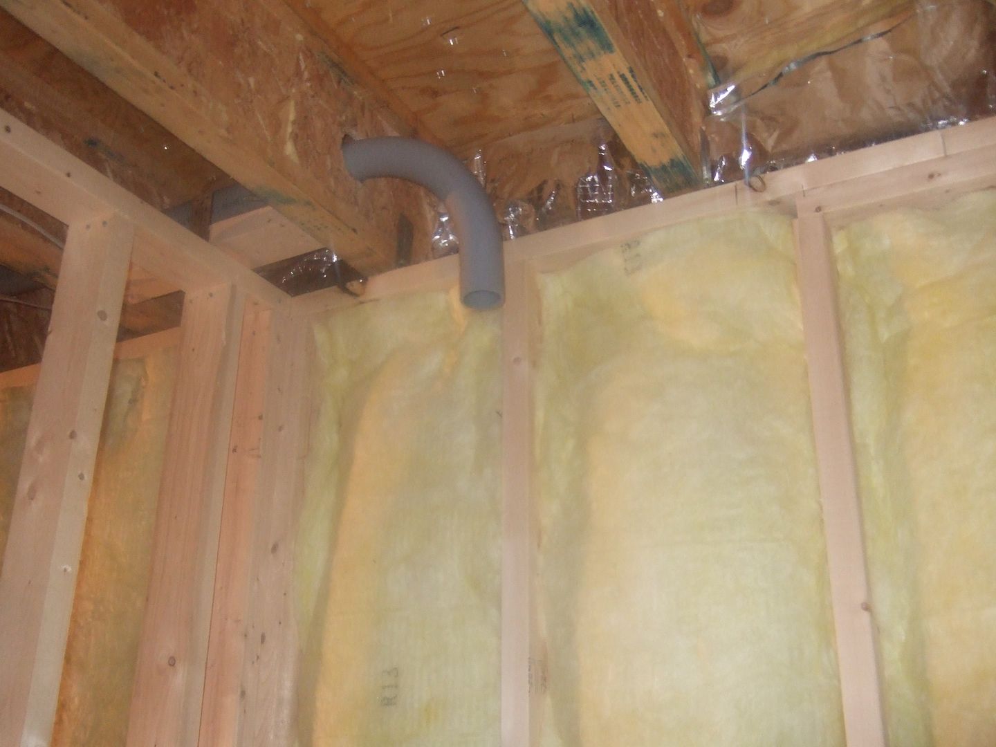

Determined projector wiring locations and installed 2 inch conduit and Romex.

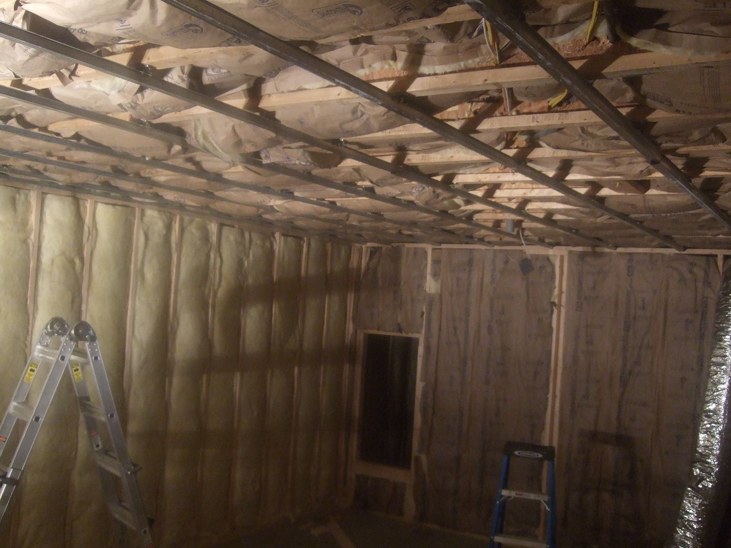

marked ceiling joists for whisper clips, installed clips and 25 gauge channel.
Some pictures
Equipment room view of conduit for the projector
OSHA rejected photo of marking whisper clip locations, either wear protective glasses or turn your back. The Theater owner hard at work. Laser is sitting on the floor.
Putting up a clip
All the clips and channel installed!

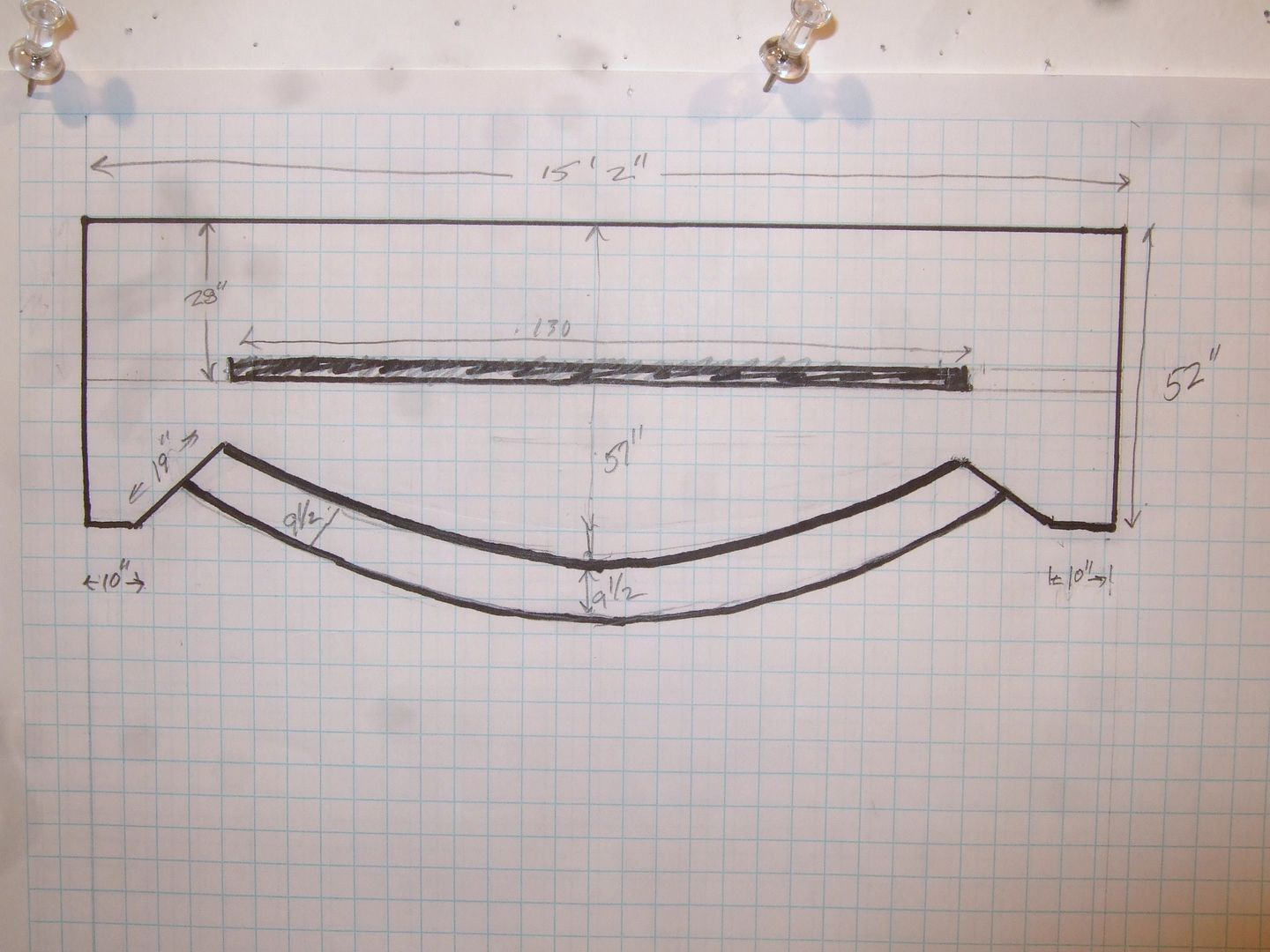

Did a quick sketch to rough scale on grid paper to get a rough approximation of stage dimensions. We can use this to estimate materials but we still can modify as we go. Maybe the curve just a couple inches shallower etc. Look at the right side angled part there is an error on the left. Each square is 6 inches.
What the bones will look like for reference

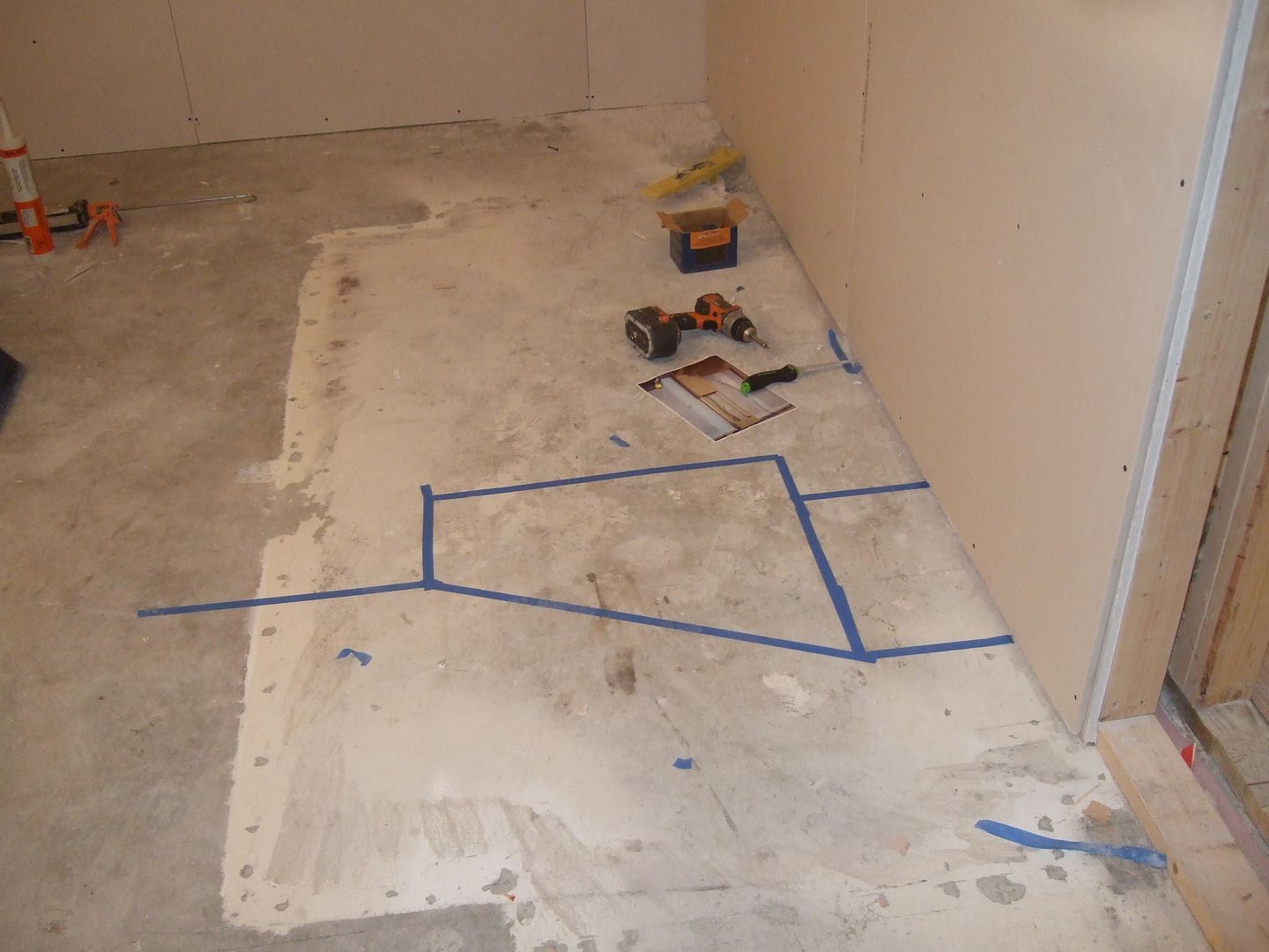

BIG and I sat down at the end of the day and had some fun with blue tape figuring out spacing and dimensions for columns, the riser, the steps, and the stage. We were going to go shopping for the materials but it was already 5:30 and we were tired.
Today the workers should be back and doing mudding and taping of the movie room. If we are lucky they will also get the drywall up in the equipment room but it isn't important for our schedule if they can hit that today or not.
Assuming all goes well, Saturday will be Riser & Stage day for BIG and I.
7'6" deep riser, 10x18 column, 30 inch inset step at an angle with step light . All inspired by the Sandman's riser. 109 Inches left between steps for seating.

Thanks Jesto! I can't wait to see how it turns out either! And FYI, BIG has mentioned things he did on your build each day he has worked with me so far. I think the biggest topic of conversation is your drywall between your ceiling joists. I remember seeing that in your thread and praying I never had to do that. (My main level is all hardwood above so it DID cross my mind, I just decided against the work and time to do it)
On another note,
I am pretty sold on a 2.35:1 screen at 130" wide. And likely I will get the new Panasonic PT-7000U next month. (ProjectorCentral is supposedly writing a review on one they have on-hand right now and should have it up next week) I just want the CIH to be as painless as possible. It may be using a lens or the zooming method that is offered on the Pannys... not sure yet. But whatever I do, I want my solution be able to at least "support" 3D in both aspect ratios.
