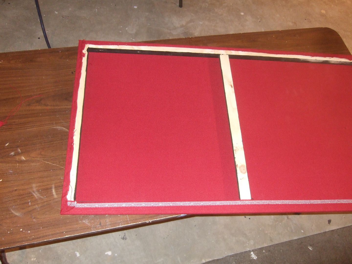

WEEKEND REPORT - ALL ABOUT FABRIC PANELS - Part 2

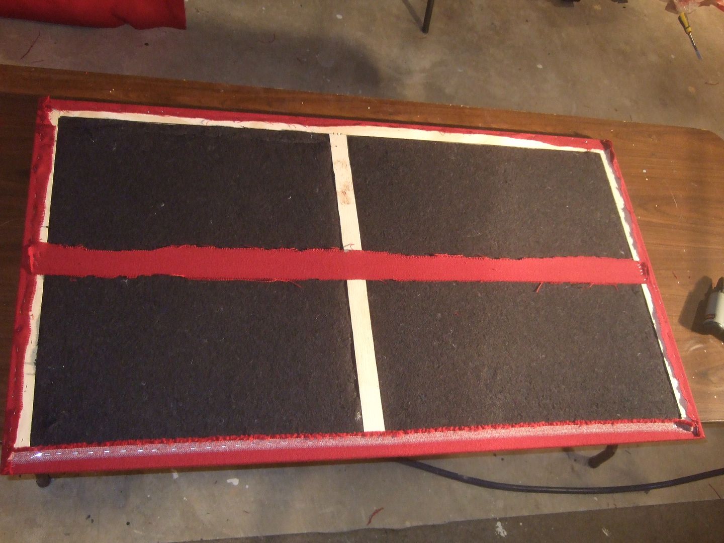

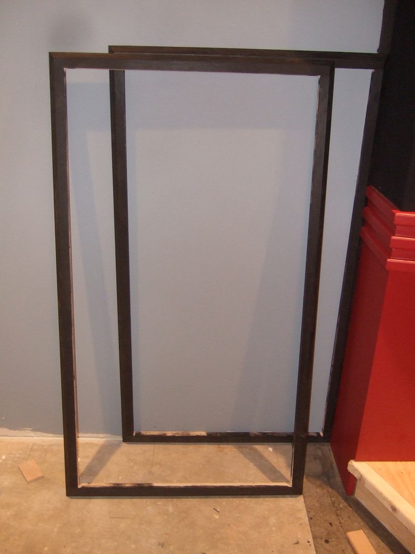

So we started with a pile of frames
Painted them Mouse Ears black

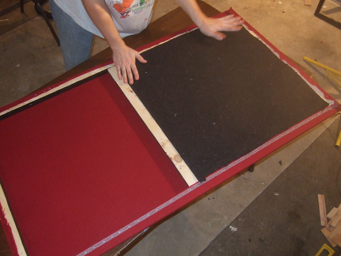

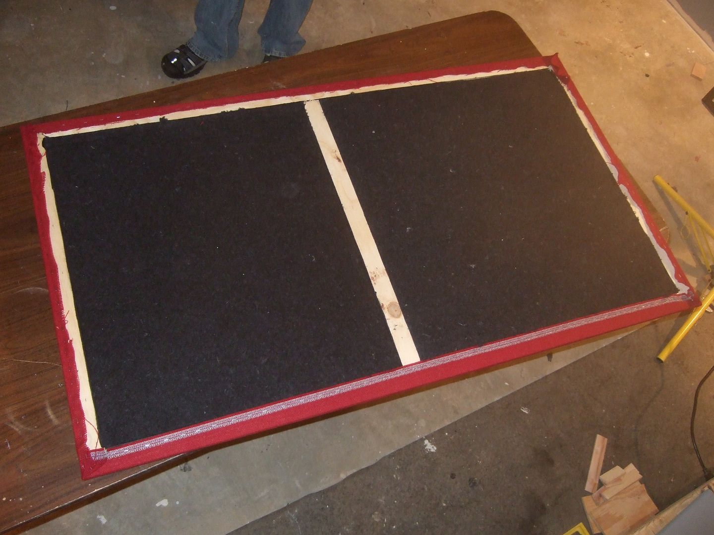

Wrapped and stapled (Porter Cable Upholstery stapler) with fabric. Don't even think about doing this with a manual stapler. My electric was never up to the challenge either.
You see that we added mid span support pieces to prevent bowing. These were just pieces of 1/2 plywood painted black on one side and held in position with the staples.

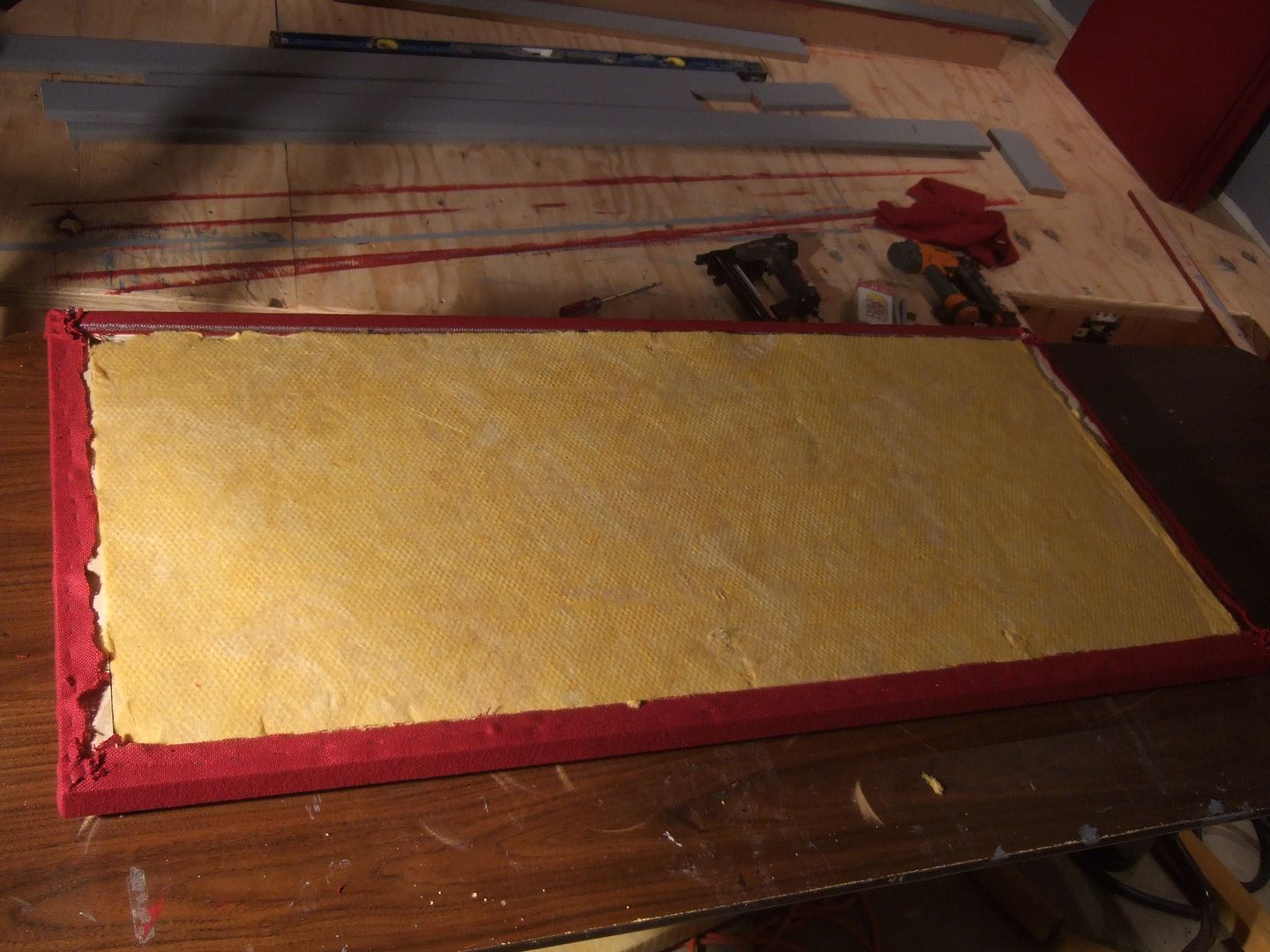

Then we fitted in the 1 inch cotton insulation, the mid span support was positioned to accommodate a full width piece of the cotton.
We added a belt of fabric scrap to keep the insulation from flopping out as we move them about.
As Damelon mentioned once we had the first one done and propped up on the wall we knew immediately that we had a problem. The columns were too orange. Now at this point we had already invested several hours picking out a color but it wasn't until we had several square feet of the fabric up on the wall that up could tell we had a problem. We pressed ahead somewhat bummed that we had this issue and finished a full section of the red panels so that we could position them and get a good look.

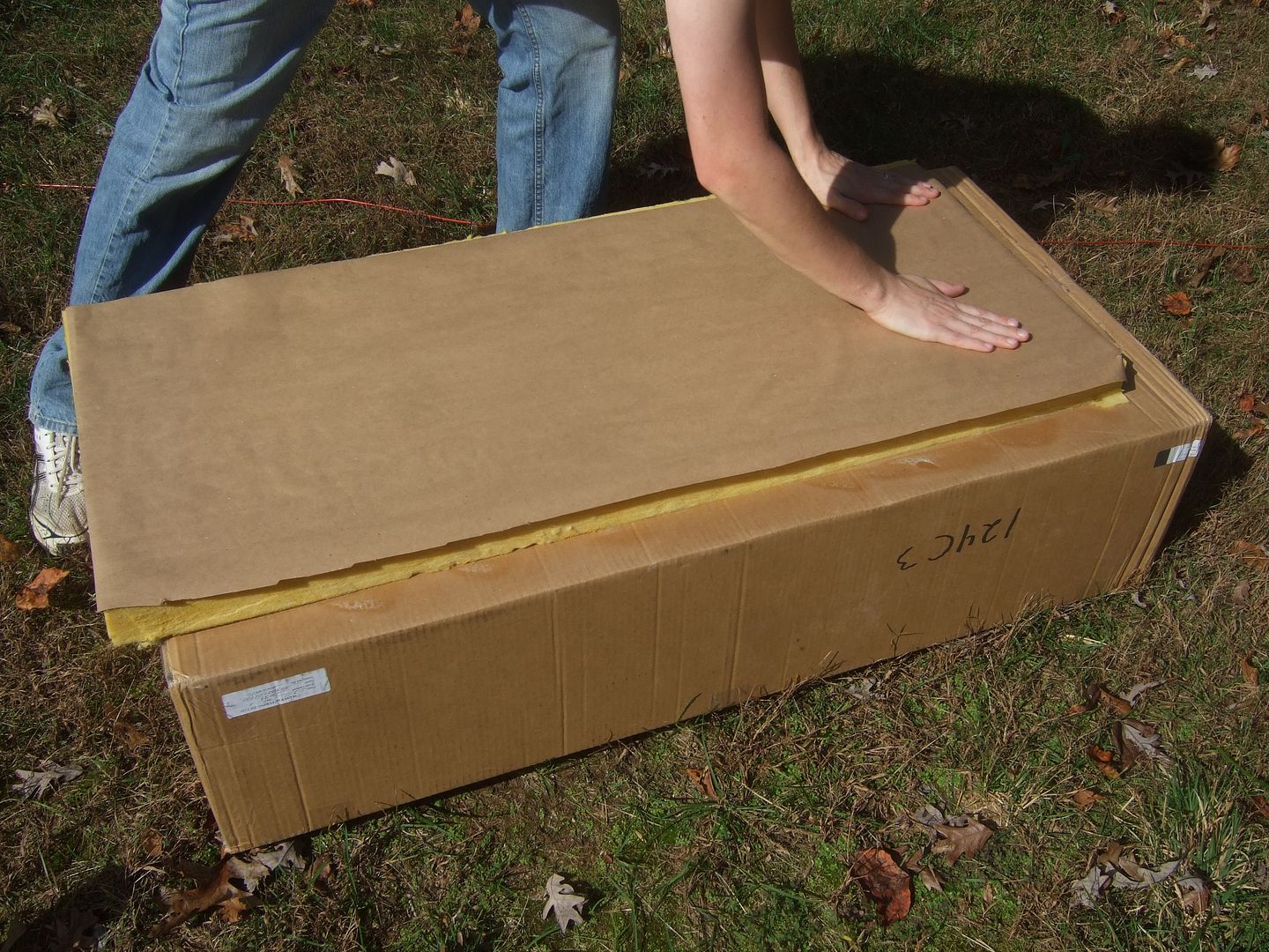

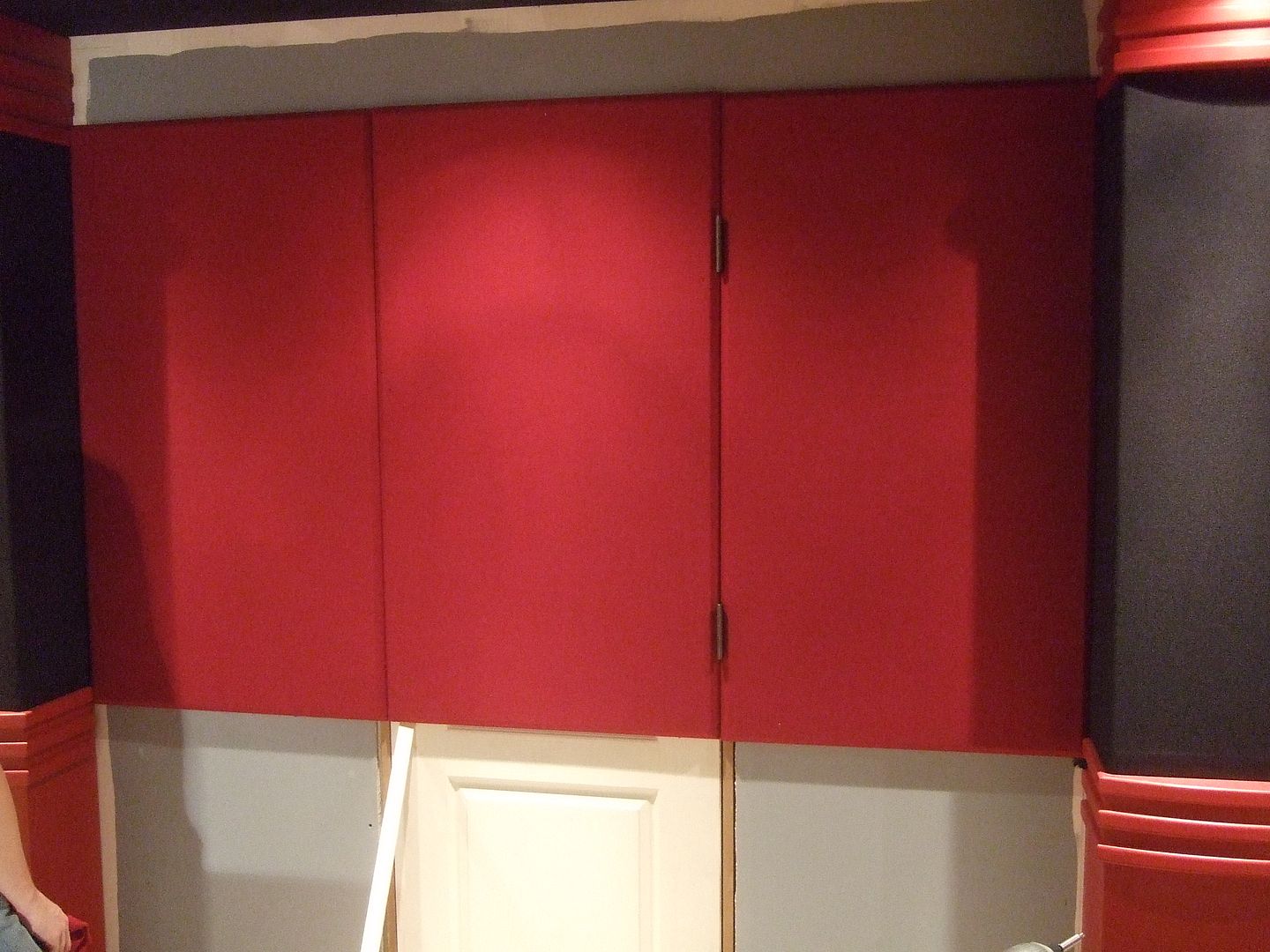

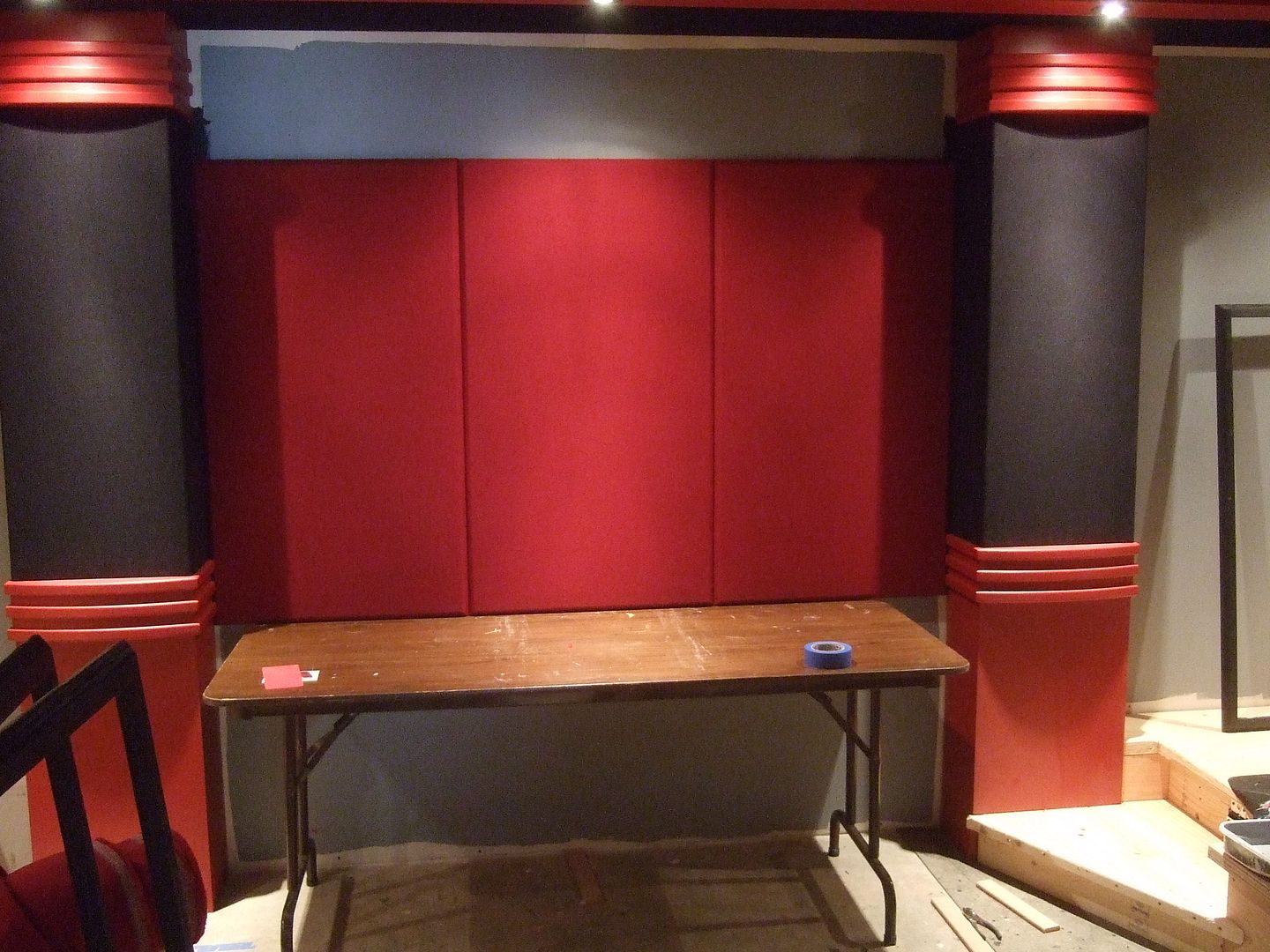

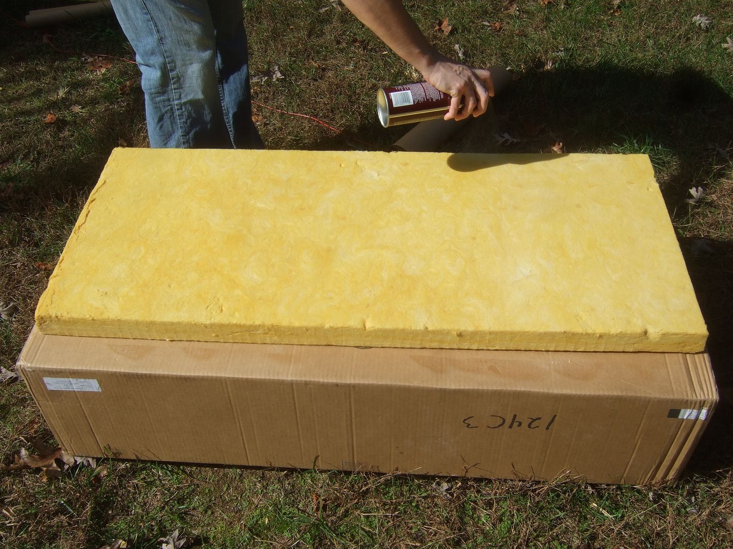

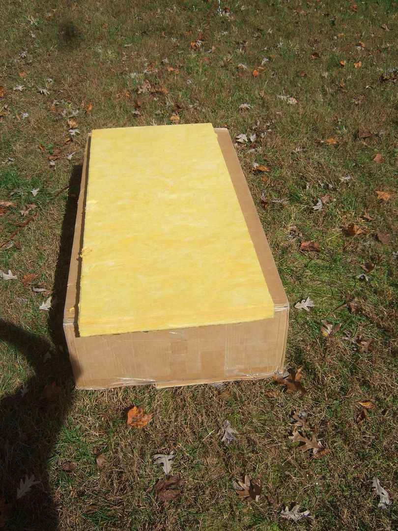

The rear wall acoustical plan (BPape) calls for two inches of rigid fiberglass board, two inches off the rear wall, with a paper scrim.
The two inch insulation (OC705) boards
A coat of 3M 77 spray adhesive. Notice we took this outside
on with the brown wrapping paper

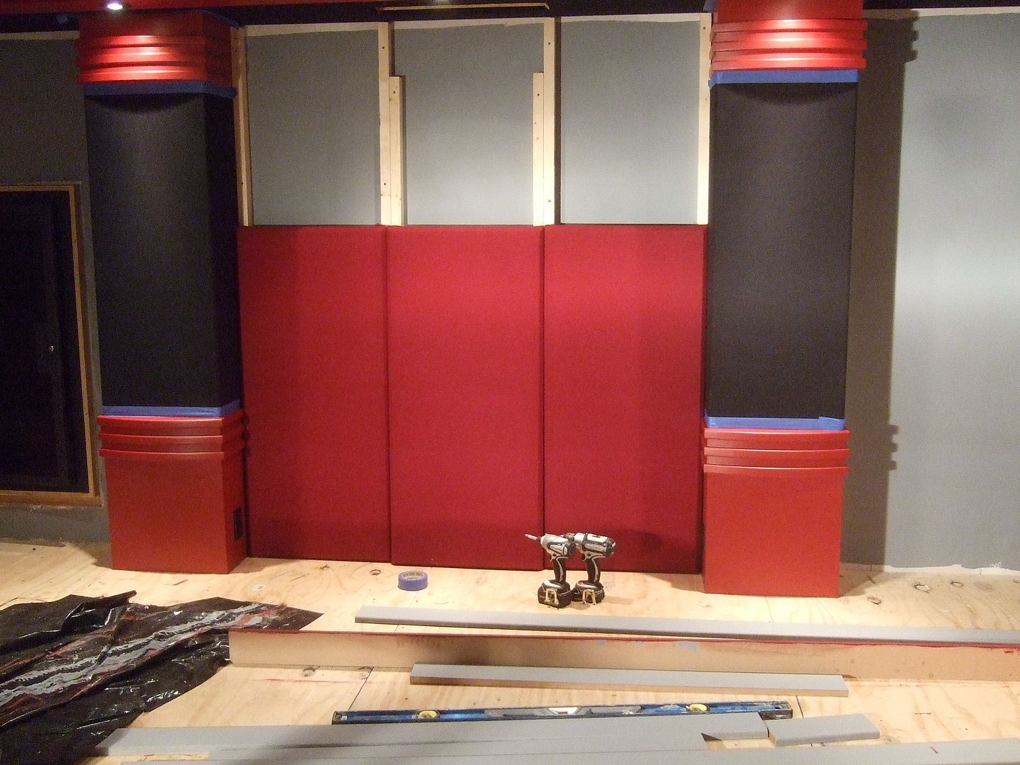

and into a two inch frame. These were 4 layers of 1/2 inch plywood.

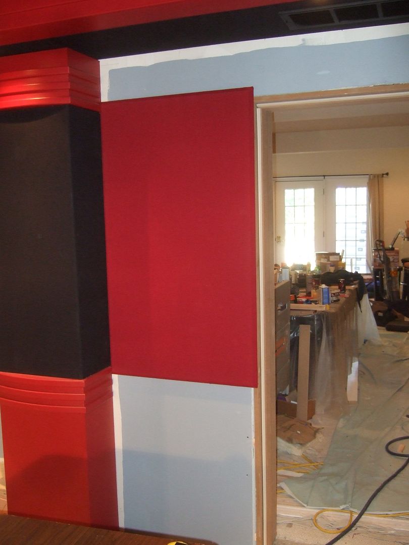

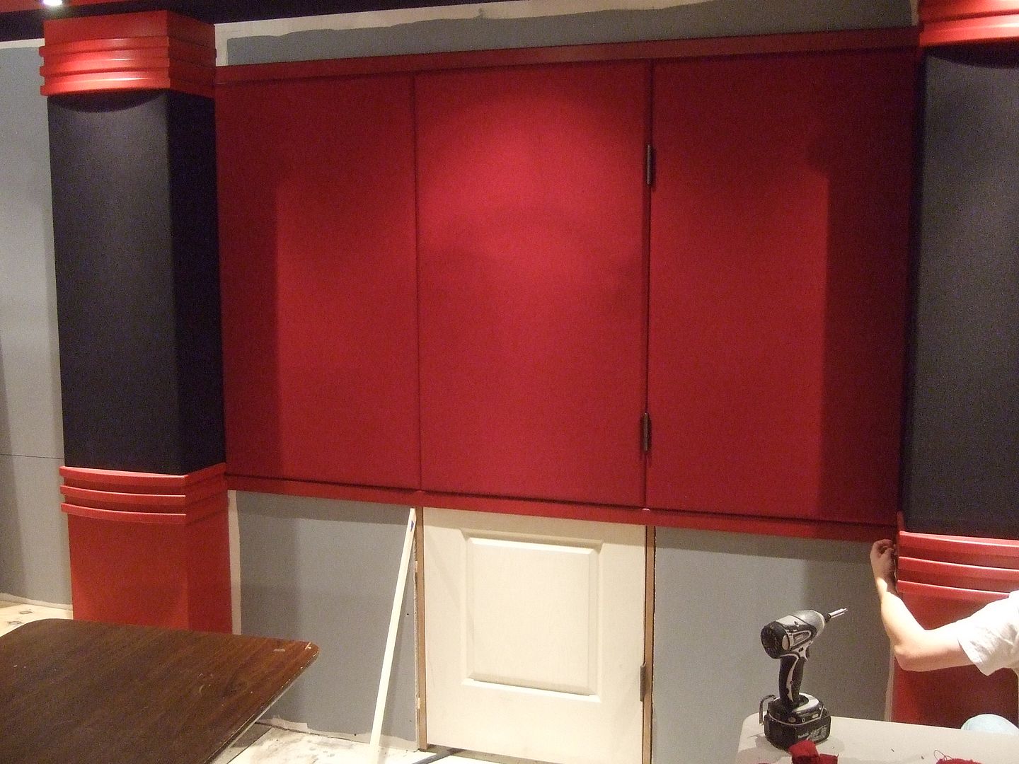

moved to the wall, you can see with fastened 2 inch furring strips to the walls to hold the panels, these were 2x3s cut down and attached with 3 1/2 inch screws.

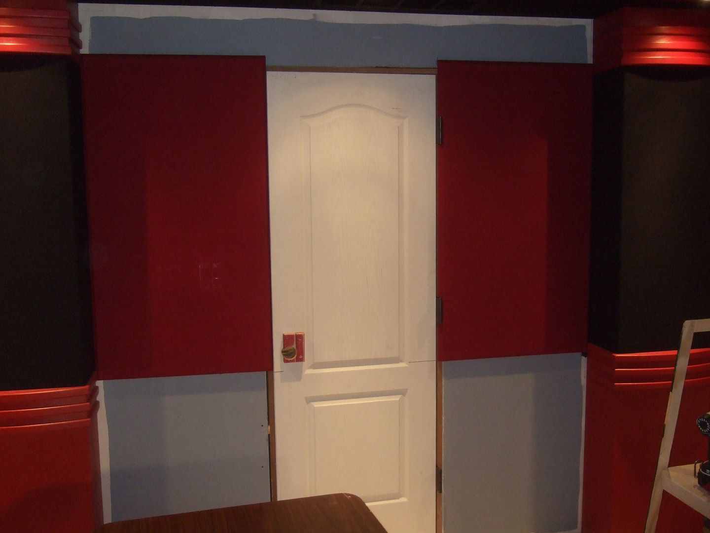

Finally it was time to tackle that door section
to the left of the door
we put the insulation on the wall first
then popped on the frame

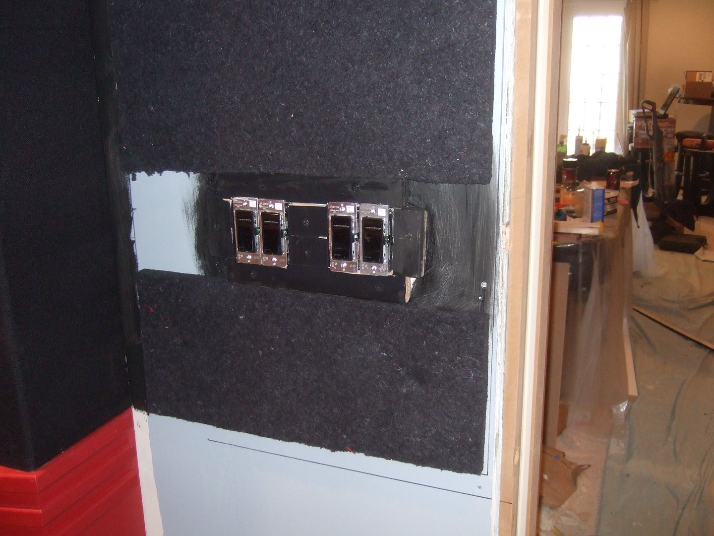

we will still need to staple and cut out for the switches later,
On to the other two sections.

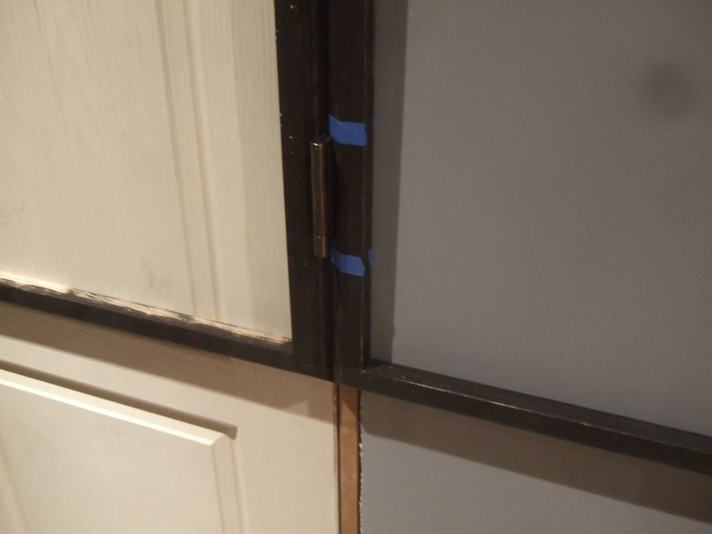

We had these pesky hinges so we needed to add about 3/16 notch in the side of the panels so they would fit nicely.
on with the fabric
Last shot of the panels is a color test of the new paint and panel molding, we like it.

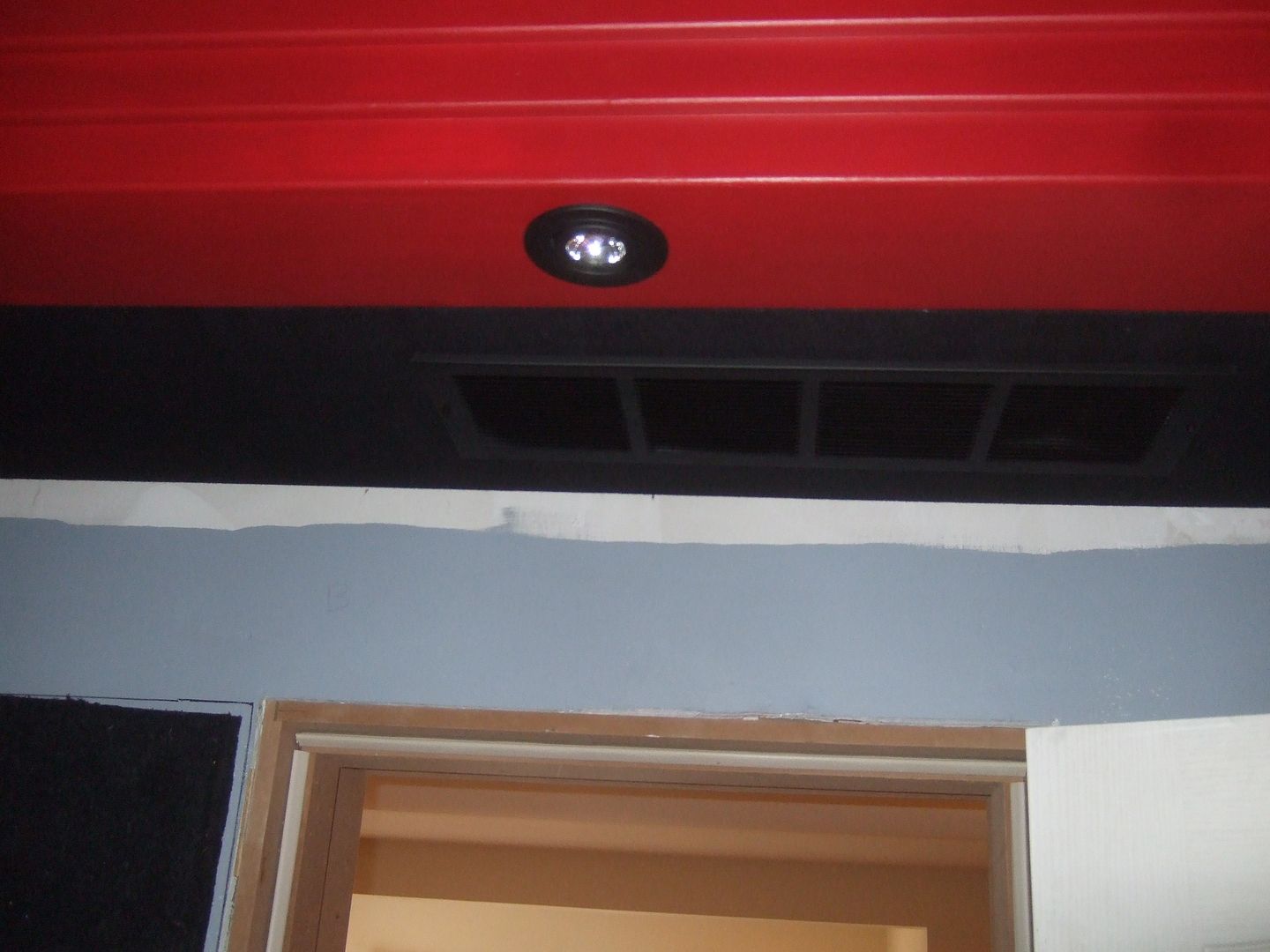

one other housekeeping detail is the air supply grill, 8 x 24 got painted and installed under the soffit.
As it was a ways back, I figured it best to quote the entire post.
At image 10, this is just kraft paper glued to the face of the 703 that is to the room right?
I know you spoke of 4" vs 2" and how Bpape felt about each, Is it my understanding that you went 2" in the end with the 2" air gap? The description below this 10th image stated 2". And so with image 12, that is the back wall and you have 2" furring to which the 2" panel attached, is this accurate?
How were the panels attached to the furring strips, just finish nails and glue again? Also, did the 2" panels with kraft paper face and 2" air gap go floor to ceiling?
Do you know if this back wall design varies by application or is that something that only Bpape can answer for me?

Before any one asks - we are going to be using the Gpowers panel attachment method, glue and hold them in place with a few finish nails through the fabric and frame.
We haven't attached anything yet
When you say this, does that mean the panel is glued directly to the wall and then a finish nail into the drywall?

Liquid nails glue, one finish nail per corner shot through the fabric and frame into the drywall
Except with the back wall. We put 2" furing strips on the back wall and then used to liquid nails/finish nails through the panel into the strips.
On the 1" panels (Sidewalls) we did this directly to the drywall.
The 2" panels presented more of a challenge with the nails we used due to the thickness of the panel frames.
It does vary per application. We even discussed 2" all around (2" back wall and 2" side wall) so depending on your speakers, your dimensions, etc. Bryan, or another treatment professional, would be able to help you with this. Bryan really wanted 4" of treatment on the back wall, but he said 2" of 703 with a 2" gap was 90% as effective as a 4" piece of 703, so it was more cost effective but no necessarily the highest performing solution.

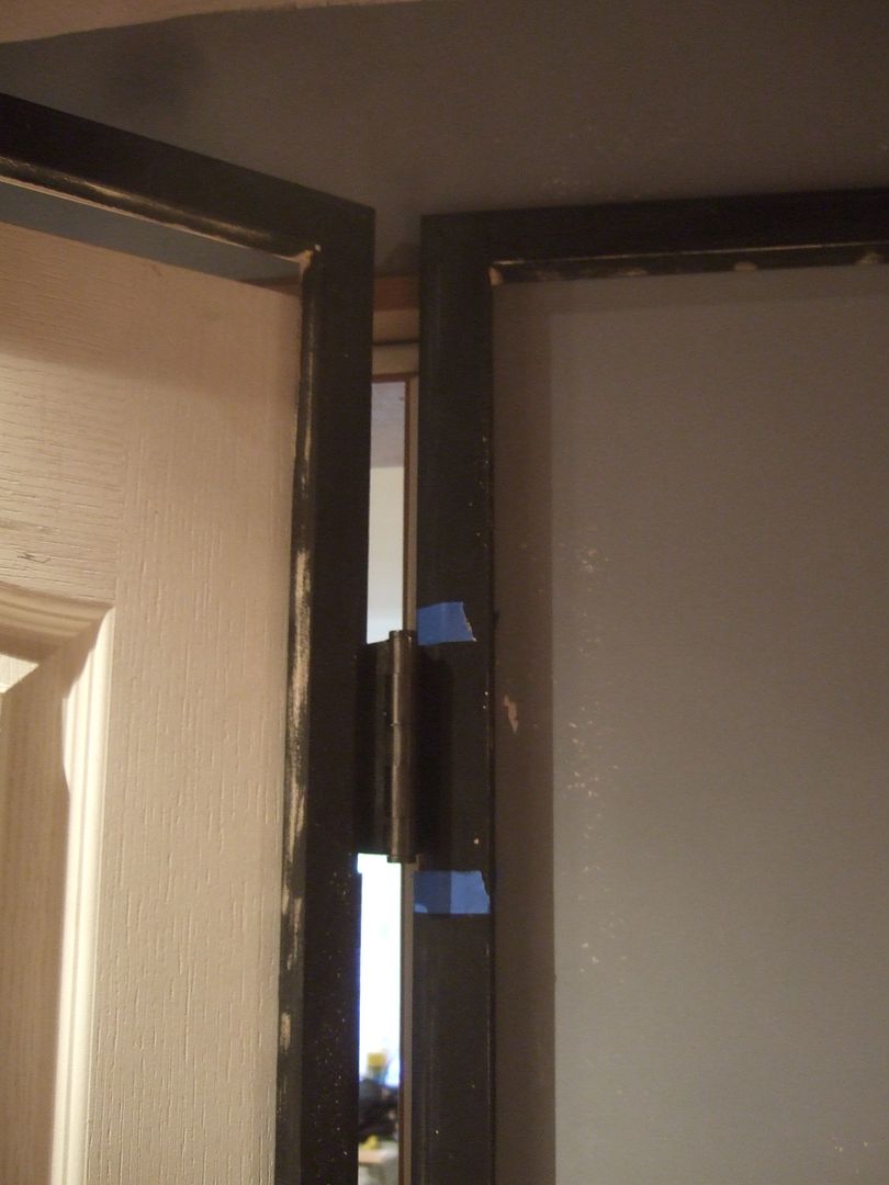

So if I have a thick wall and a thicker than normal door... I want it to be "flush" on the outside of the room and open into the theater, these types of hinges will still work, right? Your picture shows the door opening towards the camera, but also flush on this side. I would like it flush on the other side...
Just thought that I would ask before I drop a chunk of change on door hinges.
nickbuol is offline
post #1124 of 3019 Old 02-13-2012, 06:25 AM - Thread Starter
damelon's Avatar
Location: Woodbridge, VA
Posts: 2,176
Liked: 286
Originally Posted by nickbuol View Post
Amazing how expensive some hinges can be.
The picture above is a great example. You see the hinge sticks out that extra inch because we planned on making the wall an extra inch deeper. In this case the door is flush with the wall.
The door can't be flush on the other side and open inwards if that is what you are asking. (At least not with any normal hinge) Think about how the door-jam is made. It has trim in the center where the door rests against, and there is a mitred in section on the side where the hinge goes in, which always goes to the outside edge. This is so the actual hinge portion always rests outside of the doorjam. Yes, there are doors at places that swing both ways, but they dont use hinges usually. They are on a swivel-pin.
It can be flush on the other side and open outwards. The depth of the hinge matters based on the thickness of the door. Since we were adding another inch of material, we wanted the hinge point to be an inch into the room rather than at the actual doorjam, which is the standard hinge. Bigger hinges are uncommon, like thicker doorknobs, because 99% of the time there is no need for them.
I went back to the materials list and added the links to the doorknob and hinge I purchased by the way

As far as the panels on the side, you said that only the bottom 5' are treated, so the top panels are just basic fabric frames to allow reflection, is that right?
Was that a bpape solution recommendation? I know many often do full treatment, so I wonder what the overall difference is.
Partially true. Only the bottom 5' of the panels along the riser (behind the rear side columns) are treated. In front 2/3 of the sides are floor-to-ceiling treated. The reason for the small gap of untreated area behind the panels in the rear is to allow some reflections from the rear speakers. It makes that area a little more "live".

ceiling molding is just nails, nothing has come loose after 6+ years.
If it was just moulding, sure. But a full panel filled with cotton padding is just a bit heavier, not to mention a single piece!
Every time I see your theater BIG, I think of that secret door on your column where your rack is and get so jealous. I love hidden doors.

I've used long finishing nails (in my air nailer) to hold somewhat lightweight items to drywall before and never had issues. I always fired them in at an angle so that it wasn't as easy for something to work loose over time by simply starting the slide straight down or out.
Something like what is in the above picture, I would have used a couple on each side of the "frames" and either nailed them all inward towards the center, or outward away from the center. That way the nails on one side are prevent the nails on the opposite side from moving.
nickbuol is offline

Each frame was twelve pieces of molding, secured one at a time.
