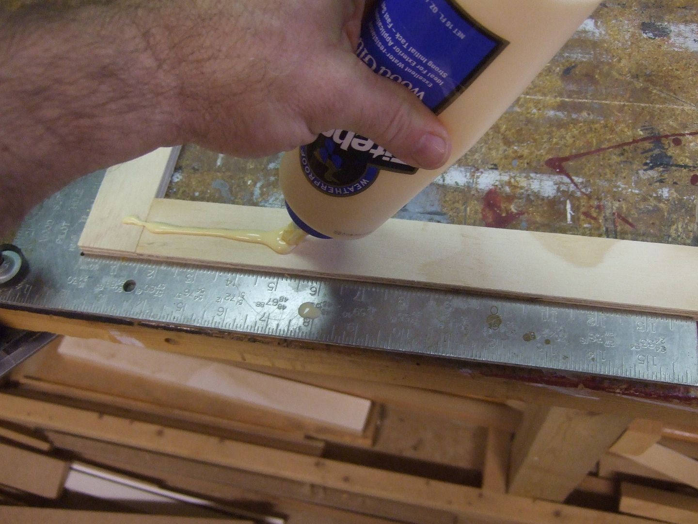

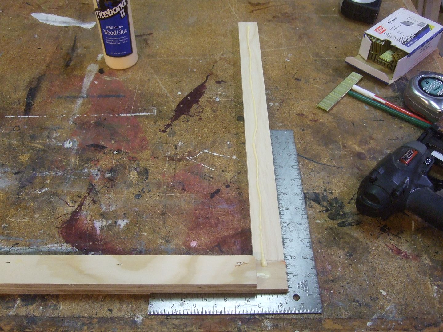

I figure we will need about 200 strips of 1 1/2 x 1/2 inch plywood to make D's fabric frames.
At 30 a sheet that means 7 sheets ripped. First I had Lowe's rip them in half for convenience.
Then on with it
This here is brilliant. As I perused the aisles at Lowes last night, I was not finding the 1/2" long pieces I would use for a frame. The only ones I found were the little 2 footers and everything else was like 1" thick.
I guess now I know, that what I really need is 1/2" thick plywood and then cut that down to 1-1/2" wide pieces...
then, cut to the appropriate lengths and then what, how do you secure the 4 pieces together, in order to get the 2" thick frame, just wood glue, stack and a few finish nails?
Lastly, what is the best method for securing the 4 frame members? Do you cut them at an angle at the ends to connect or do you secure them on the square(?) ?
smakovits is offline
post #1144 of 3016 Old 02-16-2012, 12:38 PM - Thread Starter
damelon's Avatar
Location: Woodbridge, VA
Posts: 2,162
Liked: 275

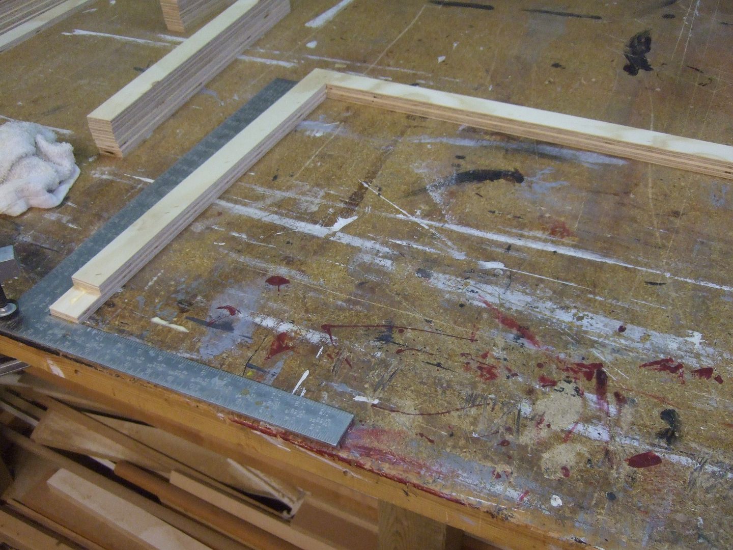

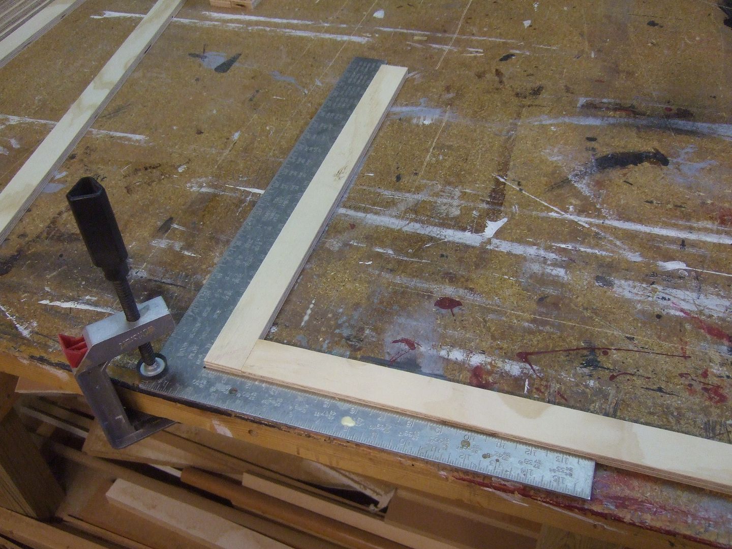

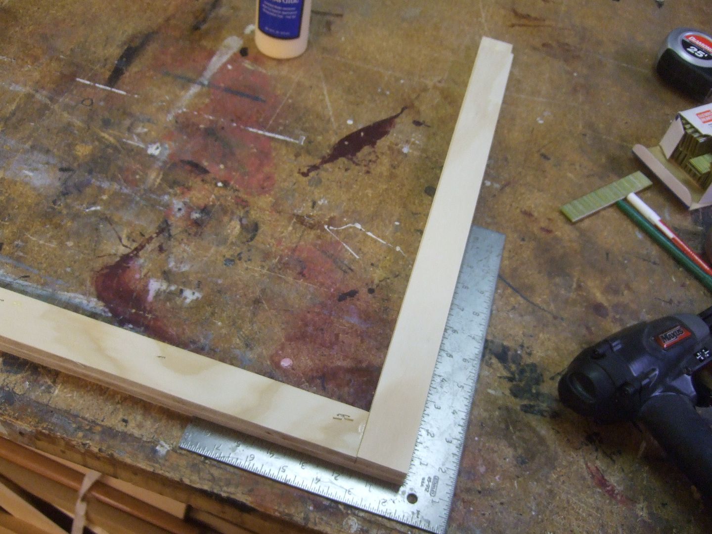

To be honest I don't remember if we used staples or not on the junctions or not, but it IS a lot of glue.
Don't use angles! You want to do it square, and on top of that, alternate the lengths so they overlap.
Say your total frame is 4' by 2'. All of your strips are 1 1/2" wide and 1/2" thick.
First lay down 2 strips which are 4' long. Then two that are 1' 9" long between them, making a square.
Cover them all with glue.
Then your next layer would have 2 pieces which are 3' 9" long, and 2 pieces which are 2' long.
Press them together.
Then there are 8 different places where pieces join (per layer) in your whole frame, but all 8 of them are in different places than the other layer.
Once you have them together and the glue has dried you can run them through a router to put angles on them.

When gluing the layers, did you guys do any clamping?
Do you wait for them to dry between layers?
I assume the key if I do fire a finish nail through the layers is to put it in a spot I wont hit with the saw...

Lastly, what is the best method for securing the 4 frame members? Do you cut them at an angle at the ends to connect or do you secure them on the square ?
Cut all you pieces 1 1/2 inches short of your desired finished panel dimensions then just overlap. I used 7/8 inch long 1/4 inch crown staples. The stapler in the picture went to the landfill, I spent more time clearing a jamb than stapling, The Rigid brand stapler has been jamb free.

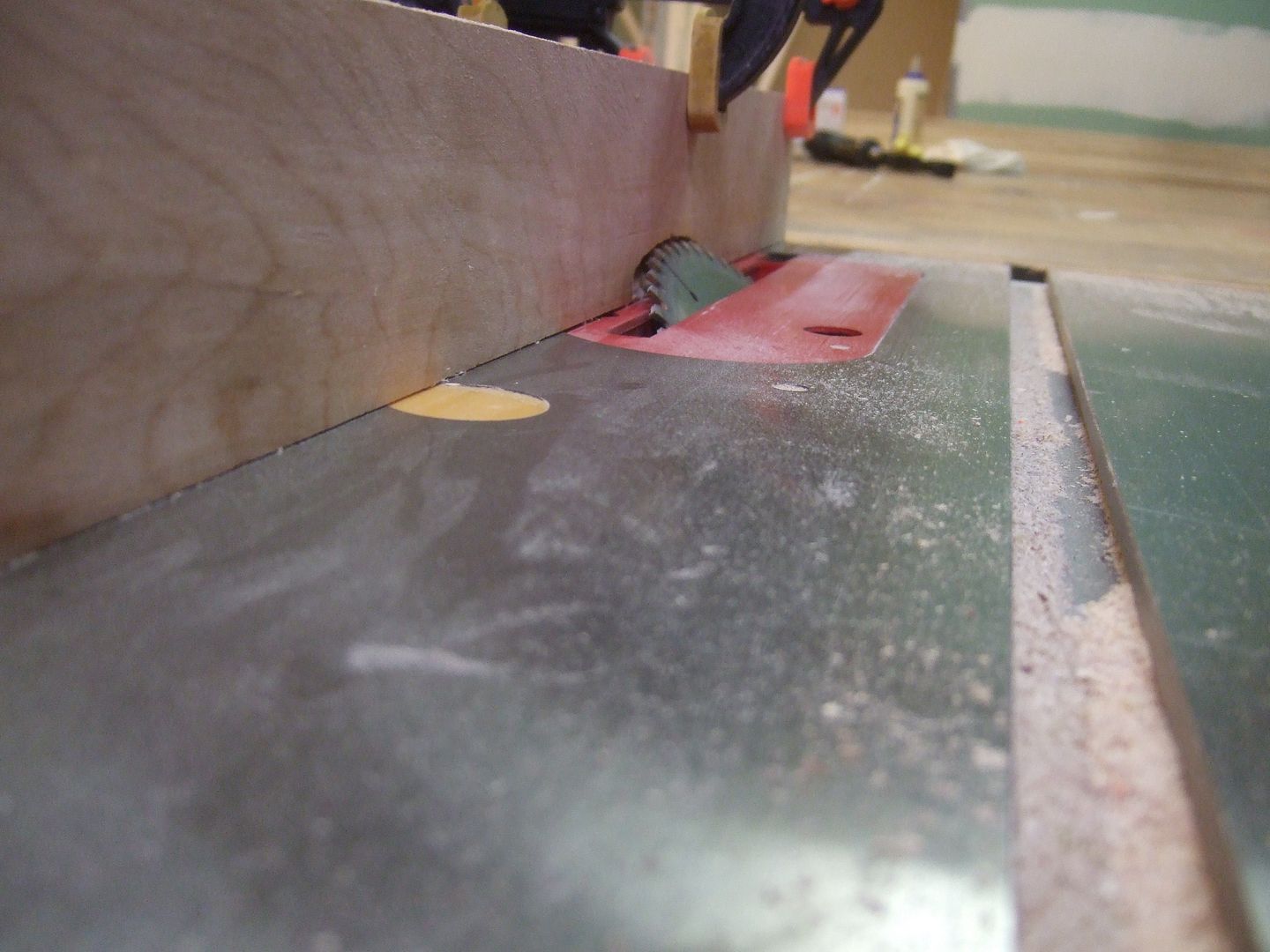

Big, just curious, why was the bevel cut the worst part?

look at the saw set up, it is exactly what they tell you not to do. It you do this never stand behind the blade, I had a few projectiles smacked against the wall.
I imagine you could do this with the right router blade.
With the frames you guys made, what router bit would give the same results?
FREUD 45° X 1-3/4 In. Chamfer Bit?

Chase I remember measuring the face of the chamfer and it was once inch. so anything slightly larger and up. I would imagine that you would really need a router table. This is the table I have and it is pretty sturdy. I just bought the top with the plastic insert. I set it up on the gap between my table saw and out feed table when I want to use it.

I gots no router table, so it appears I have to go the "fun" route. Nothing like BIG getting me all nervous. I just got the table saw and now I am afraid to use the thing. Heck, the thing has yet to be turned on, all I did was put it together.
If it bothers you too much, you could build a jig to hold the frame at a 45-degree angle and keep the blade at 90-degrees.
Be careful where you put the brads when you're assembling the frames. You want to try to keep the brads out of the area where the bevel will be cut.
Yes, I managed to generate a few sparks, If you have a really expensive blade on your table saw you may want to swap it out for a "disposable" blade for this project.

Or just a larger table and fence system for a right tilt saw. Some of the panels on this project were pretty long, so a saw with a large capacity fence or sliding panel cutting jig is required.
were any of them larger than the 2x4 mentioned? Or is 4 feet a long way?
