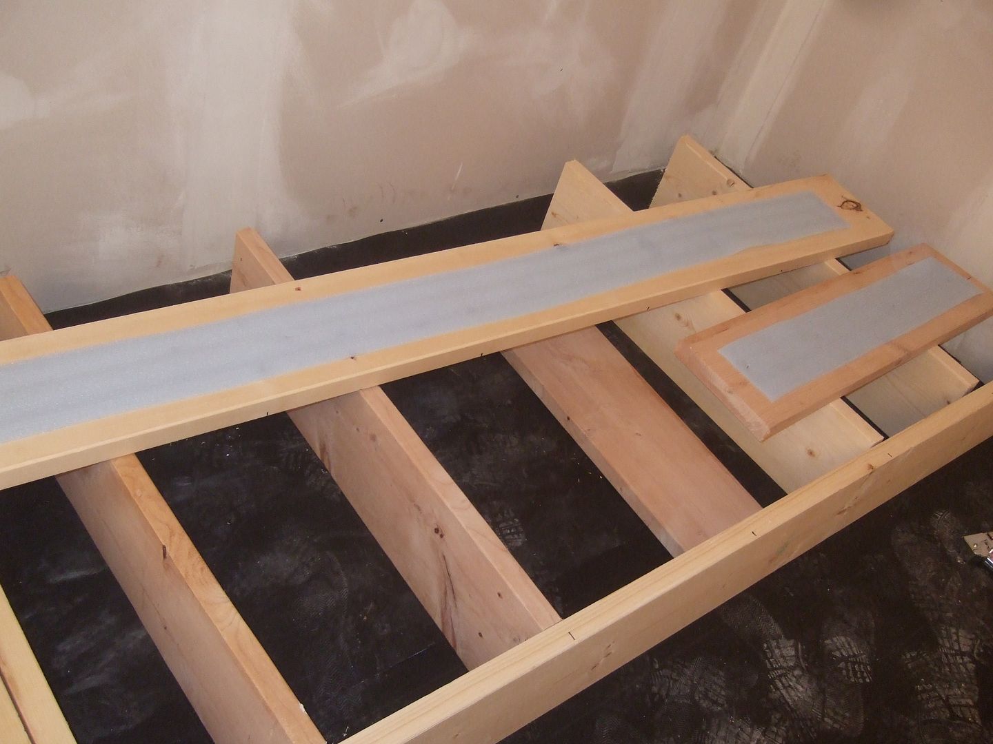

Begin saturday work! Here is some pics of our lumber for riser/stage!
Riser: Under construction

First we had some plans.
Riser
Stage
So we hopped into my 20 year old pickup (80K miles) and went to Lowe's
There on aisle 17 we picked up a stage and riser.
If filled 3 carts, Damelon up in front I'm pushing from the back. At this point I was thinking "Some Assembly may be required". If you look closely you will notice we were able to buy 3/8 inch pre-curved plywood stage fronts, this saves a lot of time trying to curve then yourself.
It fits!
I need to document that our trip to Lowe's took 3 hours, I think we were having wood cut for 2 of the 3 hours. Then there was the KFC drive thru window where we picked up some sandwiches.
We got a good portion of the riser cut and assembled
We got the stage framed
During the cleanup of the room at the end of the day I decided to finally try one of the tricks of pulling cable in a conduit
Tied a 7-11 bag on some nylon cord, one of the helpers held the vacuum hose to the projector conduit and I positioned the bag at the other end and before I could say "here it comes", the vacuum ate the bag and string.
Tomorrow we hope to get the decking on. That all depends on how fast Damelon can haul sand.

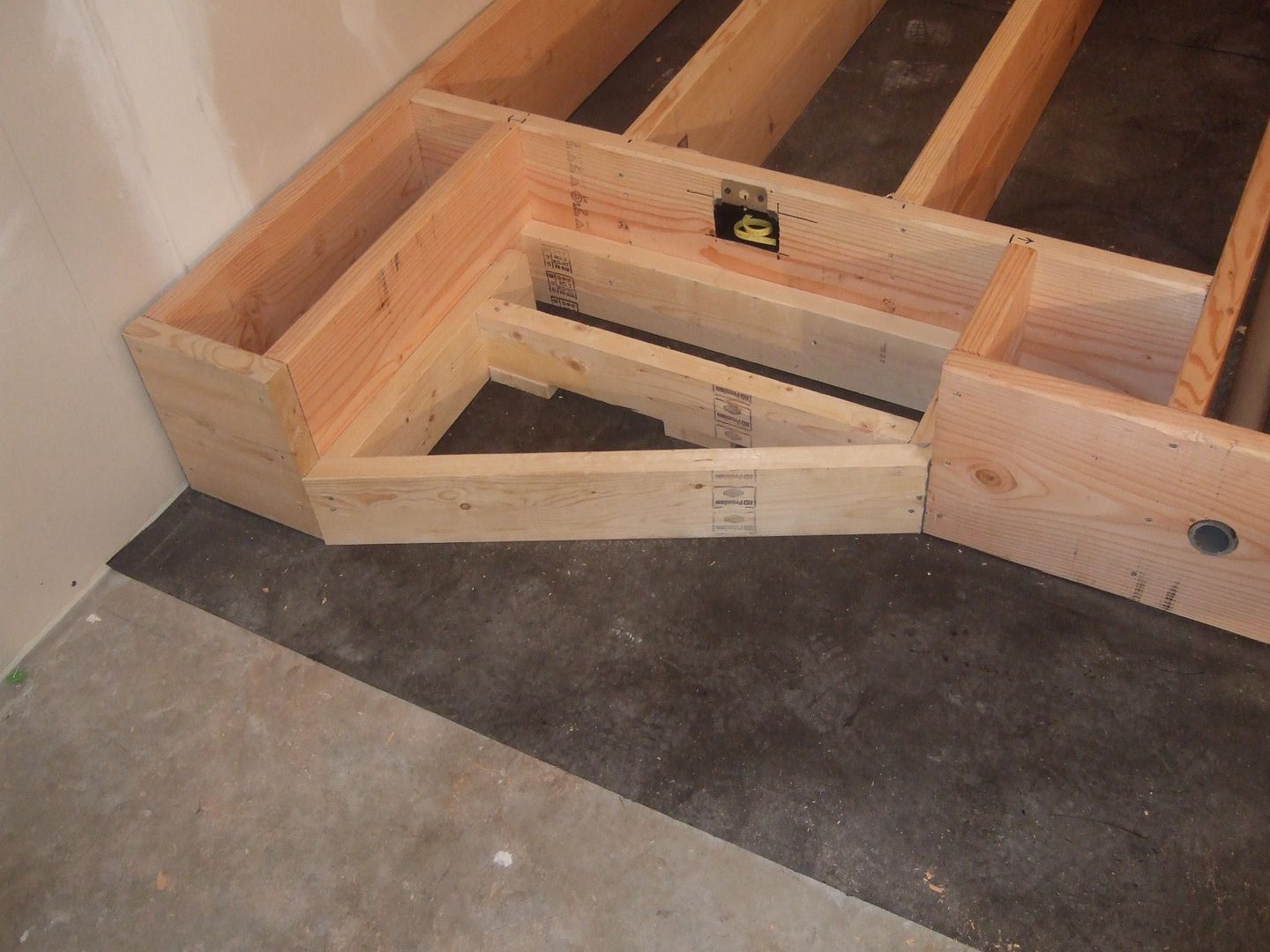

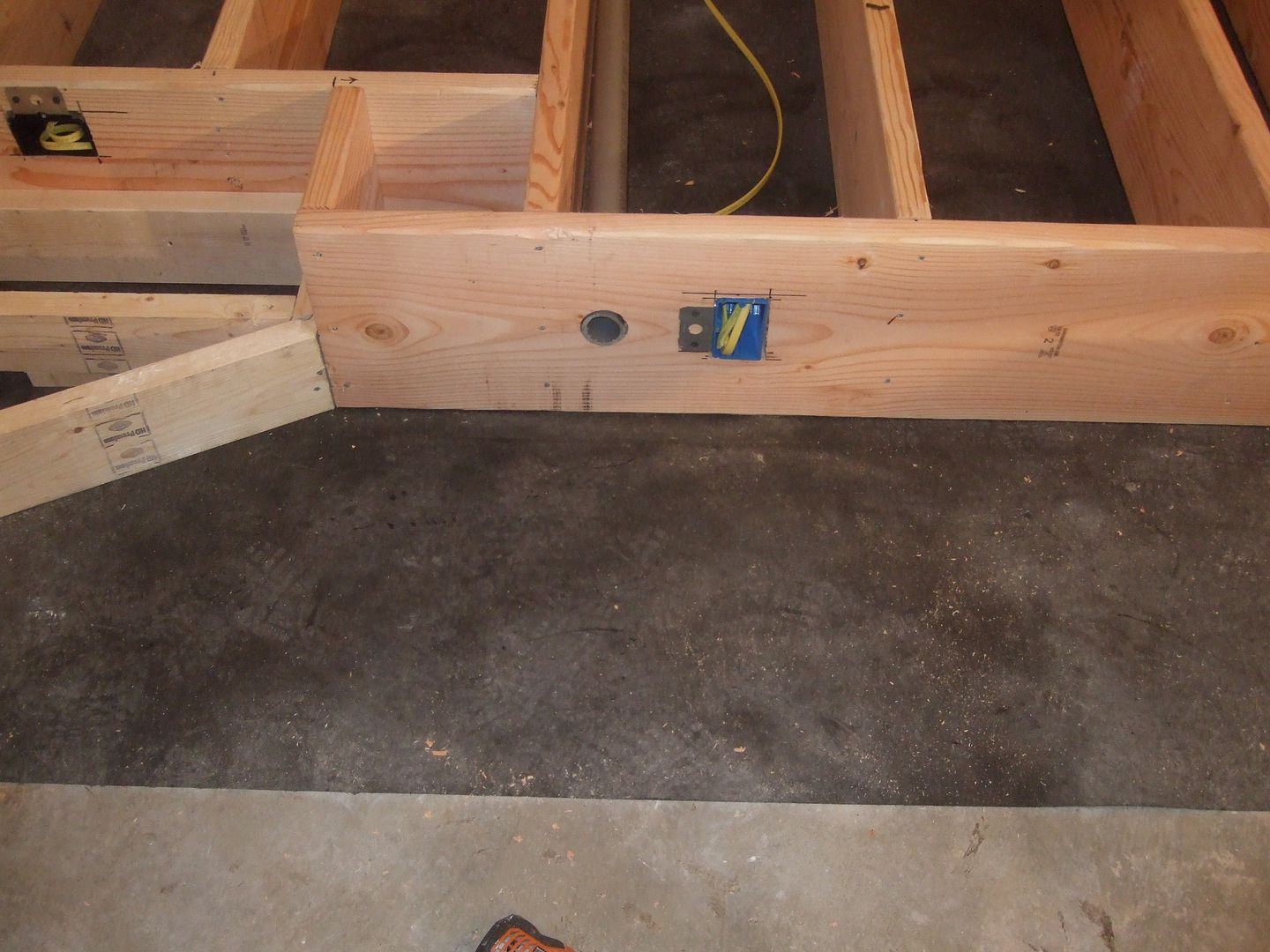

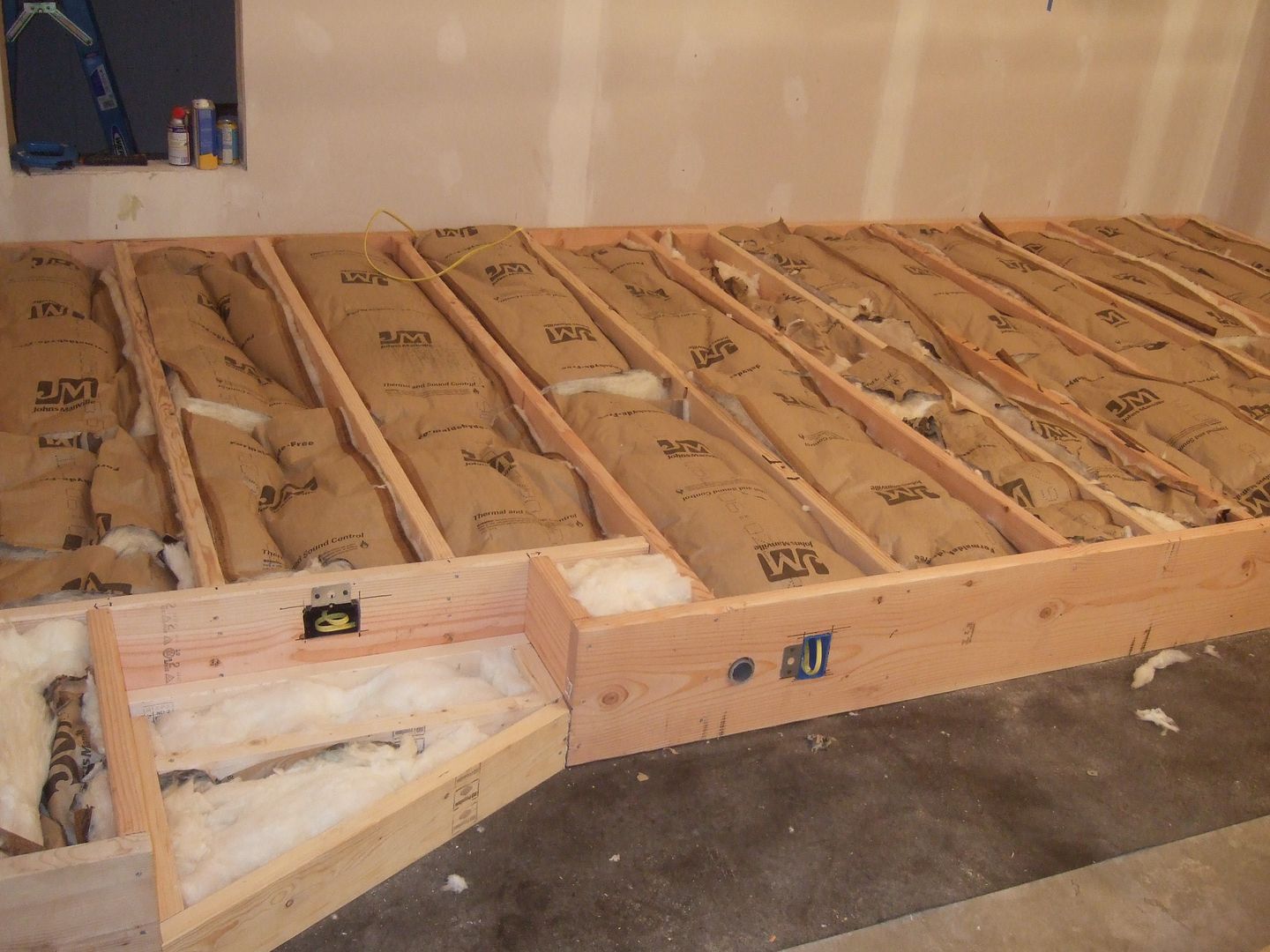

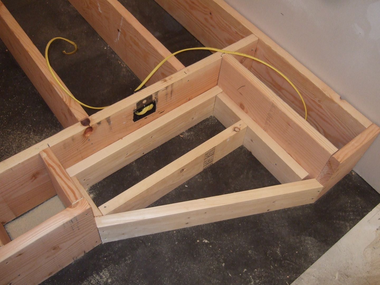

From BIG's post above (With pictures) :
A little bit of pictures from Sunday
First we finished framing in the steps for the riser, adding the electrical boxes, and pulling in the wiring.
First the left. We used adjustable depth boxes because they mount easily to the front of the 2x12s and they can be adjusted for the final depth of the carpet. Did run short of lumber and had to improvise with some spacers.
One on the right
Then put an outlet on the front of the riser for either powered seats or electronic gear. We also ran a 1 1/2 inch conduit from the front of the riser to the equipment room. Damelon expects to use His Laptop and other gear on the sofa and wants a hard wired connection to his network. Notice we didn't center it up but rather put to one side where it will be easier to reach behind the seating and plug something in.
Then while Damelon was hauling the good stuff, I was stuffing the riser with fiberglass. As my Mom used to say, as snug as a bug in a rug.
We also got the two layers of 3/4 inch plywood sheathing on top, first layer 100% screwed down, second is in progress, pictures of that will come later when I cut the lip. We did put some 30 lb roofing felt between layers.

Forgot I had a picture of this, These were the pieces cut for the stage before assembly. Damelon tacked on the foam

Sand in the stage will be done today. Have BIG penciled in to come finish the stage and riser plywood cutting and routing tomorrow.
Next will be the soffit. I've got to get my linear grilles ordered for the hvac ducting.
BIG's post below with images:
Well today we made it purty. I met with Damelon in the AM and he went to work, When he got back I was just cleaning up and he manned the vacuum.
Riser, When I left Damelon's on Sunday the first layer of decking had been screwed down, a layer of roofing felt and the second layer was just tacked down on the front edge. So I finished screwing the second layer then cut the 1 1/2 inch lip. I also rounded over the edge with a router to make the carpet wrap better. Since a decision was made to go with a single layer step I added a 2x2 extension lip so the step edge will match all the others in the theater.
Pictures:
Yes Damelon is planning the next steps, those blue tape marks are tentative column locations.
OK, now the other side of the room
Earlier this week Damelon had a helper fill all the tall sections of the stage with sand. Each section lined with 3mil plastic. Here is how it looked this AM.
I added a layer of 3/4 plywood and roofing felt.
Then another layer of 3/4. Then I scribed the curve and straight cuts and went after it. It was at this point the the stars lined up and when I finished cutting away the excess, it fell down and fit the first step perfectly. I actually stared at it a minute because I thought I was going to start from scratch cutting wood for the step. Instead I could use what fell into place with just an additional piece in the middle.
What fell on the right
On the left
Before I buttoned it up I stuffed the cavities
GOT STAGE!
