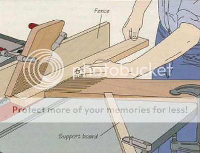

Since you had the pieces cut down to size already, you might consider making a feather board to help with this. Pretty straightforward, and you can usually make one out of leftovers you have lying around. It would help to maintain a constant pressure on the sheet as it's moving through the blade.
Edit: Here's a pic in case it helps.

with the feather board would I essentially cut everything to just over my wanted size and then go back with the feather board to slide each piece one last time to ensure the perfect cut? I ask because my sheets are 2' wide and I slide it through like 12-14 times, each time it gets smaller, so the feather board does not seem practical unless each cut is on the same size board, hence a rough 1-2/3" cut then send em through for the final...
just thinking aloud, I have no idea, just trying to learn and understand. Thanks!
I didn't think about the number of times you were cutting that sheet down. I guess it would depend on just how accurate your cuts are as to whether it's worth trying to do a rough cut and then a final. the idea was to keep you from having to worry with applying as much pressure against your fence.
It's a pretty dangerous situation if you're concerned about tipping your saw over. These things are dangerous enough under good circumstances. They don't anything to make it worse.
