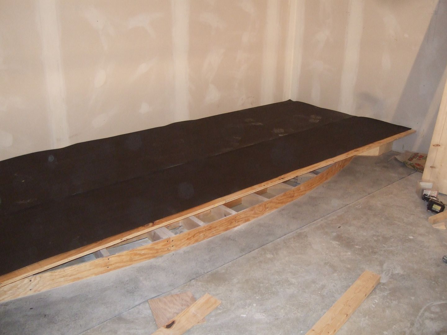

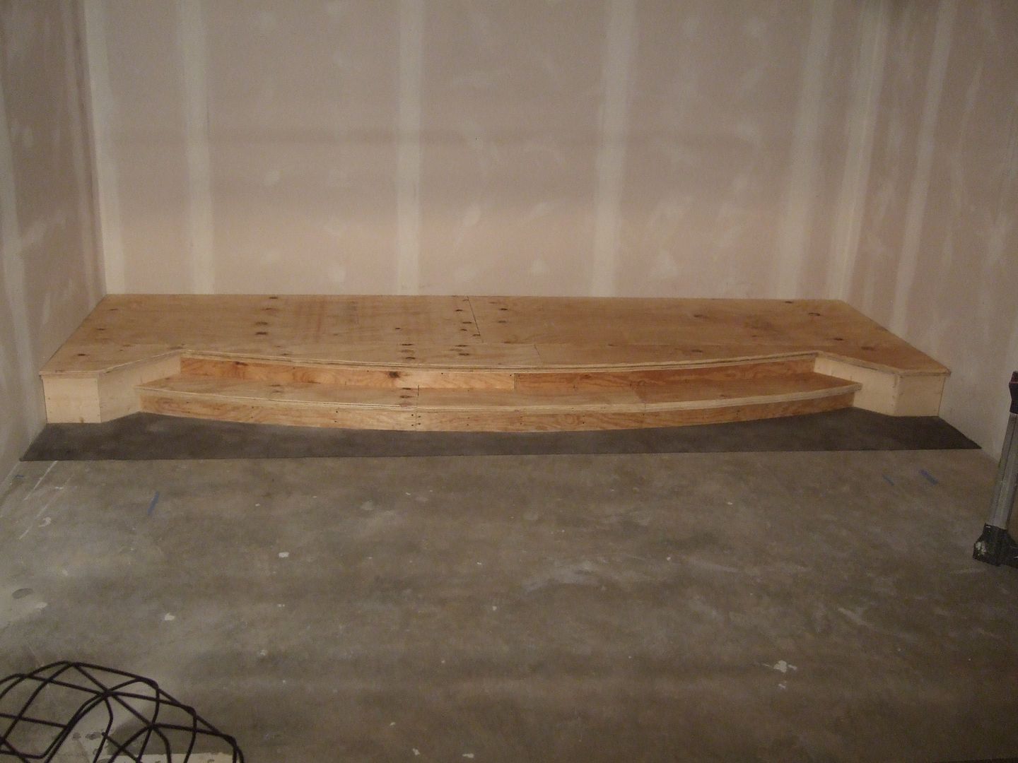

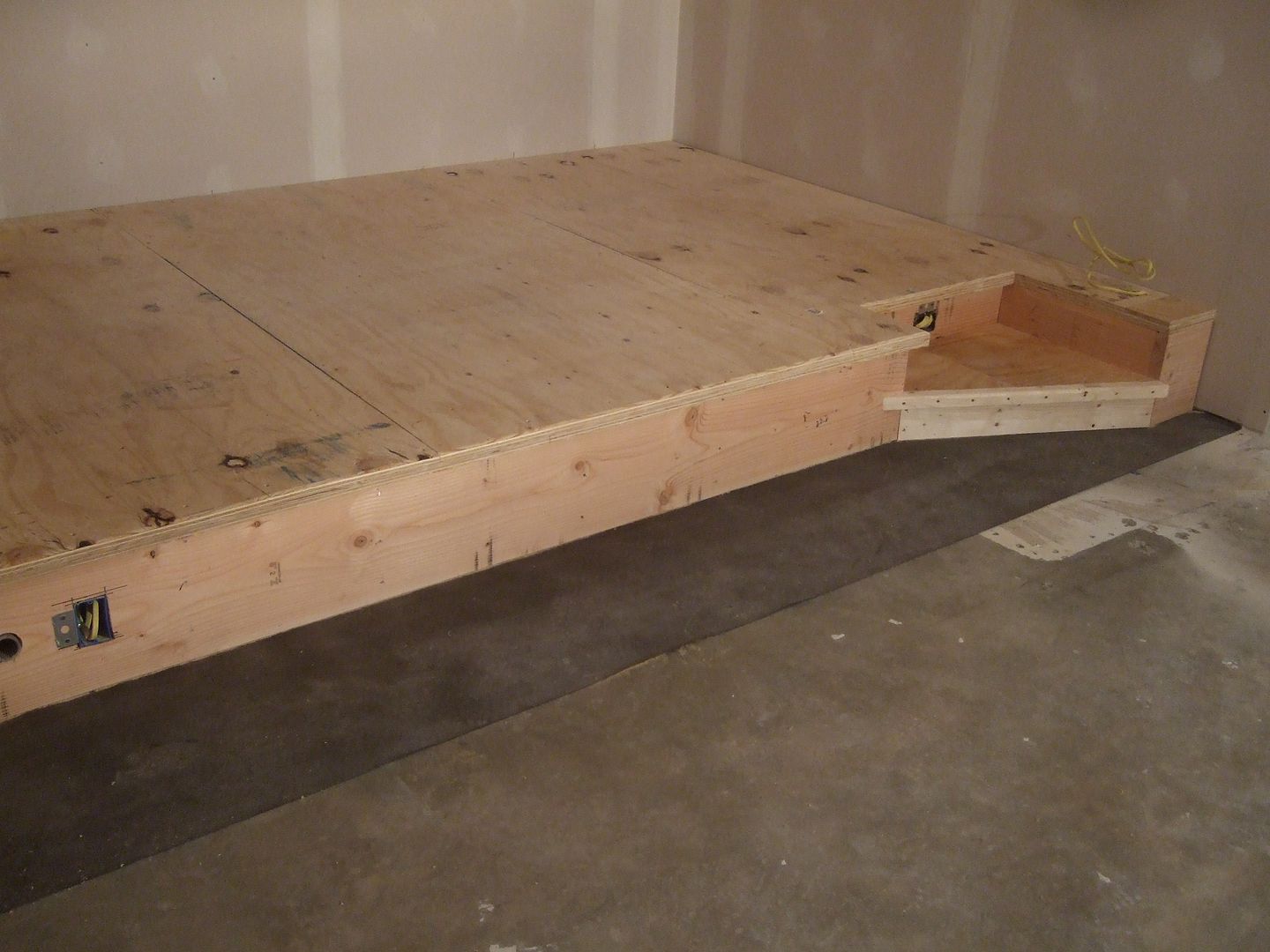

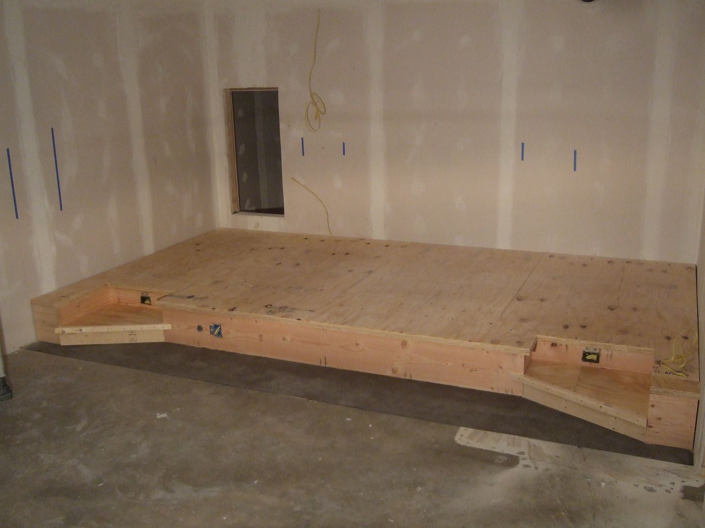

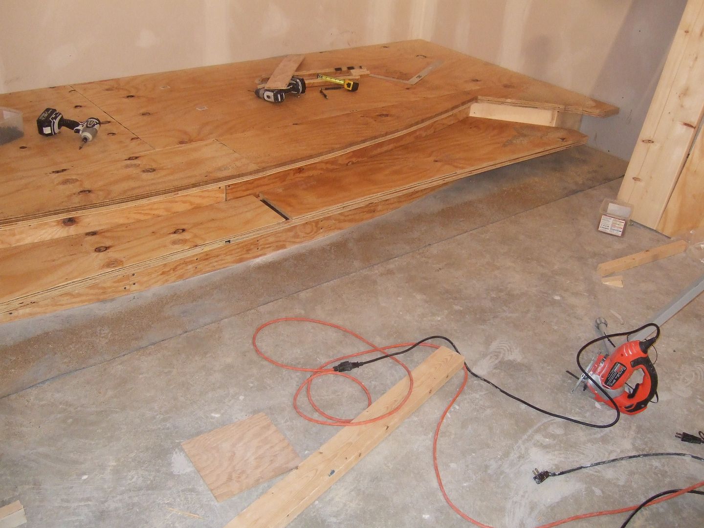

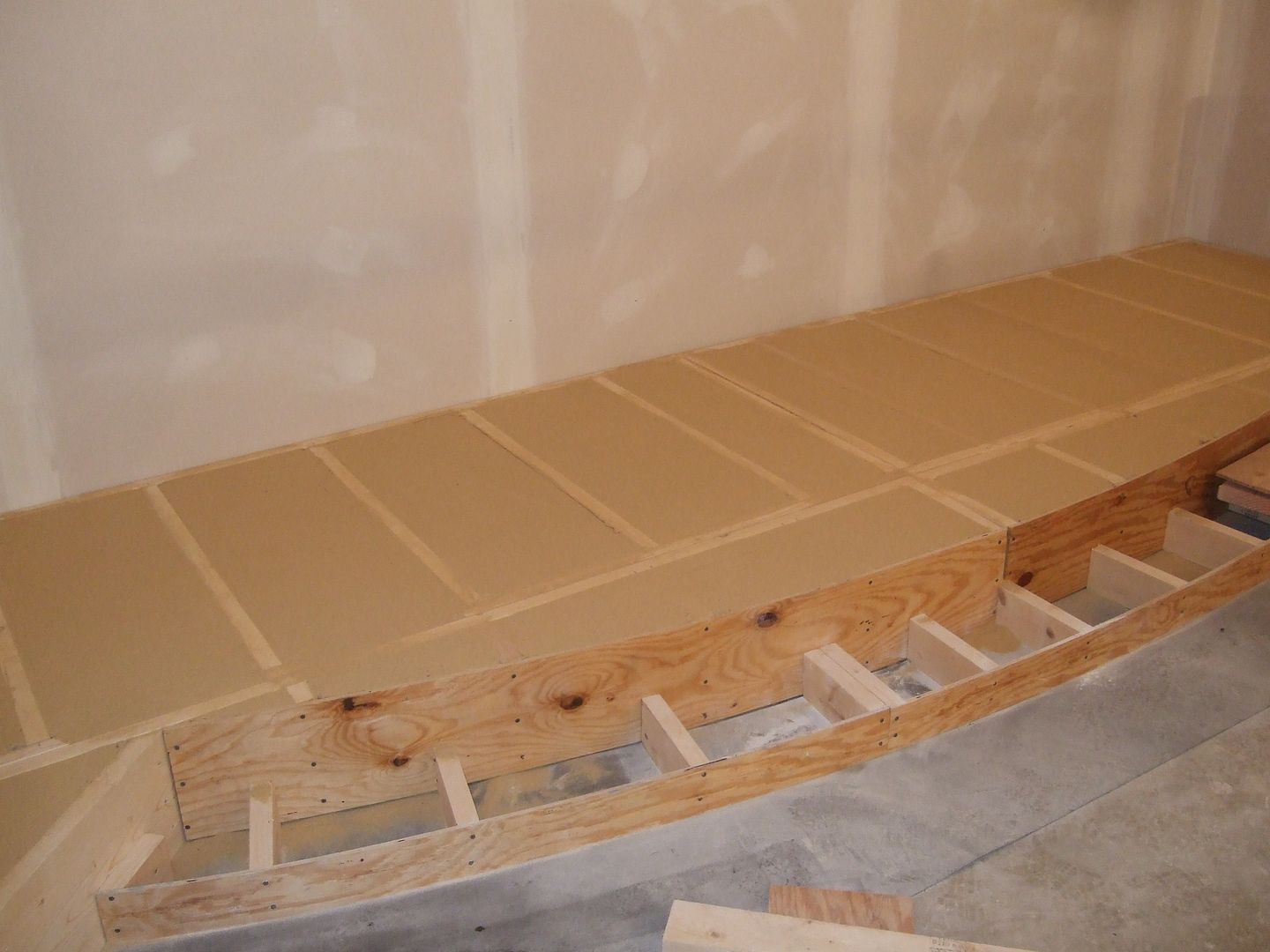

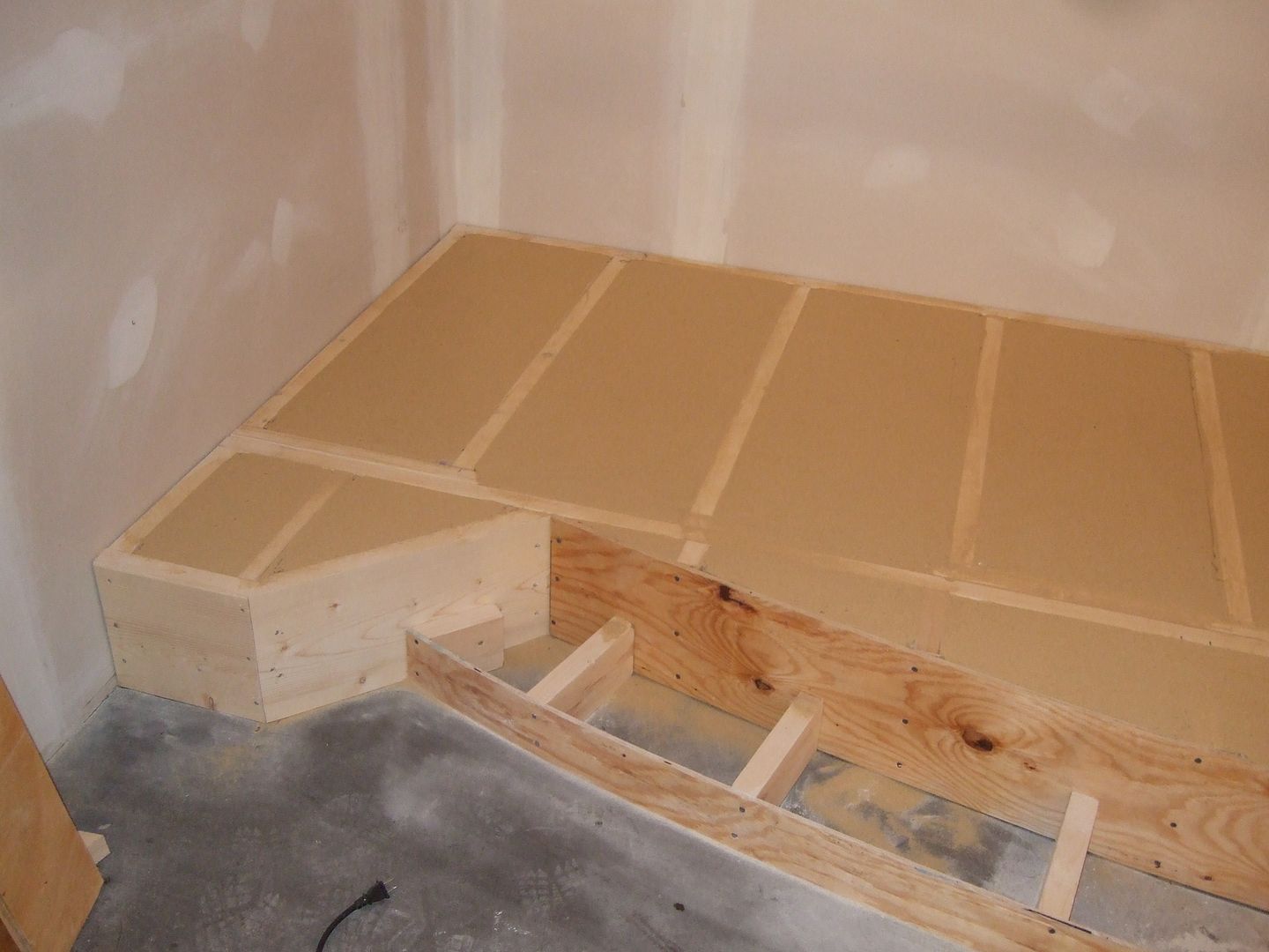

Well today we made it purty. I met with Damelon in the AM and he went to work, When he got back I was just cleaning up and he manned the vacuum.
Riser, When I left Damelon's on Sunday the first layer of decking had been screwed down, a layer of roofing felt and the second layer was just tacked down on the front edge. So I finished screwing the second layer then cut the 1 1/2 inch lip. I also rounded over the edge with a router to make the carpet wrap better. Since a decision was made to go with a single layer step I added a 2x2 extension lip so the step edge will match all the others in the theater.
Pictures:
Yes Damelon is planning the next steps, those blue tape marks are tentative column locations.

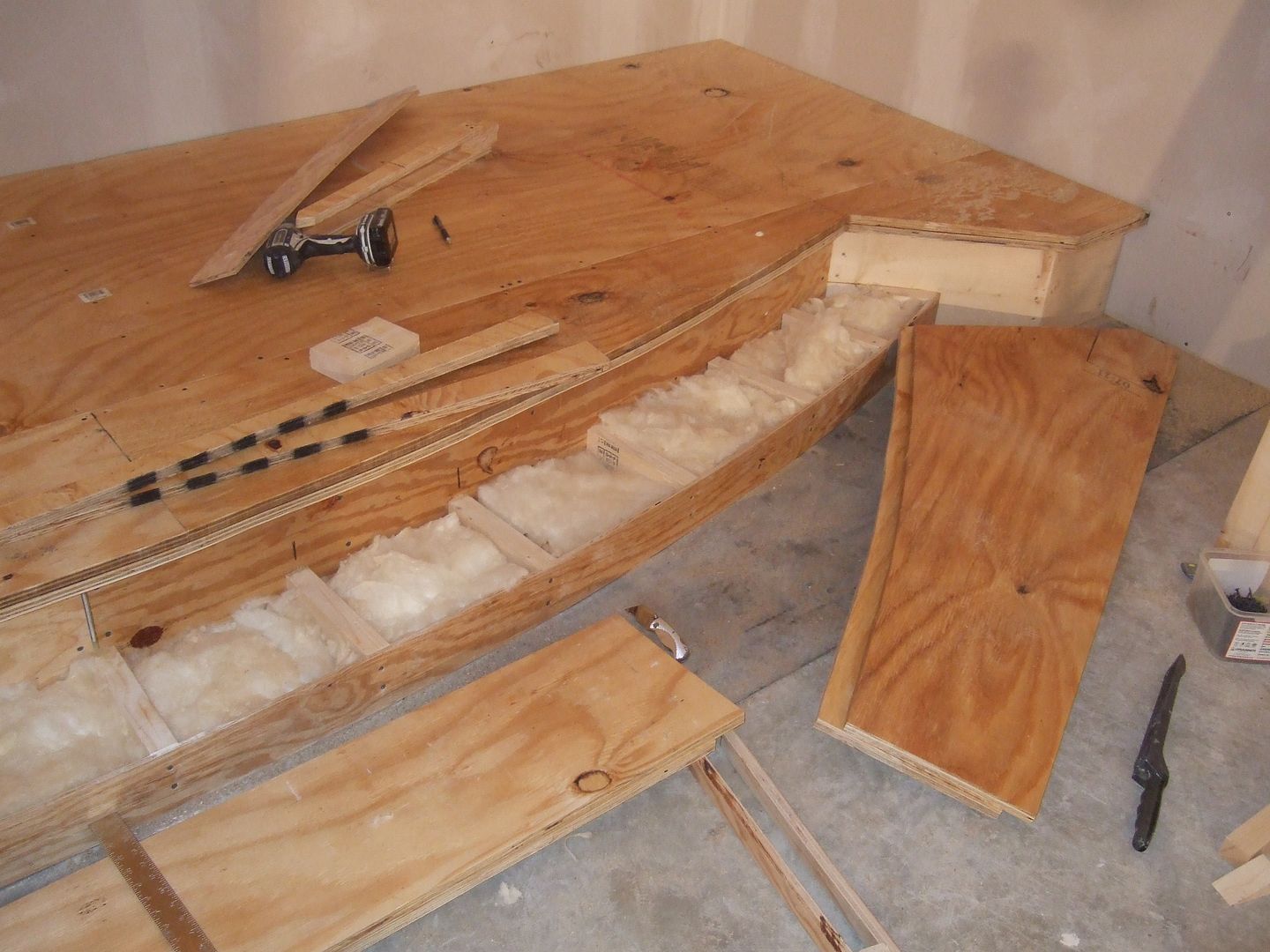

OK, now the other side of the room
Earlier this week Damelon had a helper fill all the tall sections of the stage with sand. Each section lined with 3mil plastic. Here is how it looked this AM.

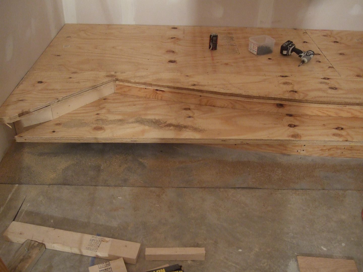

I added a layer of 3/4 plywood and roofing felt.
Then another layer of 3/4. Then I scribed the curve and straight cuts and went after it. It was at this point the the stars lined up and when I finished cutting away the excess, it fell down and fit the first step perfectly. I actually stared at it a minute because I thought I was going to start from scratch cutting wood for the step. Instead I could use what fell into place with just an additional piece in the middle.
What fell on the right
On the left
Before I buttoned it up I stuffed the cavities

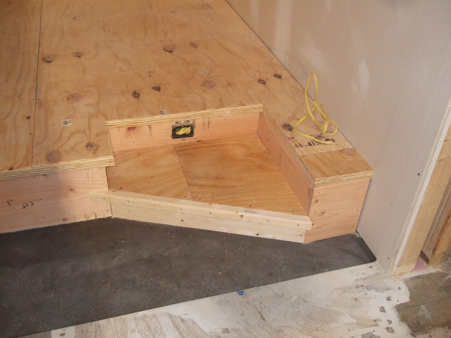

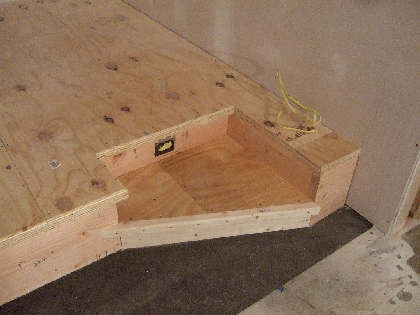

GOT STAGE!
Looks like the outlet boxes in the riser are flush with the lumber. What allowance is needed for the carpet?
DIYHomeTheater is offline
post #1244 of 3016 Old 03-02-2012, 05:13 PM
Posts: 27,706
Mentioned: 238 Post(s)
Tagged: 4 Thread(s)
Quoted: 3654 Post(s)
Liked: 3104
they are the Carlon adjustable depth boxes mounted to the face of the steps. Once the carpet is installed you can pull them out (by turning a screw) to what ever height works best. You need to do a little surgery on the metal bracket that comes with the box. Then you can simply screw to the face of the step.
