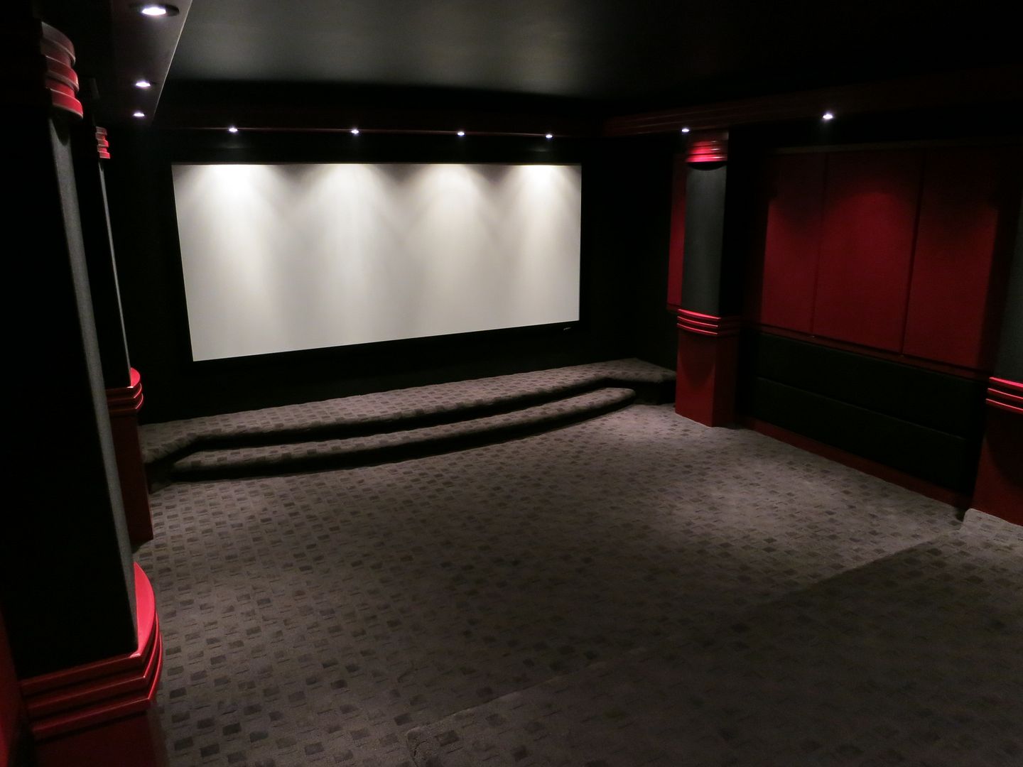

Closeup of Light Switches and Doorknob
Any reason why you didn't go with a grafik eye setup besides maybe cost?
Chase "Fetch"
Old Theater Build
New House Build
cdika17 is offline
post #1270 of 3019 Old 03-20-2012, 05:03 PM - Thread Starter
damelon's Avatar
Location: Woodbridge, VA
Posts: 2,176
Liked: 286
Well cost definitely. That and need. I just didn't need it. I can RF remote the lights if I need to, but I rarely ever even need that. I just turn on the lights when we go in the room, and turn them off when the movie is ready to start and sit down. I guess I never understood the point of advanced lighting macros for a movie room. Wasn't something I ever really cared that much about.
damelon is offline
What do you have wired to the switches? I see 4 switches, that mean there are 4 zones? Whats on each zone?
Chase "Fetch"
Old Theater Build
New House Build
cdika17 is offline
post #1274 of 3019 Old 03-20-2012, 07:04 PM - Thread Starter
damelon's Avatar
Posts: 2,176
Liked: 286
Thanks for pointing out the cost breakdown cdika! I was ready to post a link when I saw your post. I tried to make that in the first place so people could look it up but I guess it does get lost in the middle of the thread.
1) Side and Rear soffit lights
2) Stage soffit Lights
3) Ceiling Rope-Lights
4) Riser step-lights
And to be honest, I am not thrilled with those step lights. I may switch them out. They don't put out enough light to really even see that they're there. Needs to be a little brighter.
damelon is offline

So looks like the plan is that on the wall exterior to the movie room we are going to put a stone veneer and sconces. So the entryway will need to be finished up (Painted). This will also mesh into the bar area behind the theater, but I'm not sure on the timetable as we are looking to do a lot of outdoor work like patio, pool, hot tub, etc. My wife will be the driving force on priority there as I'm sure we can't do it all at once. Still, I will provide photos and updates once any of that happens, even though it isn't technically part of the theater.
damelon is offline

Originally Posted by DIYHomeTheater View Post
I don't see any electrical outlets along the walls. Are there any?
Sides of columns, usually on the side you can't easily see. Front wall behind the screen wall, Front of riser. Plenty. Most of the wiring was done inside the room and traveled around the room inside the soffits minimizing wall penetrations.
here is a pic of the front column.
post #1289 of 3019 Old 03-24-2012, 04:30 PM
DIYHomeTheater's Avatar
Location: Northern Virginia
Posts: 341
Thanks. So, no electrical boxes where you have fabric covered walls?
DIYHomeTheater is offline
post #1290 of 3019 Old 03-24-2012, 04:40 PM
Posts: 28,142
Mentioned: 266 Post(s)
Tagged: 5 Thread(s)
Quoted: 3897 Post(s)
Liked: 3331
in this case but there is an example of an outlet on a 1 inch thick fabric wall on the Black Cat theater thread. You build a furring frame surrounding the outlet, staple the fabric, cut a hole for the receptacle, You need to pull the receptacle out flush with extra long screws, The cover plate covers the staples. Make sure you know how big it is and where you can staple.
