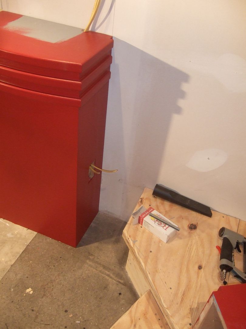

COLUMN BUILDING DETAILS
Recalling an earlier post the columns were inspired by Sandman's original round columns. So the question was without buying half round plywood forms like Ruben, what could we do to create some roundness and strong horizontal lines like Ruben's grooves.
Here is the idea Damelon and I came up with:
A three part column with rounded out trim above and below the speaker area. The speaker area will covered with black GOM FR701.
I built a prototype of the round out area to test the look and materials
Damelon said go
First up was a cutting a bunch of wood for the square box parts. Just 4 sided boxes, no internal bracing necessary, all butt joints.
Then we needed to add a rounded bump out so I needed a bunch of round pieces.
I built a jig to do this.
Mounted a jig saw on a scrap piece of Pergo with double sided carpet seam tape.
I calculated that the radius should be 29.75 inches to get the amount of curve over a 18 inch width. So the distance from the blade to the screw pivot point is 29.75.
Then I mounted the Pergo swing arm on a little Jig
It had a shelf to rest the MDF to be cut
And I cut 36 of these guys
The round outs on the columns consist of three of these pieces glued and nailed to the face of the square column faces. Then I covered the three supports with a piece of wall paneling. It is that faux wood paneling they sell at HD cut into 6 inch strips and just used upside down. The backs actually have a nice smooth finish.
Then I added matching pieces on the sides, you can almost see in this picture:
If you look you can see the base of the column that sits on and off the riser. Had to make the base of those columns at three levels to fit.
Next I needed the bump out trim bits. I wanted something about 3/8 x 1 1/4. Of course there wasn't anything on the shelf that size so I cut down 1x2s to size. I used Tuf Board that they sell at HD. I think it is a mixture of PVC and wood dust. An 8 foot length is like a wet noodle, at 18 inches sometimes you have to use and extra finish nail or two to hold it tight until the glue dries.
I also had to round over the edges
did that with a router table
a little bit later I had enough
cut some pieces to the right length and the right miters
glued and screwed to the fronts, used a spacer for the middle trim
added the sides. Then repeat for the 108 trim pieces.
column at the riser front
The middle section was detailed earlier in the thread, http://www.avsforum.com/avs-vb/showt...1#post20949031 I just need to add that we did fill the metal support members with dry sand. Plugged the bottom end with a wad of insulation and sealed the bottom with black silicon seal, let dry, then Damelon poured in about two cups of sand and we topped off the last 1/2 inch with silicon seal.
full size column
column at the back of the theater
Now I need to fill the nail holes, do some wood putty work, sand, seal, sand, prime and paint.

LIGHT TRAY DETAILS
First off all of our work on the soffit and light tray was inspired by the Sandman's design. We are going with painted versus wood laminate.
The light tray goes all around the room and will contain numerous 3 inch recessed 50 watt halogen bulbs. We will be using these fixtures (except we will get white and paint them black) from Lowe's
The light tray design from a previous post.
The bottom piece is 5 1/5 inches wide 3/4 MDF, the upright is 6 inches tall 3/4. with two additional decorative 1/2 inch strips of 4 and 2 inches. All visible edges to be rounded.
Here is the previous shot of the parts cut and rounded ready to assembly. I used a MLCS router table for the rounding. With their design and my vac very little dust resulted from the round over step.
Here is were we started. a basic 3/4 inch faced MDF soffit, Damelon pre painted everything black.
The edge where the MDF met the ceiling and the screw holes was a little rough so we considered patching and caulking versus banging up some molding and the molding won.
Just a basic 1 1/2 by 1/2 inch piece of MDF with the bottom edge rounded over.
next we added some support blocks, flush with the bottom edge
Then screwed up the 5 1/2 inch bottoms and the larger part over the stage which we had to cut with a jig saw.
You can see that Damelon put a quick couple of coats of black on the extra ceiling molding over the stage because once the front is up it was going to be a long reach to paint.
Next the wiring was Popped in. Recessed lights around the perimeter, Recessed over the screen and rope light. We actually surfaced mounted an outlet up in the front left corner and wired it up because once the fronts go on it is going to get more difficult to work reaching in the gap.
Next the 6 inch fronts were glued (Titebond wood glue) to the bottoms and nailed with 2 inch finish nails. Also put some dabs of Loctite construction adhesive between the supports and the back of the fronts. The glue is to make sure that once the butt joints are wood puttied, sanded and painted that the seams don't pop open. Over the stage we used 1/2 inch MDF so that we could bend it. The rest of the room was 3/4.
Somehow during the process I put a big ding in the ceiling and Damelon had to administer some first aid.
The last step was to glue (Titebond) and nail the decorative molding on. We used a combination of 18 ga finish nails where they wouldn't show and 23 ga nails (pins) where they will to minimize finishing prep work.
Done
