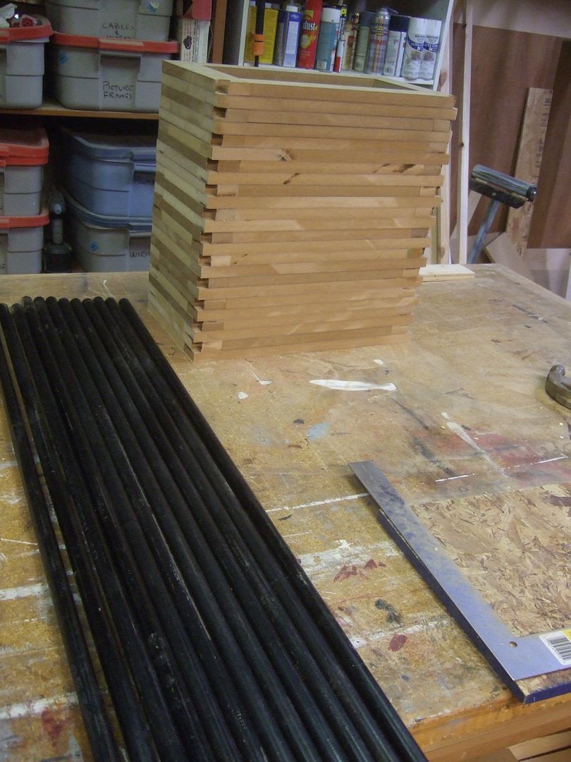

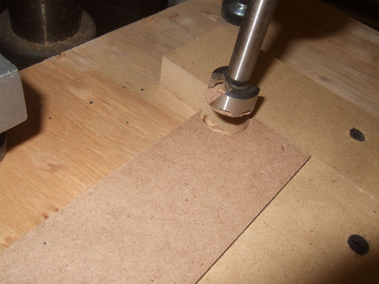

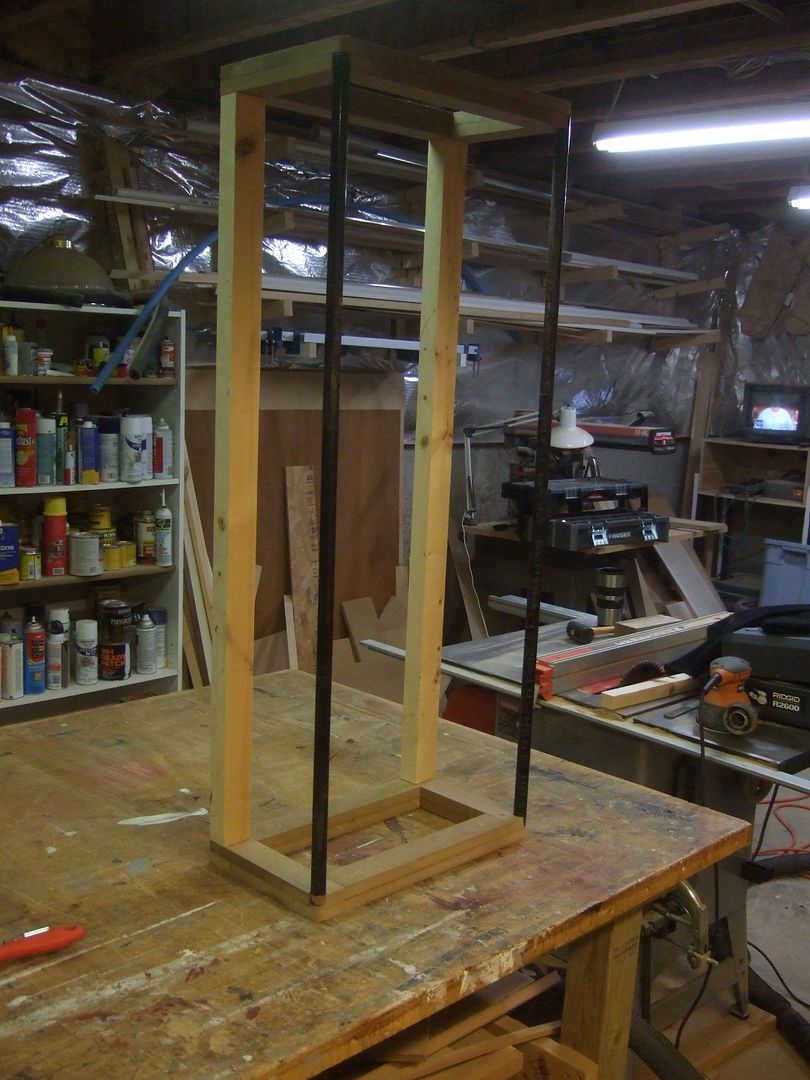

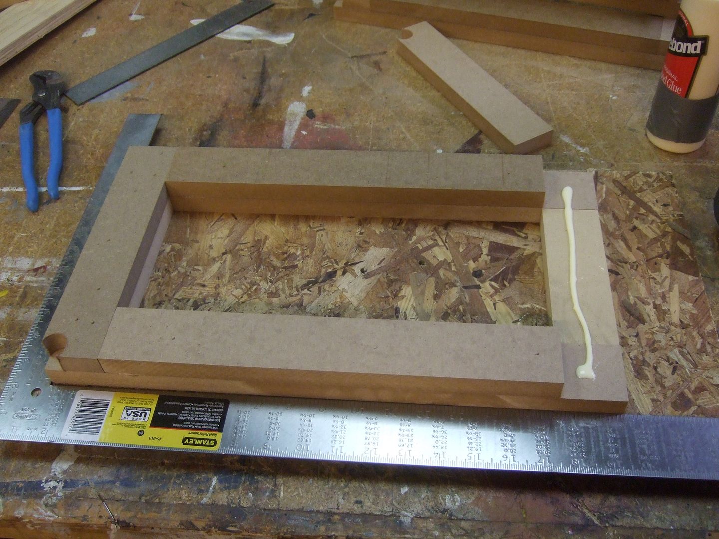

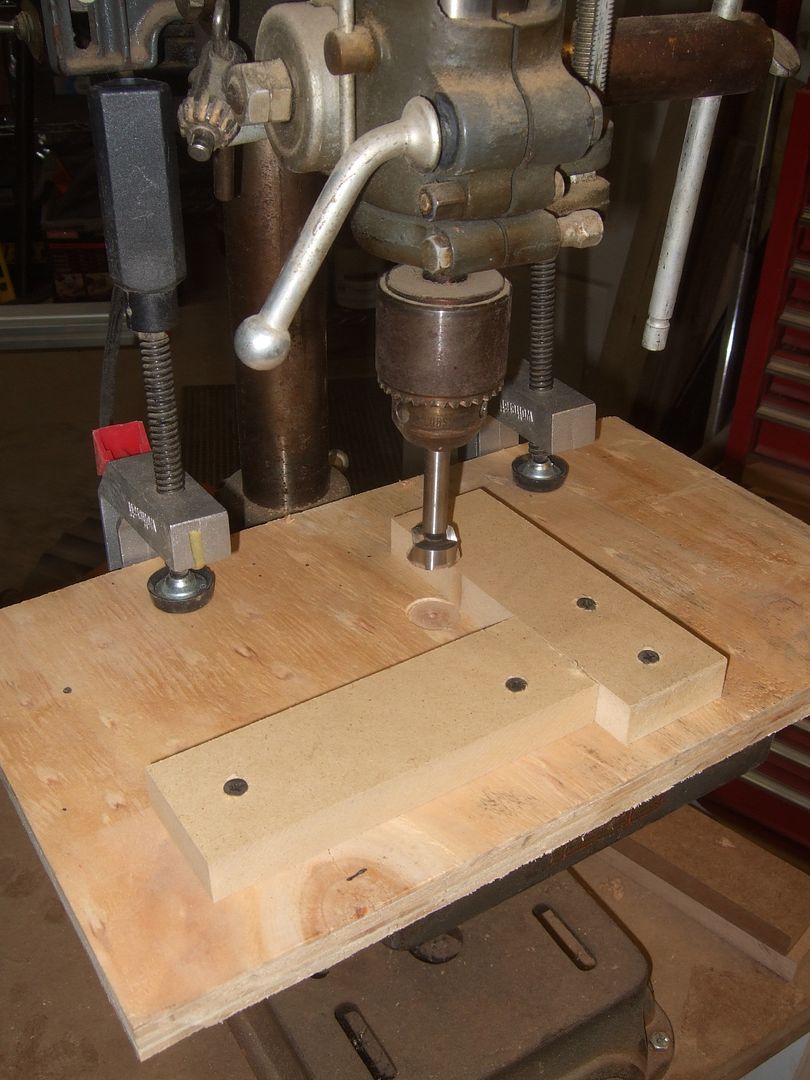

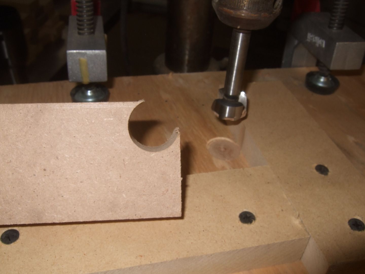

COLUMN BUILDING DETAILS
column at the riser front
The middle section was detailed earlier in the thread, http://www.avsforum.com/avs-vb/showt...1#post20949031 I just need to add that we did fill the metal support members with dry sand. Plugged the bottom end with a wad of insulation and sealed the bottom with black silicon seal, let dry, then Damelon poured in about two cups of sand and we topped off the last 1/2 inch with silicon seal.
full size column
column at the back of the theater
Now I need to fill the nail holes, do some wood putty work, sand, seal, sand, prime and paint.
How did you keep the middle section together? I see you have what appears to be a 2x4 support on the back but what keeps the opposite side (with the metal rods) together? Is it a friction fit using the pressure on the back side or is there some form of attachment between the metal rods and the bases that wasn't documented?
vanice is offline
post #1459 of 3016 Old 06-12-2012, 08:51 AM
Posts: 27,704
Mentioned: 238 Post(s)
Tagged: 4 Thread(s)
Quoted: 3653 Post(s)
Liked: 3103
Dab of silicon glue, friction fit, the wedging of the top and bottom which was a tight fit, the tension of the fabric all holds it together.
