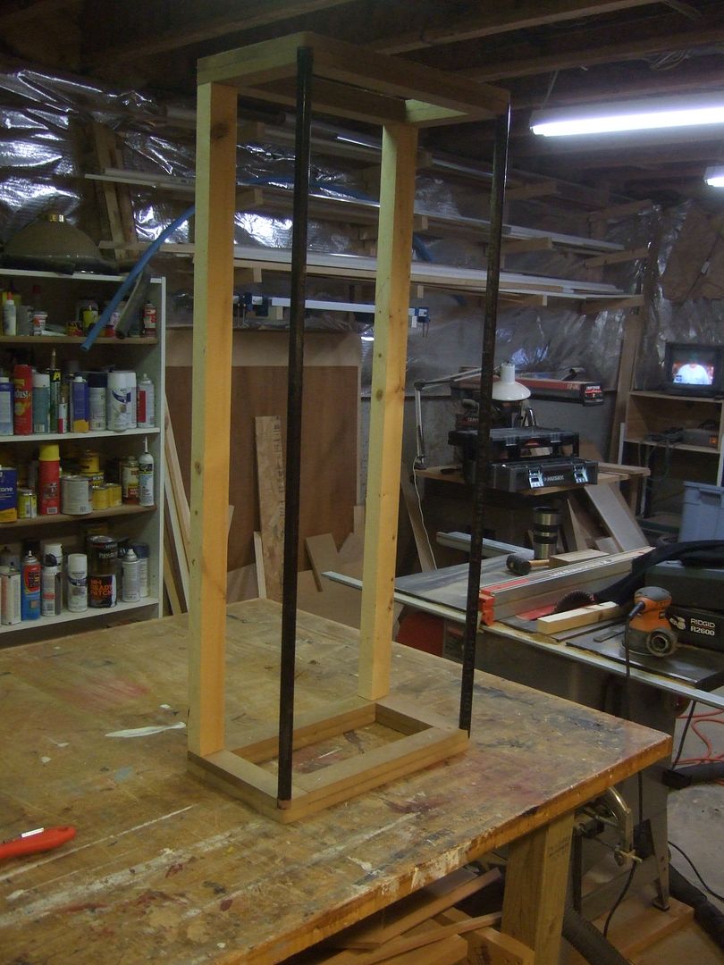

Prototype Speaker grill cover.
Damelon and I have been kicking around ideas on how to build a 46 inch tall 18 x 10 speaker grill cover that would provide the minimum speaker interference possible.
Using perforated metal was one idea that we considered but didn't pursue. Putting a 2x2 at the front edge is a pretty big obstacle. So what about some 1/2 inch iron pipe?
Here is the prototype:
Anyone have any other suggestions?

post #213 of 2990 Old 09-13-2011, 08:16 AM - Thread Starter
damelon's Avatar
Location: Woodbridge, VA
Posts: 2,137
Liked: 265
Brilliant! Just like I pictured your idea. I agree, this is much simpler and more elegant than the metal grille. Wouldn't a 1/2" wooden dowel rod be easier and cheaper?
We would need at least 1 inch dowels for the strength to resist bending when the fabric is pulled tight. They were out of 1's but had a dozen 1 1/4's in stock. Half of them were warped. The others may warp in the future.
On cost, the wood was going to run $4ish a stick, these were $5.81 each. Bottom line they are smaller, stronger and straighter. It is going to cost you $21.60 more to do all 6 columns.

Instead of iron pipe, how about either metal conduit or chain link fence top rail. Both are galvanized (cleaner than black pipe). Chain link rail is pretty darn stiff too.
Great look, BTW. Yet another idea I may "borrow"
Actually either one has to be cleaned, primed and painted black.
I'll take a look in the fence section but I don't think they have anything this diameter. The 1/2 inch black pipe is 7/8 on the outside.
OK, back from the big orange where I had 10 more 44 3/8 long pieces of black pipe cut.
I did some more looking around and conduit had too much give for my taste.
Galvanized pipe in an equal diameter ran $.50 more a foot.

There might be, but that is why we will fill them with sand. My knee-jerk reaction was the same.

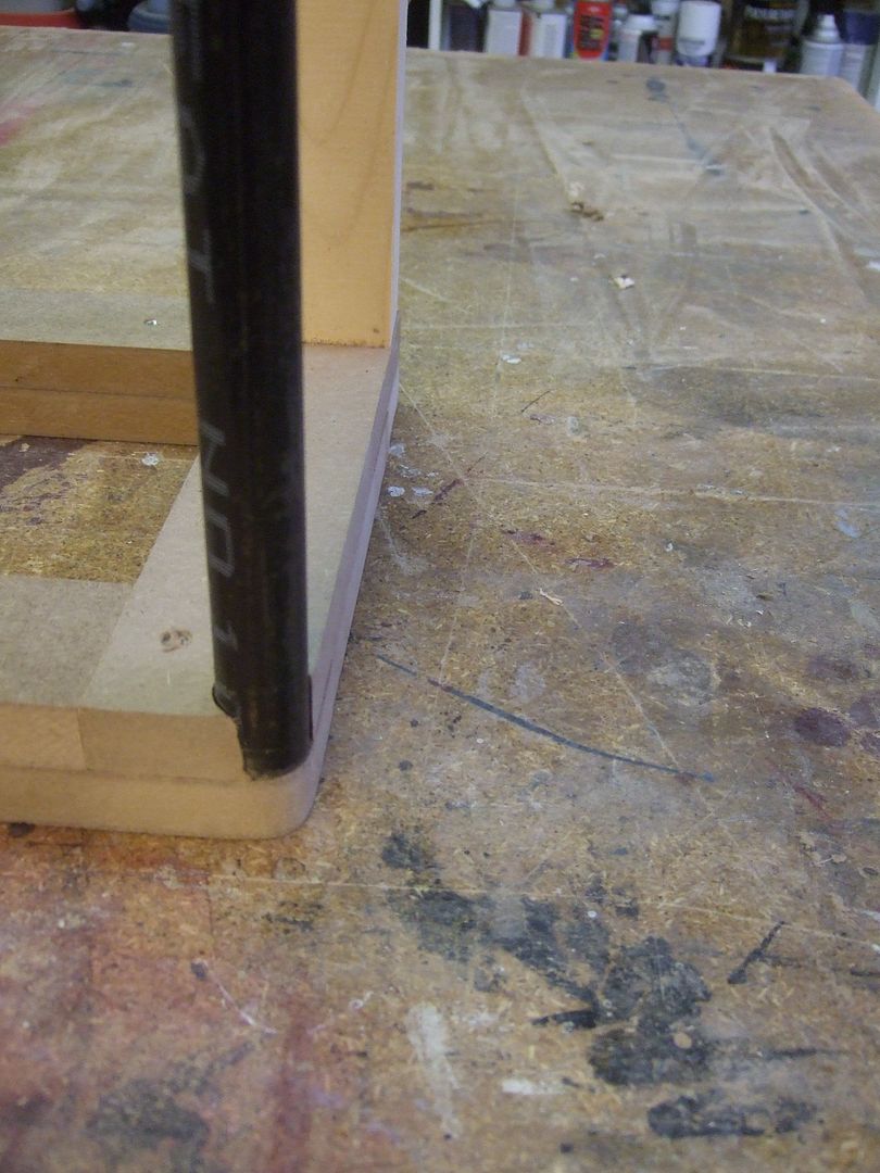

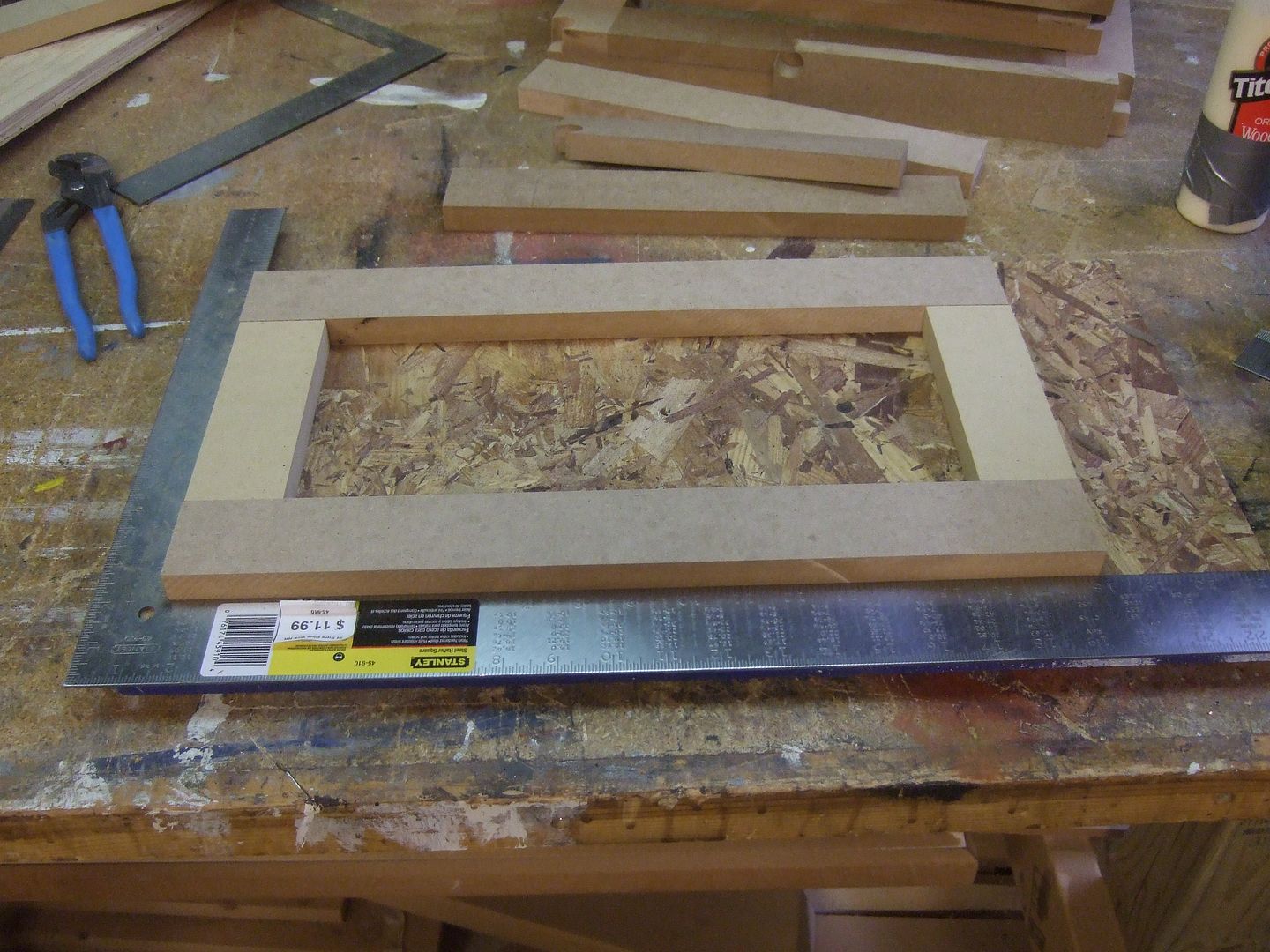

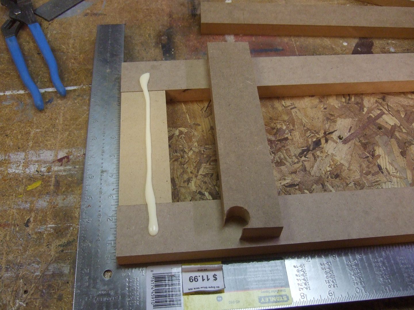

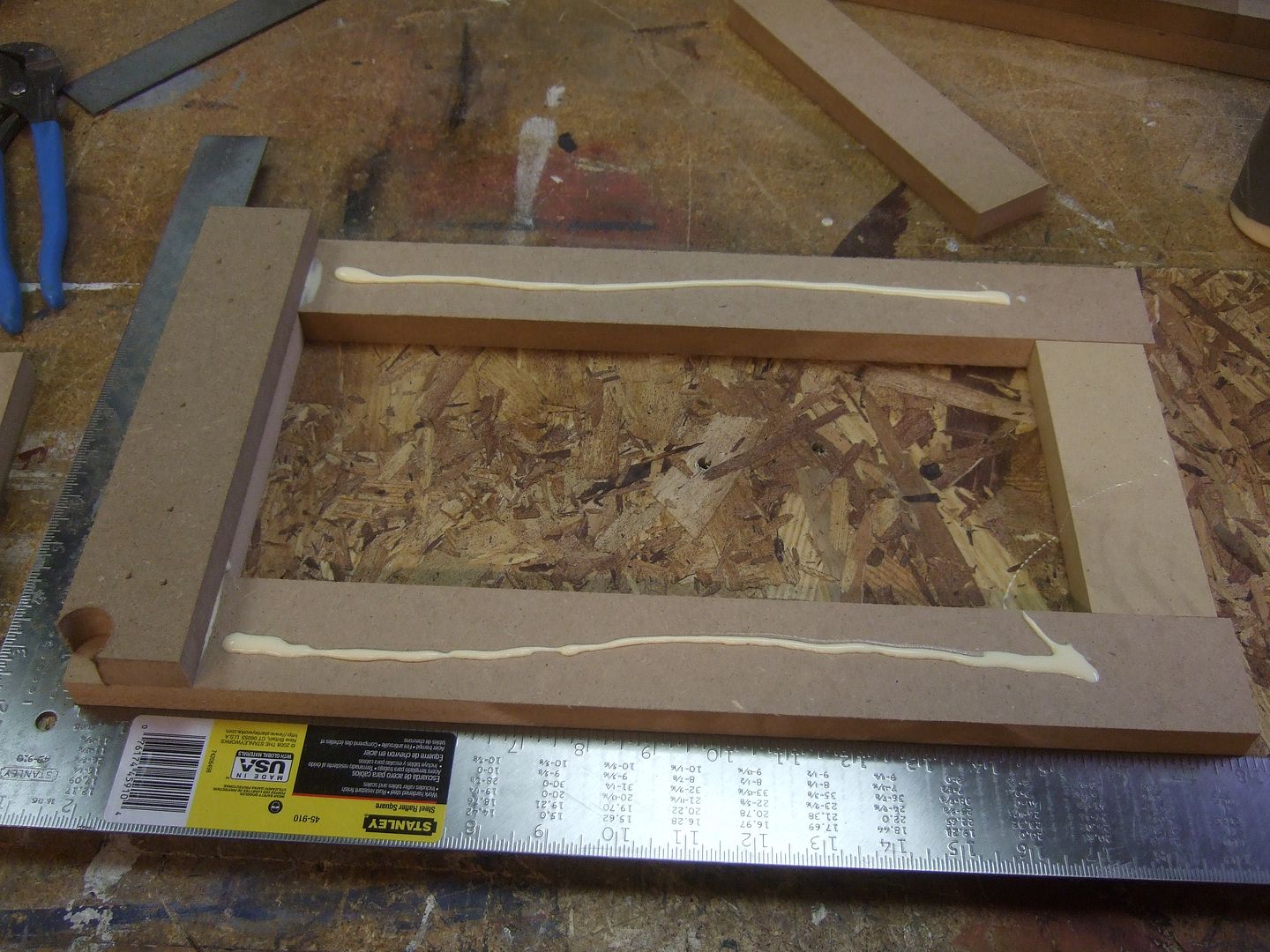

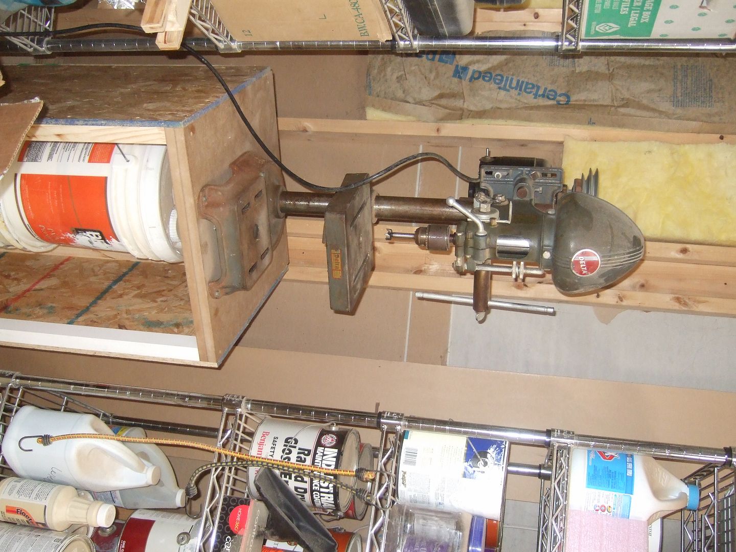

SPEAKER GRILL COVERS - PRODUCTION
Last night and this AM whipped up the covers.
First step was to cut the 96 pieces of MDF to length.
Then I made a little jib to make quick work of drilling out the corners for the metal support members, I did the prototype free hand, having a jig made it go faster.
Next was to glue and nail the two layers of frame tops and bottoms. Used a square to keep it square.
Almost done
Remaining steps: paint the metal support members, cut the back uprights, round over corners, assemble at Damelon's, Paint the wood and attach fabric.

Quoted: 104 Post(s)
Liked: 126
That's some drillpress! Looks like something out of 20,000 Leagues Under the Sea. The old version. From Disney.
Great design, as always.

Actually it is a 60+ year old Delta that my father had in his shop. Original motor.

Gotta love that old cast iron stuff. Can't beat it.
I have an old Craftsman full size drill press from the late 60s.
From my father's workshop as well. It took three guys to move it, and they finally put it on a dolly.
ADDUpstate is offline
