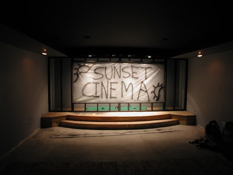

Isn't the stage a little on the tall side?
Yes, I was basing it off of another stage construction which I liked, but the height isn't set in stone. I may use 2x6's instead of 2x10s. The design would be the same, having a curved front lip and a second curve halfway down. I'm actually in the process of discussing reflection points now with Bpape so a lot of room dimensional adjustments will be hammered out soon.

Originally Posted by BIGmouthinDC
I think Damelon likes Sandman's and this stage design. It is also my favorite. Screen wall may vary.
Sandman's
I actually like the proportions of Cinema Murry's step a little better the wings come out farther on the sides.
100% correct, thanks BIG. I was too lazy to search for a link! I too like Sunset's proportions better, and the incredible background art helps too

Somehow I was envisioning a single level stage.... The second step stage design reduces the visual heft that I envisioned.
I was also thinking that an 8' 9" height, with a 12" stage, plus the soffits, is creating several nearby boundaries to the speakers. And aren't the 1/4 wave lengths off these boundaries are going to cause nulls?
And that maybe less is more? Less sand, less work slugging the sand.
Well it was a 10" stage plan not 12", and chances are the soffit will be about 10" or so around the edges of the room. Bpape didn't think the height was a big issue and plans to use the soffit as a treatment as well. I will likely lower it to 2x6s or 2x8s when the time comes. And you're absolutely right about the sand! a lot less work! I think SMX said he used 4,000lbs of it to fill his at a 2x10" height. Crazy!
Just finished a lot of discussions with Bryan (bpape) about 30 min ago and we're going to move the entry door to the left rear corner to make adding side treatments easier with the door opening inward followed by steps up to the back of the riser. We'll use ductboard for HVAC inside of the soffit, surrounded by MDF casing with supply in the front and return in the rear. Caulking around every seam, etc. The equipment room will also be de-coupled due to the rack opening to the rest of the theater.

I have a couple of quick questions for all of you.
1) As you might be able to see from some of the "before" pics, My concrete walls have the typical basement "vapor barrier" insulation secured to them. As I am building a room-within a room, and my wall will have insulation in it, what should I do with this? Should I just cut it down, leave it, or replace it with something? It's quite "poofy", so if I leave it my wall will either be pushing against it or I will need to give up a few more inches to give space between it.
2) How much typical depth is needed for the riser. I'm trying to figure out exactly where my rear side speakers are going to go, and as they will go inside of the rear side columns, I want to know where everything will be so I can finish some details about my floorplan and get it posted.
I have also decided to put my door on the side wall after all, opening inward of course, and that my walls will be fabric treatments. So I need to account for that 2" covering all around. Not to mention want to figure out colors. I'm not sure I want to go the black and red route.
My columns will be 16" wide by 12" deep.
I've decided my stage will be 2x8s + double 3/4" ply.
Undetermined yet if my riser will be 2x8s also or 2x10s.
