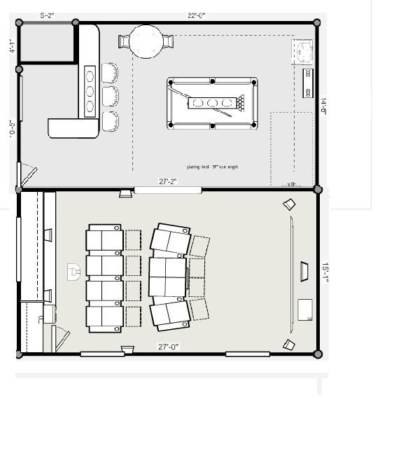

I like this general layout. Bar with bar stools, 8 foot pool table, small round table with two chairs, arcade game top right, cue rack next to it, electronic dartboard bottom right. That`s probably about as much as I can put in there without it feeling too crowded. Would like to make the most of the behind the bar space, but it`s a bit limited due to the adjacent staircase.

I like all of the pictures you posted; each for different reasons. I think you've got to decide on the look you are going for, and how much you want to be able to close off the two areas. The three archways certainly gives it a much more open feel (and expensive ), but it limits you in options for closing off the two areas. If you go with two archways it closes things down a bit, but you could still go with a pocket door, or maybe a barn door for each arch to close them off when needed.
Also, have you thought about putting the bar on the opposite side of the room? That would give you more room to move your entry door. I know you will end up with a sloped ceiling in that corner due to your stairs. Another option would be to flip the bar so that it's along the wall with the windows. You'd be able to sit at the bar and look out the windows, but you'd also be limited on cabinet space behind the bar.

I like the way the two rooms go together. Lots of more decisions to make and lots of potential refinements. Going to post this up, let it percolate, and open to comments and suggestions to make it better. Leaving Thursday on vacation for a week with my wife (Paris, woohoo!) and will start to discuss with our builder when we`re back.

I'm subscribed! This looks like a fun project.
All stuff I`ve thought about at some point as well. Need to review ideas with our builder to see what would work, what won`t, etc... Need to talk to cabinet people about bar design - never had one before so need to find out lots more about how to make the most of the space I have alotted.
I should note that there will likely be a big double window along the upper wall of the games room as well overlooking the pool area slightly to the left and woods in behind.

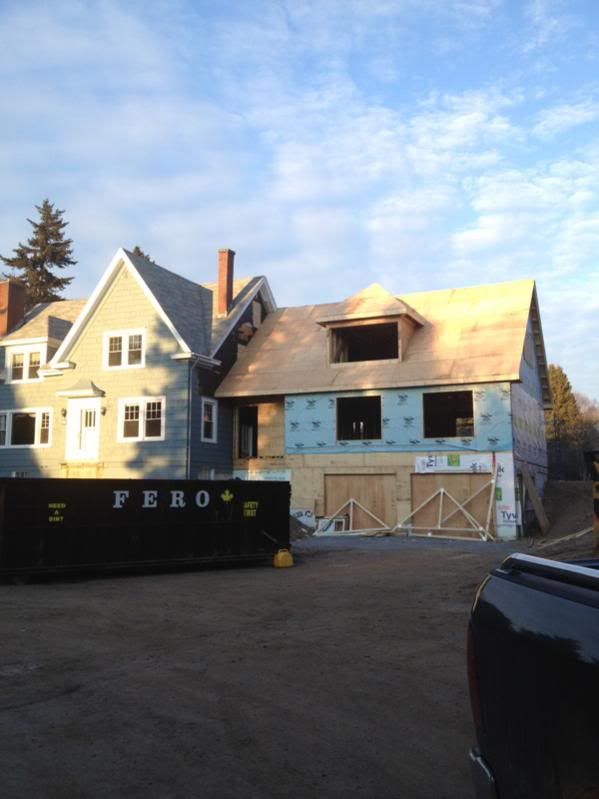

post #50 of 90 Old 01-06-2012, 12:59 PM - Thread Starter
gsearles's Avatar
Join Date: Feb 2004
Location: Rothesay, New Brunswick, Canada
Posts: 436
Best pic so far of the outside. HT and bar room are over the garage.

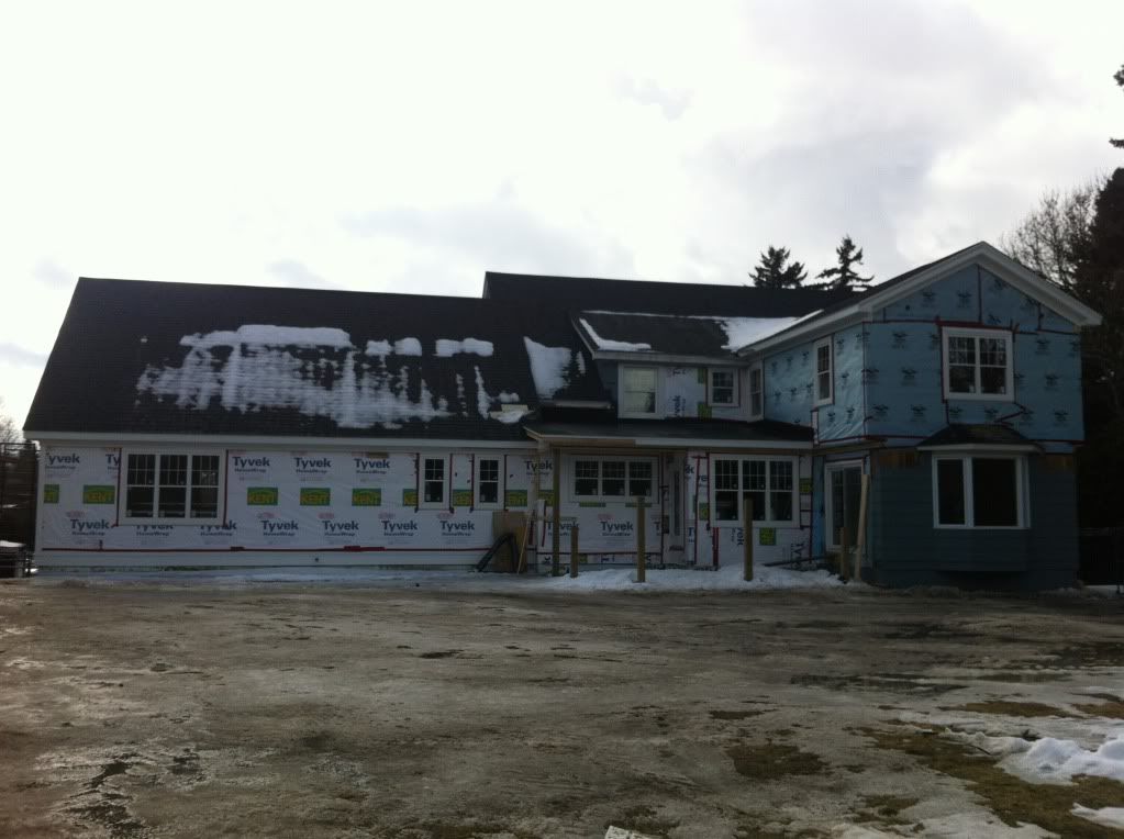

Things are moving along at a fairly rapid pace. Here are some photos of the outside taken today from front and back. Eventually all shingles will be painted a medium blue. Roof and outside walls are all done. Inside, electrical and drywall is all done. Next up is paint, floors.

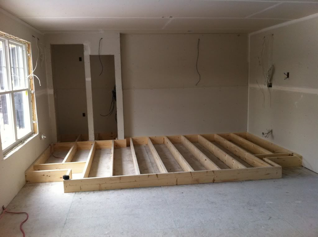

Drywall is done, two layers on ceiling and the walls that are connected to the house.
Front stage is set up, back riser as well. To be filled with insulation and double plywood top.
Back closet is now properly cut out.
