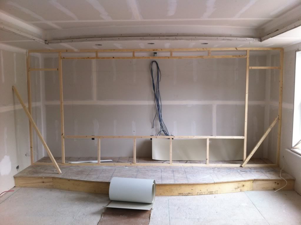

post #76 of 90 Old 04-28-2012, 07:44 AM - Thread Starter
gsearles's Avatar
Join Date: Feb 2004
Location: Rothesay, New Brunswick, Canada
Posts: 423

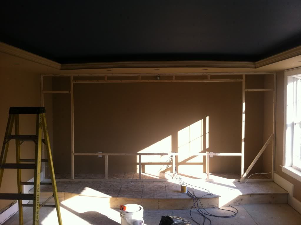

Lots of more progress in a few weeks. Here are some pictures from about two weeks ago with some painting done and the media shelves at the back installed. The first pictures shows the soffit and screen wall edges. The colors are much better represented in the second picture. We went dark blue on the celing both for reflection control and lighting effects.
gsearles is offline

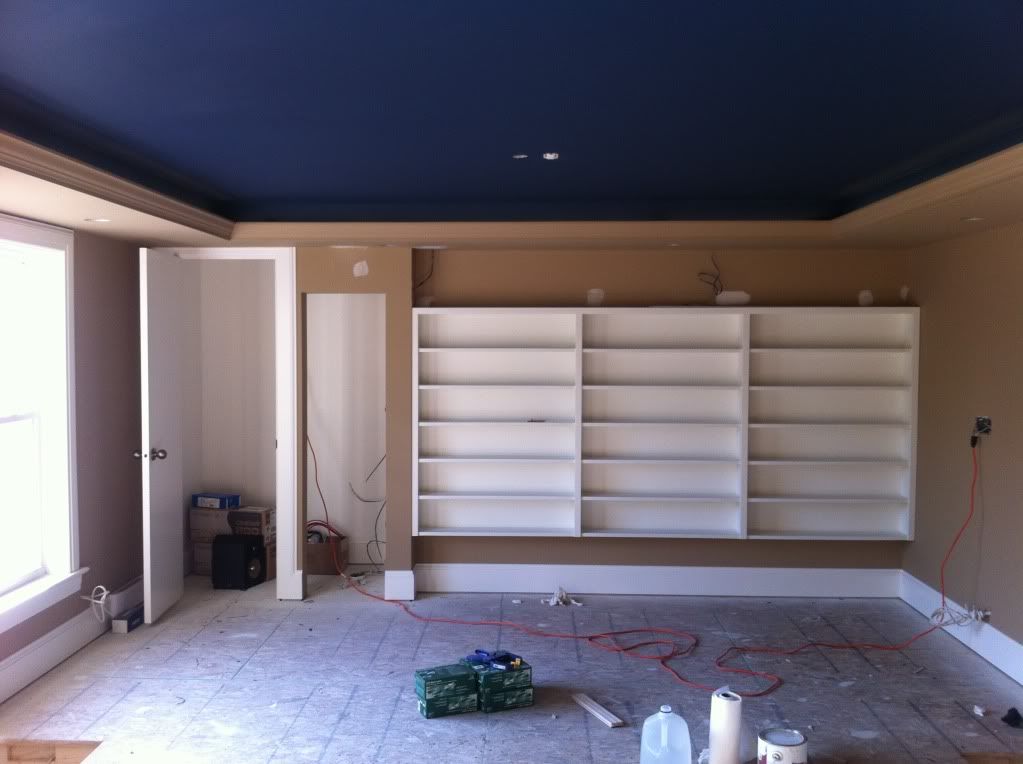

After painting but before acoustic treatments. The crew hadn't realized there was no real point in painting behind the screenwall.

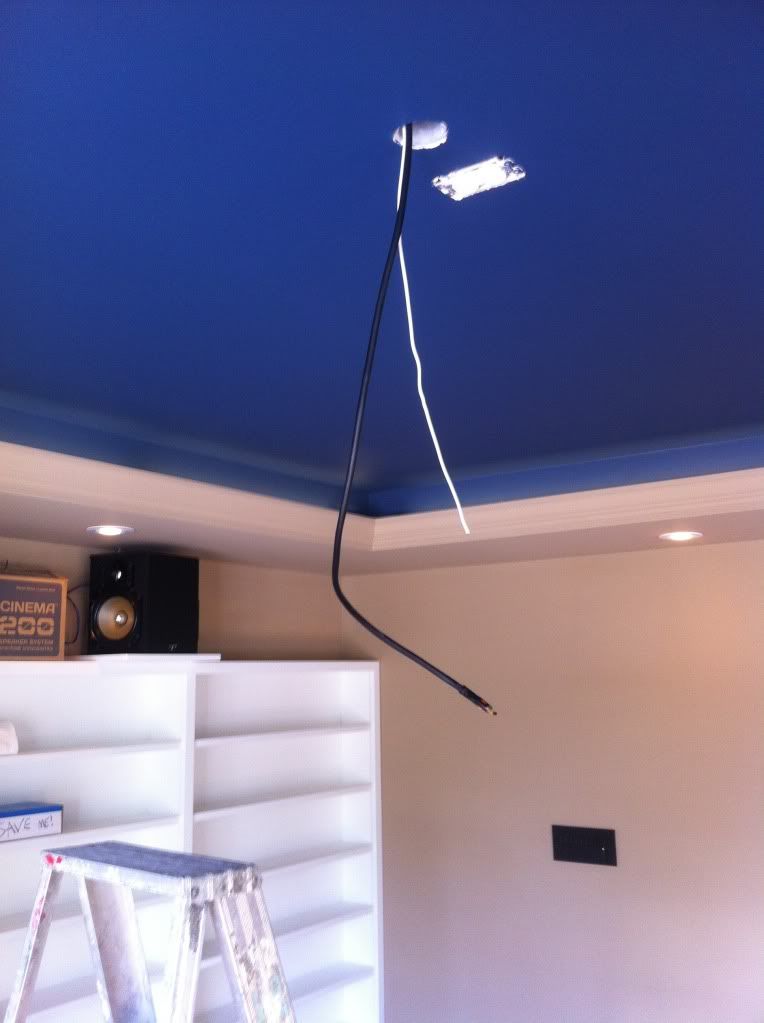

So construction proceeds quickly, along with the rest of the house. We move in in two weeks. The bar room next door is coming together nicely as well. I can post pics of that here is people would like.
I like the wall and ceiling colors that we (well, OK, she) picked out. Carpet now going in, it's similar to the wall color. Drapes, chairs and ceiling are all dark blue.
The electrician has almost everything done. Will do some close up pictures of the lighting scheme when I have the chance.
I am removing my speakers and projector from our current house today and taking them over. I picked up my new Yamaha RX-A2010 yesterday - very excited to hook that thing up.
Need to put together my Middle Atlantic Slim 5 rack
Need to figure out the best spot for the projector on the ceiling. I have a broad area of the ceiling re-inforced with wood behind the drywall to accommodate the current projector and possible future changes.
Will put up more pics today or tomorrow

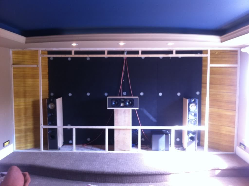

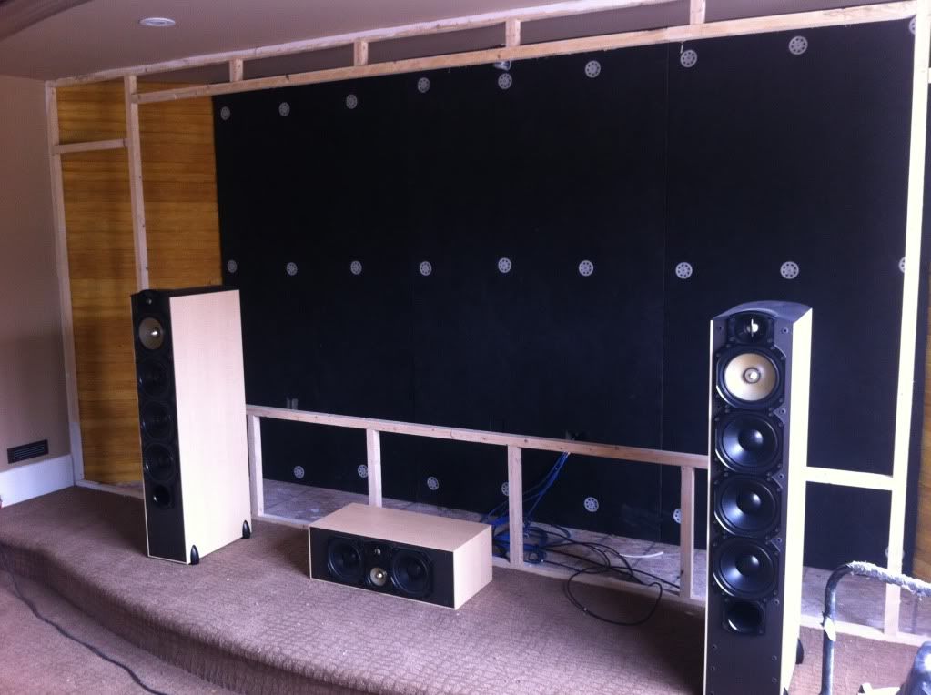

post #80 of 90 Old 05-04-2012, 02:09 PM - Thread Starter
gsearles's Avatar
Join Date: Feb 2004
Posts: 423

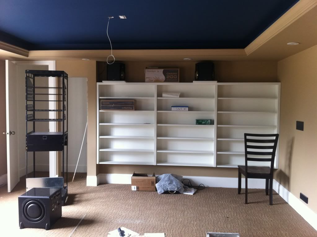

Front wall 2" linacoustic and bass traps done
Speakers going in, questions next post...
gsearles is offline
post #81 of 90 Old 05-04-2012, 02:21 PM
dvmiller's Avatar
Location: Great Northwest
Posts: 272
Coming along nicely Greg. Really like how the blue ceiling looks. Looks like an interesting texture to your carpet or is that a visual illusion?
Dale
dvmiller is offline
post #82 of 90 Old 05-04-2012, 02:24 PM - Thread Starter
gsearles's Avatar
Join Date: Feb 2004
Posts: 423
1. Not sure what to do with screen height and L/R mains. I specified the screen height that you see here, but my speakers (Paradigm Studio 100s) have so many drivers that they come below the screen bottom. My options are:
a) leave as is, allowing a driver below and above the screen frame - the spacing is actually pretty decent
b) lower the screen opening - sounds appealing in some ways but not in others - would have to be pretty low to get all drivers behind the screen
c) build small platorms to raise the speakers up
d) a bit of b and c
2. What height and orientation for the center channel? I've mostly read that given the choice it should go vertically as shown. Is there good info supporting this? If I do, what tweeter should I like up with the tweeter of my mains?
gsearles is offline

post #84 of 90 Old 05-04-2012, 02:28 PM - Thread Starter
gsearles's Avatar
Join Date: Feb 2004
Posts: 423
Dale
Thanks! I LOVE the blue ceiling. It just got the final coat today. As is often the case, the pictures I took don't show it quite right. Same for the carpet. Yes, it's textured, but also currently covered in dust (hahaha) and the picture is brightness corrected to show the screen wall better.
Will take more of the rest of the room and try to get the brightness right for those details.

post #86 of 90 Old 05-04-2012, 02:37 PM - Thread Starter
gsearles's Avatar
Join Date: Feb 2004
Posts: 423

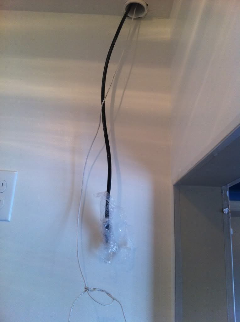

Here's a picture I'll share to show some other details. As you can see, pretty messy. However, this shows the ceiling color quite accurately. The carpet looks lighter than it really is, but that's the weave in it.
Also, can see the rear shelf surround speaker placement, and the Slim 5 rack I'm putting together.
gsearles is offline

Will the screen be surrounded by acoustically transparent fabric panels? If so, I wouldn't worry about the LR speakers. I wouldn't want the tweeters or the midrange drivers to be firing right into the wood frame, but diffraction is not as audible in the bass frequencies.
I'm pretty sure that particular center channel speaker should be mounted horizontally. You want the tweeter and midrange to be vertically aligned (tweeter on top of midrange). The usual advice not to mount the center channel horizontally applies to speakers that use a woofer-tweeter-woofer layout. With your center channel speaker, Paradigm engineered around the issue by using the vertically-aligned tweeter and midrange.

Thanks for the feedback.
I'm sure you're right about the center channel. Will do a bit of checking but will likely mount it horizontally.
Yes, the screen will be surrounded by Guilford of Maine acoustically transparent fabric. The screen frame goes right on the wood so should work out fine re the woofers.

Also need to decide exactly where the projector goes. I got a 130" diagonal 2.25:1 screen, with side masking panels. Will be using zoom method with my JVC RS-15. Used Projector Central calculator last time. Is it still the best online throw/brightness calculator on line?
gsearles is offline
post #90 of 90 Old 05-13-2012, 08:41 AM - Thread Starter
gsearles's Avatar
Join Date: Feb 2004
Posts: 423
As much as all the construction was done for me by professionals, I'm fussy about doing the wiring and component installation myself. This weekend I ran all the needed wired through the pre-installed conduits. I love conduits. My equipment closet at the back of the theater has conduits to the projector mounting area, the front screen wall area, and to the TV area in the games/bar room. This allows any future cable/speaker upgrades and added features obviously.
I bought a new 13' cable to run to the projector. For the first time ever, I bought the highest quality (ultra high speed) Monster cable that Future Shop has to offer (I am no cable snob and usually avoid overpaying for Monster branded products. But for this critical run I thought what the heck, get top quality and future proof). The white wire you see is scrap CAT-6 that was used as a wire pull and will be left in place, tucked away out of sight for future use.
I already owned a 40' HDMI cable from my current installation. I ran this to the TV area in the bar/games room. This will allow me to duplicate the output to both rooms simulataneously.
I then ran my 12 gauge speaker wire from the equipment closet to the three front speakers. I cut, trimmed and threaded them in place - bare wire connections.
I had pre-installed a run of RG6 cable with a coaxial termination and hooked up the sub with this.
