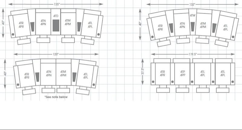

One of the reasons I picked these chairs was the slightly narrow width vs other models when I was building my current theater. I only have 12'8" of width now and I wanted 2 rows of 3. It works fine.
I've attached the layout options for this series of chairs. You can configure them several ways. A chair with one arm is only 28.5" wide. You need one in each row with two arms, and that one is still only 34" wide. So I should be fine with 4 in a row - you can cram them in as little as 10 feet of width, though I like the curved end configuration which makes it 135". That would still leave me about two feet on either side of the row (probably cheat like a do now, a little bit moved over to the far wall to make a little more space on the "entry" side.
My theory is most of the time it's me and/or son/wife watching a movie. If there's a large crowd it's for sports or it's all kids and noisy, so I don't care too much if the side seats don't have great surround. I plan to optimize sound for the two middle seats in each row. As long as I can seat 8 and get around the chairs I'm happy.
All that said my problem may be availability. Looking at the LaZBoy website it appears they may not make these anymore!!! Given I already own six I may have to look far and wide to find two more that match.
Thanks re pic info - when I'm at my PC I'll figure that out. (Edit: Figured it out. Will re-do the posts so far to have embeded images)

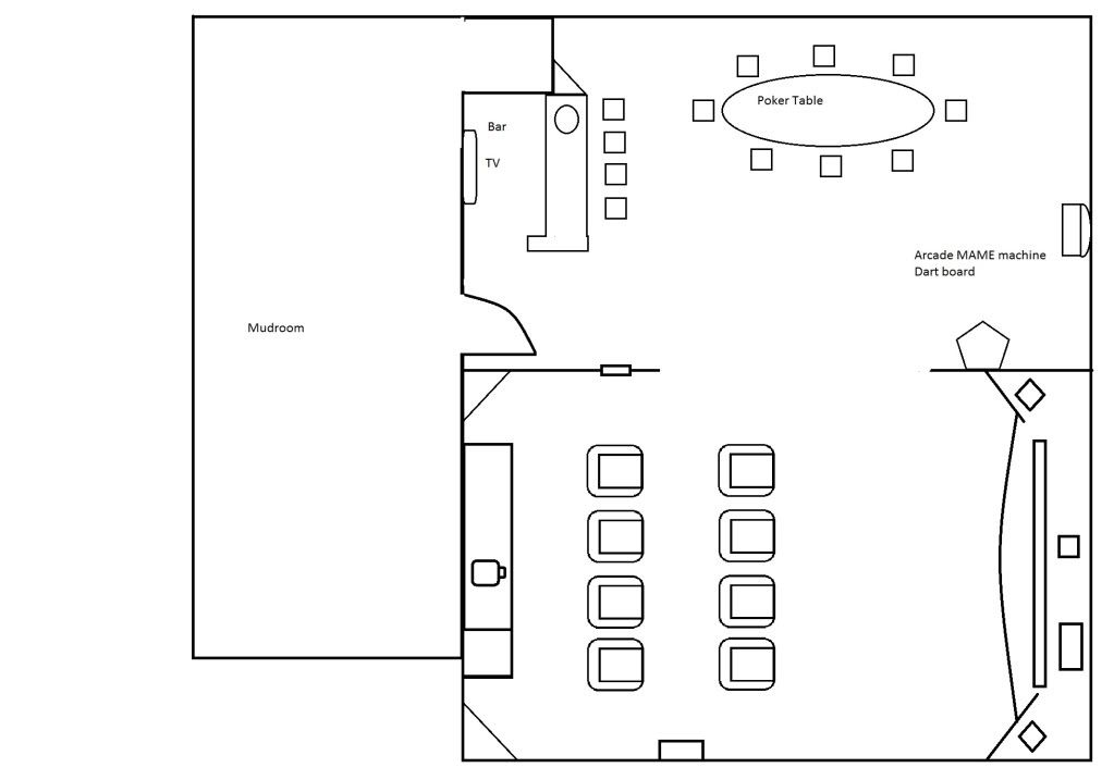

It took me way too long to do up this not-exactly-to-scale drawing of my proposed layout.
Each of the two rooms will be approx 25 feet long. I'll make the theater room 15.5' wide and the games room 14.5' wide. There's a 4' x 4' piece lost in the top left corner for a staircase from mudroom to garage one level below.
I want the areas to feel open to each other yet distinct. I will carpet the theater for sure, but may use hardwood in the games room to set them apart. The rooms will open to each other trough an archway like in this picture (not my build - found it in google image search looking for inspiration).

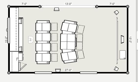

We got the next round of drawings from our designer, atached here:
The entertainment room at top will be the entrance point, as shown. I have only a few inches of space to play with at the entrance.
I need to figure out how much width the theater room will lose with finished walls, and see if I can finagle a few inches more width by moving the entrance door away a tiny bit more.
Games room:
I like the bar area as drawn - I plan on a *QUIET* mini fridge down below the bar, lights above it, and popcorn machine on the useless part of the bar at the top of the picture. I want a small sink on the bar.
The remaining games room space is decent - should be about 20 by 15 feet. A light fixture will go above the center of that space - have to make sure it`s something that won`t rattle! Also want it to not quite hit the theater room screen.
As for a table, ideally I want something a little tricky. I`d like an 8 foot pool table with some sort of custom made overlay that can turn it in to a poker table or buffet table. I`ve searched a bit and can find no such beast - anyone here ever seen or accomplished such a thing???
Lighting
The middle walls will be left open I am now almost certain. I plan on using the room either a) totally dark in the theater for movies, with very dim lights that don`t hit the screen in any way, to help walk through the games room or b) both rooms going with dim lights in theater if sports are on the big screen, and lights in the main room for eating, drinking, cards, etc. I`ll make a column at the end of each partial wall.
I will invest in a six zone Lutron Graphik Eye that will control the lights in both rooms. That way if I`m in the theater alone, one button shuts them all off for movie (or XBOX 360) time.
I could maybe have some dark curtains pulled aside on the theater side of the wall that can be dropped if needed for more light control.
Theater layout
The available space is going to be about 27 feet long. I will use 2 or 2.5 feet at the front for behind the false screen wall. In the back, I will have lots of shelves for media. Rear surrounds will go over these. I like the addition of the back closet in the lower left corner. This was not part of my original scheme but I ended up with that little space down there and it`s great. I will put a small door in the back corner. The equipment rack will go right next to that, and the closet will give me just enough room to 1) get behind the equipment and 2) store extra cables, Rock Band instruments, etc. I love this setup because I can still maintain sound control behind there with double drywall and GG all along, the closet is sort of within the room.

Found a great resource for room planning at http://www.gamesandthings.com/Displa...m_planner_page
I've laid out my current plans for the theater part of the room here. I'm VERY happy with the dimensions, seating, screen and viewing distance as is.
Will have to do some calculations to figure out the best projector placement as I`ll be doing zoom method 2.35:1, but will often be using the screen masked to 16:9. Want to get it right the first time!
The only thing I`m NOT happy about is the placement of the side surround speakers. That`s still my biggest debate about this room - do I want it open like this, in which case I`ll have to put the side surrounds up about 7-7.5 feet high. Or do I close it off more using double doors between rooms, in which case I can likely get it right where I want it, 6 feet high or so and between the two rows of seats. Dilemma, dilemma...
Greg
Greg
Have you considered making the opening into two archways with a column in the middle?
