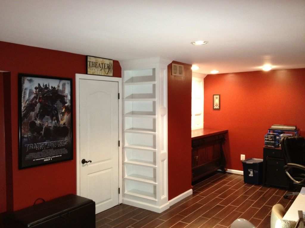

Originally Posted by dvmiller View Post
Nice work. Great use of a usually unused space (except for maybe hanging a picture on the wall). How does the theater entrance door line up with the bookcase? Don't want any dings in your fine work.
Thanks, I had planned on the bookcase being there in my design and it worked out well. Once the bookcase is finished I'll need to put a clear rubber bumper where the door handle meets the face of the shelf (I've added this to other cabinets before).
Hard to see it but the handle will smack the front of the case if you let it.
I'm sure I'll need to build another at some point.

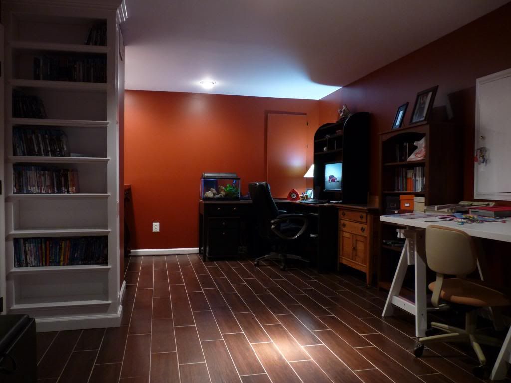

Originally Posted by DrZaus View Post
nice wood look floor tile, where did u get them from?
Thanks, just a basic tile from Lowes
Style Selections 6-in x 24-in Serso Black Walnut Glazed Porcelain Floor Tile
http://www.lowes.com/pd_397692-1813-1095206_0__?productId=3815453&Ntt=wood+tile&pl=1&currentURL=%3FNtt%3Dwood%2Btile&facetInfo=

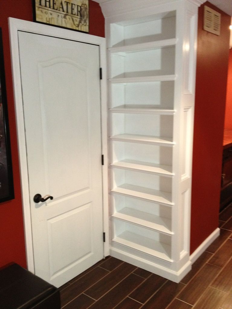

Finished painting and caulking the media bookcase (caulked the trim above the sideboard as well). Should be able to start loading it up shortly.
I'll have to get some shots with a real camera as the phone doesn't cut it.

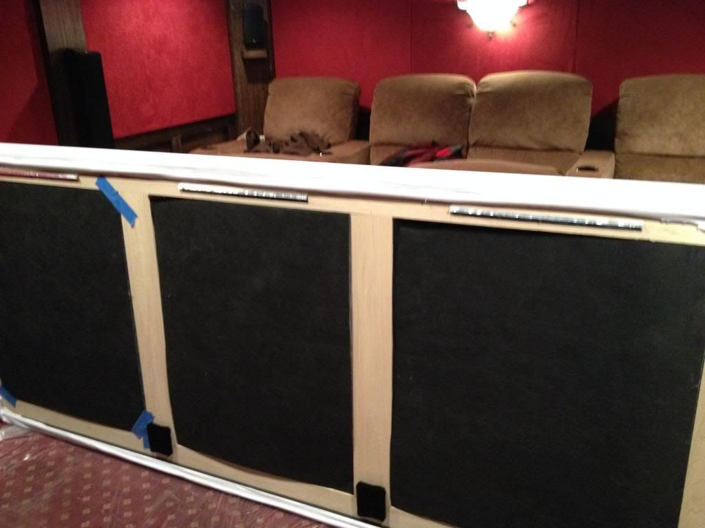

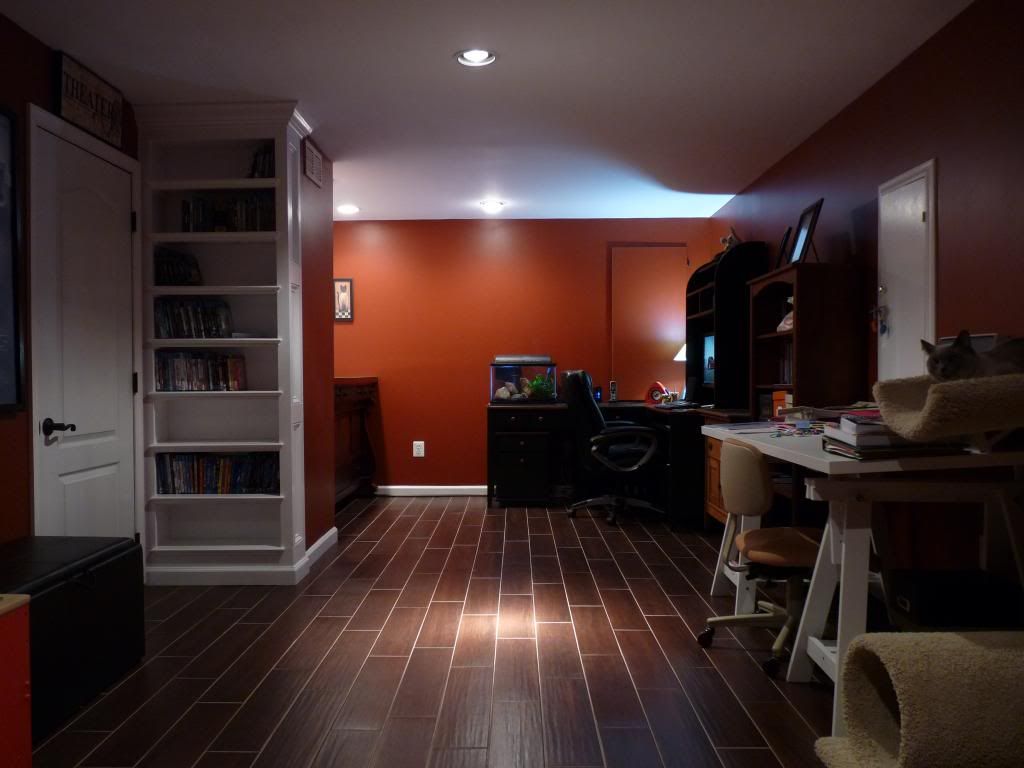

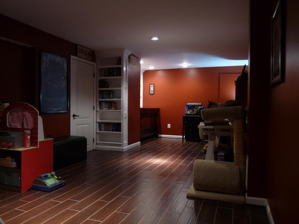

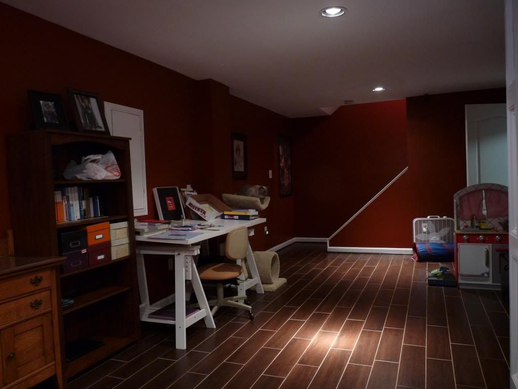

Thanks guys. Finally got around to taking some pictures with an actual camera. Turned out darker than I expected.
Still working on the railing
Play like a Raven

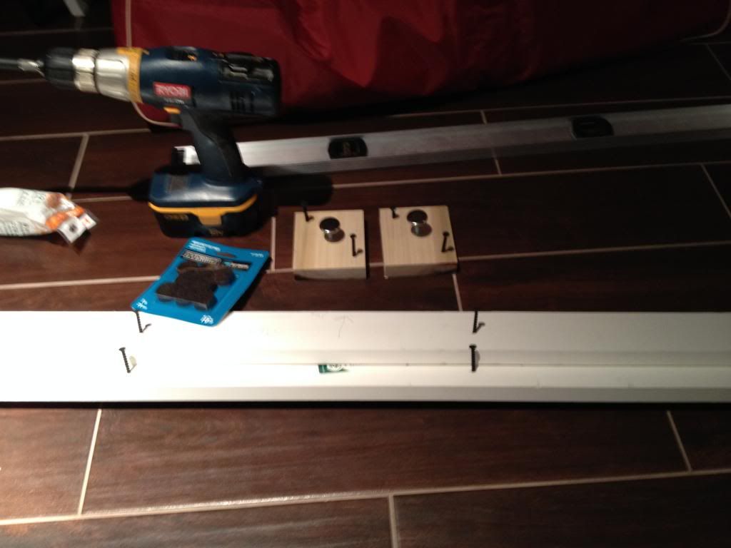

Screen has been re-hung. It went pretty smoothly. I made a french cleat out of some left over FJ pine I had and I also made some leveling blocks which in the end I didn't end up using (well I used the blocks but not the threaded feet). I guess the addition of the blocks the chair leveling feet were in was enough to get the bottom of the screen leveled with the top.
It's now centered perfectly, level and a couple inches higher which I wanted. Took a little bit go get my 2.35:1 and 16:9 presets updated but they are all good now.
Some blurry shots of the cleat/blocks:
Back of the screen with the old hangers. Spent $40 or maybe $60 on those stupid things. French cleat is much better and cheaper.
You can also see the ductliner I added to the screen. I don't have any on the screen wall so this at least helps somewhat.
