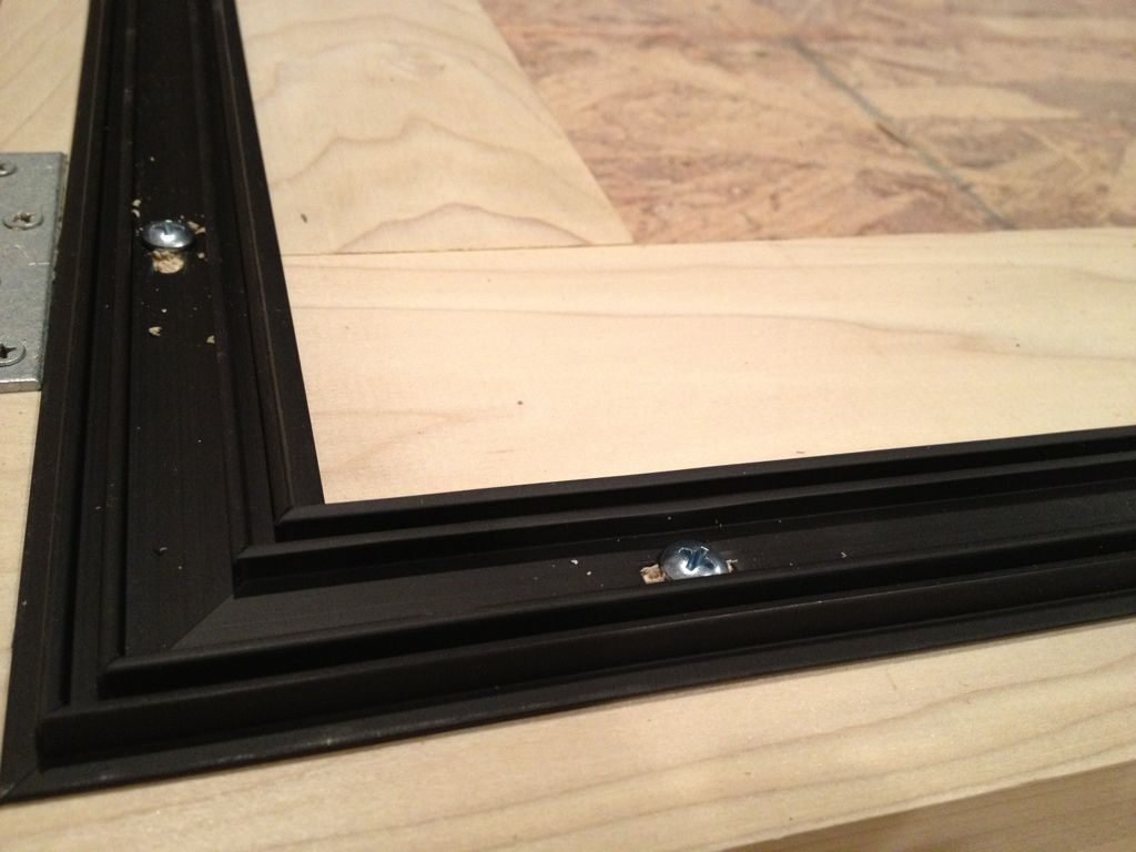

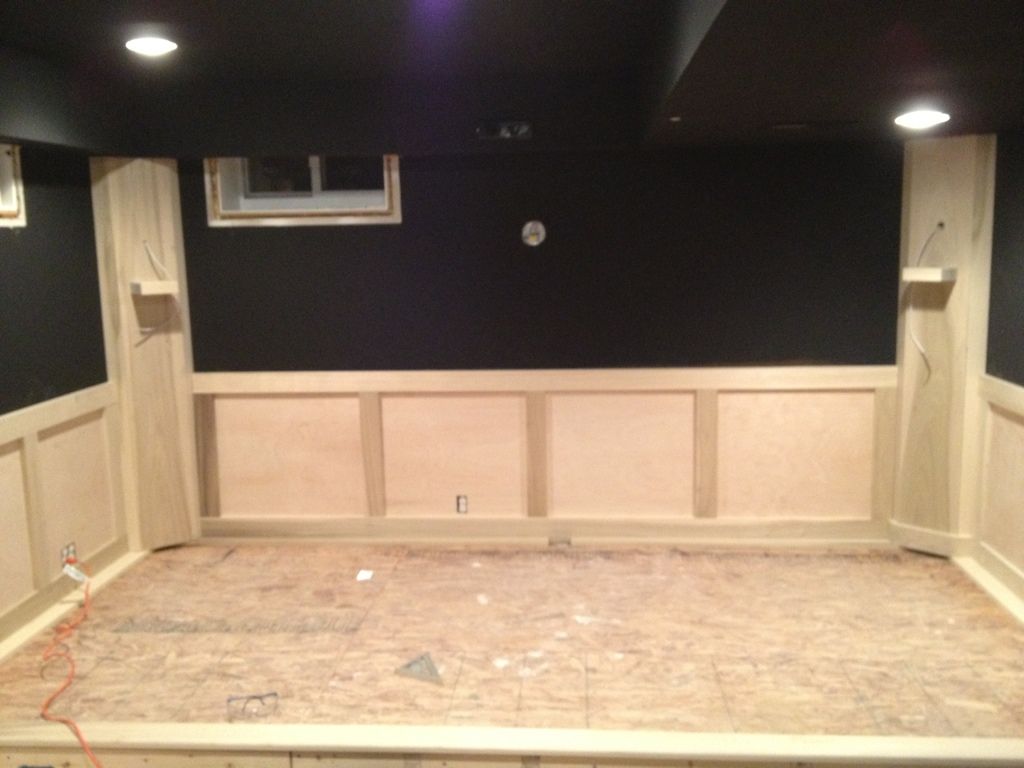

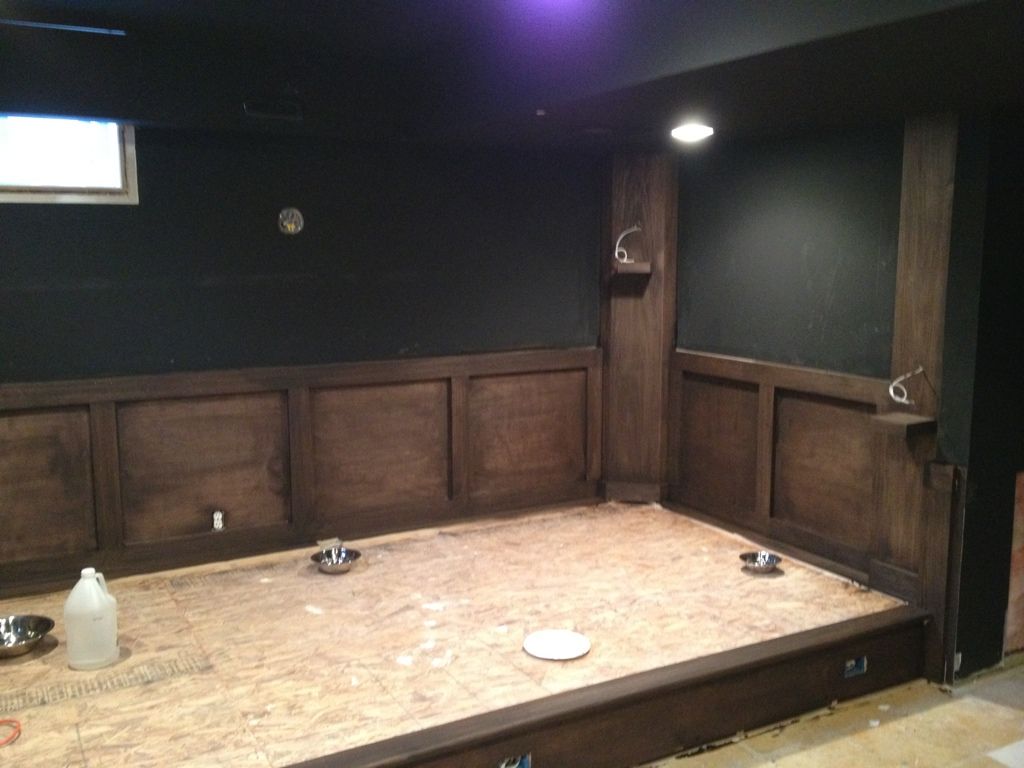

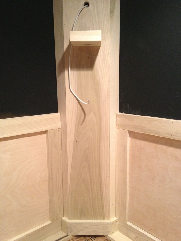

Columns are in and some of the wainscot. I need to buy more 1/4 ply and poplar. Screen frame needs a few more brackets and the screen track but otherwise it's mostly done.
Can't seem to find my rear surround brackets but I'm sure I will soon.
For now the speaker is just sitting on the block. The blocks will tie into the theme of floating shelves that the LCR speakers will sit on.
Columns still need trim but you get the idea.

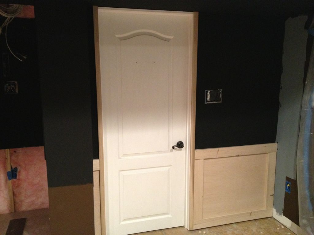

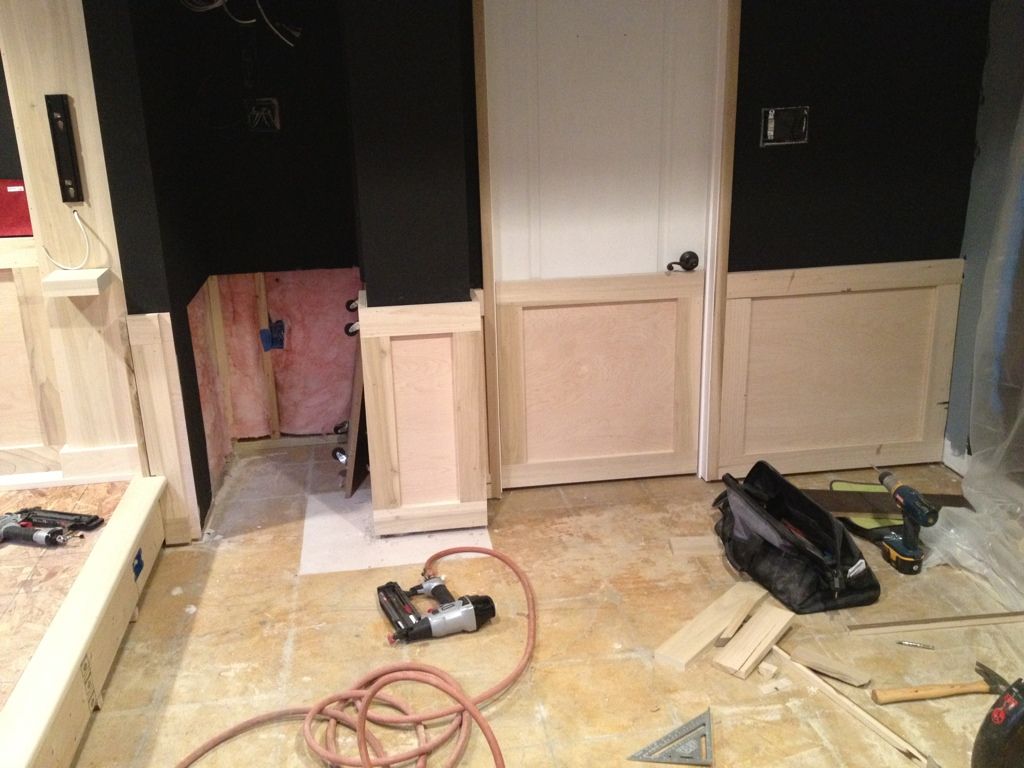

Just have to say, what a game today!
I did get some work done in the theater, door is now in and more wainscot is done.

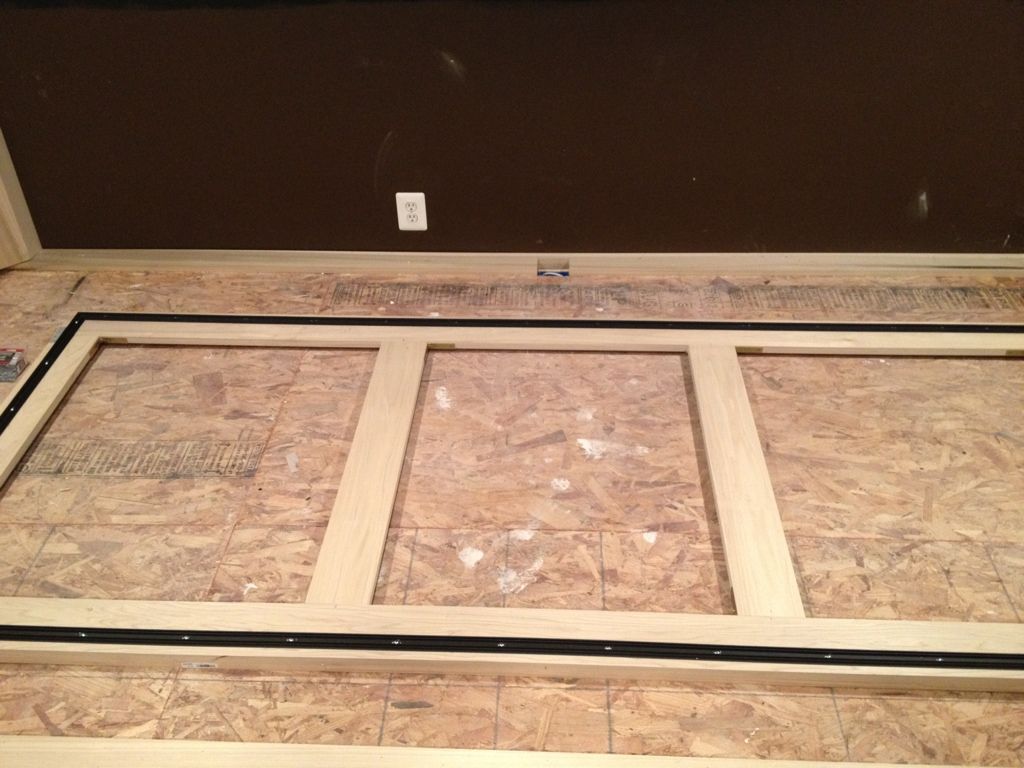

Liked: 44

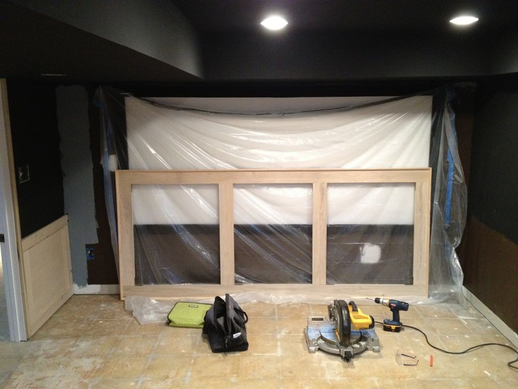

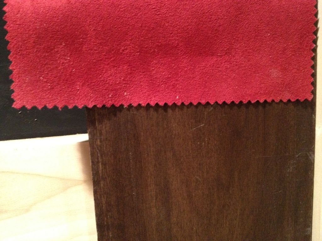

No progress without photos right?
Screen frame just needs French cleats and paint.
The door will be covered in wainscot and fabric so it will look more or less like the rest of the wall.

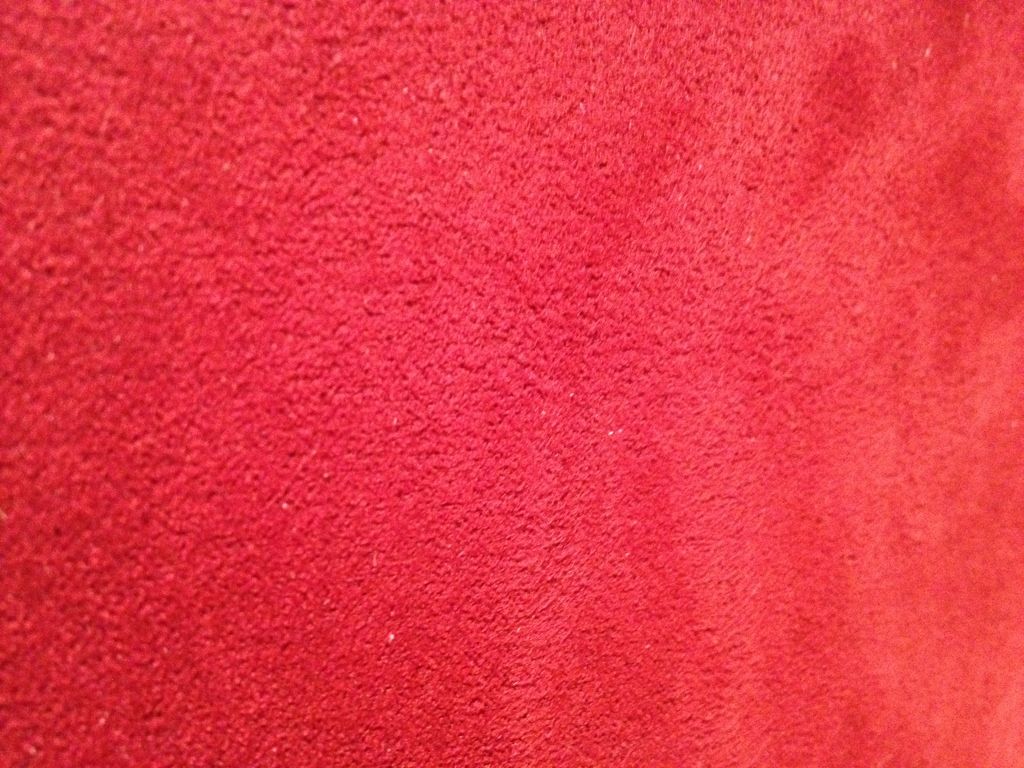

Close up of the fabric and a stain sample

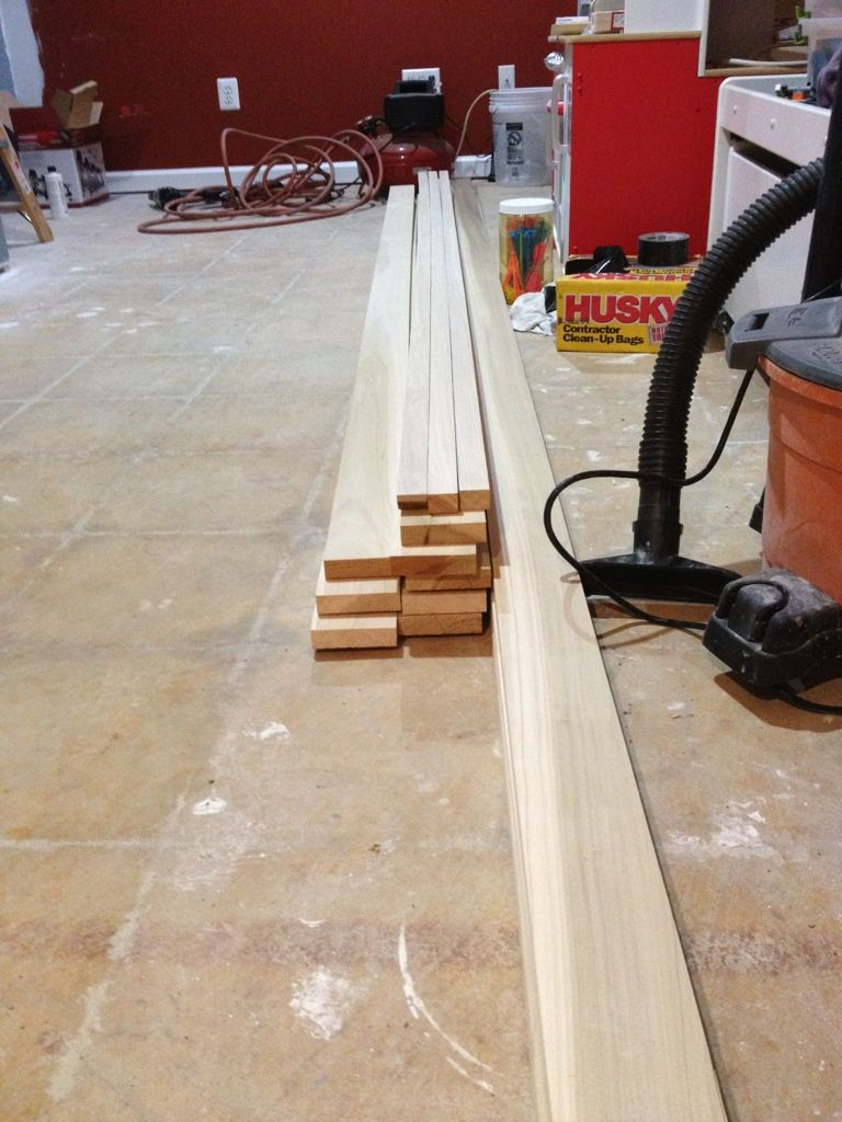

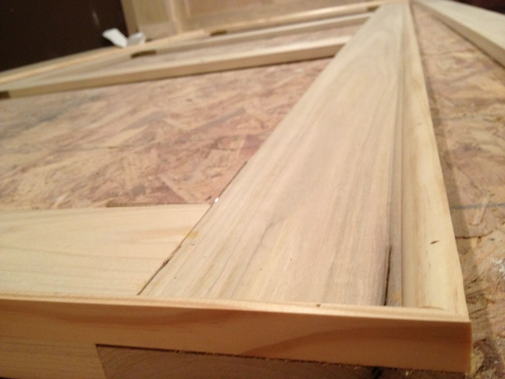

Probably overkill but I was already having a load of poplar planed so I just picked of a couple extra boards. The lumber was ripped to 5" and is 7/8" thick.
I have also decided to skip the panel mould and just do crown around the columns. I kind have a square/clean look going on with the columns and the wainscot as it is now and panel mould would not flow with that. Plus it saves time and money...

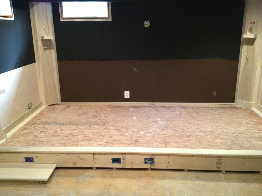

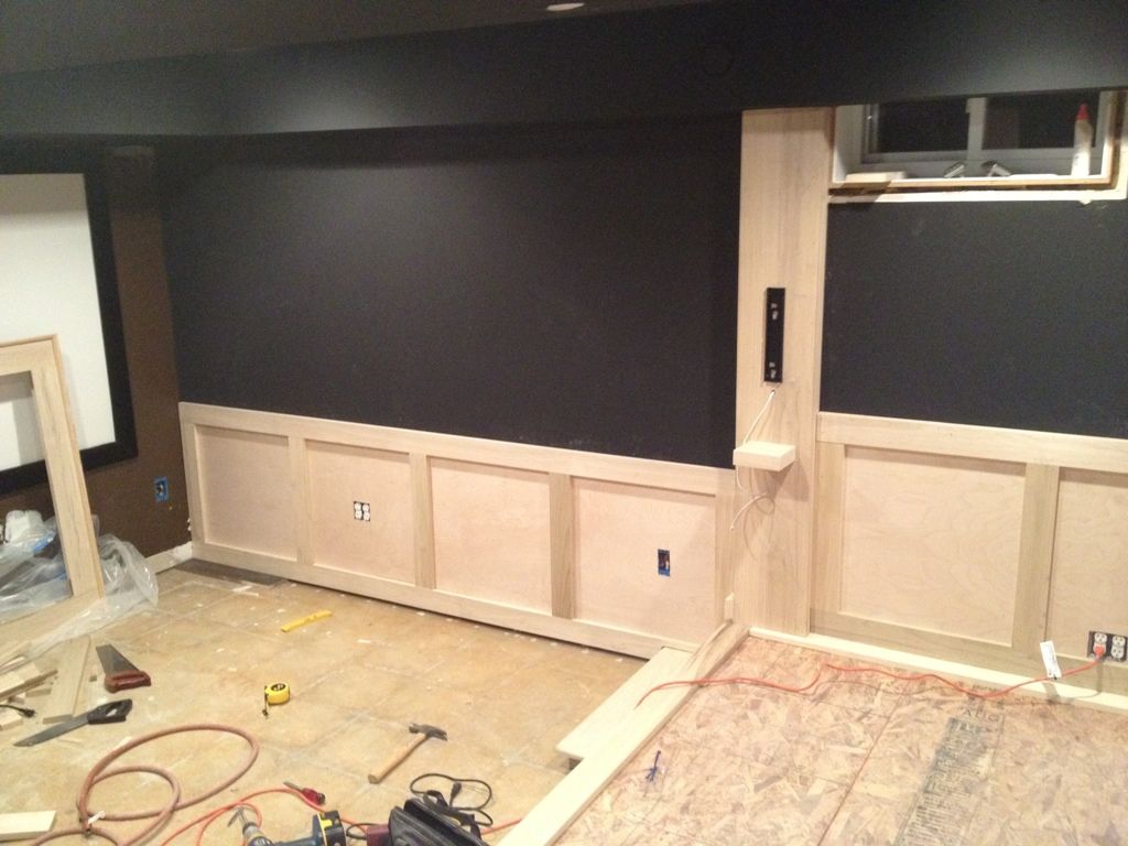

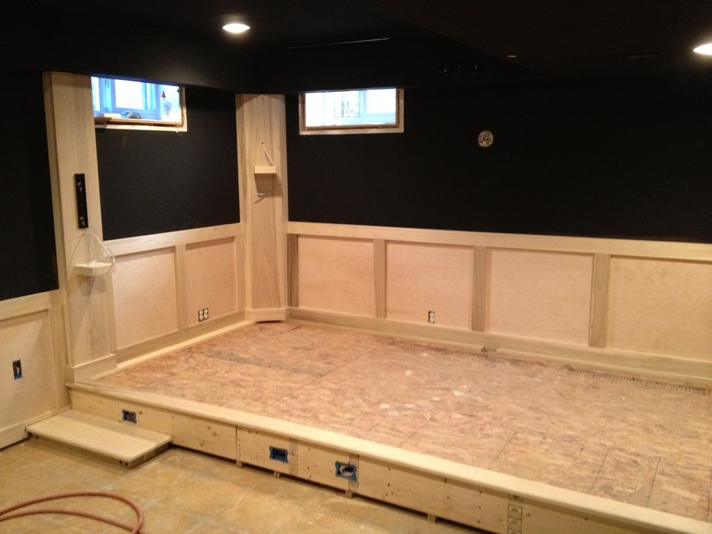

Today was a productive day. Pictures enclosed.
Before:
After:
I know poplar is a cheap hardwood but actually like it better than oak and maple, it can have some nice figure and coloration.
One thing I need to decide is if I will carry over the upper part of the wainscot on the back columns. I am carrying the bottom or base on all the columns but originally didn't plan on the upper chair rail portion. It can't go on the side columns because of the speaker placement so it may look odd just on two of them:

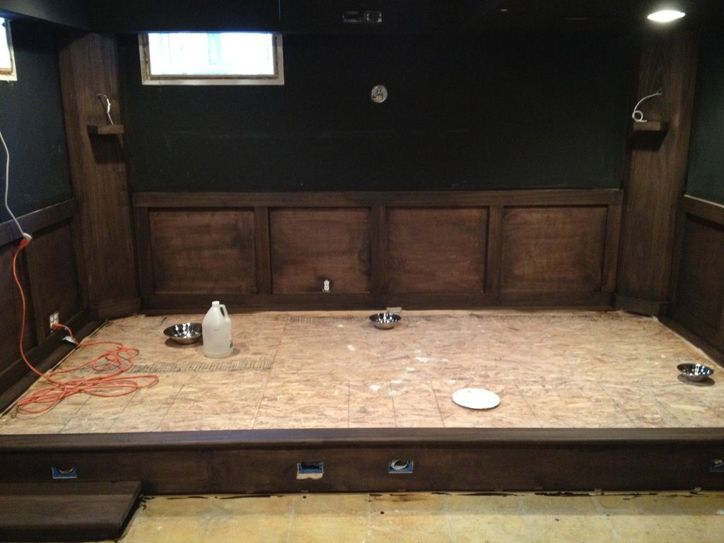

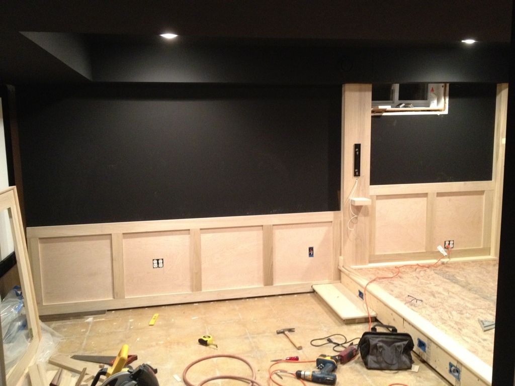

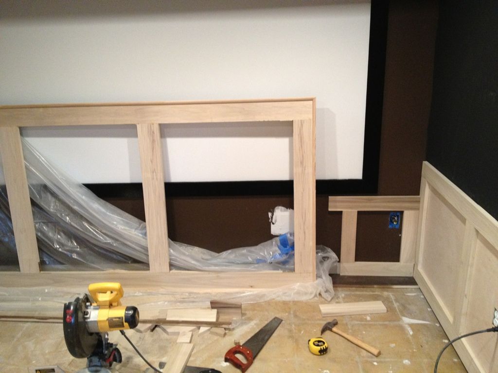

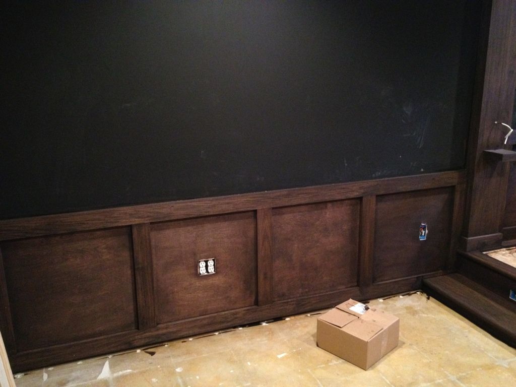

Today's progress, not as significant as yesterday with it being slower detail work.
I thought of doing wainscot on the front wall but I think I'll just go with base instead.
Here was a mockup I did to get a feel for it:
The Ravens finally make it back to the Superbowl and my theater is out of commission. Curse you hurricane Sandy. Oh well at least it will be a lot nicer space for next season.

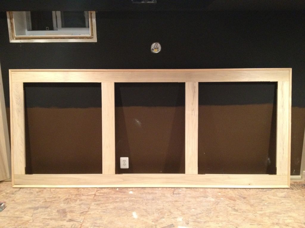

Riser front and step front/side is complete, the riser front is just attached with screws so it can be removed in case of flood (1.5” air gap under the riser). I’m currently working on the rack and sub door. Sub door is being glued now and once that is in place I’ll measure and build the rack door. While those bits are being glued I’m sanding all the columns and wainscot, I hope to stain at the end of the week or this weekend.
Acoustic panel fabric is on its way and the rack door will be the first one wrapped. I’ve found a local place for Linacoustic and its a lot cheaper than what I have found online although twice the amount I need. But then no reason to buy 50’ for more than I can buy 100’ right? I can always sell the rest.

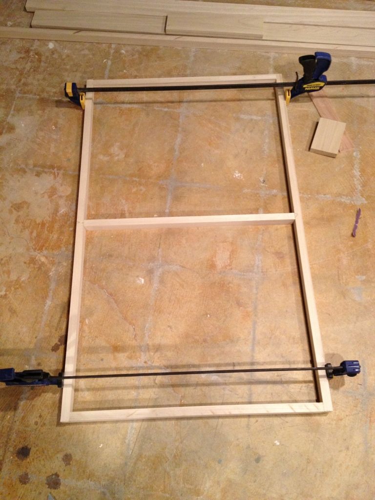

Also my fabric has come in, can’t wait to get started on frames. I made one frame last night for the rack door but I can’t really wrap or install any until the wood is stained and finished.
I did a sample stain with some wood conditioner first and a coat of lacquer and it came out nice. The only thing was the fumes on the lacquer were pretty bad so I’ll need to pick up a good respirator and I need to wait until it warms up a bit so I can open the basement windows and put a fan to help pull out the vapors.
Sanding is done and all wood has been wiped down so I’m ready for stain. I think I’ll have to wait until I can pre-condition and stain the entire room at one clip since most everything touches and it’s a lot of wood; hopefully Sunday.

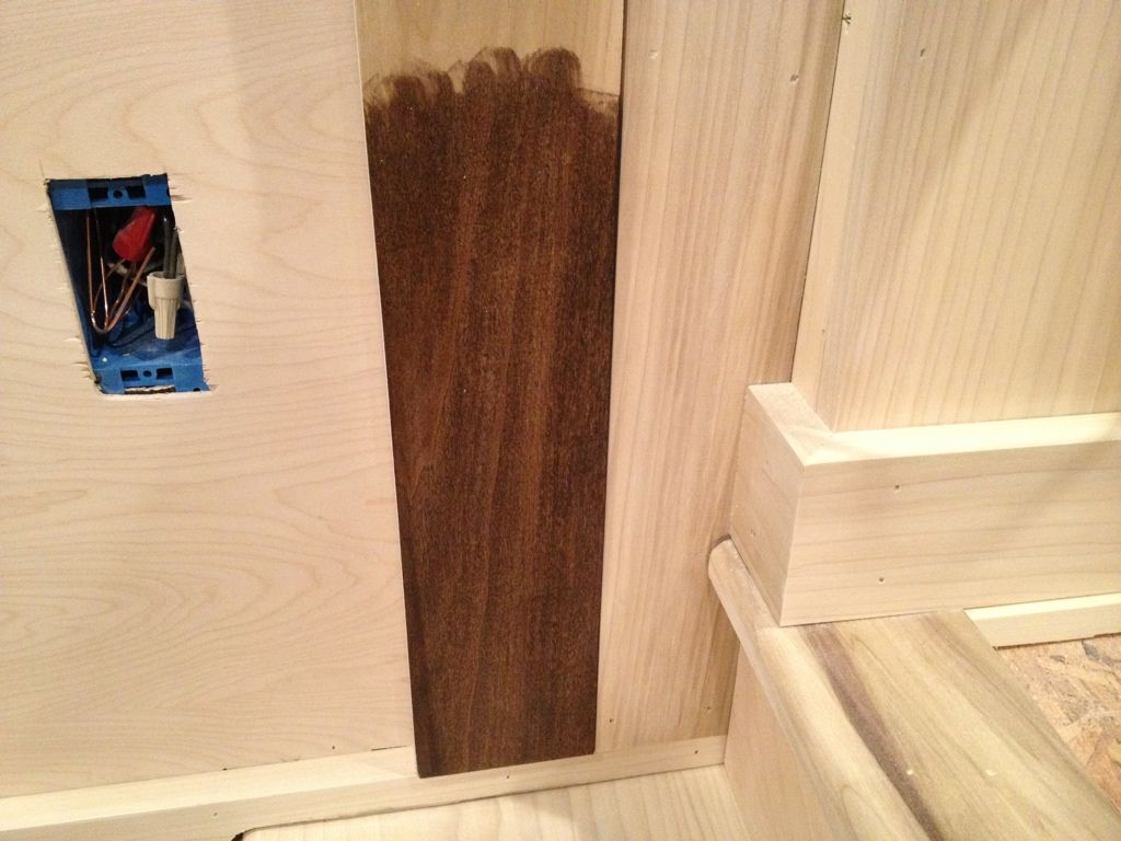

So here is what it is supposed to look like if it were attached:
And here are all the holes where I didn't get it right.
Here is the frame for the rack door. Which is essentially the same as the acoustic panel frames. Just adding hinges and a cabinet pull.
Stain sample:

I'll give that a try, I'm going to remove the hinge and sand, stain, finish the door the same time I do the rest of the room this weekend.

I could use magnets or even speaker grill ball/sockets probably as this is just the covering for the sub (the inner part will be covered by acoustical fabric). The "door" above it will need hinges as it's where the rack will be (the door is going to be wrapped like the rest of the acoustic treatments just with no insulation so the IR signals will pass through). I was getting hinges for the one so I just ordered two more for the sub door.
As to the stain I’m using this pre-conditioner since its poplar:
This is the finish:
I’d use something a bit more involved if I was just doing a piece of furniture but I don’t want to spend weeks putting on 5-6 coats and sanding all that wood between each coat.

post #119 of 316 Old 01-27-2013, 10:17 AM - Thread Starter
design1stcode2nd's Avatar
Posts: 892
Quoted: 31 Post(s)
Liked: 44
Staining is done but man the fumes are bad. I was fine with the respirator but even with the windows open and a fan it's going through the house. I have all the vents closed and some main floor windows open. Of course it's 25 degrees outside which doesn't help. Going to try some bowls of vinegar and a box of baking soda to help absorb the smell.
Going to have to take a day off from work to lacquer so that the kids and wife are not in the house. And when it's warmer.
Play like a Raven
design1stcode2nd is offline
post #120 of 316 Old 01-27-2013, 02:35 PM - Thread Starter
Posts: 892
Quoted: 31 Post(s)
Liked: 44
Pics
Play like a Raven
