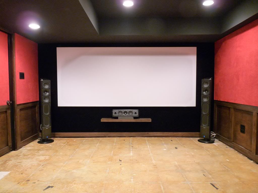

Old 03-01-2013, 07:20 AM - Thread Starter
design1stcode2nd's Avatar
Posts: 893
Quoted: 31 Post(s)

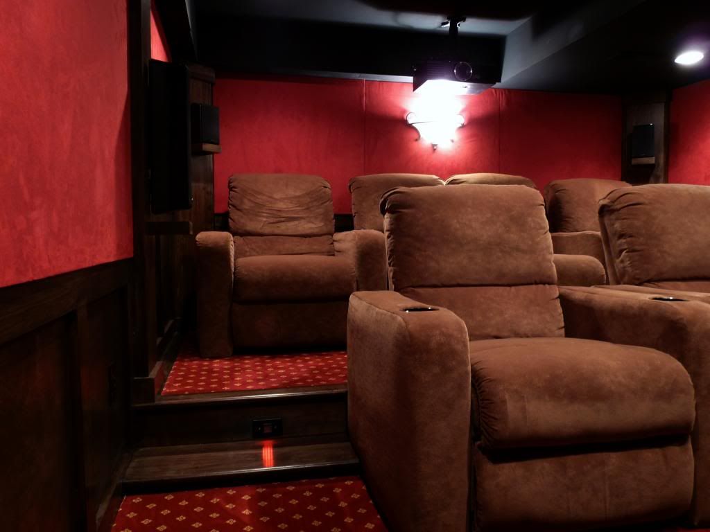

Liked: 44

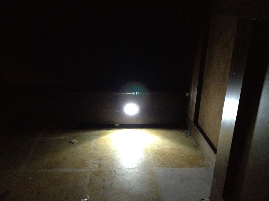

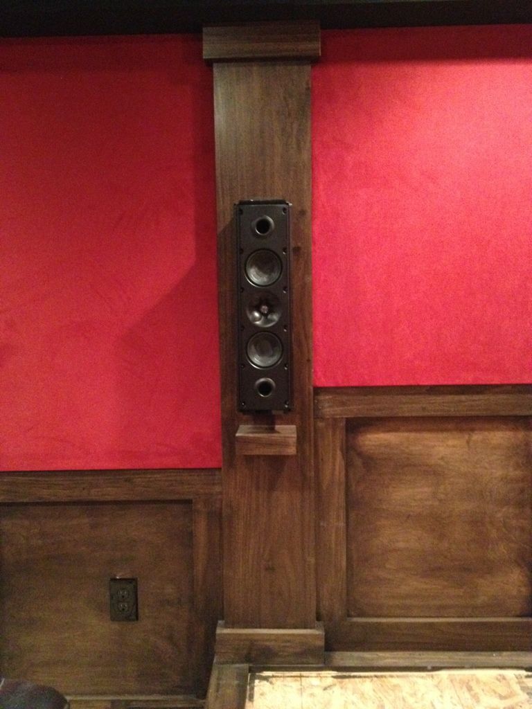

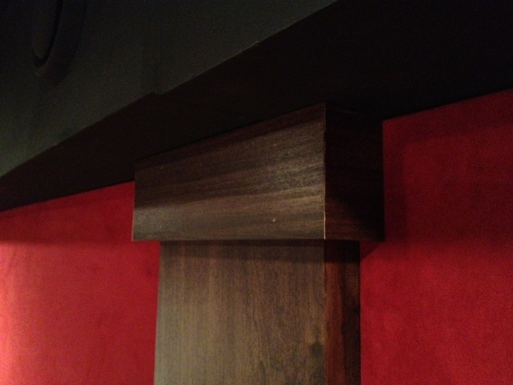

I got the rest of my trim up, I would have really like to have done crown molding but with the need to have the windows accessible, the rack door would have hit it and the soffit not being wide enough on the right side it wasn’t an option. So what I went with is just the same base I used around the rest of the room. I also wanted the panels to still be removable so the side pieces are affixed to the columns with Velcro instead of nails. Pictures below on the process:
One inch indentation
And installed
The light output on my step lights is pretty high, here it is with the louvered plate off
The plates are being painted black now and I’ll have the red gels installed sometime next week. I think there are 12 LED’s on these.

I put the lightest red gel I purchased in and it really kills the step lights. I'll have to order something more transparent at some point.
I'm also debating putting two recliners in the theater while I wait on carpet to be installed. Other than finishing up the rack door which should be done this weekend there is nothing left to do inside the theater. Doesn't this picture just say "I need carpet!"

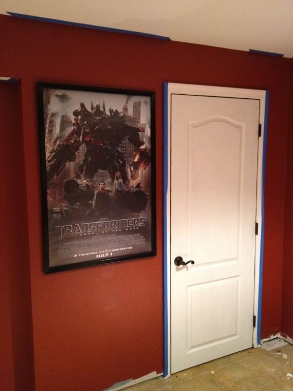

The rack door is finished and everything is cleaned up and waiting on carpet. Other than making 16:9 panels for the screen the theater is finished. Hopefully the carpet will be in shortly as I can't do too much outside the theater until my recliners are out of storage. I need the storage space they occupy for what is currently outside the theater before I can tile.
I plan on painting the area outside the theater this week and I'll hang a poster where the TV/Lighted poster will be. I guess I could try building the movie storage although I can't install it until tile is complete.
After four months of always having something to do with the basement it feels odd it not being done but yet not being able to work in it.

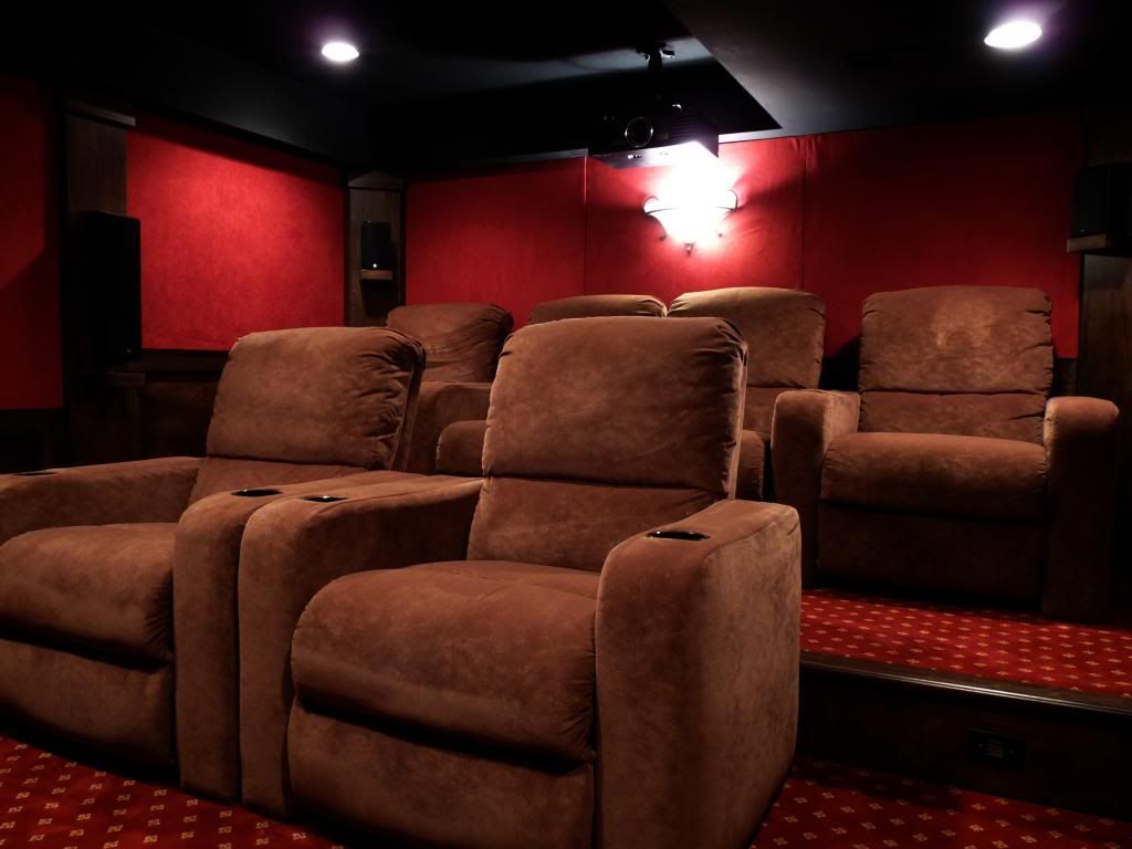

Old 03-16-2013, 09:10 AM - Thread Starter
Posts: 893
Quoted: 31 Post(s)
Liked: 44

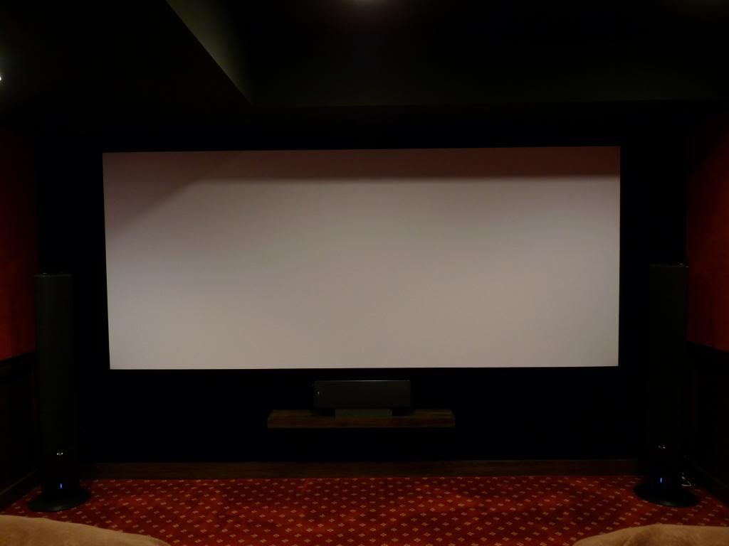

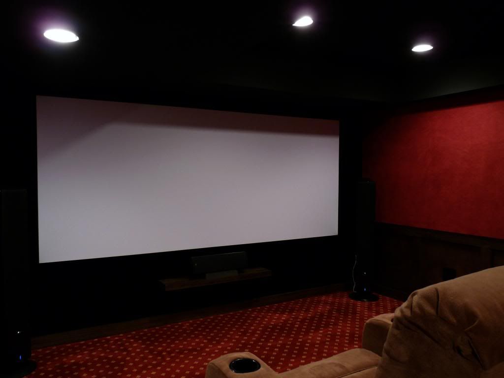

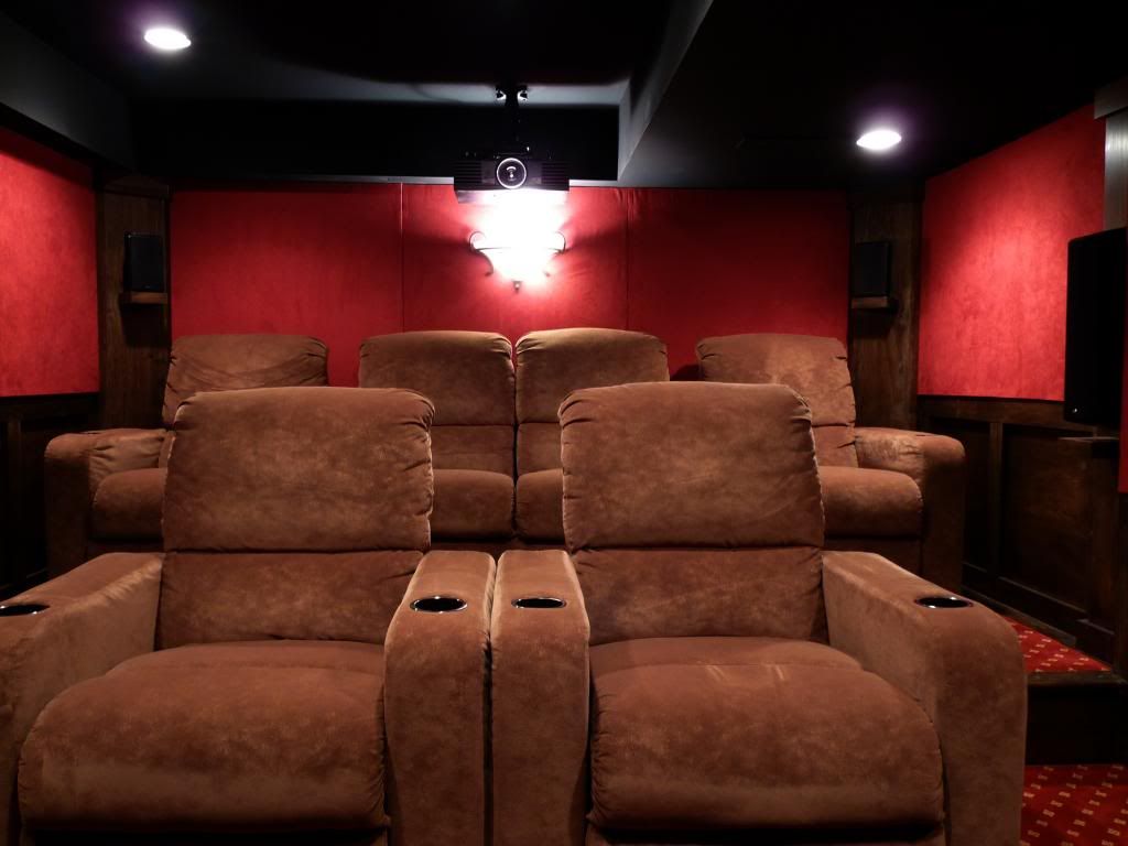

Theater is done.

Old 03-17-2013, 08:17 AM - Thread Starter
Posts: 893
Quoted: 31 Post(s)
Liked: 44
Originally Posted by landshark1 View Post

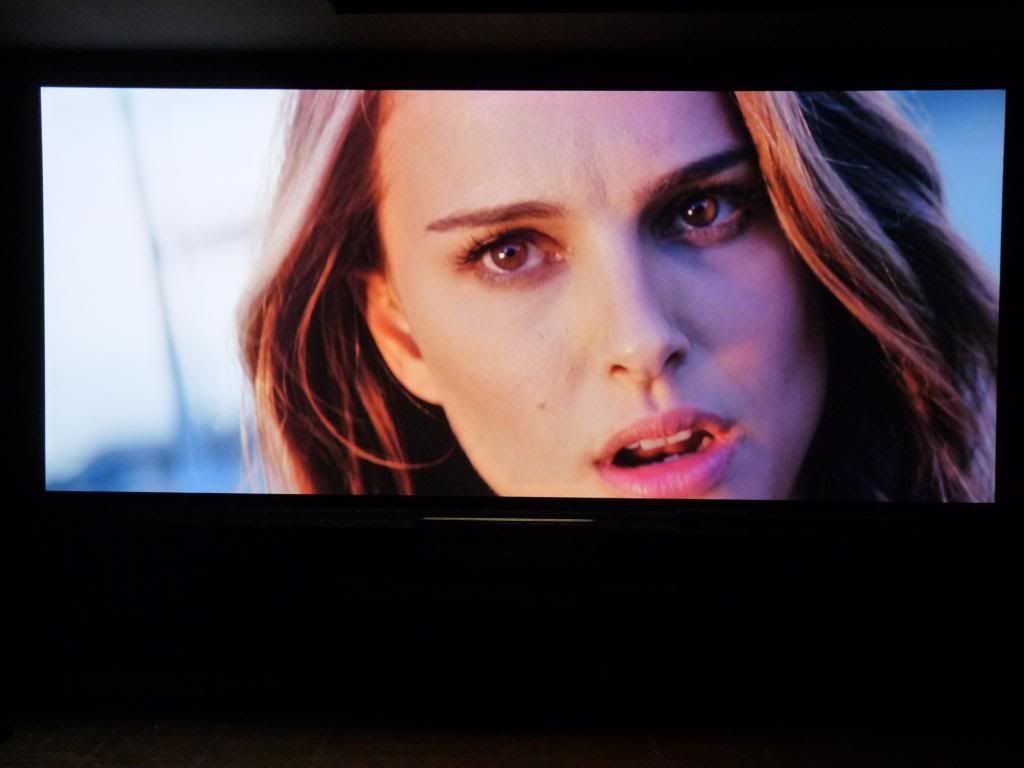

I'm sure you've mentioned it somewhere, but what size is the screen and how far away you sit?
Thanks everyone. It is good to finally be done with the theater. I still have the area outside the theater to do so plenty of work left. Now that the chairs are out of the storage area I can clear the space for tile. It's not a huge space but it will take a while 250sq feet when you are cutting, thinseting, and laying yourself goes slowly.
The screen is 120", 2.35:1 and I think 96", 1.78:1. First row eyes are at 9' when reclining and back row is 14' 6" reclined.
