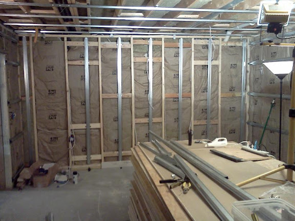

Ceiling insulation is in and the HVAC flex is in for the supplies, I will work on the returns tonight.
The roxul only fills the first 1/3 of each cavity, I have plenty of room if I want to add some faced fiberglass batts but I don't know if there is any additional acoustic benefit to piling on top of the roxul.
I may work on some of the drywalling this weekend but I need to check with Ted and see what order the sheets go up or if it matters much. Also if you have to always end each sheet halfway down the hat channel, like you would if it were going against studs.

Really, once an air cavity is 50% - 70% full, there's not a real improvement adding more insulation.
Take a peek at the WhisperClip SIM for drywall application diagrams, but essentially your first layer is ceiling, then walls. Then celing again, often perpendicular to the first layer, then the second layer on the wall, also perpendicular.
This is the great advantage of multi-layered applications that comes with field installations. Exotic drywall in single layers will always combat seams and seal failures.

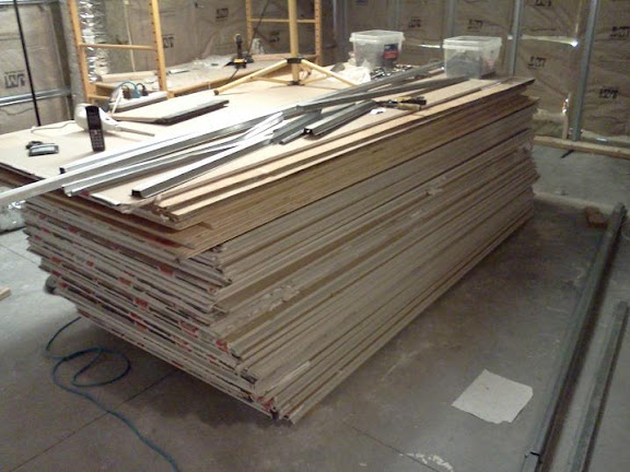

The Berklines are coming in today from UPS, I'm nowhere near ready for them though
Worked all weekend and it seems like no visible progress aside from:
It took a while to pick all that up from Lowe's and carry it downstairs. Many thanks to my friend CJ for helping with it all, I doubt he knew what he was getting into when I asked him to help me move some drywall.
The clips and channel are all installed, I'm glad it's done but I'm almost wishing I had skipped them altogether. I hope they turn out to be worth it.
I borrowed a drywall lift from Woolly last night, might try and get a few panels hung this evening.

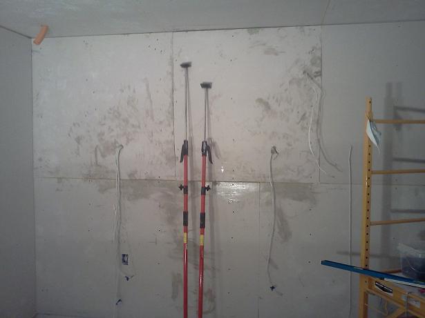

The first and second layers of drywall are done. I would be just fine with never having to work with greenglue for the rest of my life.
I had a minor greenglue disaster over the weekend while trying to hang a 4x8 5/8th" sheet solo. I had it coated in greenglue and hoisted it up horizontally against the ceiling, while holding it in place I reached for my impact driver so I could screw it in...and found that the impact driver was just out of reach.
Tried to hold the drywall up while grabbing out for the impact driver and the whole thing came crashing down, breaking up the drywall, greenglue flying all over.
It's ugly and it was frustrating but I guess since it will be covered with insulation and behind the screenwall nobody will ever see it.
Started in on the soffits, using a design that I saw from Big and Jesto. I wasn't sure they would be very strong but Big assured me it was, and of course he was right.

The channels weren't too bad, most of the time I would remember to mark the end locations so I could snap a chalk line down the longer runs, that helped a lot. For the shorter areas I could eyeball it and generally get it pretty close.
I have some greenglue left over, I will use some on the soffits but it wont be much, I'm thinking about greengluing a thick piece of MDF to the inside of the theater room door and then wrapping that in gom to match the walls.

Priorities shifted a bit, we found out that we are going to be parents! The theater is still going in, but the big man cave I was going to build on the other side is going to be a kids playroom instead. Well, a kids playroom with a bar, beverage fridge and popcorn popper.
I've got the room completed and ready for drywall. Called the drywallers, he said he would be out this week.
I've got a pic of the main room and bathroom, you can see the bev fridge I just picked up, and the door on the left will cover the sump pit.
And a picture of the deep equipment closet under the stairs:
