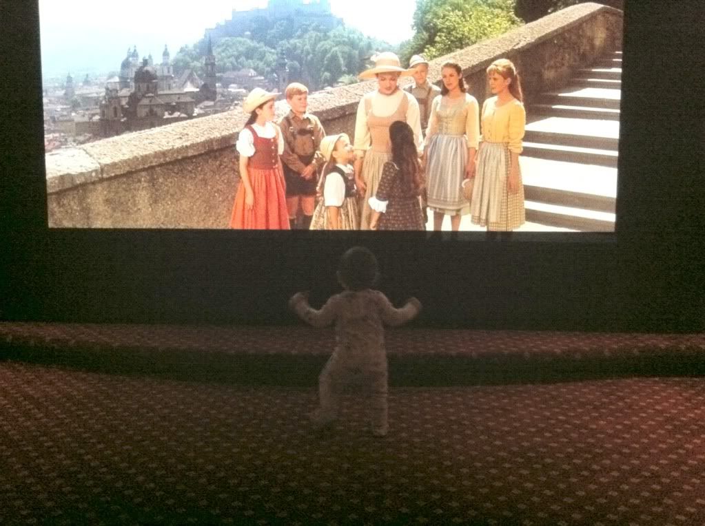

The basement is coming along great. Thought I'd pop this picture in as it shows theater as baby sitter from Jesto's. She was about one in this shot.

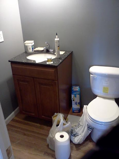

I've been making progress on the outer room, equipment closet and bathroom. These should all be completed in the next week or two and I will get to start back in on the theater. A few progress pictures:

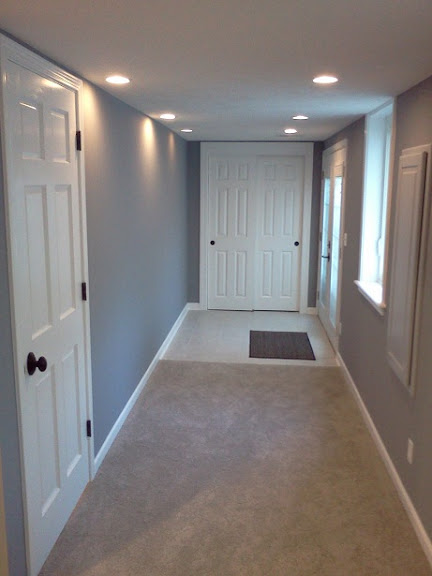

Finished the bar area and the dricore. Carpet goes in next week.

Man I can't believe how clean it is down there. nothing to trip over Tile turned out nice

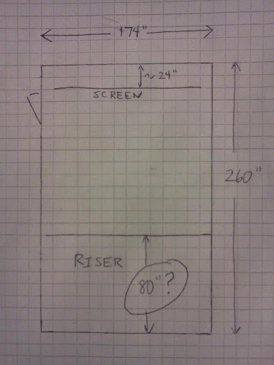

Starting back in on the theater soon, last night I got actual measurements of the finished room.
final size was 14 1/2 feet wide by 21 2/3 long. Screen wall approximately 2' deep. Thinking of making the riser 80" deep.

That seems about right. My room is almost the same length, and my riser will be 82" and screen wall will be 2.5' deep.

My riser is 90" I wanted to be able to walk in front of the chairs if they were reclined and have at least 12" off the rear wall. If you went 90" you could have your first step go into the riser rather then having it stick out.

After talking with Big yesterday it looks like the new riser depth is going to be 88".

remember you will be adding treatments and trim so add that in

Totally forgot about taking that into account, should be fine though, since I'll be buying 8' 2x10's and trimming them down. When it comes time to build the riser in a couple weeks, you'll have to come over and help.
