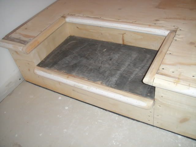

Main stage is built and the sand is going in. I'll make a curve on the front to match the curved ceiling above.

the framing for the riser is done. I used 2x10's for the outside and 2x8's for the joists. It's built on top of roofing felt and will have insulation in between the joists. I have the linear bar diffusors to use at the sides and back so it will also act as a bass trap.

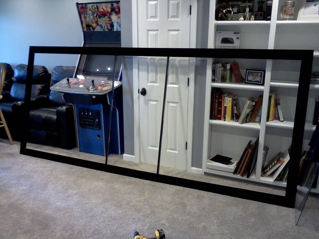

The good news: Woolly and I got the screen put together fairly painlessly. The instructions that James includes with the screens are the non AT screen instructions, with non AT pictures, but then includes footnotes if you have an AT screen. We didn't know that, and due to poor reading comprehension and going off photos rather than words, we did a few things wrong the first time. After realizing this and fully reading the instructions, we got it put together. (don't be like us, read the instructions fully before starting!)
The bad news: James sent me the wrong size screen. I ordered a 10' wide 2.4:1 screen, what I received is a 10.55' wide 2.52:1 screen.
The not as good as the good news: I called James, he answered right away, I told him the issue and he is going to get new top and bottoms sent off to me in a few days. I should be able to re-use the sides and the fabric.
The quality of the frame seems just fine. Learning from others past mistakes, I used a hand screwdriver when assembling so I wouldn't over tighten and strip out the wood screws and the frame. I did pre-drill very small pilot holes for the wood screws. The quality of the black velvet James uses seems good.
I spent some time working on the curve at the front of the stage and I hope to complete that today and get the stage top put on. I tried to match the stage curve to my proscenium curve and I think I came close:
I think when it is carpeted it should look like Jesto's stage did in his Bethesda build:
nebrunner is online now

Odd about the wrong size frame - were you thinking 10' wide total (including frame) and he was thinking 10' wide viewable?
Remember to spray those vertical supports flat black - they do show through the screen material if you don't.

Nope we were pretty set on 10' viewable, he just made some kind of mistake. I don't need it immediately and he said he would have a replacement made and sent out in a few days, so it shouldn't be too big of a deal. I am glad I didn't wait a couple weeks and assemble it the day I want to hang it and watch a movie!
If you look close to the picture, they are sprayed black, it came that way so I think he has refined his process somewhere along the way.

Could you take a closeup pic of the back of your screen frame? I'd like to have a better idea of how the wood trim and aluminum frame come together and overall method of assembly.
I'm about ready to pull the trigger on a screen and the Jamestown frame is at the top of my list due to price. However, with the high humidity here in Houston, I have some reservations about the wood trim. Do you think the aluminum frame will help keep things squared up?
The simplicity of the grommet and o-ring system on the Seymour frames is very appealing, but it comes at a price. I'm also waiting for a quote from SMX, but I'm guessing that will be even higher than Seymour.
The Jamestown method is pretty simple as well - screen fabric is notched, and is held between the wood (poplar I believe) frame and the square aluminum tubing, by screws every 6" or so. To adjust tension, you just loosen a screw or two, pull the fabric tight, and tighten the screws.
Brad Horstkotte is offline
post #120 of 398 Old 05-28-2012, 01:21 PM
Spaceman's Avatar
Location: North Houston
Posts: 2,035
Mentioned: 8 Post(s)
Quoted: 41 Post(s)
Liked: 139
Thanks, Brad. I forgot you have been down this road before and already had a screen thread. I think I'll try Jamestown and put my savings into my surround speakers.
