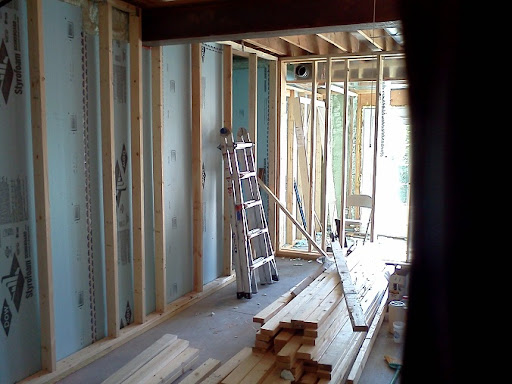

I tore down the supports under the stairs and added a header, this will be used as the equipment closet:
Removed the studs along the side of the stairs and cut away all the drywall to open it up. Tomorrow I'll frame out a little wall to add the new railing:
It already feels great to have that opened up. When you come down the stairs you can look to the left and it makes the room seem bigger.

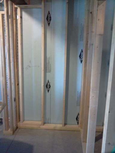

Will this area work for a built in shelf? It is 9 1/2" deep.
Farther back picture of the area:

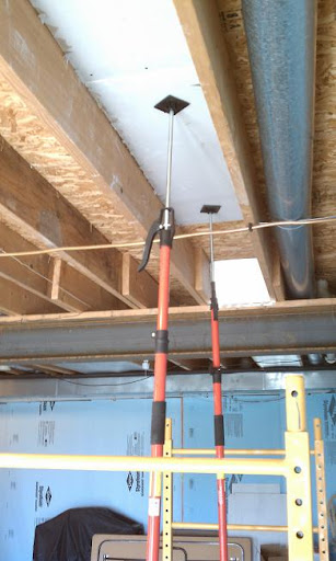

I've been putting in the can lights in the main basement room, wasn't sure what bulbs to use so I picked up a variety to try out.
Going to compare the normal BR30 65watt floods against some equivalent CFL floods and also try my first LED flood.

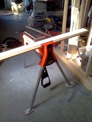

And I bought a new toy, been wanting one of these for a while but I couldn't bring myself to spend the money on one. I was at Menards today picking up some romex and saw these on closeout for 50% off.

What kind of clamping tool is that? I think I saw one a long time ago. I'll call the local Menards to see if they have any in stock. Also, how do you like it? Oh, and looking good so far!

That is a Port-A-Mate MegaVise. It may be a Menards house brand, they had it sitting next to the Rockwell Jawhorse so I was able to get a close look at both, it looked like a part for part remake of the Jawhorse so I felt like it was a good deal at half the price.
