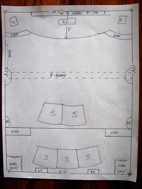

OK...here's a plan I drew on how my finish will look like.
I've added the front stage and back stage which I did not have on my previous HT room.
Please remember I've had a HT ROOM for approx 15 years now. It's that I have completely stripped down my basement and want to start over with PROPER soundproofing being my main objective.
Here's the quick drawing I made...please accept my apology for the quality and lack of drawing skills.
Thank you all

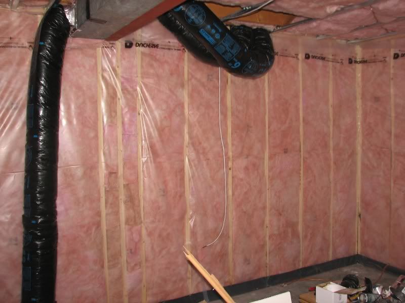

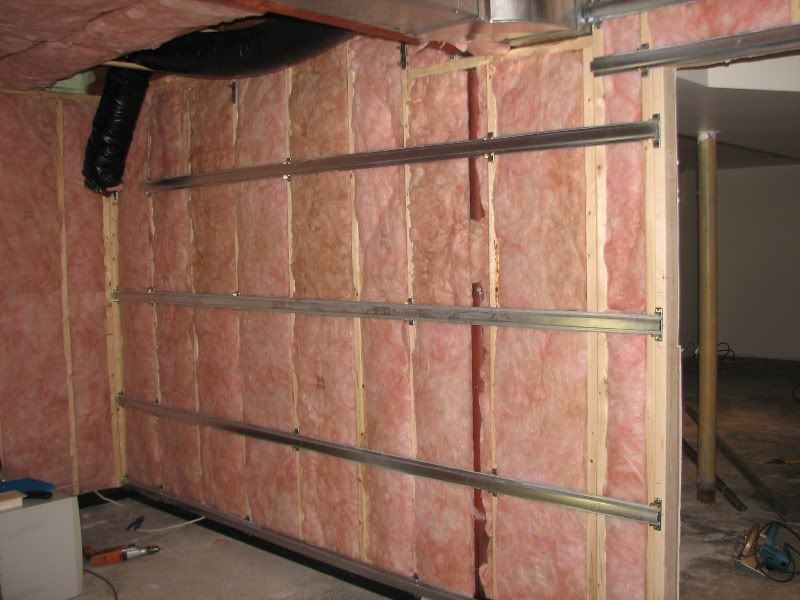

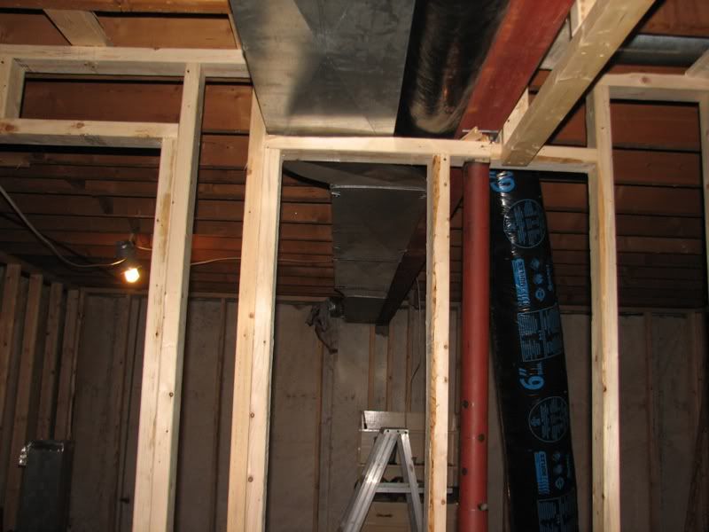

Well I almost finished the framing.
My next move is to rework the duct work.
I'll be redoing it soon I hope.
Here's most of the framing done and how it looks.
All 2x4 all around 16 apart.
Now I need to order some...

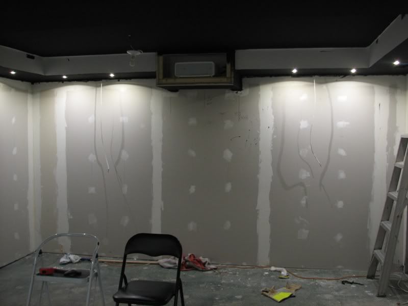

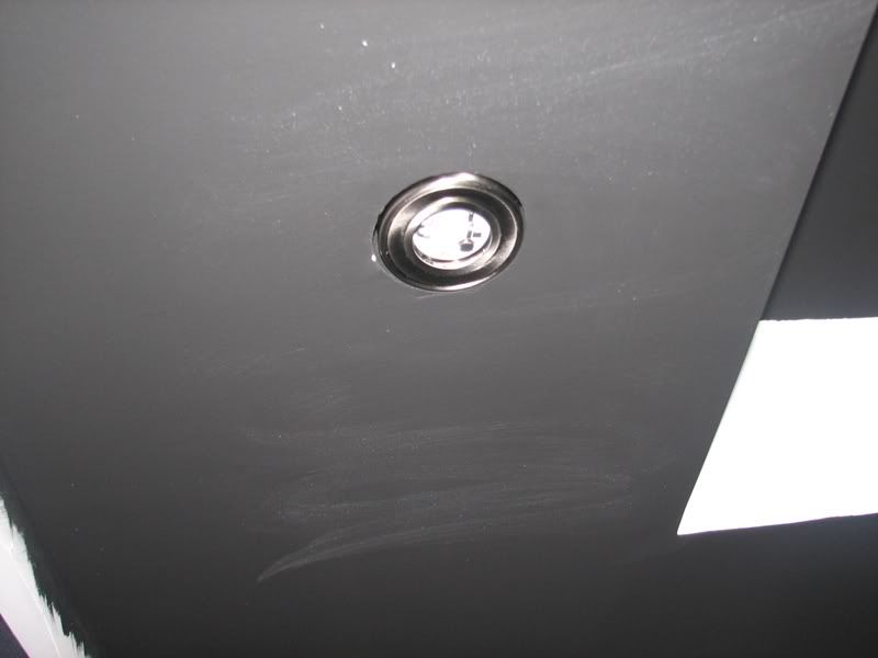

Well it's been awhile now but I have made some progress.
I had to finish the other room 1st.
Now I'll be concentrating on finishing the HT room.
Some pictures.

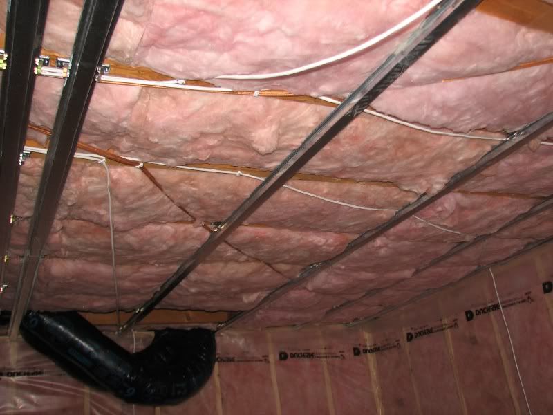

This is my reworked duct
Insulation and whisper clips with Hat channel installed
Vapor barrier installed.
Whisper clips and hat channel installed on ceiling with speaker wiring
Rear of room now with DD and GG with soffit and puck lights installed.
Front of room now with DD and GG with soffit and puck lights installed.
Puck lights installed
Both Vents (1 out and 1 return) are backer boxed with sonopan filled
