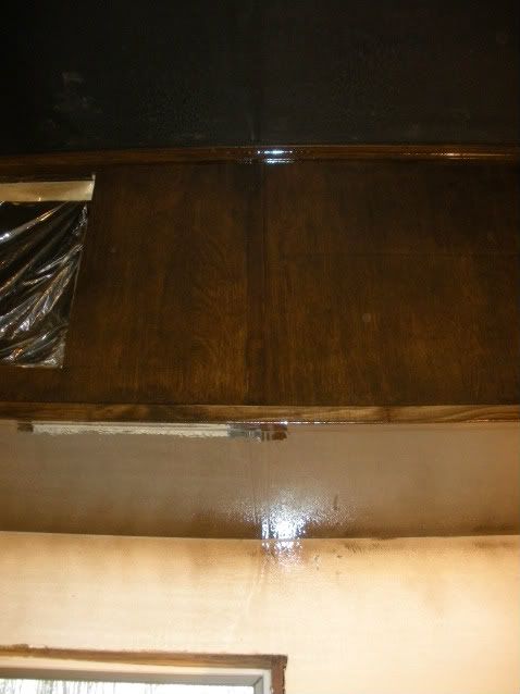

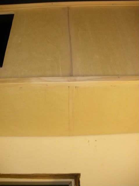

Staining has started....here's 1st pic.
I've got a couple of butt-joiints next to sub portal that I'm not happy w/ regarding the amount of filler; it will stain too thick. So I'll be getting a small roll of birch tape (w/ glue) that I'll iron on over the joint. This will leave a small edge that will create a "panel" look of sort, but I don't think I'll mind staring at that vs a heavy dark line...like the one in the upper left corner soffit in the pic above.

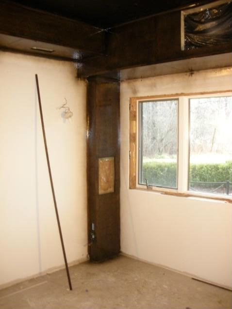

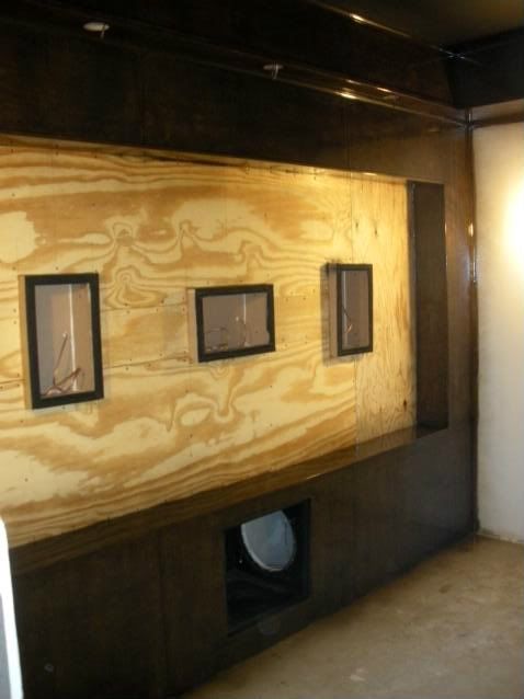

All the wood staining is done. Clear coat is on and drying now. A couple of spots where it's too heavy...we'll see how it dries.
Here's a shot of the screen wall...
Rear columns...
the molding against the wall is for the speaker frames to be built.
Below is a close up of an area showing before/after on adding the edge tape to cover my not-so-spectacular craftsmanship skills (gaps). I'm happy with how the tape ended up finishing...much better than the dark fill lines if it wasn't added.

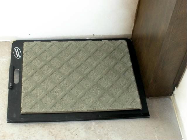

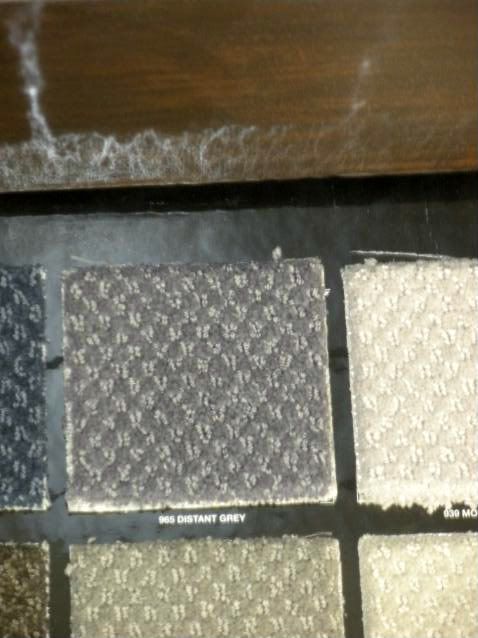

We've decided on the carpet for the theater (and the rest of the basement). I'm going to work around this 1st piece and find the other elements to compliment it (not too many in my small space) - sconces, wall paint, rear wall drape/fabric.
Theater;
This is from Dixie Home; Style = 1147 Ellsworth and Color = 124 Search
For the rest of the basement;
This is from Mohawk Signature Series; Style = 1124 Serene Ground and Color = 965 Distant Grey

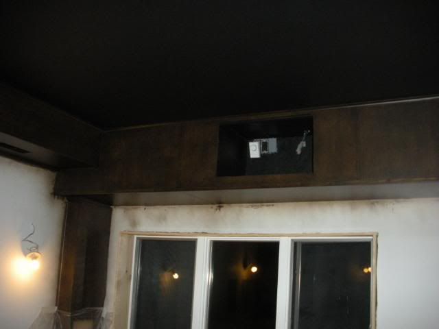

They are done and stained; here's a couple of pics of just after finish coat (wet)...
And now (dry)....
I'll still have to work out a door/cover for the PJ box. I've got the hardware and idea, but don't need it yet (since I haven't settled on the PJ)....
Hope that helps for something.

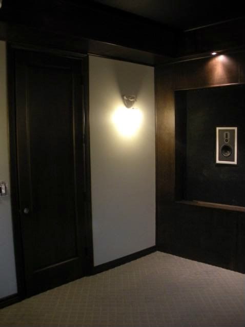

The door and special wide jamb came in...sorry about pics; I totally forgot to get a clean shot after I hung it.
Also, with the door, the casing and base moldings....lined up like good little soldiers...

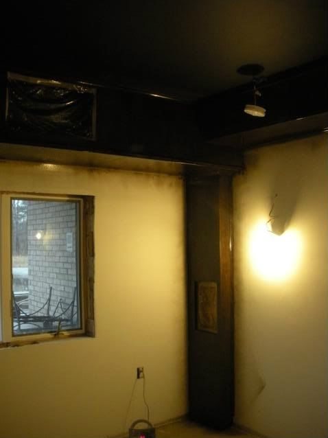

And here's pics of the staining...as of tonight.
2nd finish coat done and drying and probably be ready for install on Friday.
Tomorrow, some staining touch ups and paint the 2 side walls.
BTW, we have chosen the paint color on the Left in the pic above...called Bedford Gray.

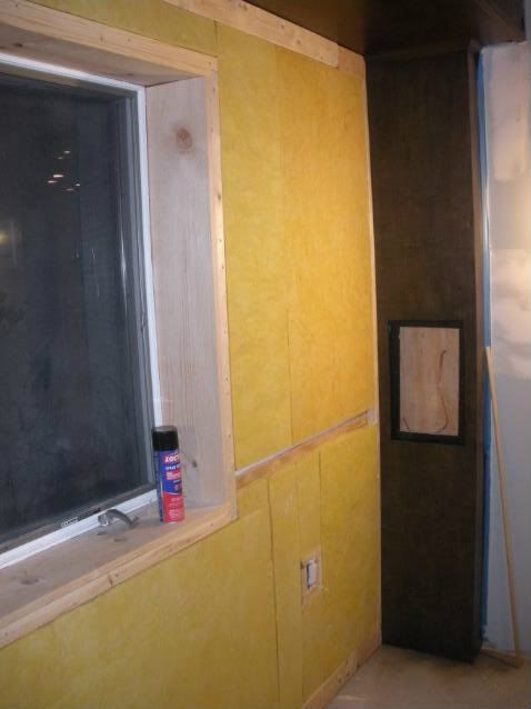

I also worked on the rear wall; added firring strips and the OC703 (2").
the horizontal strip on right side is waiting for my 1 piece of fabricmate track to get here

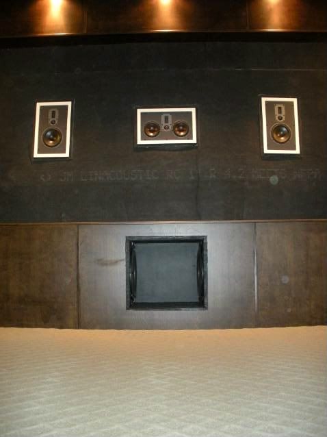

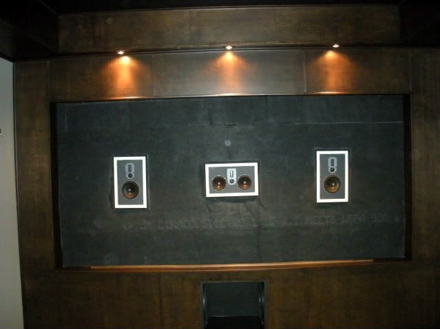

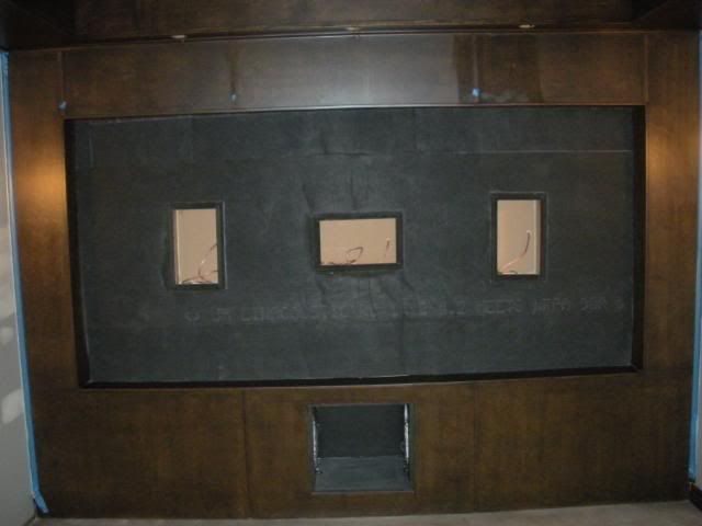

So not to waste some of the day, I connected the 3 screen lights and installed the speakers. Of course, I haadd to hear the system....the IB's were kicking finally and shook the house like I had been waiting for
Here's a screen wall updated shot...

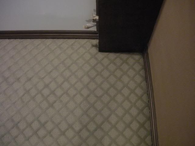

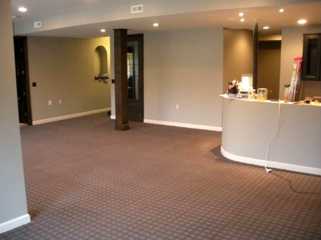

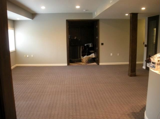

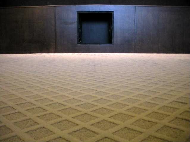

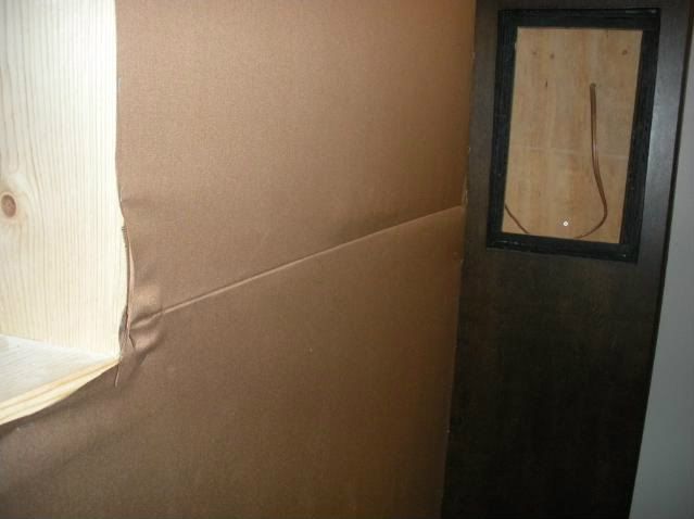

Alright! Carpet is installed and I love it; both the theater and the rest of the basement. Best mistake a salesmen made on the measurements; the carpet we put in the rest of the basement is sooo much better than what we originally picked.
Here's basement, view from theater doorway.
Basement from corner.
The camera I have is nothing special and it shows by not being able to pick up the colors very well; especially the HT carpet.
Here's theater.
Ground level view towards IB/screen wall.
Close up in rear corner/column (camera issues shown here).

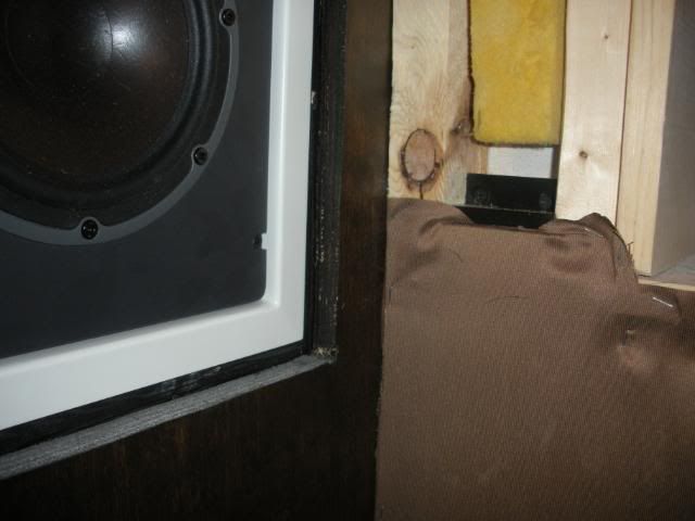

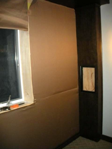

Also tried to finish up the back wall fabric. Will get to it later this week. Here are a few pics.
Close up of seam. Fabricmate is very clean. The edges will be covered by casing for the window and in the corner by the column a piece of 1/4 round.
Other side of window; small piece to show how I laid things in.
Looks great, glad you are making progress.
So next up on the list for the room...
- speaker grills/frames
Aren't your speakers going behind your screen? Why do you need speaker grills/frames?
Oh, never mind. You must be referring to the covers for your surrounds.
Carry on...
