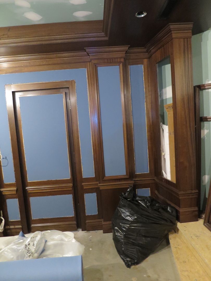

hidden doors take some special hinges to get the swing right for clearance of the 2 inch acoustical treatment called for in the typical Erskine plan. Steve, who builds Erskine theaters builds those doors in Atlanta. He has a custom cabinetry shop (his day job) and builds them for each project. If you have the $$ you could ask him for a bid on a door then drive to Atlanta and pick it up. it will be 4 figures.
I've been using 1 3/4 thick birch veneer MDF solid core doors and haven't attempted to make it "hidden" just mounted acoustical treatments in the inside of the door set back from the edge for clearance.
Some guys have added one or two layers of 1/2 MDF with GG to the basic flush door for added STC. You will also need to purchase door seals.
this is an example of an out swinging door

another out swinging door with 2 inches of Quest material, The final trim isn't on the door on this job which will hide the staples and fabric edges. A custom woodworker did the Mahogany work in the theater, it is beautiful. I just stapled the fabric

Here's the look and I'm going to go the quest route as well. It's also a swing out door. Does Steve work for Dennis?

There have been plenty of documented Erskine builds but scant details on Steve's magic doors, maybe intentionally.

That multitude machine is NICE! Thanks for posting that. I'm going to have to look them up when I get the rest of my basement finished.
