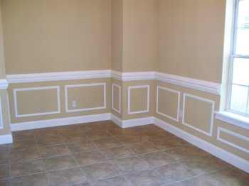

post #141 of 1329 Old 01-21-2012, 06:27 PM - Thread Starter
chinadog's Avatar
Location: Knoxville, TN
Posts: 5,832
Quoted: 77 Post(s)
Liked: 284
OK!
Started playing a little bit with Sketchup today, just to get some beginnings of a design done. This is no where were I would want it to be, I just had enough of working with sketch up for the day. First, the room dimensions are 19L x 13.5w x 8.5h. I don't have the doors in the correct position and my columns are not at all what I was thinking, they're not in the right place nor really designed anything like I really am thinking. Still no decision of where the rack will go, depends on what I can do with the cold room if anything. One option, which I'm not necessarily in love with is putting the rack in the front right of the room since it can go under the stairs there.
I'd really like to do some sort of wainscotting this time, maybe something relatively low, like two feet or so. Thinking off using some dark wood, maybe doing the inside in fabric. Above the wainscot I would do some sort of design, not so plain like the design shows. Would like to do some real nice wood columns. Due to the door to the cold room, I may just do the one row and have a counter behind it. 99% of the time it's me and the kids in the room, sometimes the wife will join us, so no really need for a second row. A counter would be fine for overflow. I'd also like to do a coffered ceiling maybe this time. Something simple and not over the top.
This is beautiful and congrats to whoever has this theater, I'm not sure who's this is, but I would like to do something similar, not the same colors and not quite as elaborate around the ceiling.
I really like Mario's design as well.

I really like the look of msujdog's wainscotting here.
I also like the "picture fame" look.
Here is a simpler design/look.
Well after posting the photos, I guess you did not necessarily need examples huh? Oh well just thought I'd help out a little.

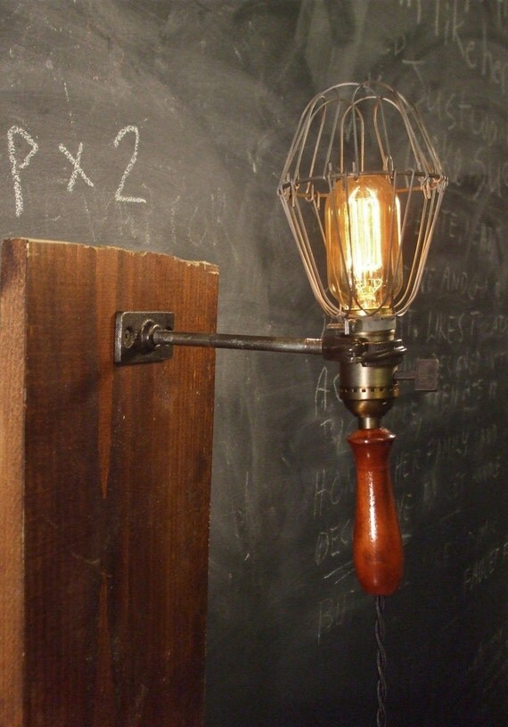

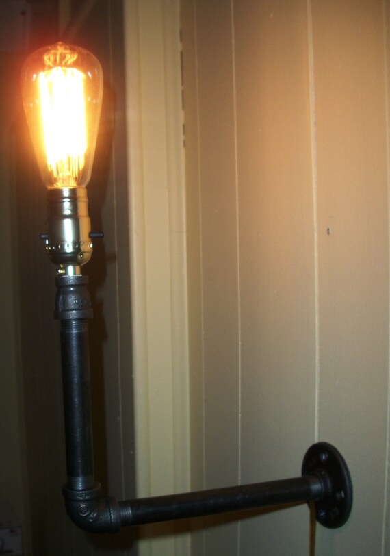

Bud,
I have noticed those fixtures/bulbs as well an I also like them. I just don't have a use for them right now. That would be cool to incorporate them in your build. I like the loft/industrial look as well. It will be harder to pull off in a basement as you are height limited but it is definitely doable.
Oh, and how is that super secret, can't tell you yet, project/plan/idea/deal going?
Inquiring minds ya know.

Bud,
I've got some ideas to give me that old building look. I don't want to go overboard - like a themed basement are anything, I want to be able to sell the house some day. I was just down there looking at some of the supports that I want to make into a timber like look. I'm looking at using faux timbers from www.fauxwoodbeams.com. Specifically, looking at the distressed beams:
Trying to fit the pieces of the puzzle together so it would look realistic. It's like you would have to think about how you would build it from scratch with real timbers and how they would stack. Here is what I'm dealing with:
They also have "hardware" to give it a more realistic look.
Can't speak on the super-secret thing yet. Not going to happen, but it might freak some folks out watching this thread if the cat gets out of the bag.
Bud

Liked: 484
I just wanted to mention I've been looking at lights like those as well. Lowes had a set on sale a couple months ago and we upgraded some kitchen/dining lights.
We've been using pinterest.com to organize decor items. It works pretty well, because you can see all your saved idea laid out next to one another, as on a cork board.
Several of the ideas I've found have come from etsy.com
I think I'm going to make a set for the theater wall, similar to the last one.
