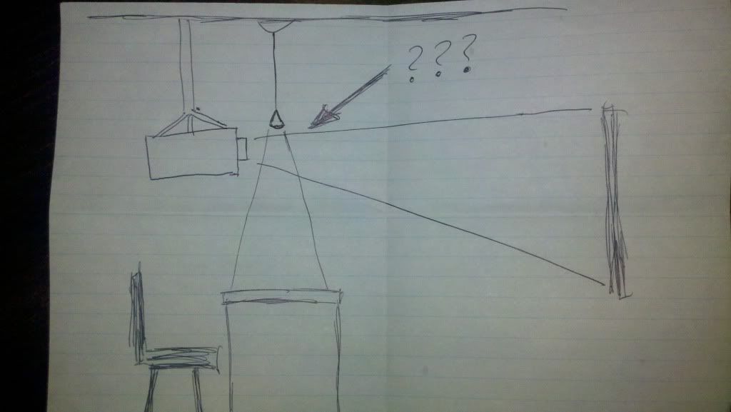

I think this is a stupid question, but I want to make absolutely sure, to put my mind at ease (my wife has me worried.)
The beam of light shining down from my pendant in front of the projector won't affect the image on the screen, will it?
In other words, there's no difference in the image regardless of whether this focused light is on or off, correct?

post #16 of 272 Old 11-02-2011, 05:57 PM
tony123's Avatar
Posts: 5,058
Liked: 38
I've got a similar condition except with can lights...it has no effect.

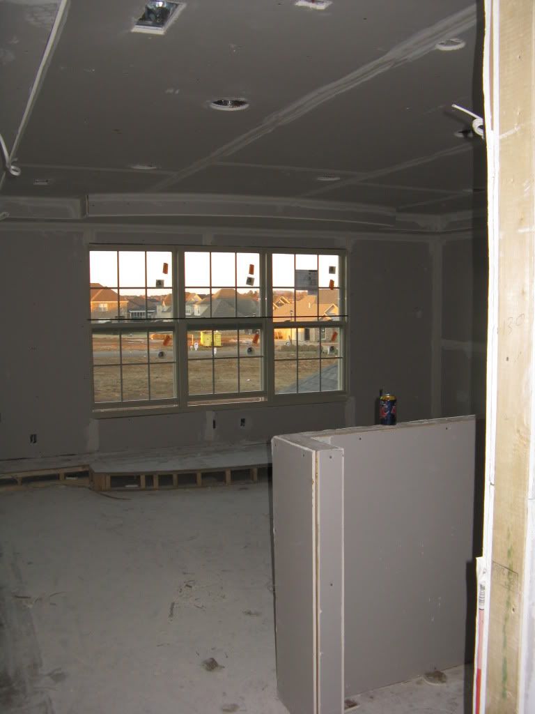

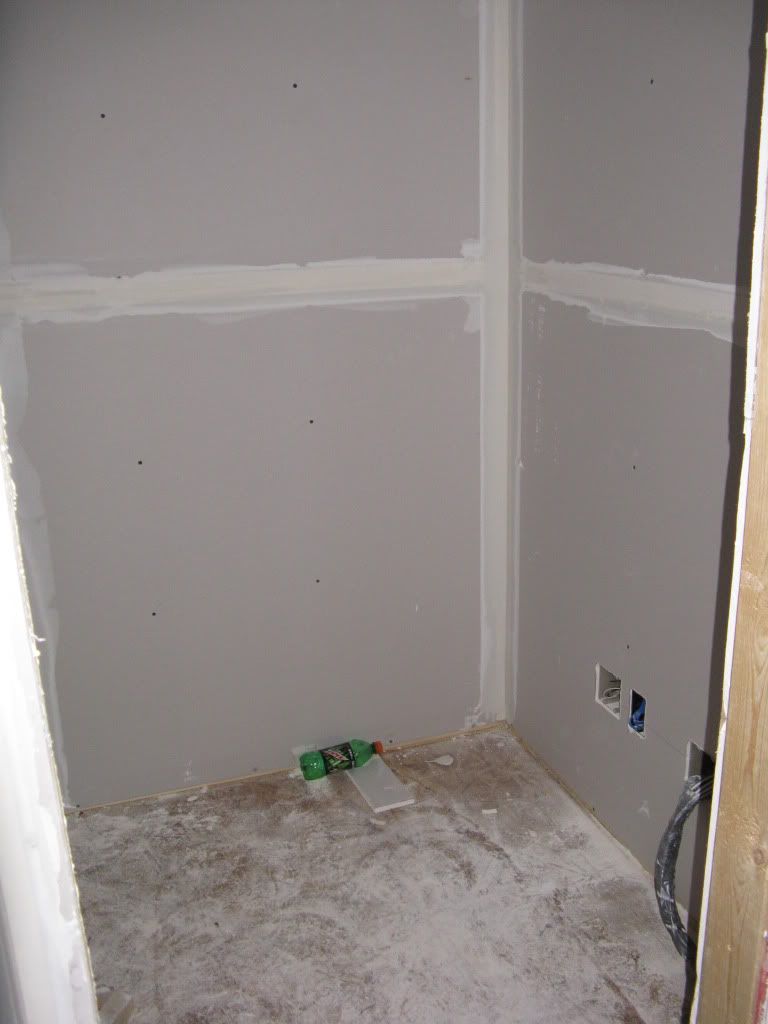

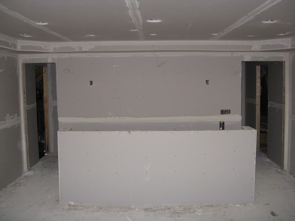

Drywall finished today. Double 5/8" + GG.
My wife took a pic of me making sure they used GG. (They did)

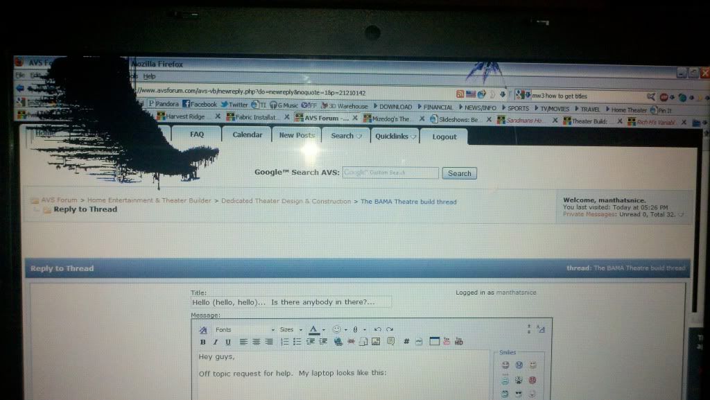

Hey guys,
Off topic request for help. They don't call them "Bag Throwers" for nothing. My laptop looks like this:
Advice on an inexpensive laptop? My only requirements are N-wireless, Office 07 or later, a decent processor and RAM, and a decent size HD. Just a general use computer at a good price.
