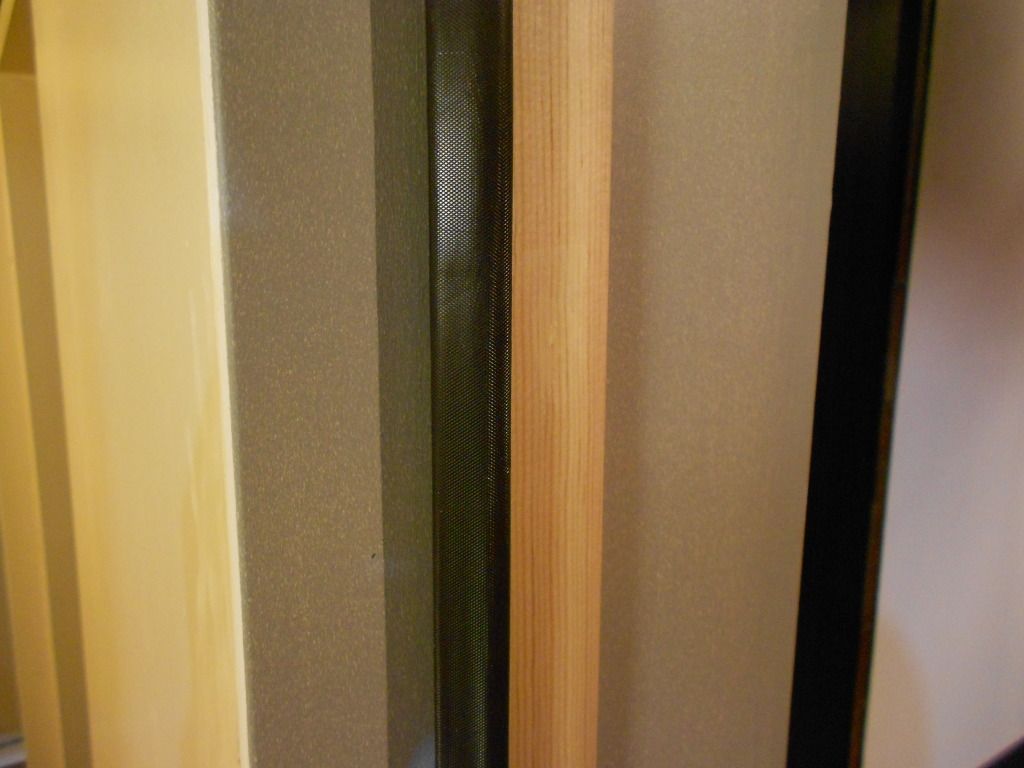

Sunday began with the installation of the door stops, weatherstripping, and the black marble threshold (I still have to paint the door stops).
The marble turned out awesome. I'm really glad that I decided to use it over a wooden threshold.
Now that the door is sealed up I can say that the soundproofing was a success!! I put the radio on in the theater on full (at an uncomfortably loud level) and measured 85db with my phone's spl meter app. Right outside the closed door it read 40db and in my sister's bedroom adjacent from the theater with her door closed it read 25db. The noise is barely audible in her room when everything else is dead silent, and as soon as you introduce any kind of background noise it disappears. Inside the theater it's like you've been transported to another world. The door sounds like an airlock when you close it and then it is so quiet. I am very pleased!
Also, the airflow through the unpowered supply dead vent in the front of the room feels like it is just about equal to the air being drawn out in the back. That seems like pretty good reassurance that the room is sealed up tight!

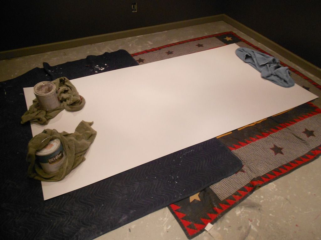

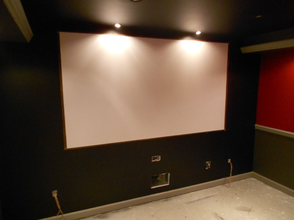

Next came the screen!!
I spent a lot of time during my research period (before I even started building) trying to decide what I wanted to do for a screen. Since I don't have the room for a false wall, an AT screen wasn't necessary. I also decided that I wanted to go the DIY route and try to save some money. At my old house I just painted the wall with Behr Silverscreen. It looked good, but I never trusted that the wall was dead flat. This time I knew that I wanted to do something that would be hung on the wall. I contemplated many options, black-out cloth stretched on a frame and a painted substrate being only some.
Then one day while browsing the forum I came across the laminate screen thread. After a lot of reading, it seemed like the perfect option for me. The laminate is relatively cheap, it has been tested to perform as well or better than some more expensive "real" screens and perhaps the best trait for me, it's extremely durable and easy to clean. With three younger siblings and five dogs, the screen is bound to be touched and get dirty. The laminate is what is used on countertops, so it can stand up to that type of wear and is also a cinch to clean.
So I ordered my sheet of Wilsonart Designer White laminate and it waited patiently in it's box until today.

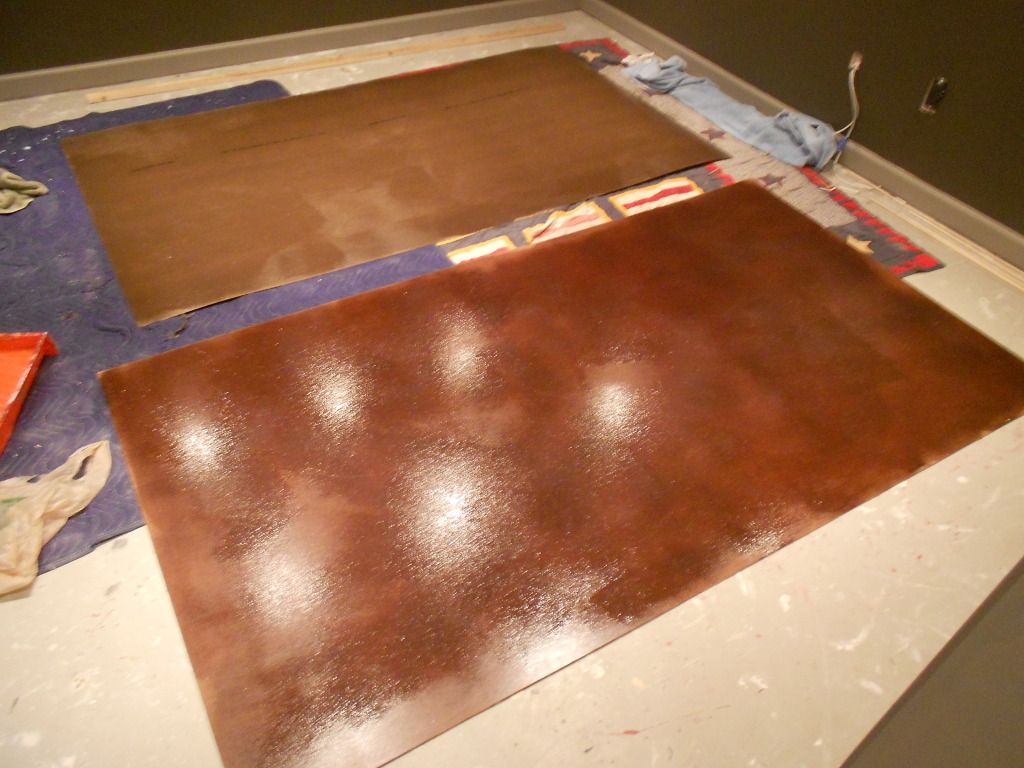

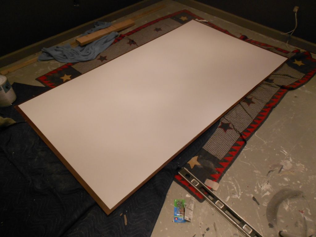

I began by laying it down and applying some weights on the ends to flatten it out.
During this time I also cut it to size. I used a utility knife to score and snap it. I ended up making it 47" tall and the accompanying 16:9 aspect ratio width (84") to give me the option of upgrading to a slightly larger screen if I get a different projector and want to reuse this one. For now I will use the screen border to cover up the extra area.

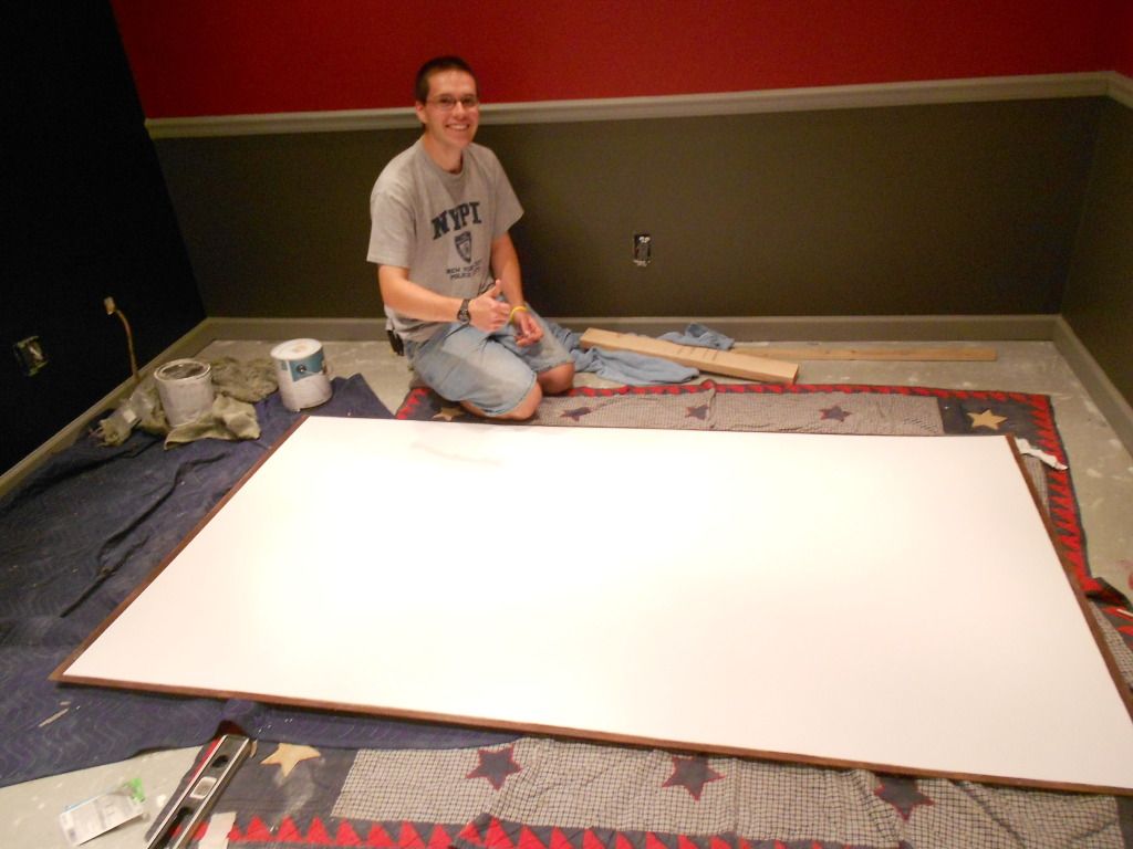

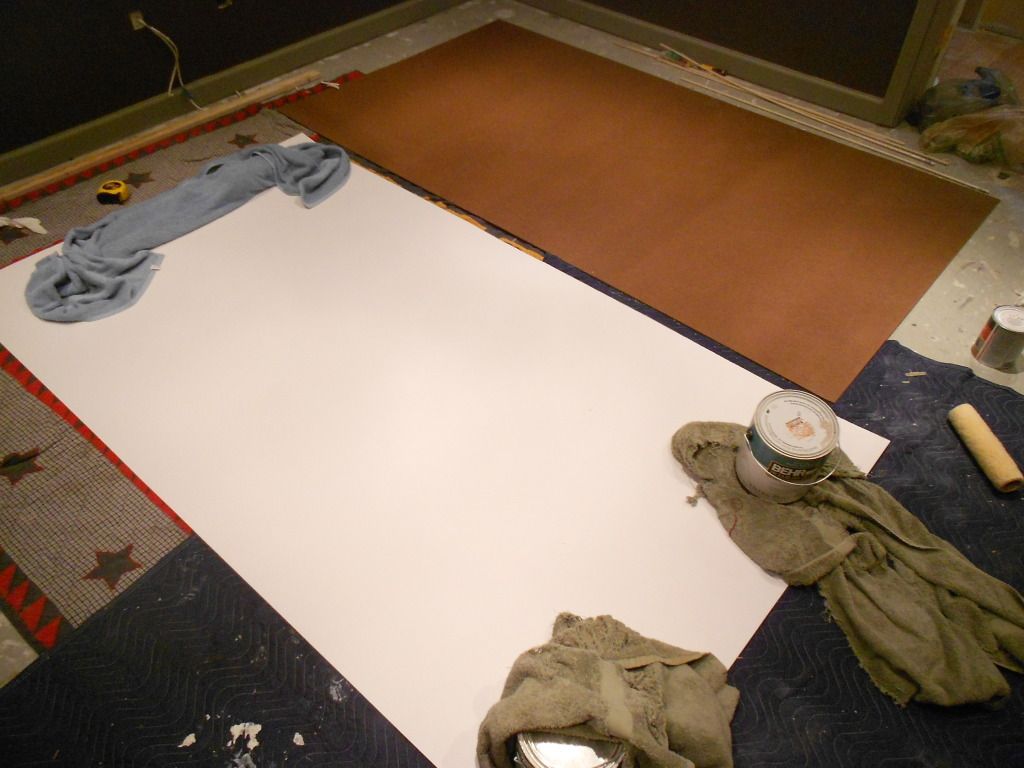

The laminate is not rigid enough to be mounted directly to the wall, so I decided to mount it to something more rigid. I had read about people building frames but decided that the best (and easiest) option would be to attach it to a 3/16" piece of hardboard. I left the hardboard at 48" wide and cut it to 86" long to allow for some overhang to screw it to the wall.
The best way to attach the two pieces is contact cement since that is what is normally used when resurfacing countertops. It bonds the two pieces over the entire surface, providing maximum adhesion. It's also nice because it eliminates the possibility of any "bumps" beneath the laminate from a thicker adhesive like liquid nails.
A DIY word of warning:
When the instructions say use in a "well ventilated area" they mean a WELL ventilated area. I thought I'd be all right with all the windows open in the basement and a fan running in the door of the theater but man does that stuff smell. Lets just say that I felt a little loopy for a few minutes and there was a 2 hour "airing out" period where nobody went in the basement after the two pieces were bonded.
I rolled the contact cement onto both surfaces and then let it dry for about 20 minutes until it felt "tacky".
Then my sister and I VERY CAREFULLY lifted the laminate and, starting in one corner, "rolled" it down onto the hardboard. I was very nervous because once those two surfaces touch they will not come apart. Then I used a scrap 2x4 covered with a towel to apply pressure working out from the middle to ensure that both surfaces made full contact.
It came out great!!
Success!!

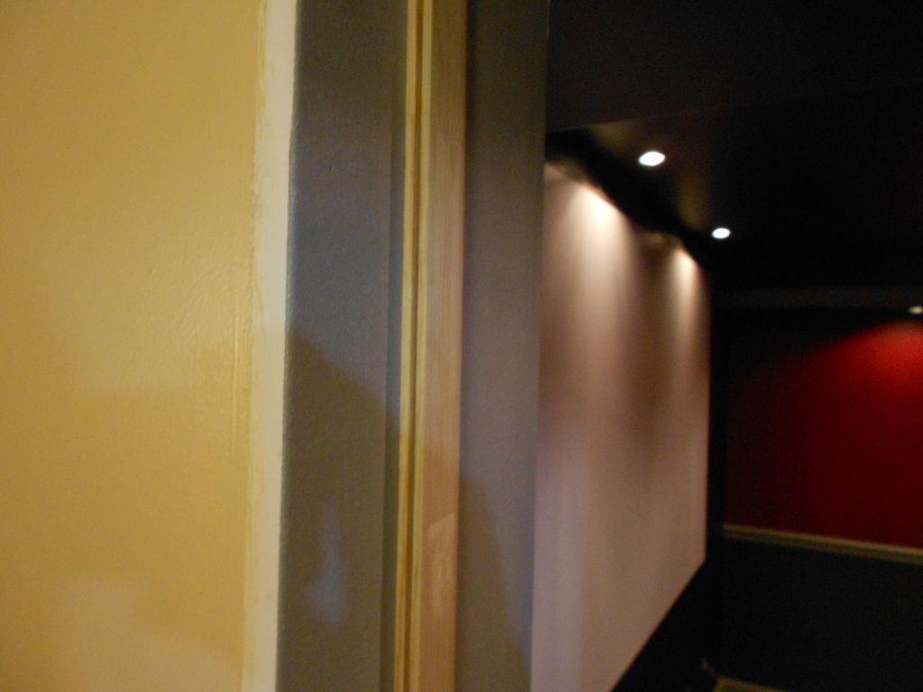

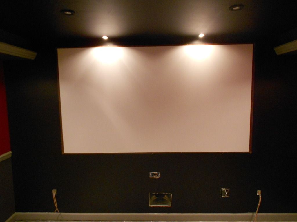

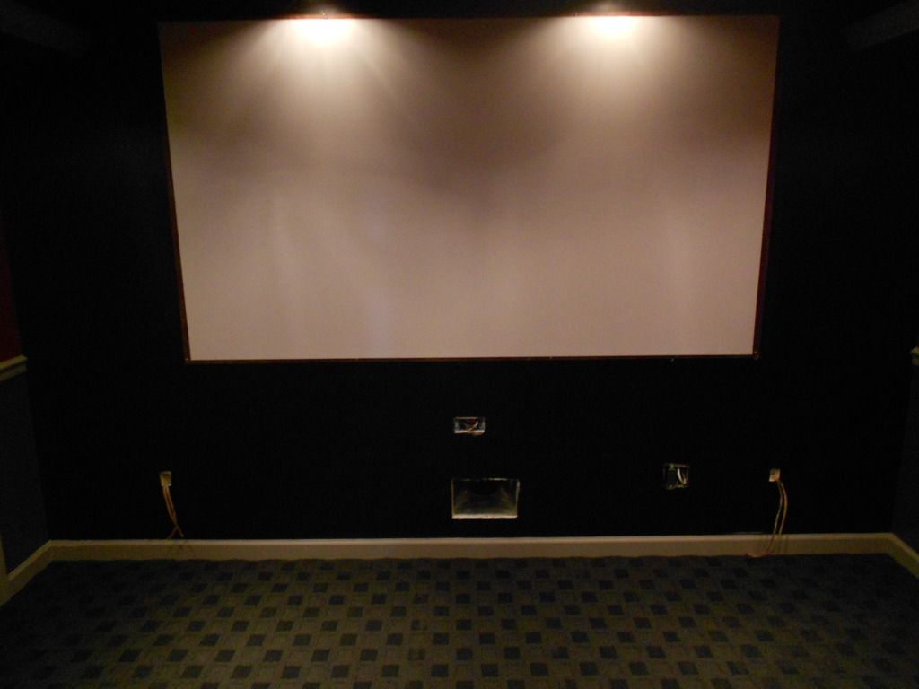

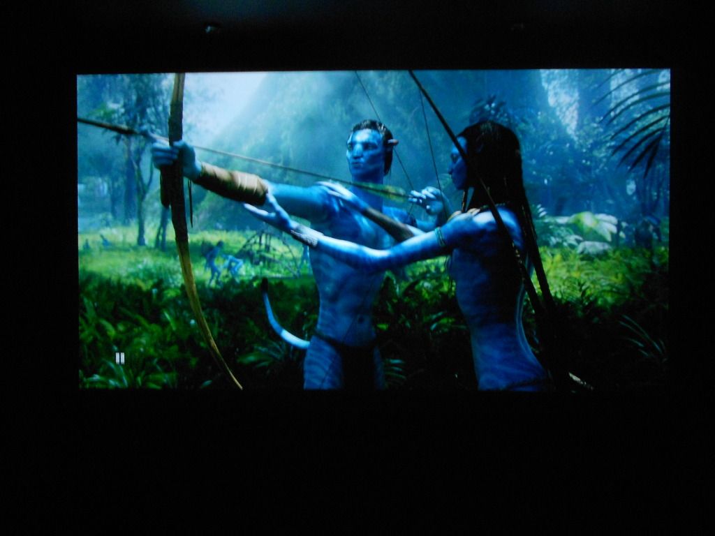

Next I enlisted the help of the family to get the screen mounted to the wall. It is anchored and screwed around the perimeter.
It came out AWESOME!!!
I love the way the screen wash lights above it look too. It makes quite a statement when you walk in the room.
And finally, just for kicks and giggles, a screen shot.
Keep in mind that this was taken with my cheap little digital camera so it doesn't do it justice. Once the room is complete I'll try to get my grandpa's better camera and a tripod to take some final pics.
Needless to say, I am VERY PLEASED with the screen!

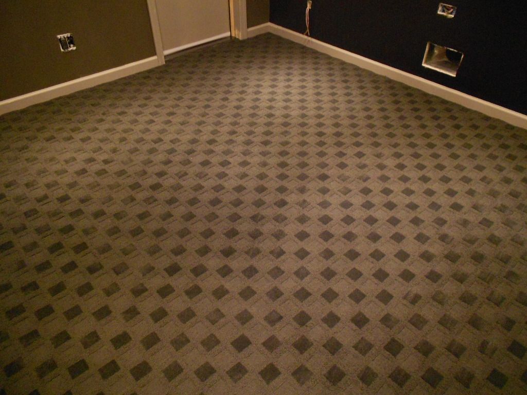

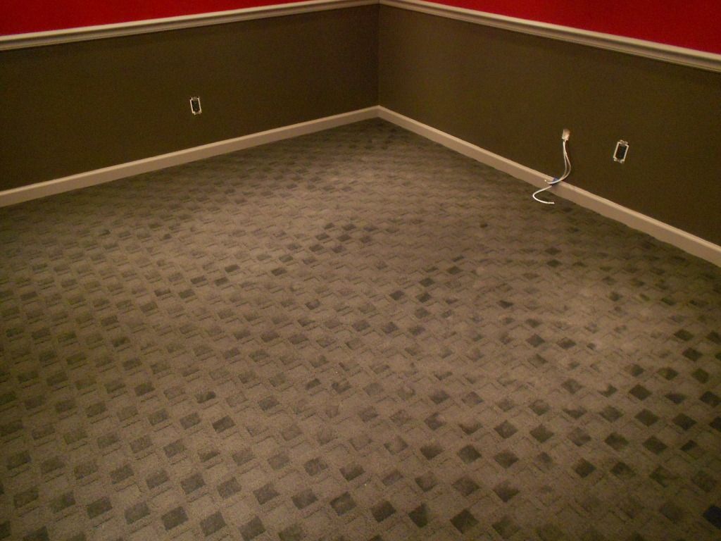

Then I spent some time cleaning up because........... carpet goes in tomorrow!!
After carpet my next step is to build the screen border and masking system (I know that you're anxiously waiting RTROSE ). Then I've got to get the shelving in the equipment closet installed and wire everything up, bring down the seats and hook up the bass shakers, and finish some other odds and ends.

Excellent progress. Looking forward to seeing the carpet pics!
Do you happen to have any more pics of the door seals? What did you go with for the bottom of the door (hard to tell in the one picture)?

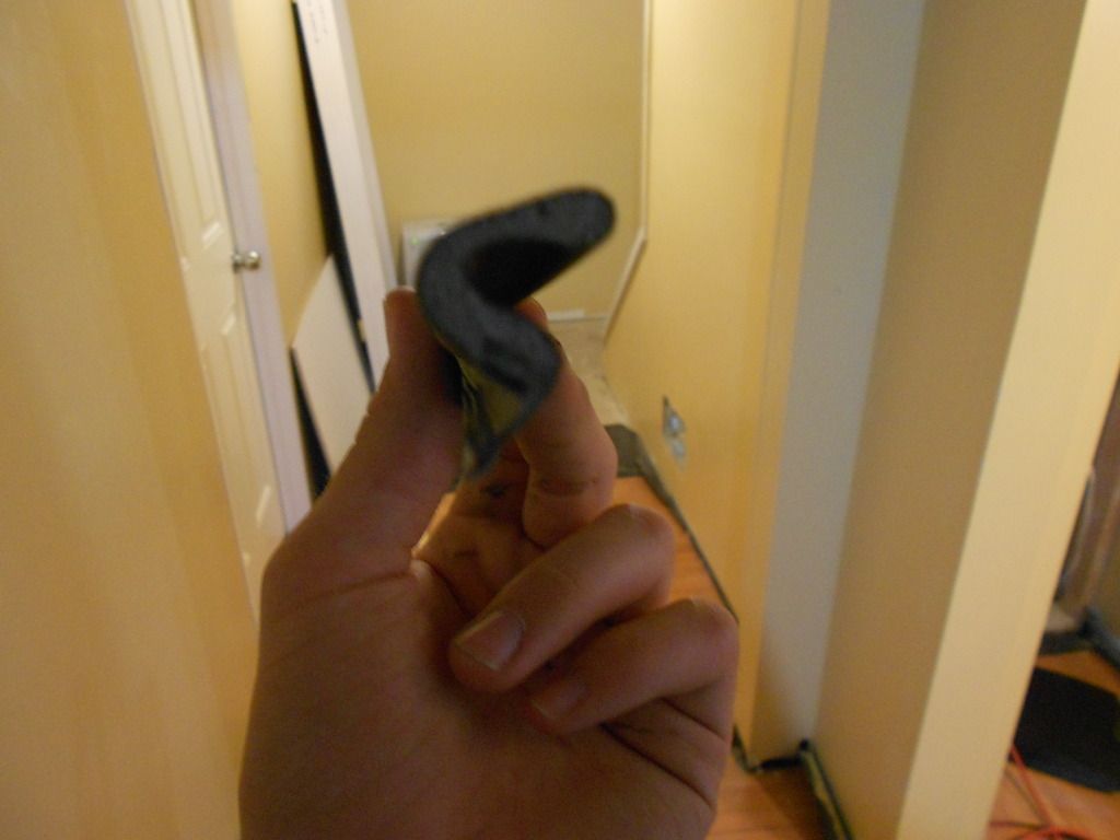

Thanks vanice!!
I can get you some pics of the seals a little later once I get home. On the top and sides I cut a slot in the door stops and inserted some kerfed vinyl weatherstripping.
The bottom is sealed right now with a cheap stick-on door sweep that I had lying around. It isn't horrible, but is most definitely the weak link and I'd like to work on something a little bit better. The gap between the bottom of the door and the marble threshold is 3/4", so my current plan is to cut a piece of 1/2" MDF to fit the bottom of the door and use some construction adhesive to attach it. Then I'll try the sweep again with the 1/4" gap. Hopefully with that small of a gap it will be sufficient. If not I'll look into getting an automatic door bottom, but I wanted to try and make something work with things that I had lying around first.
I'll keep you posted.
Here's some more detailed pics of the door seals. You can see in this first one that I cut a slot in the door stop to accept the kerfed weather stripping.
Here is a close-up of the weatherstripping. The part that sticks out on the bottom is what goes into the slot.
And here it is once it is put in the slot.
I attached the weatherstripping to the stops before attaching them to the jamb. Then I closed the door and pushed them up tight to ensure a good seal before brad nailing them on.
I am very happy with how this kerfed vinyl weatherstripping performs. It seals everything up tight.

Today at around 11:30am the carpet installers showed up. It only took them about an hour to get everything in.
It looks AWESOME!!!
I absolutely love the checkerboard pattern and the way the lighter areas are also recessed down a little adds a really cool texture as well. It has a distinct feeling when you walk on it due to the different textures. The best way that I can describe it is like some showers with pebbled floors that feel a little "bumpy". But of course this is soft. It is better than I imagined it would be.
I am very glad that I went with the darker shade now that it is installed in the whole room. The small sample was rather deceiving and didn't show the pattern very well. Luckily I had damelon's and bzbase's rooms to use as examples!
The whole room just feels more "finished" now. This was the last big surface that needed to be transformed from a concrete basement to a theater. Now that it is done, I feel like the end is closer than ever.
It's also amazing how much it helped tame the echo in the room. I expect that the chairs will have a similar effect.
This afternoon I spent some time working on the screen border and masking system. I'll have pictures and more information on that once it is finished!
The forum is going down tomorrow at 9am, so I'm not sure when I'll hear from all of you again. Hopefully everything will run smoothly and we'll all be back quickly with an updated AVS!
Well.... see you on the other side!
