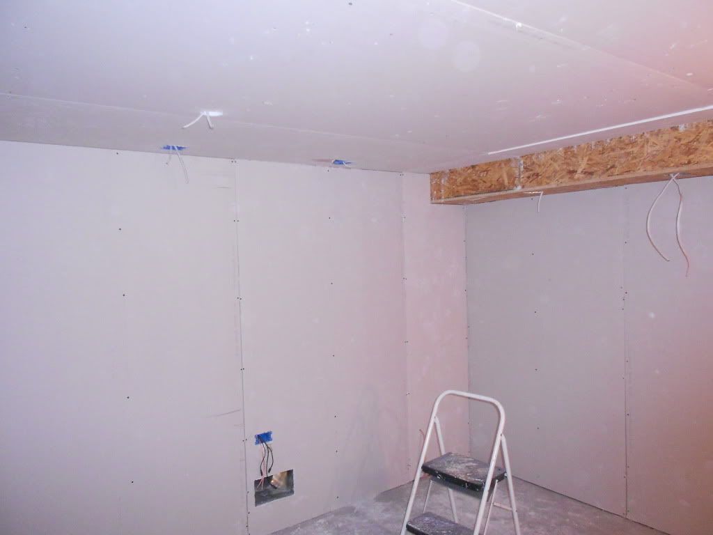

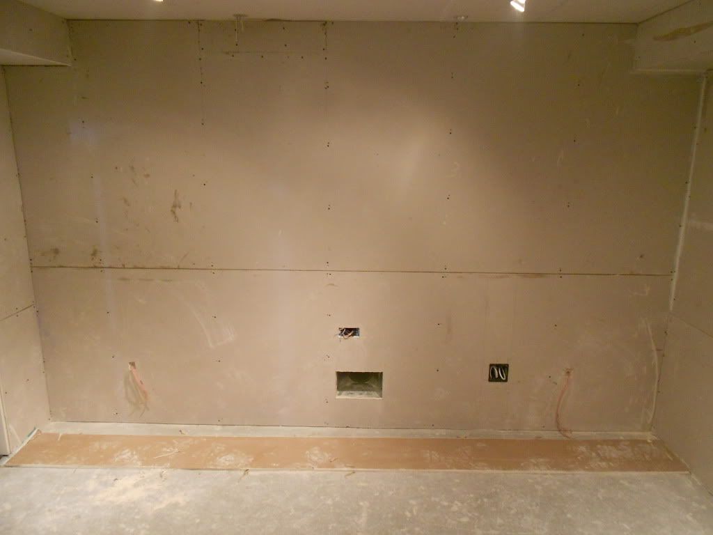

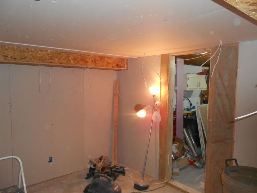

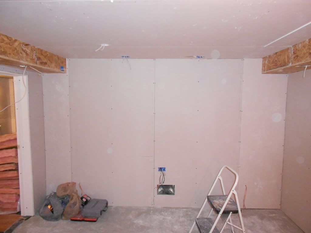

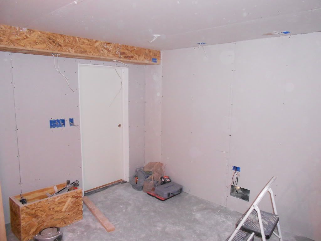

I have been waiting to post these pictures since I started the thread. To me once drywall gets put on the walls you cross from the building a room stage to the finishing a room stage. I know that there is still a lot of work to do before movie time but the fact that I can actually walk into a room now makes me feel like a kid on Christmas morning.
Well here it goes:
Front:
Back:
Screen wall from back:

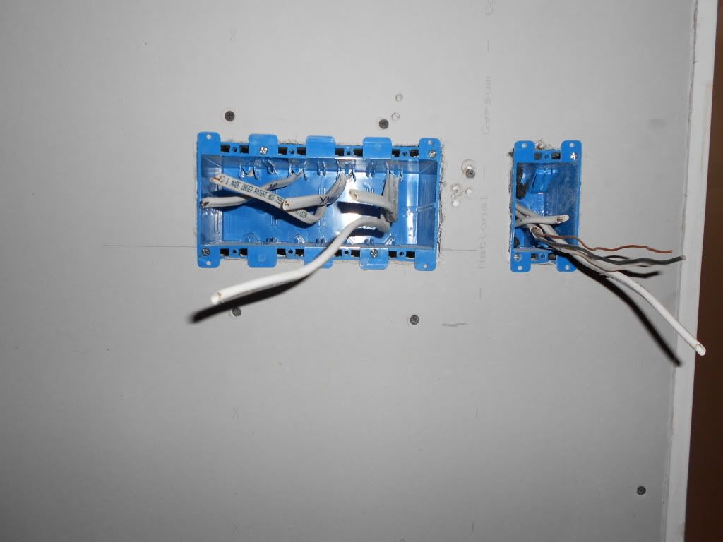

Electrical boxes. The 4-gang is for the dimmer switches and the single gang is for the fan controller.
I am ecstatic!
Keep in mind that this is only the first layer. I get to do it all again!
The spot in the back is still open to bring in the drywall for the second layer.
So the next steps are to seal any larger gaps with acoustical caulk and then bring in the drywall for the second layer before sealing up the opening in the back. Then I'll install the projector backer box in that opening. Then it's Green Glue time baby!
People had told me how much the room transforms once the drywall goes up but it really is magical when you experience it. I sat on my step stool for ten minutes just staring at the screen wall. I know it sounds cheesy but I really have never been so proud of something that I have accomplished. The whole scope of this build and what I have learned and gained from it just hit me tonight. It is so exciting to see something that you planned and designed come together in a way even better than you could have imagined.
I'm looking forward to getting more done throughout this weekend and I will keep you all posted!
Thank you to all!

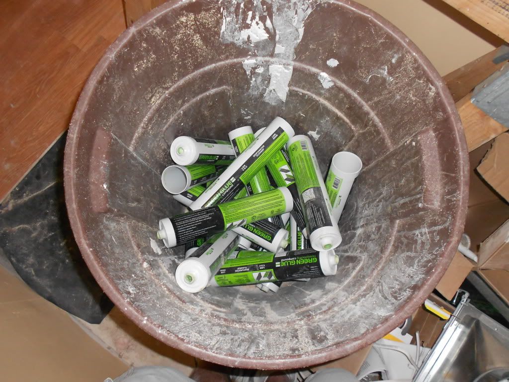

If you use GG you are obligated to show full tubes and then a pic or two of the empties to prove that they were in fact deployed for the build.
I can't remember now who it was, but we gave'em so much grief that he went out to the big dumpster in his drive rummaged around and then took some pictures of the empties.
Don't make us put you in the same situation!
RTROSE
Oh don't worry I'll take the picture. No dumpster diving for me.

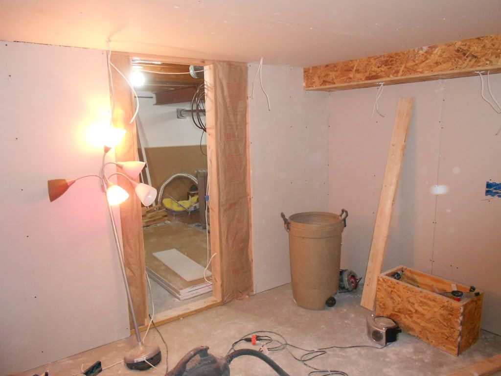

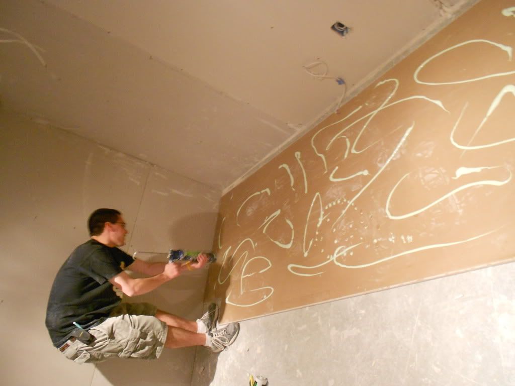

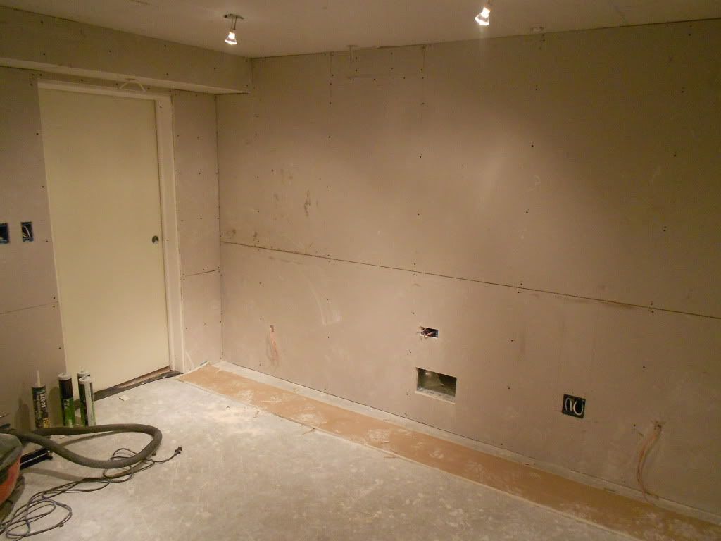

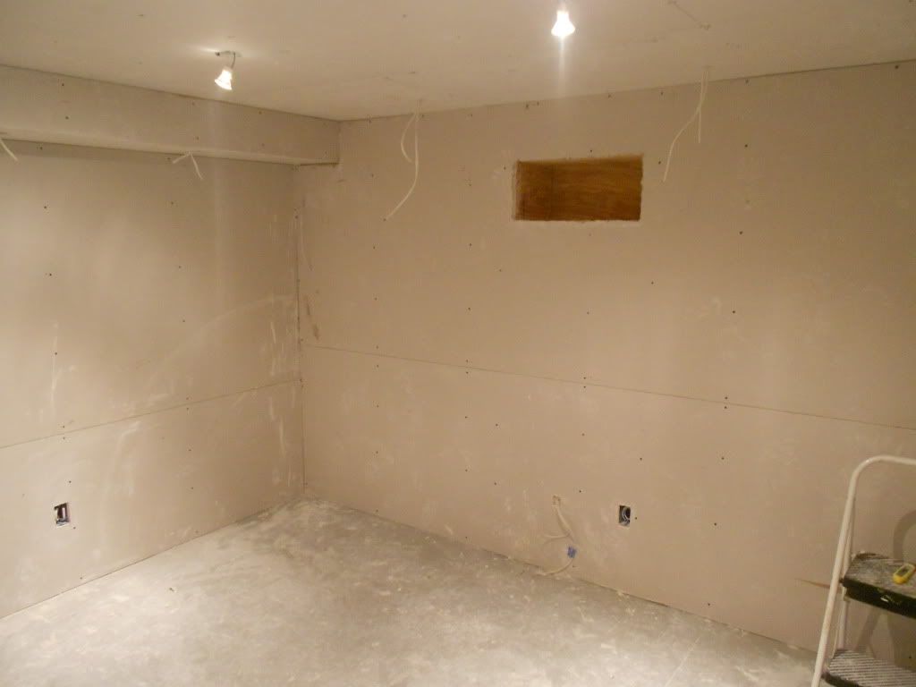

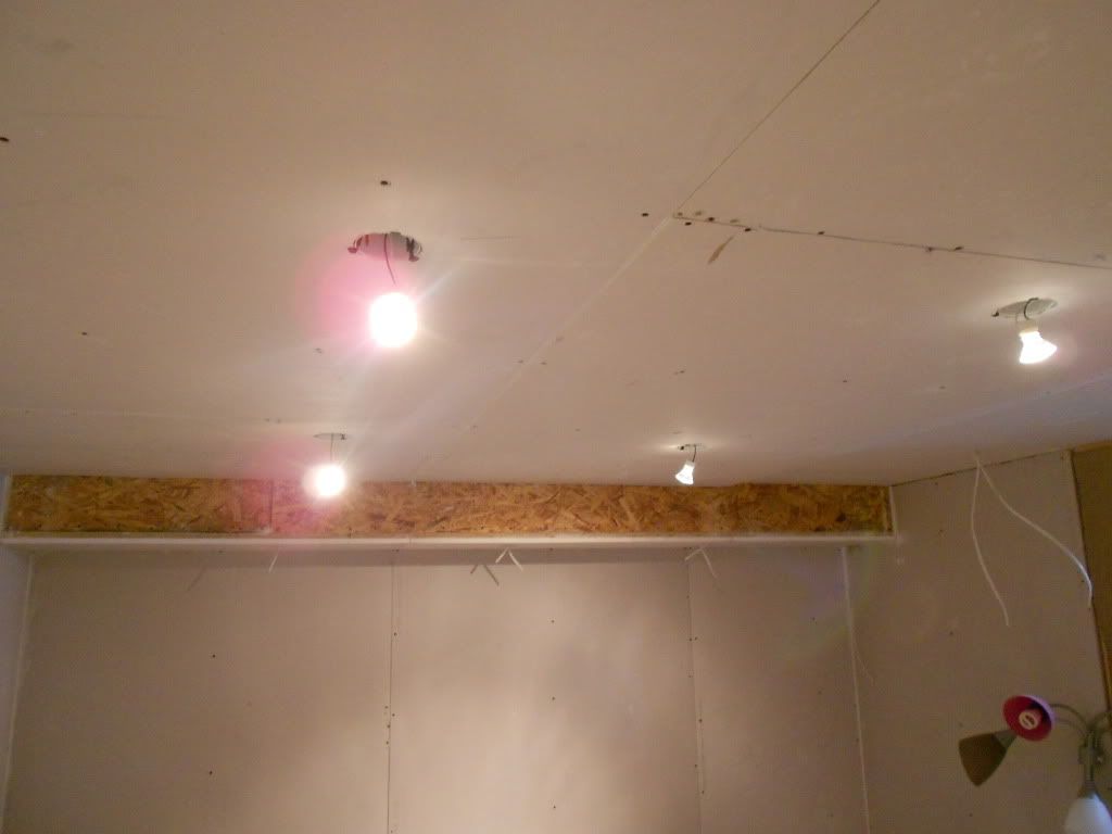

It was an exciting weekend at the Austin household!

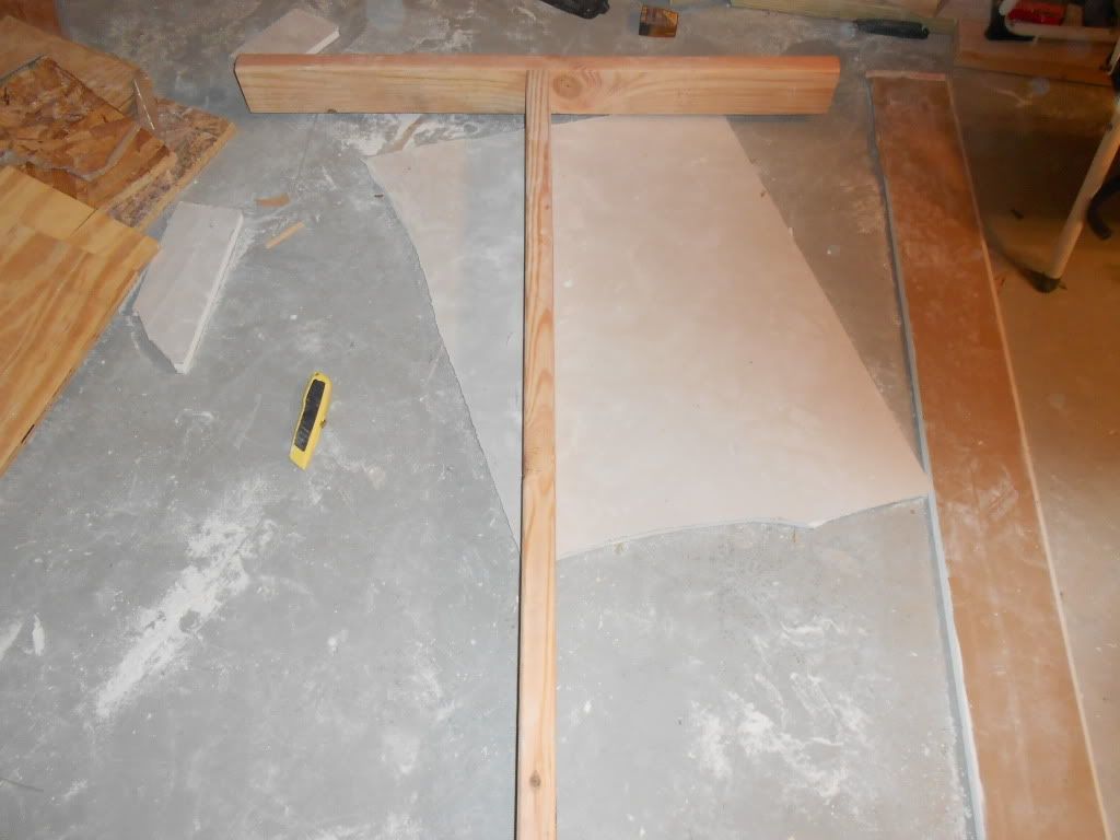

I began by putting the second layer of drywall up on the ceiling. Got to use my good friend "the T" one more time. I'm going to miss him.
R.I.P...........NOT!
I got the ceiling lights put in and on.

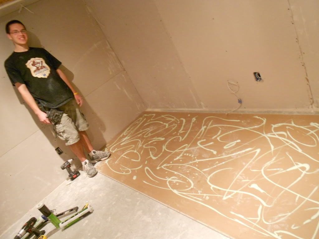

Then it was time for the walls. Green glue action shot!
Bam!
It's great family bonding time!

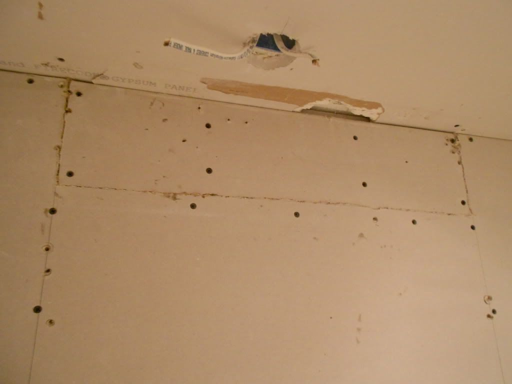

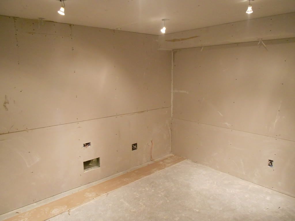

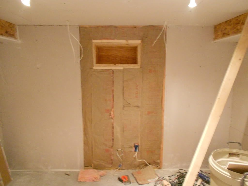

So I'm on a roll with the walls until I realize that at the top of the screen wall theirs a big hump in the second layer of drywall. The home theater gods must have really hated me for something because apparently a loose chunk of drywall from the ceiling fell between the two layers while I was installing them. I didn't realize this till about three hours after I installed the panel so rather than trying to tug the panel off the wall and risk destroying the Green Glue since it had already began to dry I cut out a section and removed the piece before patching it up. Oh well...more finish work later I guess.....
I also got the back opening framed up and the projector "backer box" installed. Before covering that up with drywall.
I worked late tonight but got the entire second layer of drywall finished!
After I hung the last piece I stood in the middle of the room and screamed multiple times as loud as I could. My mother was in the kitchen right above me and when I asked her if she heard me scream she looked shocked. She heard nothing! A little scary actually-"no one can hear you scream......"-but hey that's what I wanted!
I think everyone that ventures into soundproofing wonders if they screwed up throughout the build so it certainly was nice to know that all of the extra effort was worth it. I trusted Ted the whole time but man is it nice to know that it worked. I could still hear faint voices in the theater from upstairs but the noises were obviously coming from the unsealed door. Once I shoved a blanket in the crack underneath almost nothing got through. I'm still planning to add some extra MDF and Green Glue to the door so that should make it absolutley perfect.
Speaking of Green Glue, lets end this update with a picture I've been waiting a long time to post and a few of you have been waiting to see.
Next up is the soffit in the back and then mudding and taping.
Thanks everyone!

Looks good, and as I'm told as the GG cures even more it only gets better. Well done, very well done. Enjoy this milestone, but not so much that you procrastinate on the rest of the build.
Nice shot of the GG in the bucket BTW. Looking forward to seeing some more progress. Now don't you have another math test to study for?
