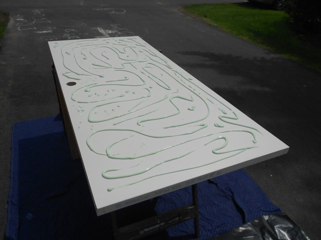

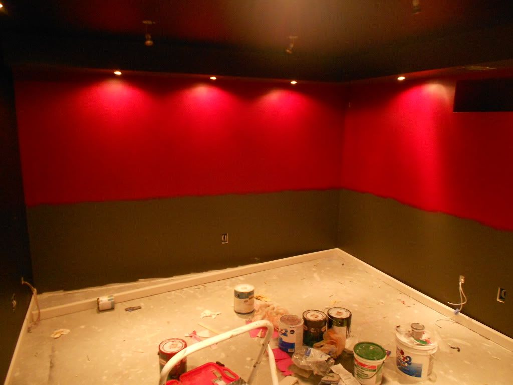

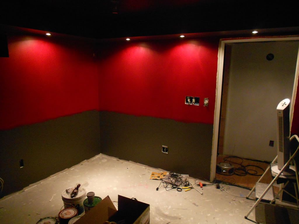

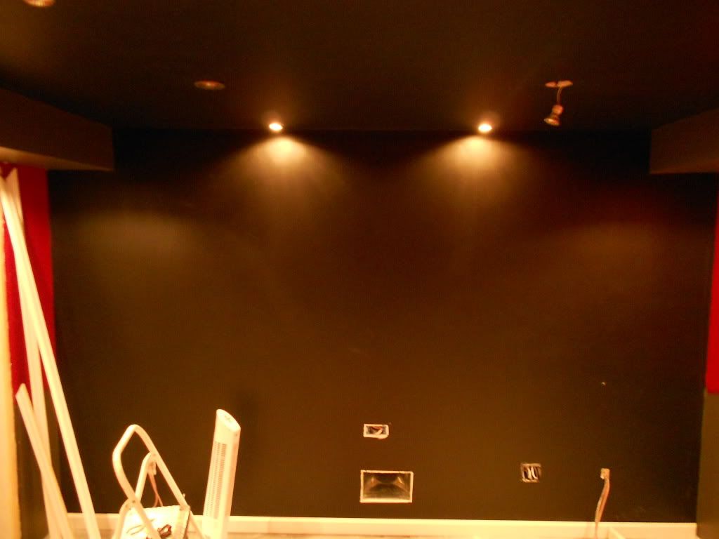

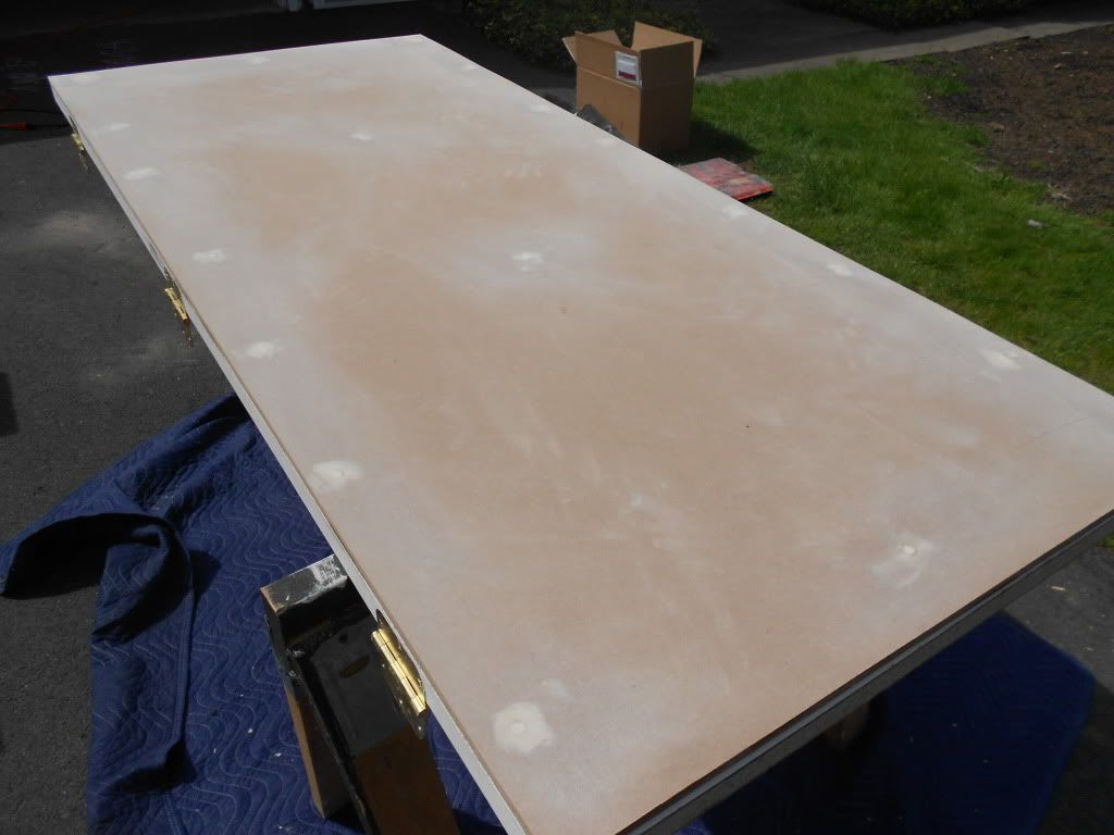

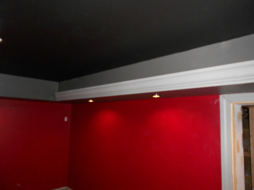

Another busy weekend here at the Austin household, though admittedly about half of it was devoted to set building so there wasn't a ton of theater progress.
Here is what i did accomplish though....
I started by installing the rest of the puck lights in the soffits. As I said before I love how they turned out and I think that the wall wash look is a very nice design element. With all the pucks on the overhead lights are not even necessary. They will most likely end up being used only for cleaning or other work that needs to get done (getting the remote lost in the chairs comes to mind ).
I also got the screen wash lights in the front of the room installed. They should provide a nice compliment to the screen once it's installed.

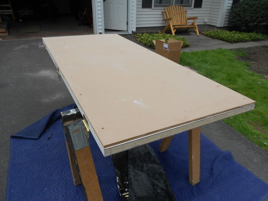

Then I moved onto the jamb extensions for the door. Since my wall is a 2x6 staggered stud and I have two layers of drywall on the theater side I had to extend the jamb by 5/8". I ripped down some 3/4" pine then glued and brad nailed it to the existing jamb. It was nice to put the table saw to work since I don't get a chance to use it very often. I've still got some work to do with the wood filler to make everything look nice and smooth.

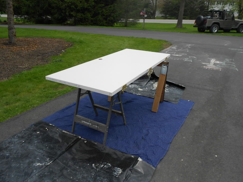

Then it was on to beefing up the door. I decided to add a layer of 1/2" MDF with Green Glue to my door to make it heavier and provide some dampening to improve sound isolation. I contemplated going with 3/4" MDF but decided that I didn't want to risk overloading the hinges and because the 1/2" would make my final door width 1 7/8" which means that I can use the doorknob that I already planned on that fits doors up to 2" thick.
I set up my workshop in the drveway.
Then I used the last of my Green Glue to cover the door. I savored the moment as it was the last time I'll get to apply the Green Glue (well at least until I get my own house that is and do theater 2.0 ).
Covered in MDF.
Then I filled in all of the screw holes with wood filler and sanded it smooth.
After that I primed it with two coats of KILZ Original oil-based primer to seal the MDF.
Note to self: be careful with oil-based paints and primers!!!
In my stupidity I managed to kick the quart over and send it all spilling onto the driveway. And having never dealt with oil based paints before I completely forgot to pick up some paint thinner to clean it up. So in my panicked state I pulled out the hose thinking that the water pressure might "push" it off. Well stupid head maybe you should close up the paint that you managed to save before spraying the hose so you don't ruin all of that too! So in the end I had to go back to the store to get more primer (and paint thinner). There's still a white blob on the driveway but I'm hoping that when we get it sealed soon it will cover it up.
DIY lesson of the week:
Close your paint can when your done pouring it out so that you don't kick it over and spill it everywhere and always have something on hand to clean up oil based paint.

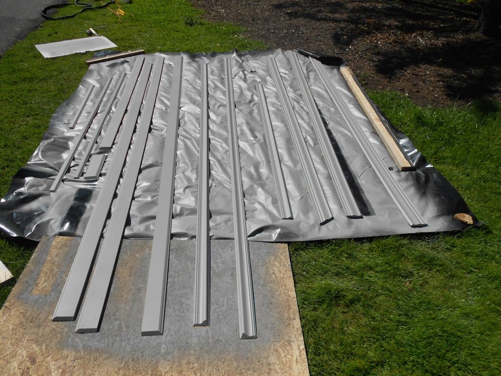

I also picked up all of my door casing, baseboards, chair rail, and crown molding for the theater. I managed to get all of the casing and baseboards cut so I'm making good progress there.
The next step is to finish cutting the molding then pull out the sprayer to paint it. I'll be going with a gray about two shades lighter then what is on the bottom of the walls and the soffits for the molding. I threw the black idea out because I thought that it would look a little strange to have black crown molding hanging on the bottom of the soffit. I like the lighter gray much better.
Heh,heh,heh. I remember my first beer. Theater 2.0! I was young and optimistic once, too. You young guys crack me up!

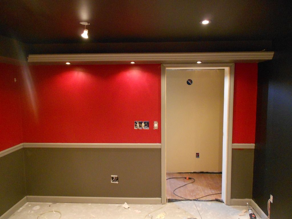

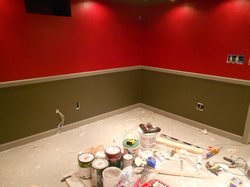

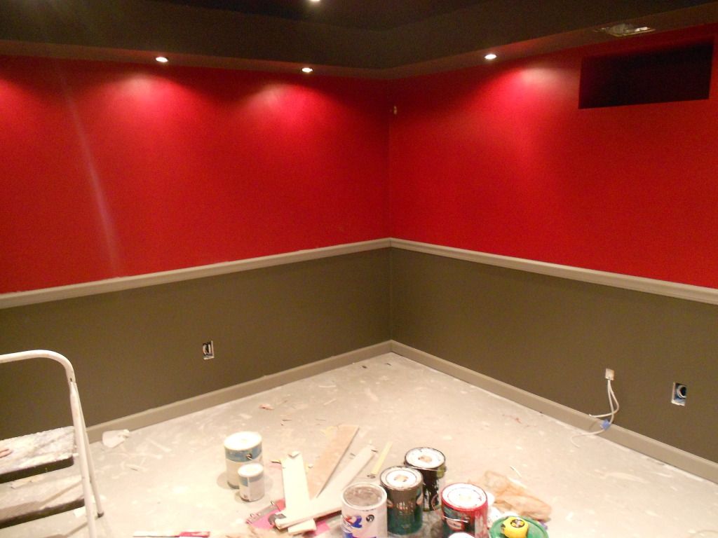

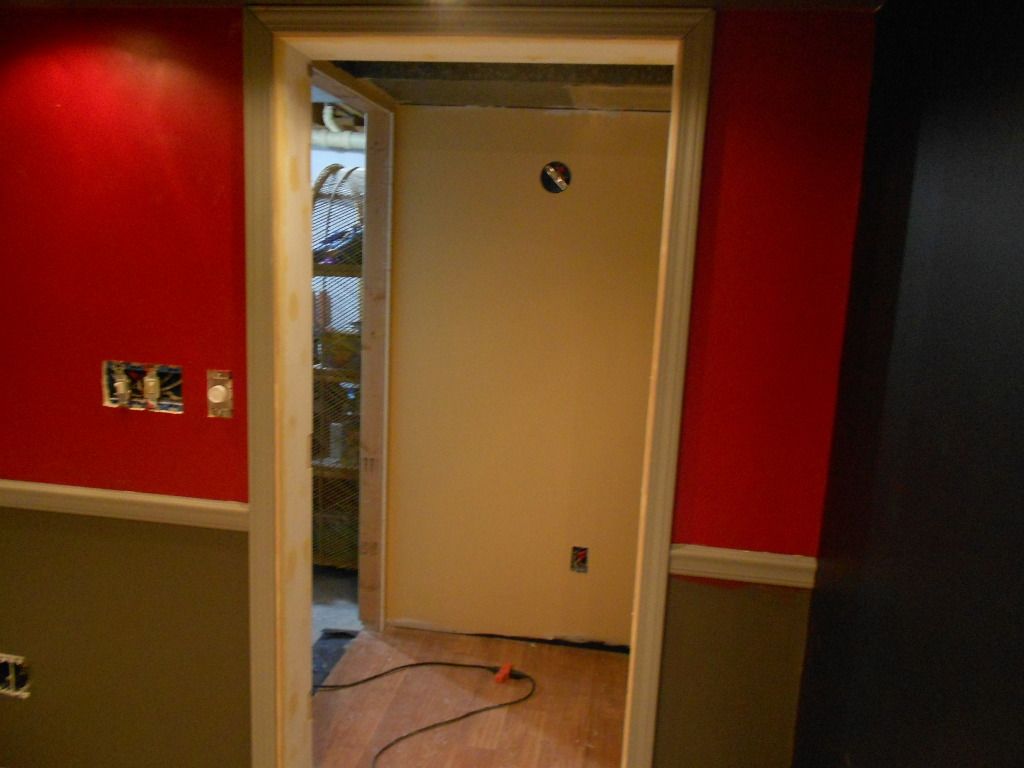

Somehow throughout this hectic weekend I managed to get most of the trim work complete.
I started by making all of the cuts (I didn't screw up a single miter! ) and then laid everything out in the yard to be painted.
Nothing gets a nosy neighbor going like setting up a spray booth in your front yard.
Once everything was painted I began with the door casing.
I had to rip about 1/2" off of the top piece since the top of the door is so close to the soffit.
Then I moved on to the chair rail and baseboards.
I'm very happy with how they turned out. I think that the lighter gray is perfect for splitting up the two colors of the wall.
Then came the first piece of crown.
I don't like it........
It just seems to be too overpowering in the small room. It makes the soffit look like it is painted two different colors. So my thinking now is that I will paint the crown the same dark gray as the soffit to make it blend in more. After all, its main purpose is to hold the rope lighting.
Any other thoughts/opinions?
Speaking of rope light, I'd like some opinions on what color I should order. Maybe a clear white or amber?
As always, thanks for following along!

I actually like the way the crown looks. If you paint it the same color as the soffit it may blend in too much. If you have a scrap piece you can paint it up and see how it looks.
On the rope lighting I'd go with the white (not the blue white) or you could go with those LED strips that can change colors via a remote control so you could change them as the mood dictates.

I guess I just thought that it stuck out TOO much. Good idea with the sample. I'll try that. Also since they are already painted the lighter gray color I think that I'll hang the last two pieces as is and then assess the situation from there. Then if I decide to repaint them I will paint them hung.
Thanks for your input on the rope light. I'm still torn on whether the white or amber would be better. Anyone else have an opinion?
I've got to do some more research on the LED but will look into that too.

I like Damelon's red but if you are looking for white then I would go for more of an incandescent look. I prefer the warmer look.
The color change LED is a nice thought. Then you can change it based on mood.
