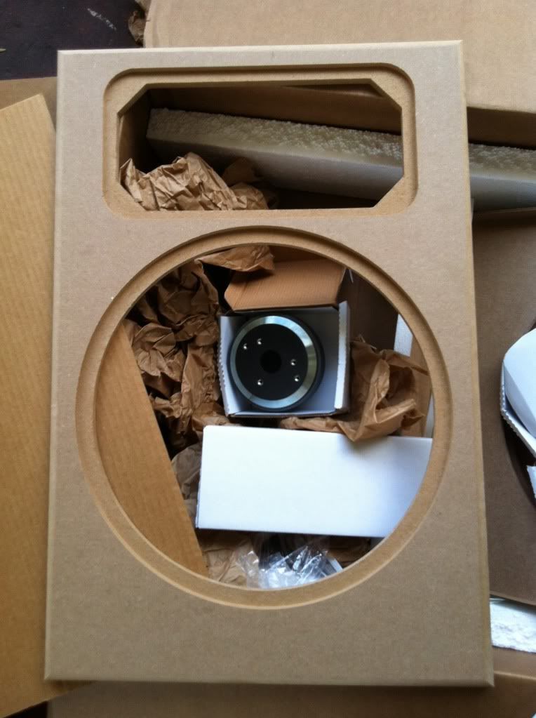

I went with the MDF, and I have no current plans for a double baffle. I did pick up a couple more clamps, however.
Also, I was informed that the baffle is actually a 1/4 inch bigger than the advertised final dimensions. If that's so, I'll have an 1/8 excess all the way around, and need a router. If that turns out to be what I need, I'll find a way to borrow one or something.
