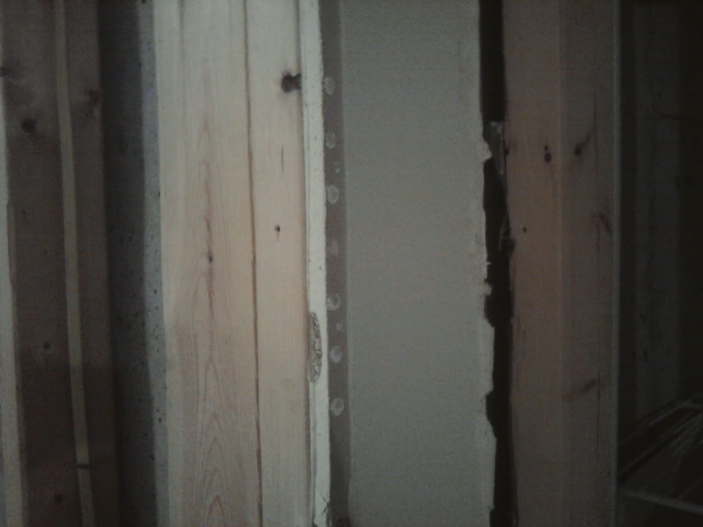

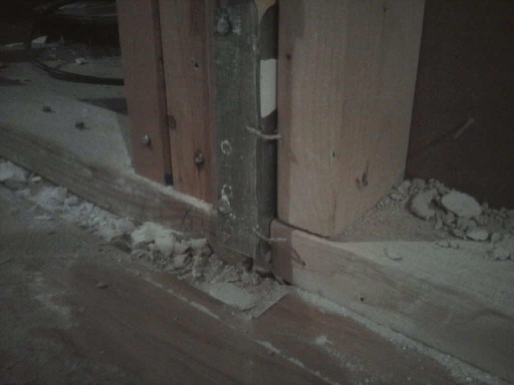

I've found a few hours here and there to swing hammers and hatchets (my favorite) at drywall, pull nails and back out screws. Apart from making a great mess, I've learned a thing or two about how the room was built. So, for the photo whores, here's the money shot:
Here's the first question. The underside of the soffit and the ceiling are harder to deal with. Anyone have any tips for getting that drywall out without breaking my neck? The ladder makes it a little precarious in the first place, then there's swinging the hammer over your head, then the dust and debris falling back onto you, then the concern about what might be on the other side - I certainly don't want to crack open the drain from the bathroom above, you know? So what's the proper way to do this?
Second, any tips for small section of drywall screwed to several studs in a row, as in such short wall segments like in this picture?
Third, I'm a little nervous about the floor. This third picture shows that some of the walls are built directly on the hardwood floor (this is the wall at the bottom of the stars, where I will be changing the door location). Is there a compelling reason to pull the whole wall out to get the flooring up from under it? Also in this picture, see that the corner bead is sandwiched between the new wall and the old - cut it, or remove the wall to pull it out? The wall shouldn't "need" to come out unless one of these problems requires it.
Thanks for reading - and any thoughts you have are appreciated.
Fred
HopefulFred is offline

My thoughts,
The corner bead should come out. You could sawzall it out or it is not very thick you could easily cut it out with some tin snips. The flooring can be trimmed back to the studs, but does not necessarily have to be removed unless it is going to interfere with the new flooring. As for the soffits I think there really is no other way other than what you are doing. You could always do what Mike Holmes does and just grab it with one hand and gently pull it down, seems to work for him. Nah, actually just wear eye protection, a mask, and some construction gloves and I think that is the best you can hope for. Drywall demo is dirty, dusty, and grungy work.
