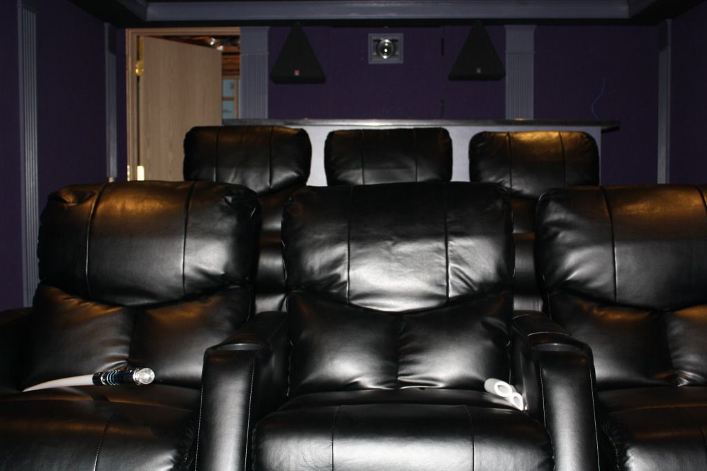

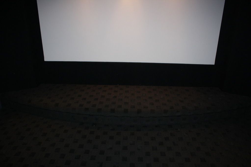

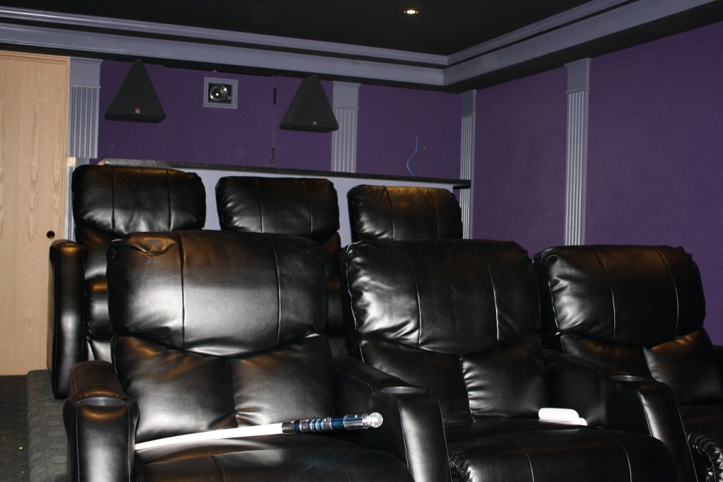

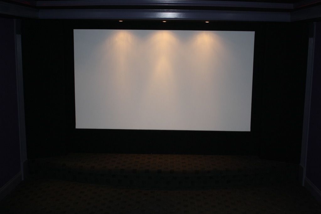

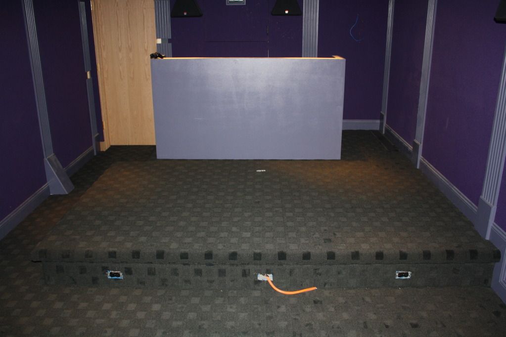

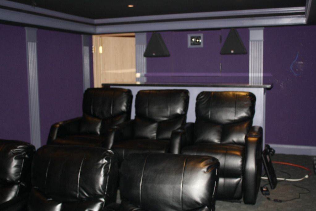

Carpet was installed today. It is Stainmaster's Silver Lake from Lowes. Chairs from Roman are being delivered tomorrow and granite bartop hopefully this weekend.

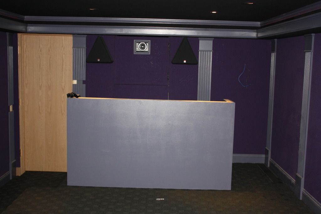

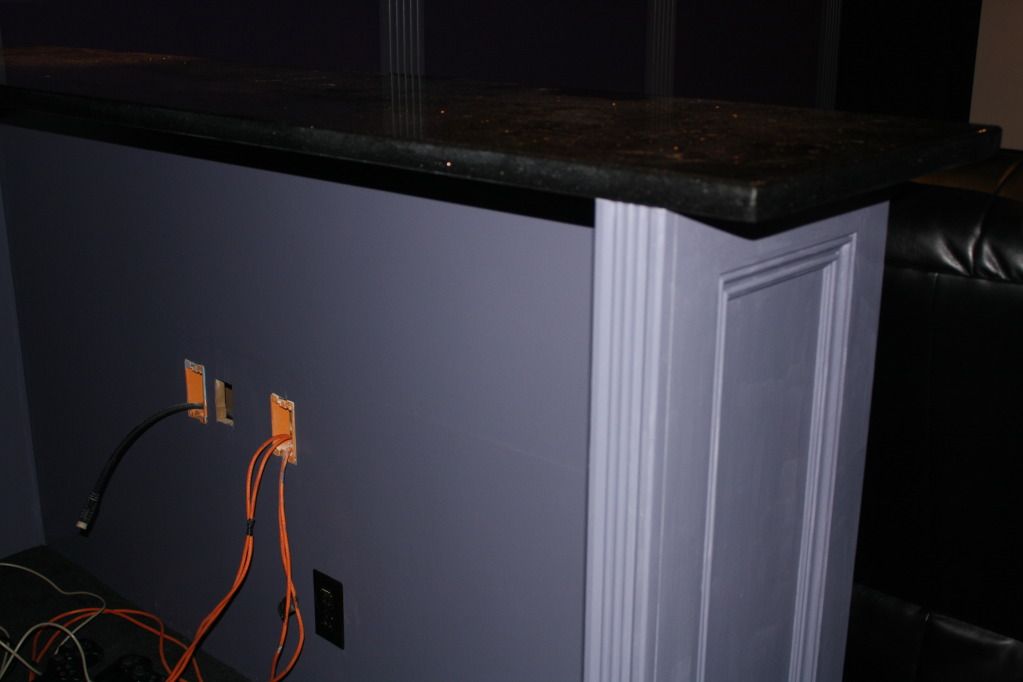

Originally Posted by bzbase View Post
Sweet! I like the look of the rear wall with your 'projection booth', that came out very nice.
That orange cord is for a massive butt-kicker, right?

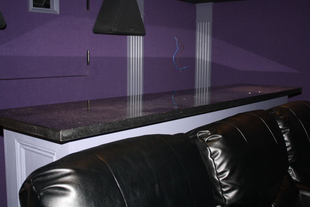

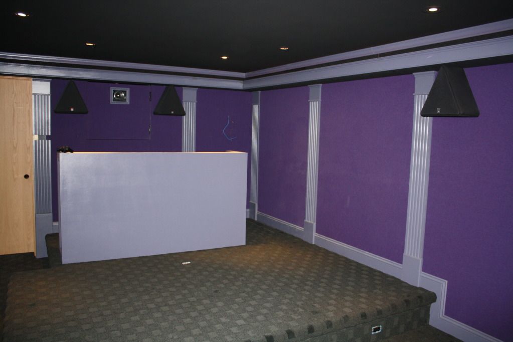

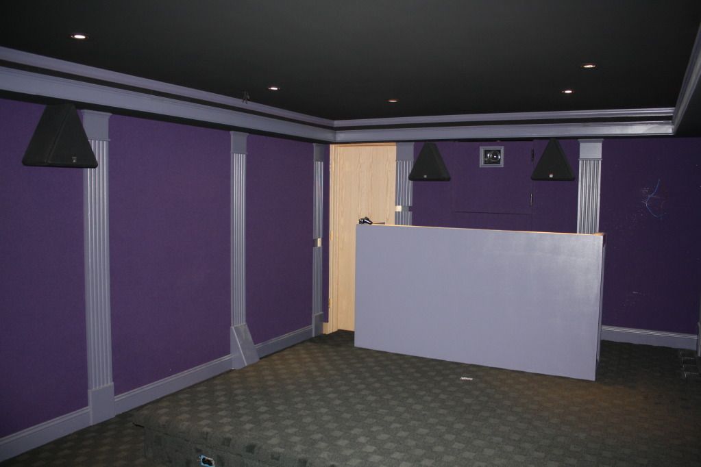

Yes, but I still have a fairly large punchlist. I knocked out a few items over the weekend. I hauled the chairs down to the theater and built them. Then, I hauled the granite countertop down and set it in place. I think the college kid who helped carry it laughed his butt off about the # of breaks I needed. Here are some new pics.

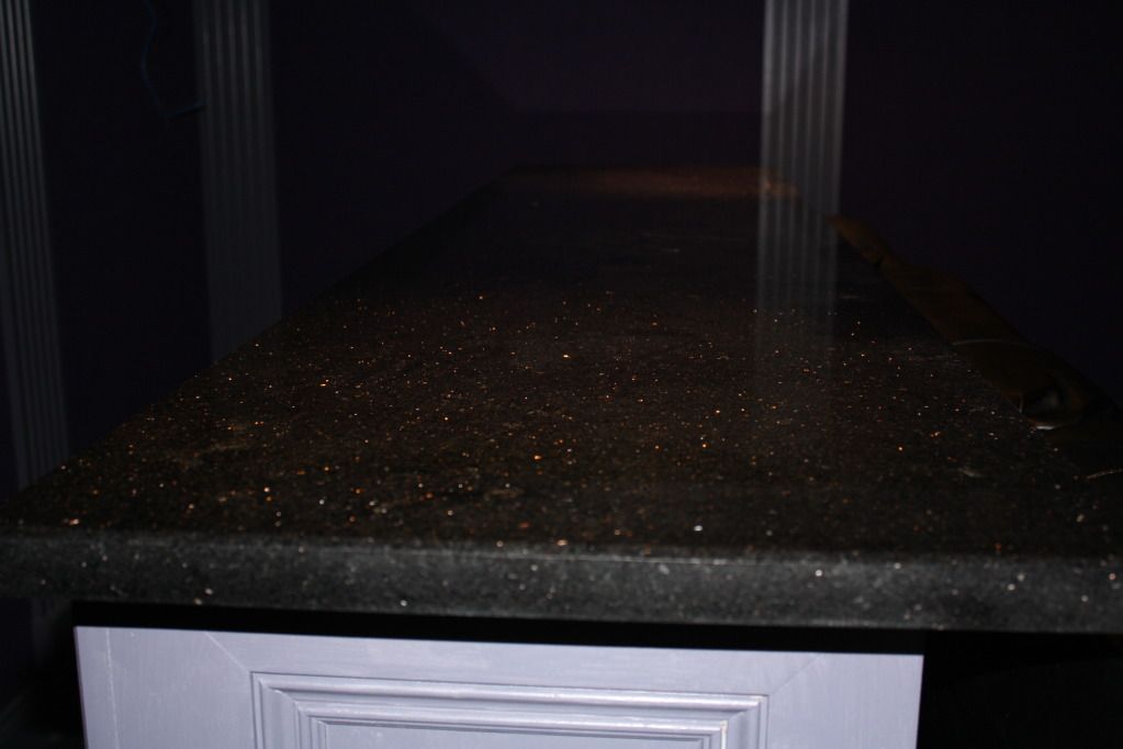

I love your granite bar in the back. I wanted to do exactly that myself but my theater depth request was denied by the wife. Looking good!
