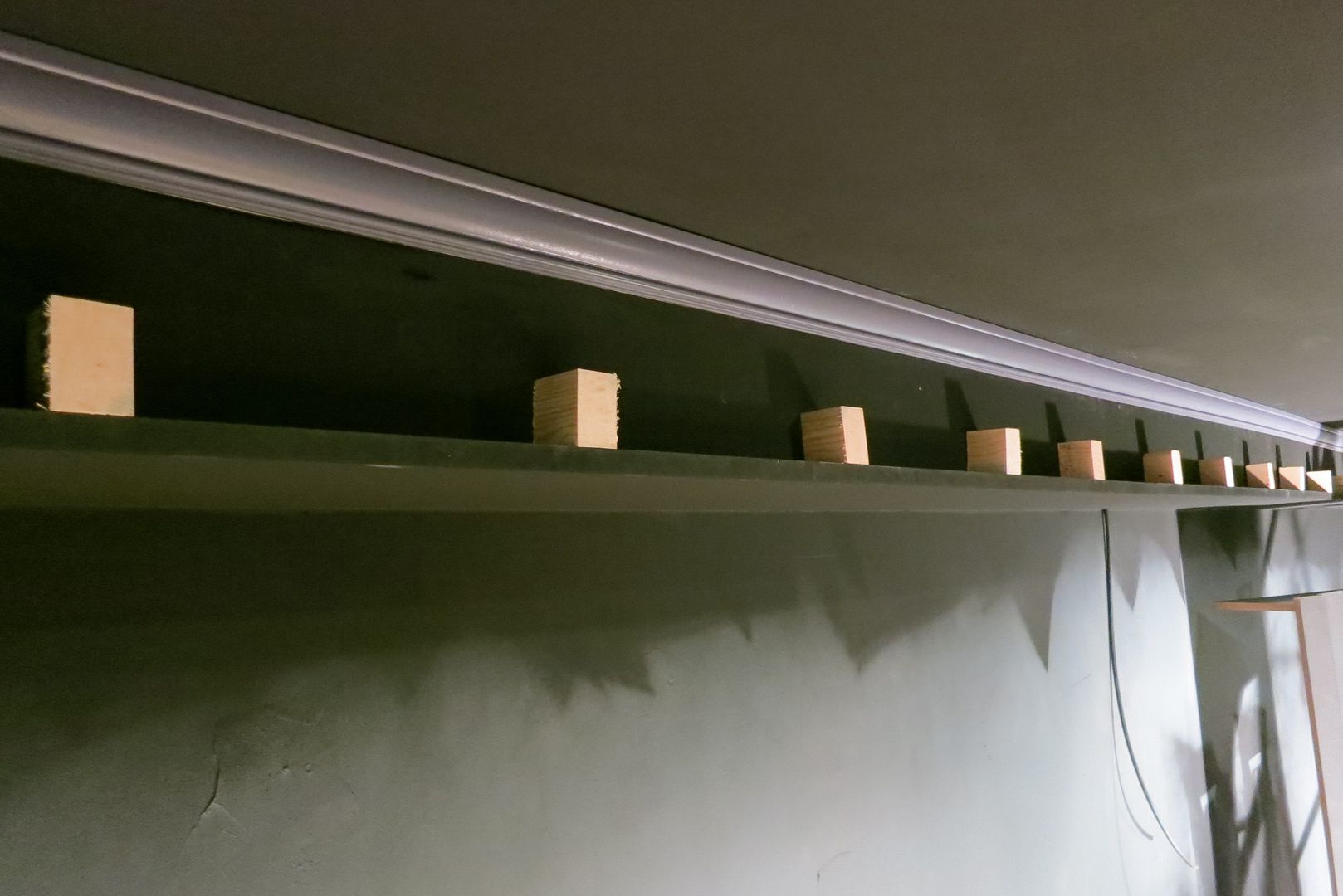

Today was all about the light tray. The bottom edge of the soffit sticks out 2 inches and here is what we did with it. Glued and nailed a piece of molding at the top., Picking the right piece is important because of the way the light will highlight the ridges.
Did you paint the Top Molding that the light reflects off of or did you leave it white?

painted the same color as all the molding in the room. BZbase at work:
