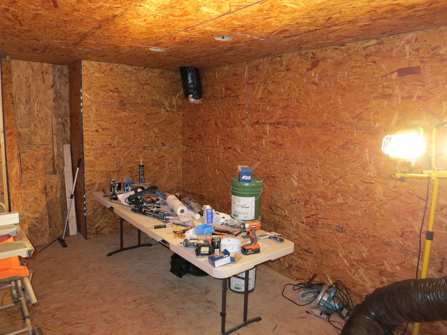

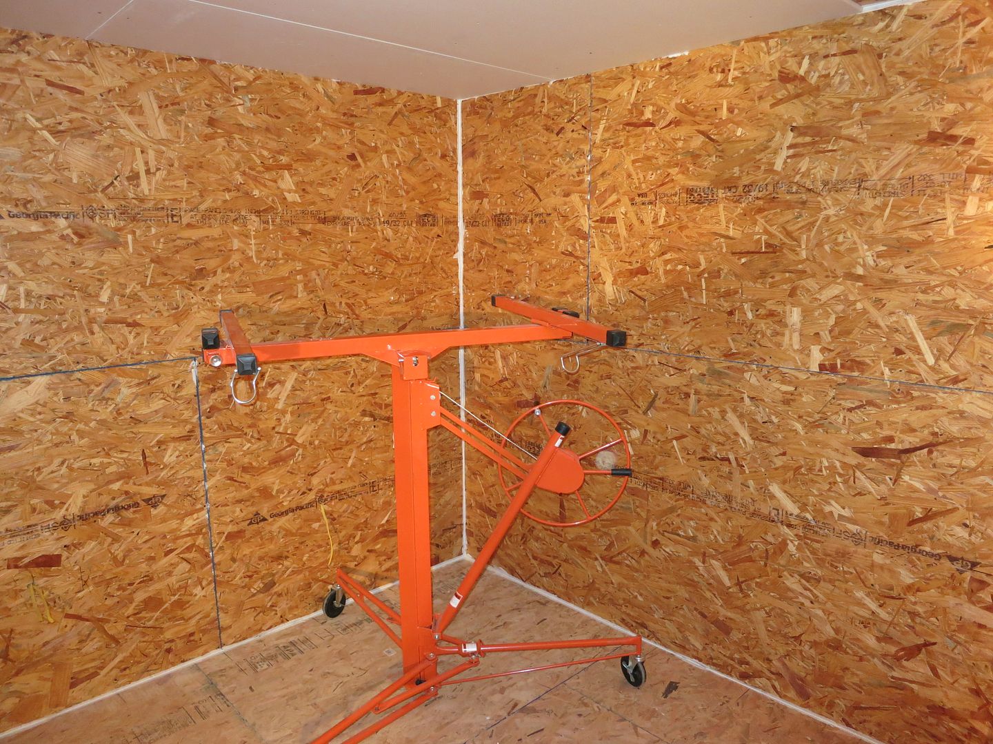

I have no illusion that it will be 100% done by the end of 9 days, but this project will have been jump started and hopefully the momentum will continue.
today we finished 90% of the OSB and managed to get a start on the Drywall. The last 10% of the OSB will happen tomorrow as we had to wait for supplies which we now have.
Status pics to follow.

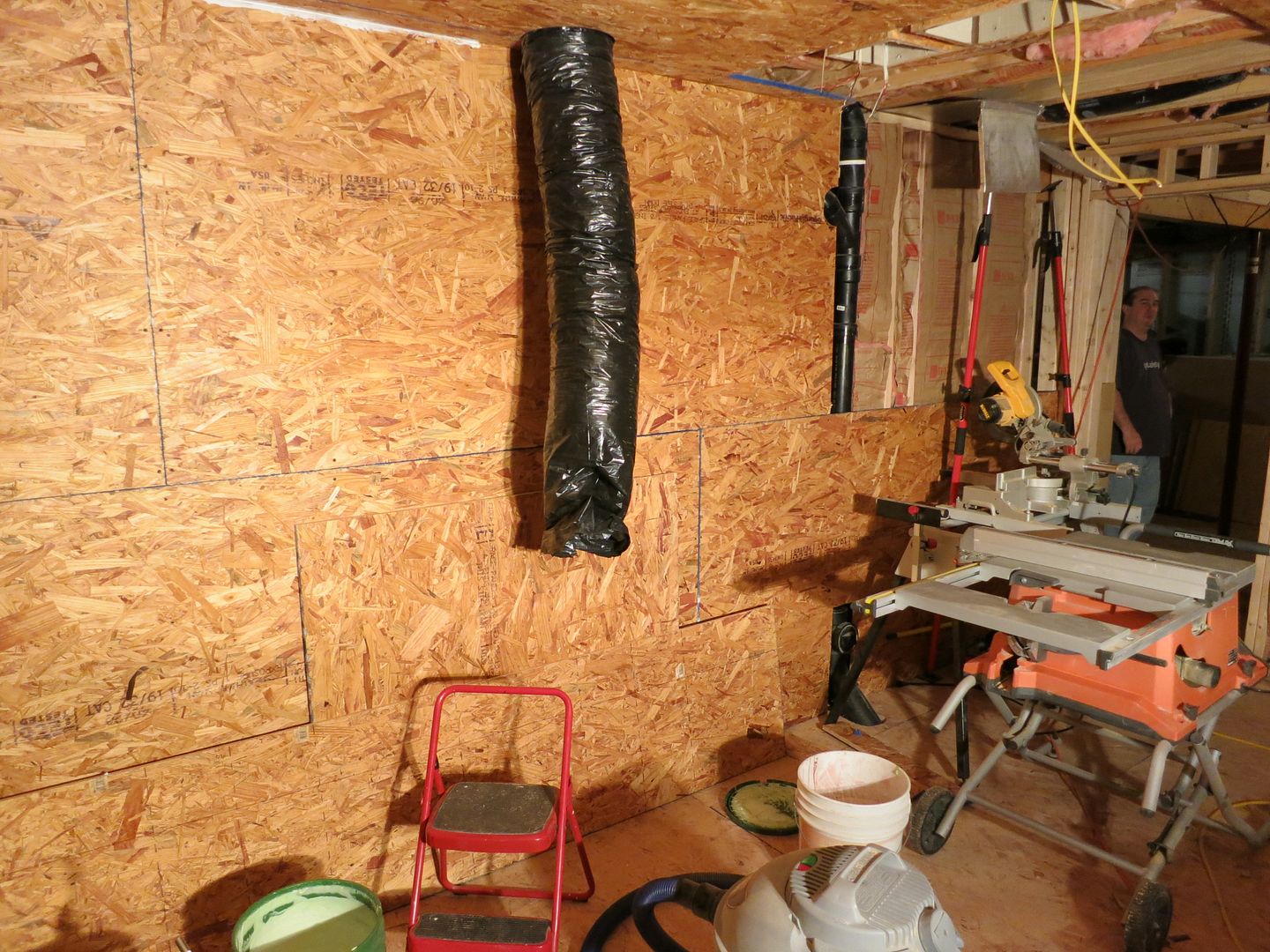

How did you go about soundproofing the vents in the ceiling? A dead vent within the joists?

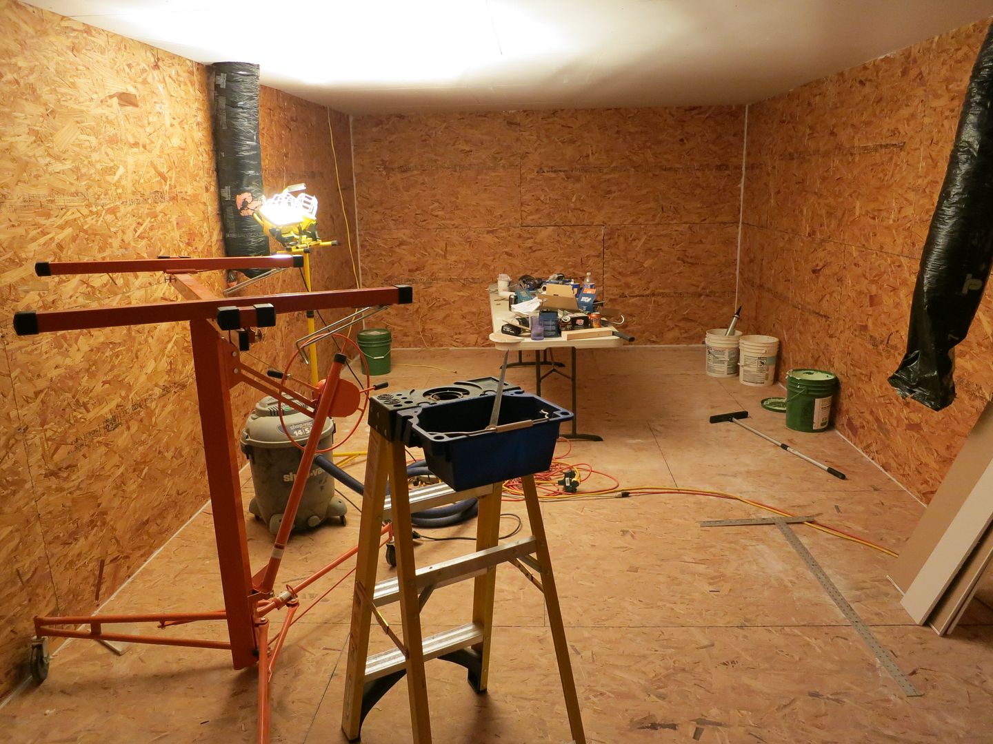

All ducts are flex,where they enter the theater space they will be inside MDF soffit, the supplies are zoned, where the returns connect to the the main returns sections of linacoustic was added this morning, duct boots will be boxes lined with linacoustic like a duct muffler.

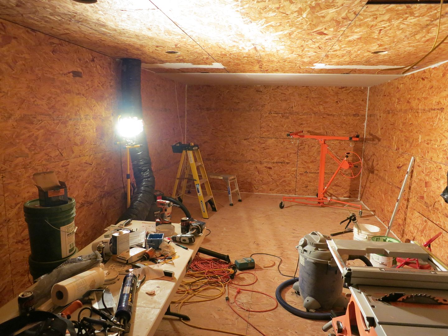

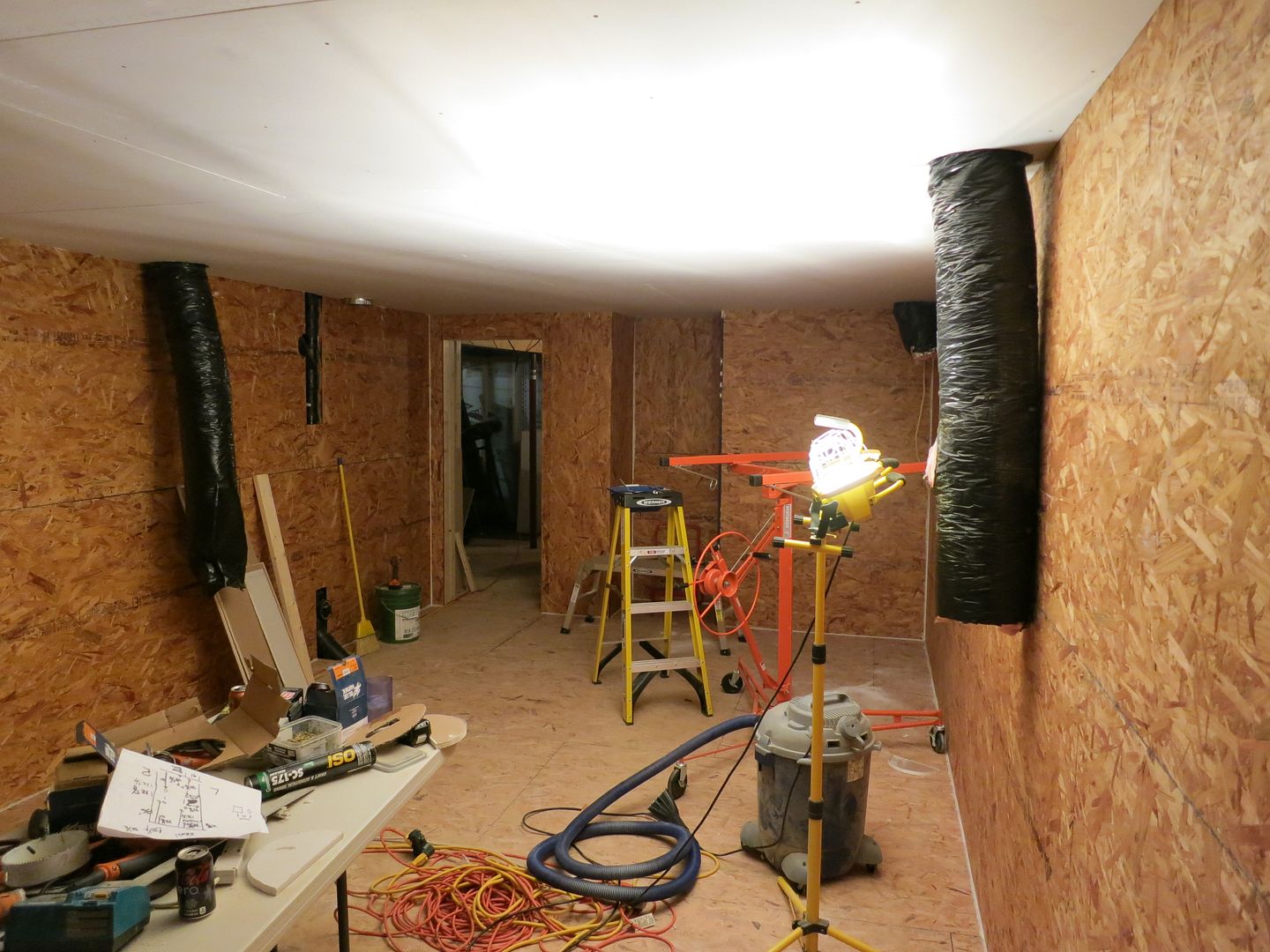

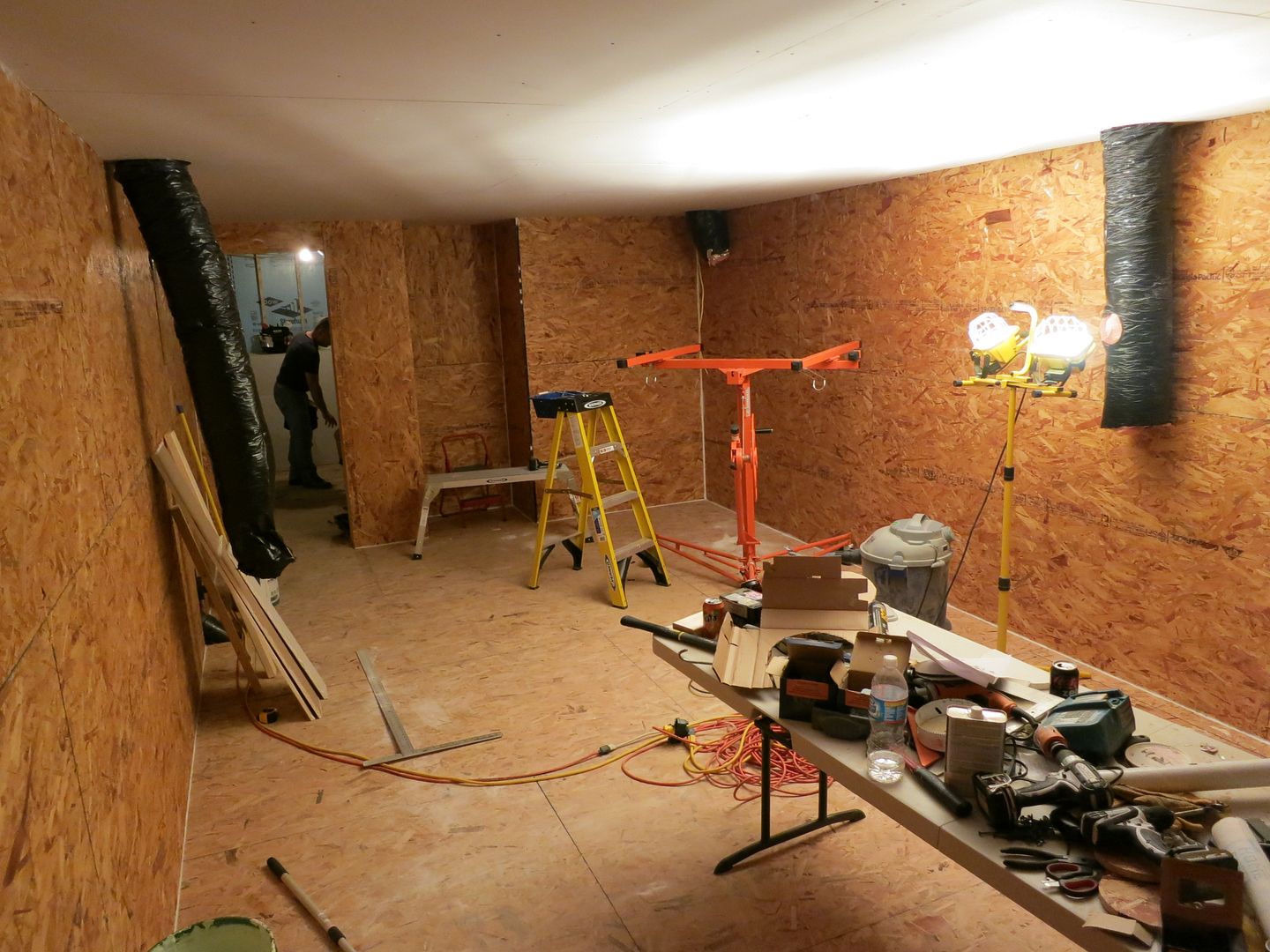

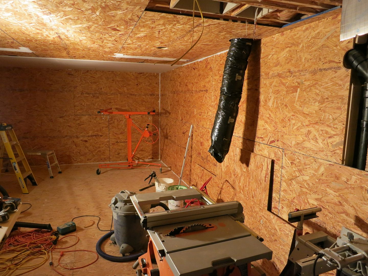

I'm not a fan on OSB for the first layer because of the extra effort required to cut all the boards. However in a retro fitted room within a room design with additional joists fitted in some with in really odd spacing it was nice to have that base to get the drywall layer to lay nice and flat with out having to worry about landing edges on joist spacing.
This morning and early afternoon was devoted to finish details on connecting the returns to the existing returns by building some linacoustic lined boxes connected to existing between joist space returns.
After that the rest of the OSB could be finnished. After dinner we did the drywall ceiling
Pics, you can see the design of a projection booth at the rear of the room, it will be covered with a matching wall panel resulting in a flush back wall.
