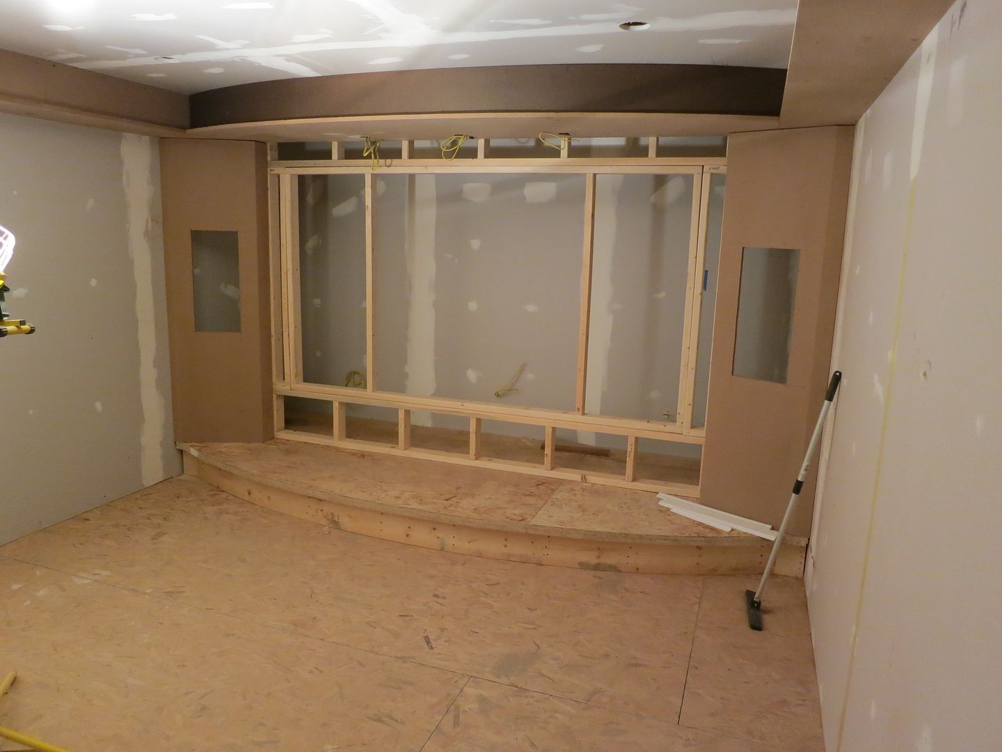

Just one picture for now, loading the tools and heading home this AM.
Bzbase just needs to add trim molding (soffit , baseboard and some pilasters) paint, fabric, carpet and hang the projector. There are a few other things but minor in the scale of things. His projector arrived yesterday, Panny 4000, and his son spent an hour studying it sitting on the floor. He is going to be reminding his dad to get er done several times a day until it is.

Big,
Looks like a 16:9 screen, huh?
What size and type of screen is going to be used?

That looks absolutely amazing! I really like how the stage turned out. Do you know the dimensions of the soffits?

Looking good BIG! I am a bit stumped, however, because it looks like it's set up for an AT screen, but yet you have the proscenium with cut-outs for speakers ?

Looking good. Can't wait to see or read about the details of the build. Screen wall turned out really nice.

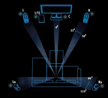

That's a good question. However, best way to answer this is to consider the infamous and often misused Dolby speaker setup image.
I'm sure someone will post it.

Also interesting that the front screen wall is traditionally built, considering the builder "developed" the minimalist approach.
Will be interesting to see what design or structural elements led to this.

I slept for 10 hours recharging my batteries and now I'm working on my caffiene. The screen wall uses a combination of my minimalist construction approach and Dennis' original design for this space. (more later) As for where are all the finger joined pine boards that I like to use?, They don't sell them in Akron and Bzbase had a stack of PRIME CANADIAN KILN DIRED LUMBER sitting in the basement for several years. Since it was still pretty staight decided to use it.

Beats me. "Infamous" has a negative connotation and the graphic looks self explanatory.
So are you saying the guide itself is bad or that it is somehow often misinterpreted/misused?
I've used this as one of many references -- just want to understand.

It is often misused. While the graphic itself is a good representation of "what should be", there are a few things missing in the depiction that are often overlooked....like walls and more than one person. That's where things get a bit more interesting.
You mean this one?
I'm assuming since this room is fairly narrow, the left and right speakers had to be pulled to the sides of the screen in order to maintain sufficient separation (22-30 degrees +/- from center). Placing them all behind the screen would have put them too close together, resulting in poor imaging. Does it also help that the L&R speakers are pulled forward a bit? It looks like if you were to draw an arc from the primary seating position, the left, center, and right speakers would all fall on that arc. If everything was lined up behind the screen, the center speaker would be a little closer to the primary seating position than the left and right speakers.

You got it! Pulling them forward is really to maintain the same distance from the listener to the front three speakers. However, we have the capability to adjust for that in most AVR's or pre pro's, and once again, the focus is on a single listener in the diagram. It depends on the capabilities of the pre pros and what the graduations are for distance settings. Some can only go by 1 foot increments and that is too large in my opinion, so you can compensate by making the speakers equidistant. Having speaker's distances set inappropriately will cause imaging to be screwed up and it can be as little as 6 inches. It just all depends. I cannot comment though on what Dennis did or did not do...it's his design his decisions, so I would defer to him on that matter.
