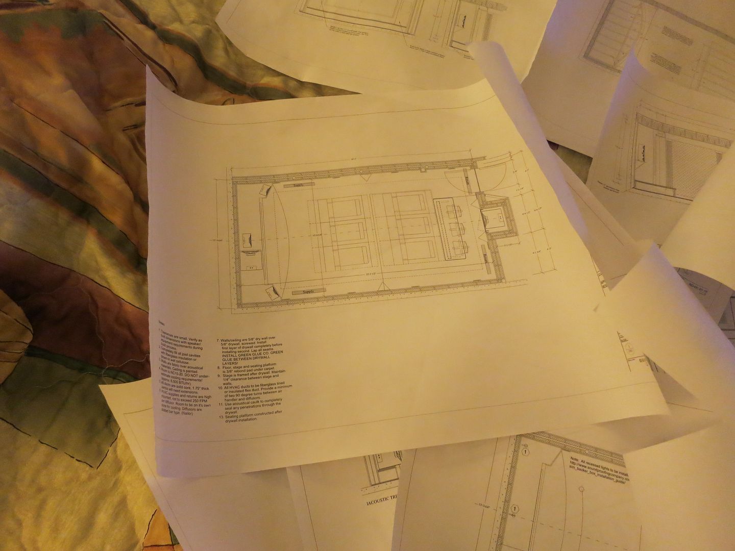

UPDATE: Yes today I pile my tools in the 4runner and head back to Ohio. Major items on the list are all the trim molding, light fixtures, Acoustic and Fabric treatments, Projection booth exhaust fan, Sit at bar construction. Graphic Eye install, DIY Screen and hanging the Projector.
PART I I'm starting a new project, I loaded most of my tools in my SUV and headed for NE Ohio. I'll be staying in a Hotel and seeing how fast we can get this one built.
The theater owner started some time ago by getting a detailed set of plans developed by Dennis in the summer of 2010. Progress was painfully slow after that with life getting in the way. So I got asked to come over and lend a hand, We are going to see how far/fast we can take this project over the next 9 days.
So we have a set a plans for a 2 rows, plus bar in a width constrained space.
The room has been framed using a true Room within a Room approach and a second set of ceiling joists have been strung hanging lower than the originals.
I arrived at 5 tonight and we assembled some backer boxes and finished running a couple of ducts, tomorrow we will finish and install the boxes, pull in some wiring, run some more ducts and insulate. Maybe get started with the first layer which is going to be OSB for rigidity of the Room within a Room structure.

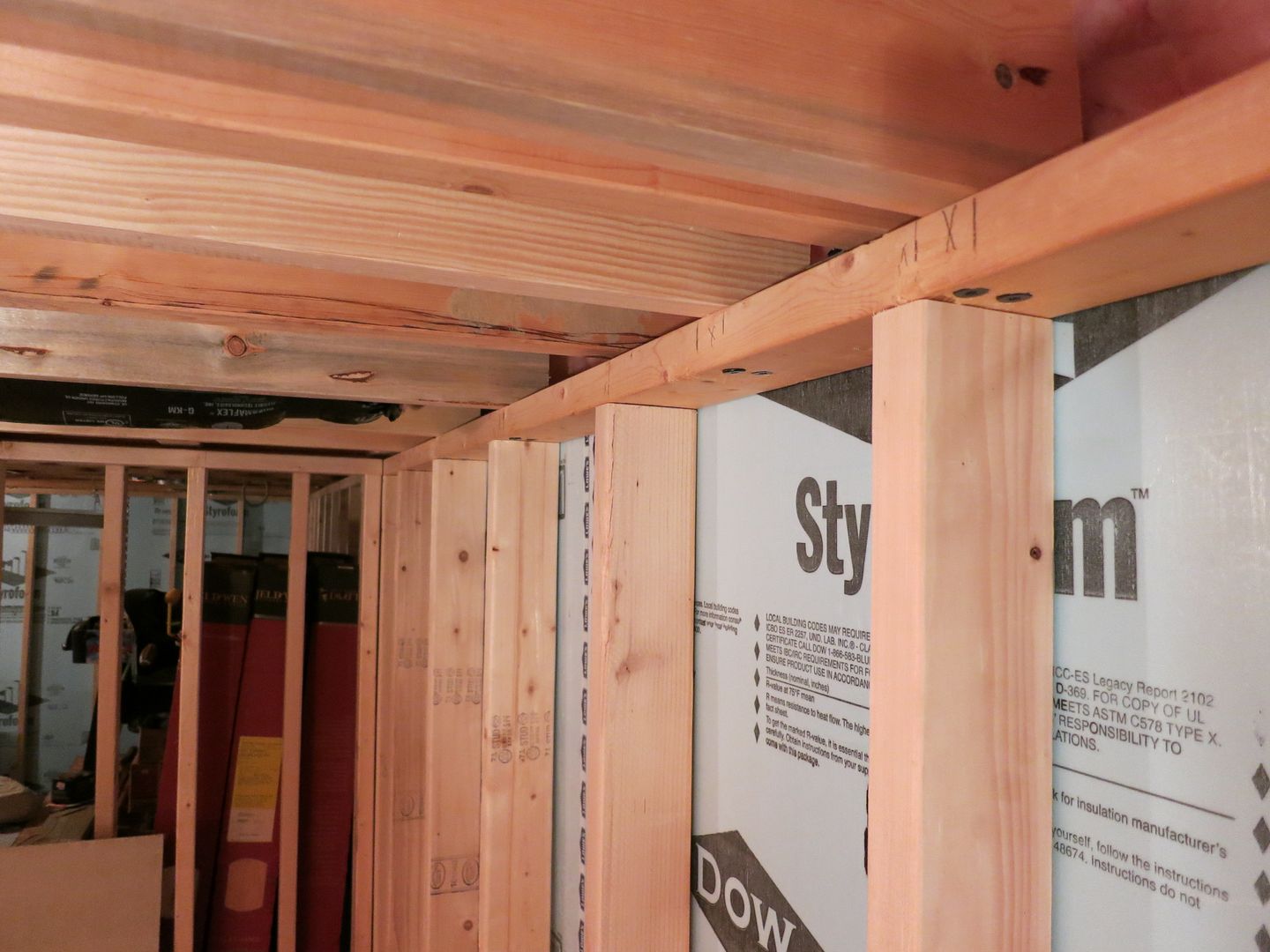

The wall framing is attached at the top with only isolation clips. The second set of joists rest on the walls and do not touch the sub floor above so there is no mechanical connection between the theater framing and the rest of the house.

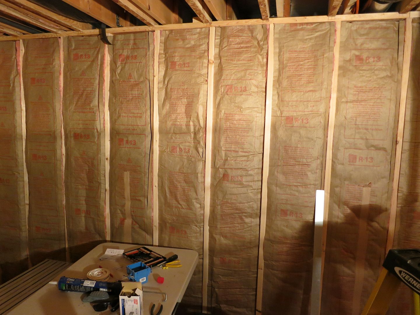

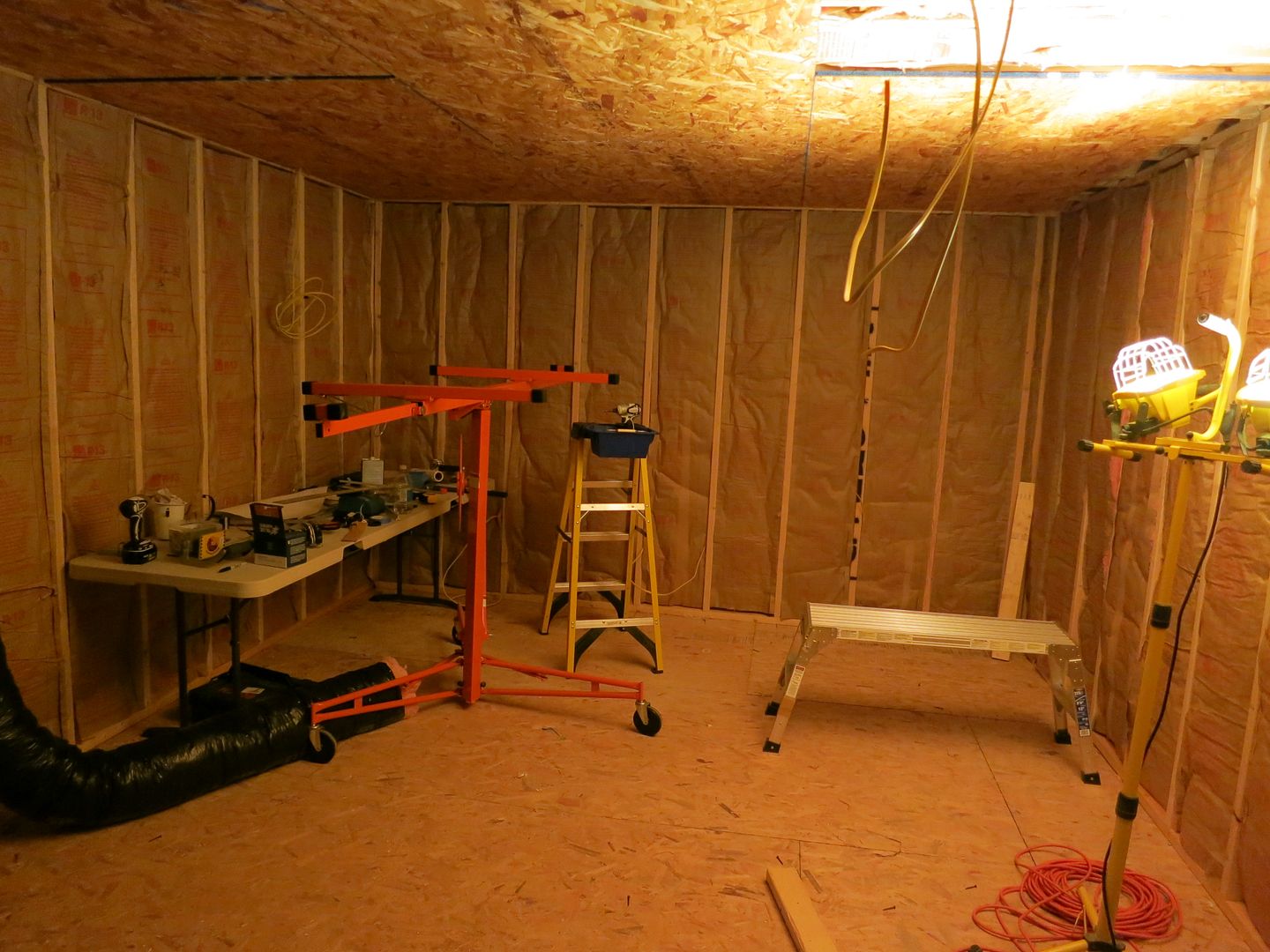

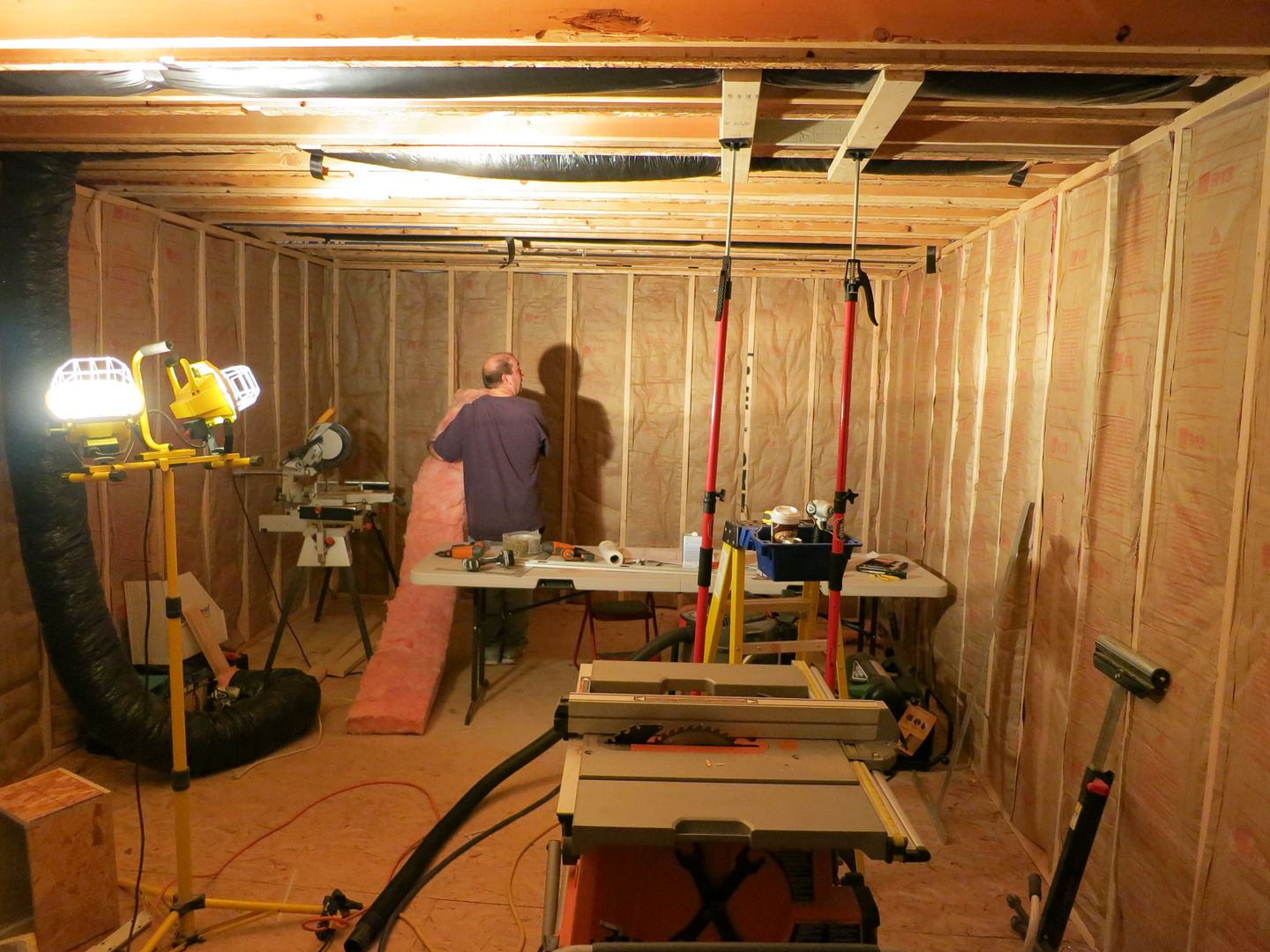

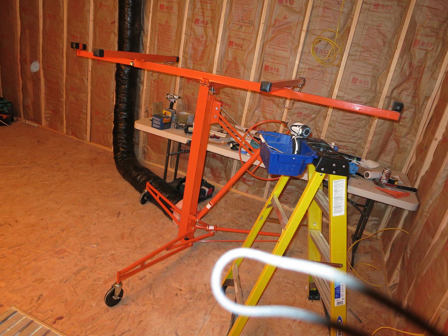

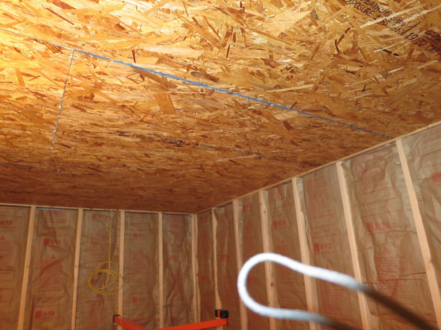

It has been a really busy two days as the list of items that needed attention before drywall grew exponentially.
Things accomplished include
Removing existing ceiling wiring
Building and installing 10 backer boxes, then pulling in 5 circuits of lighting wiring.
Adding 1/2 inch furring to the new ceiling joists to make sure the ceiling didn't contact the old joists
Insulating the walls and ceiling
Installing a conduit to the Projector location
Running acoustical duct work for supplies and returns
Finally after dinner tonight we hung a few sheets of 5/8 OSB on the ceiling. Instead of drywall for the first layer we will be using the OSB to give stability to the Room within a Room.
Some Pictures, I'll come back later and add comments

Looks like Big has gotten younger, shrank, and lost some weight. Nice to see some "help" pitching in on this build.
I understand the reasoning behind using the OSB for rigidity, what if anything does it do acoustically (pros and cons).
I'll be doing the exact same in our room one day. Its not good acoustically as its not nearly as flexible as drywall on channel.
I didn't realise this until I saw Greg/Dingaling's room - the flexibility is impressive - I should imagine this has significant benefits for bass
