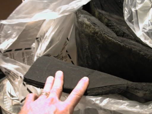

for a small project it doesn't make sense as the Linacoustic comes in a 4x100 ft roll.
I used Linacoustic RC

solid foam insulation is worthless as an acoustical treatment, look for compressed fiberglass products. Owens Corning 703 is one such product that comes in 2x4 sheets.
It you are doing a lot of wall surfaces then the finding the Linacoustic from a commercial insulation dealer makes sense. You will not find products for acoustic treatments at Home Depot or other big boxes.
