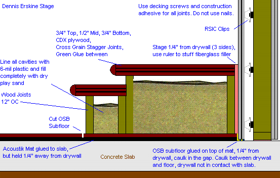

A cross section:
Green glue replaced roofing felt in the state of the art design.
dc_pilgrim is offline

Well just to close the loop on this thread. I finished filling the stage with sand. Took a long time since I had to wait for two orders of sand to dry. But no issue really since I had many other task to do in the mean time in the theatre.
The sand was filled in a 3 stages. After each stage it was compacted with square OSB3 piece and a heavy hammer. Then I did the last filling all the way to the top. I screeded it with a long flat piece of wood to ensure it was all leveled. Then I went ahead and did the final compactation of this layer. Well the sand compacted about 1" to 2" from the top. So for sure it does settle. Ted was right! Now I'm not sure if it helps or not to have it compacted but its done!
Cheers.

Excellent! How were you able to dry it?

I used Teds suggestions.
1. I took it out from the bags and put it all on my concrete floor (use plastic sheet if your floor is moisture sensitive).
2. I spread it on a large surface to make it as thin as possible.
3. I connected a fan directed towards the sand.
4. I connected a small dehumidifier that ran in the closed room
5. Twice or three times a day I would turn the sand pile a bit
Quite easy and not to bad if you are not in a hurry With all the above you would need 2-4 days to get it completely dry.
But my suggestion is to have enough sand so you don't have to redo this operation twice
Cheers

I don't know why sand is used. I put some sand under my stage (approx. 3-4 sq. ft.) and then I decided on insulation. I packed alot of fiberglass insulation inside my stage and I don't have any problems. I have 2 subs on it and I can't tell the difference between that and where the sand is.
