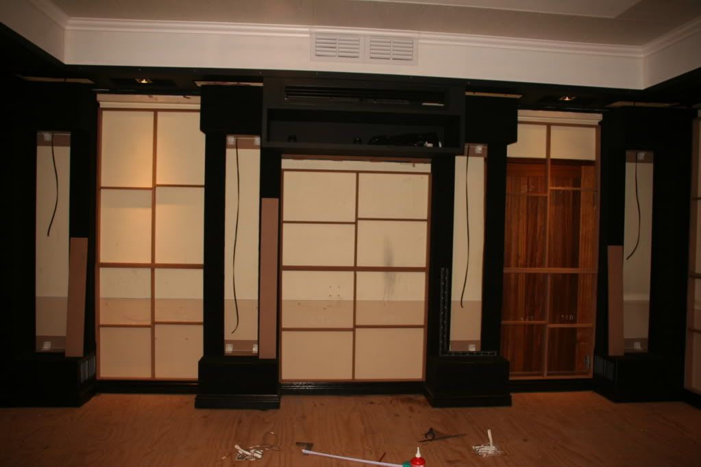

Here's quick vid of the new masking contraption in action. This this is also as loud, maybe a bit louder, than the other one. I think I'll pad it with some sound panels to quiet it up a bit. The new "actuator" is much slower than the previous setup, but is MUCH more accurate. We'll see how it goes
Click on pic for video
I started on the fabric panels last night. I will continue as soon as I can and post pics when I've progressed a bit.

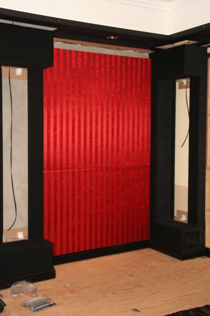

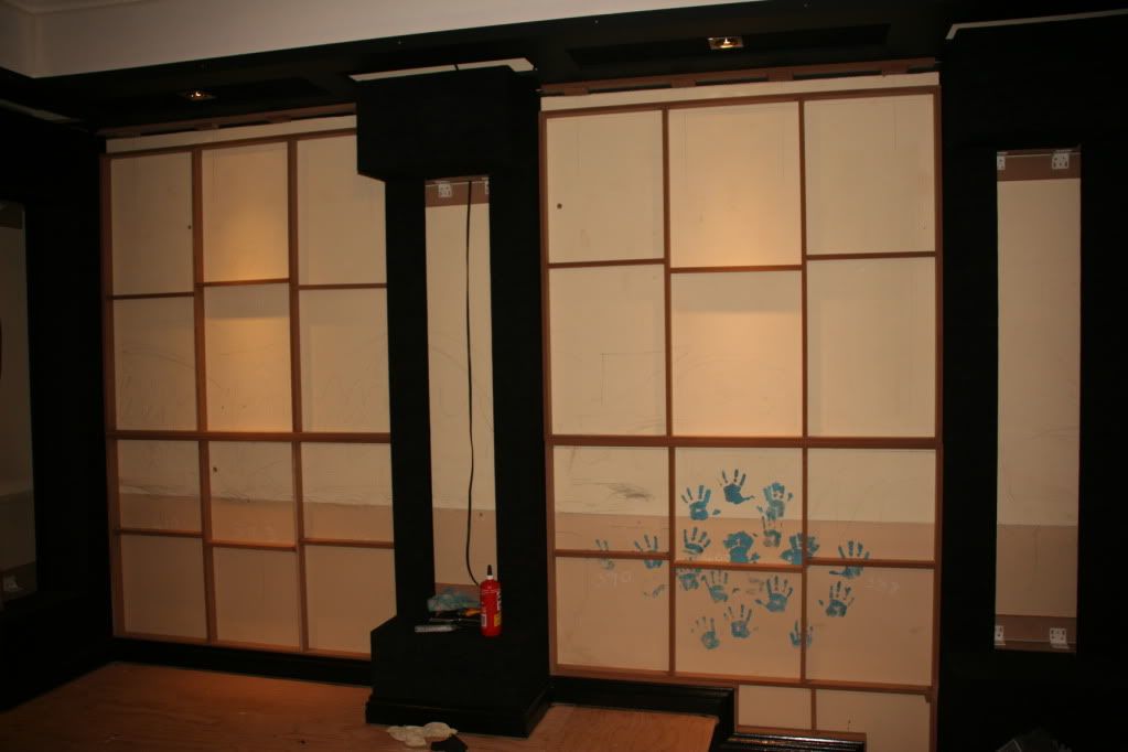

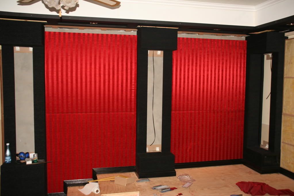

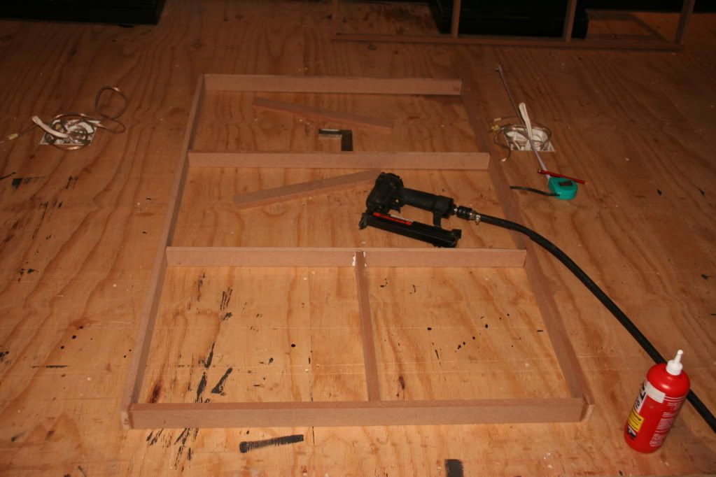

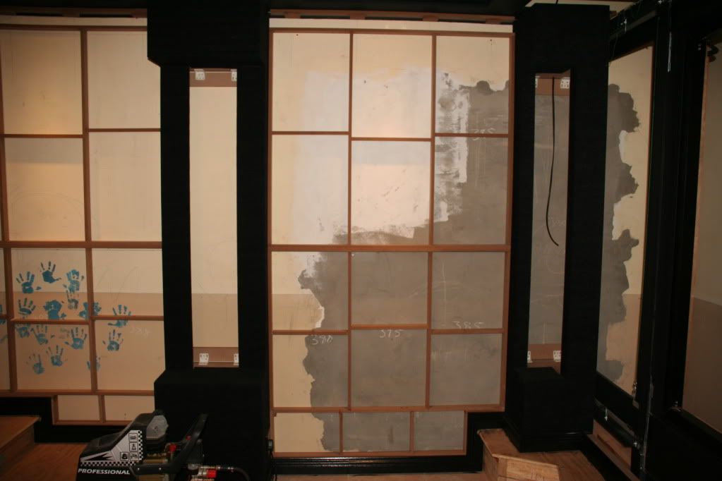

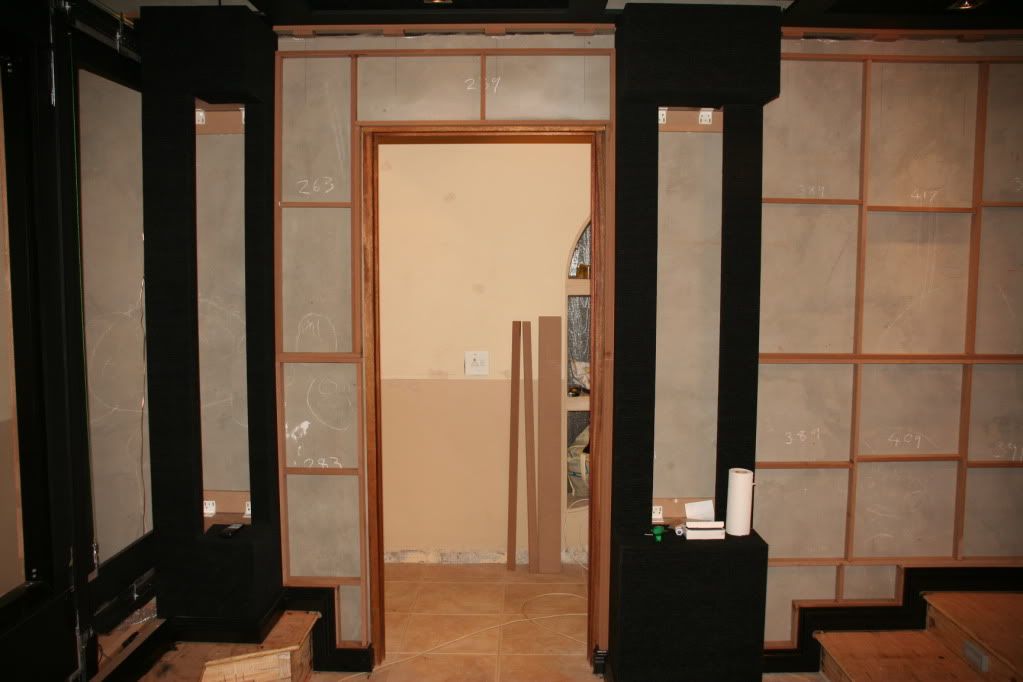

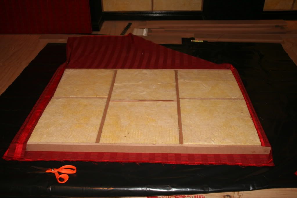

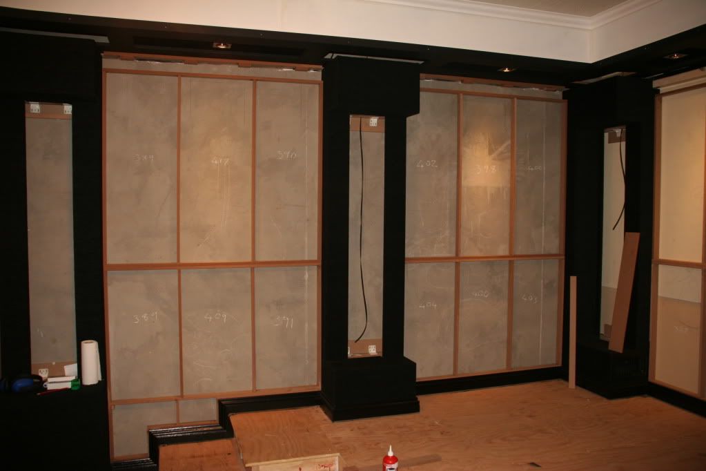

Some more progress! I've been busy with the fabric panels over the easter weekend. I made mine a bit different than most others here. I used MDF cut to strips of 45mm and 40mm to construct the frames. The borders of the frames are made with the 45mm and the inside cross braces are 40mm to ensure that they'll not push against the fabric and show. The inside "blocks" will be filled with the fibre glass panels. Every panel was made-to-fit, so every cut was measured individually to make sure it was just right with a few mm's on each side for the thickness of the fabric.
Enough blabbering, here's the pics:
I first made all the panels to size and afterwards measured the spaces between the vertical braces , hence the writing on the walls, for the horisontal braces. It took 45 pieces to do the job.
Here's the horisontals cut and ready for glueing and nailing:
Here is one of the panels in process of being made:
And finally, all of them are "cross-braced" and put in place - ready for the streching of the fabric and filling with sound-lite panels.
Bobbejaan is offline

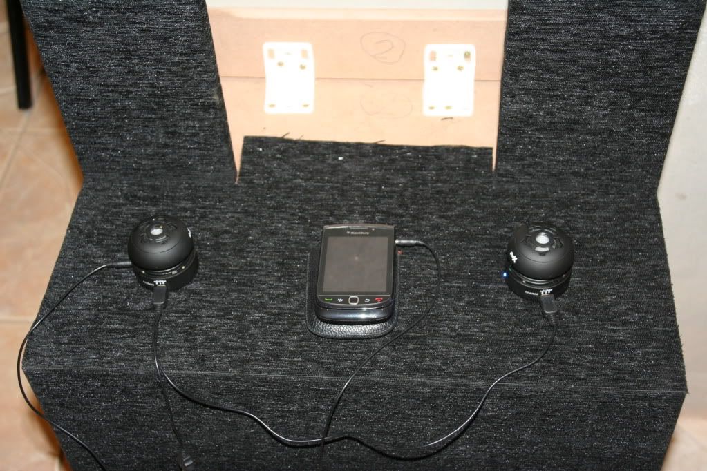

This pic shows my Super Hi-Fidelity sound system used for music in the HT while I'm busy working away.
I can't wait to be fully surrounded by the 11.1 speakers for real!!

Wow! Looks great and I'm amazed at your ingenuity surrounding the masking system.
I noticed you enclosed your mini-split in the soffit. I'm guessing the black vent (difuser?) is output and the white vents are the returns? Do you notice a lack of airflow now that it's enclosed? How is the noise level?

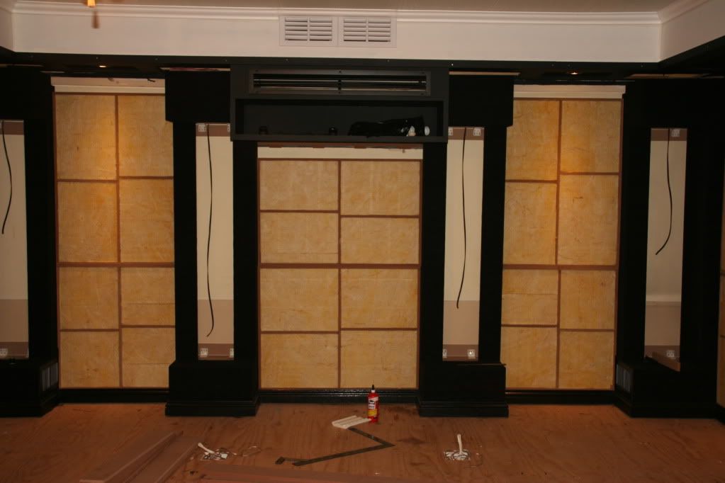

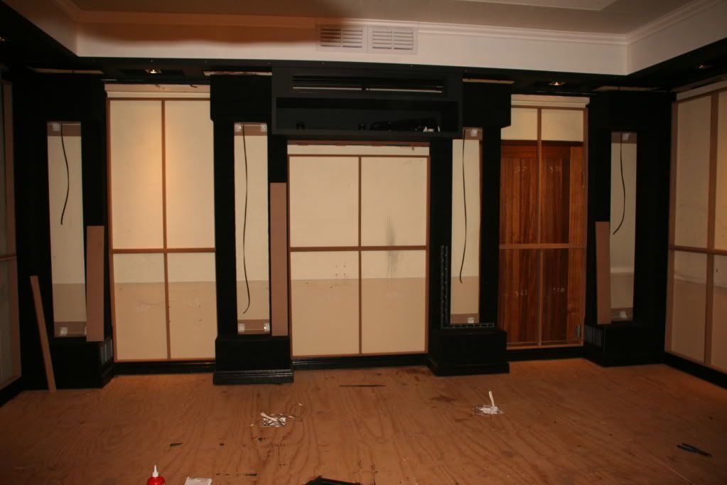

Visit the Lipszyc Home Theater! 1.0
2.0 done and finally posted! - Theater 2.0
And now...The Queen City Theater (3.0)
blipszyc is offline
post #203 of 482 Old 04-13-2012, 12:49 AM - Thread Starter
Bobbejaan's Avatar
Location: Sunny South Africa
Posts: 309
Hi blipszyc, yes you are correct. The airflow is good and the whole room is cooled nicely but at a cost - NOISE. The thing is a bit to loud for my taste. Most peolple that have been in there says it doesn't bother them but for me it will be distracting while watching a movie, aspecially a quiet scene. I'm going to put some of the ridgid fibreglass panels inside the soffit where the aircon is and see if it will help. The aircon part of the soffit is not completely close of from the rest of the soffits, so some of return air is sucked out from the soffits as well. I've got a secondary aircon unit in the adjoining room connected with a duct pipe to the HT for fresh air (previously in thread). The idea is to cool down the room with the split unit, for a few minutes before the movie, and then just use the second aircon to keep it cool and fresh - works so far

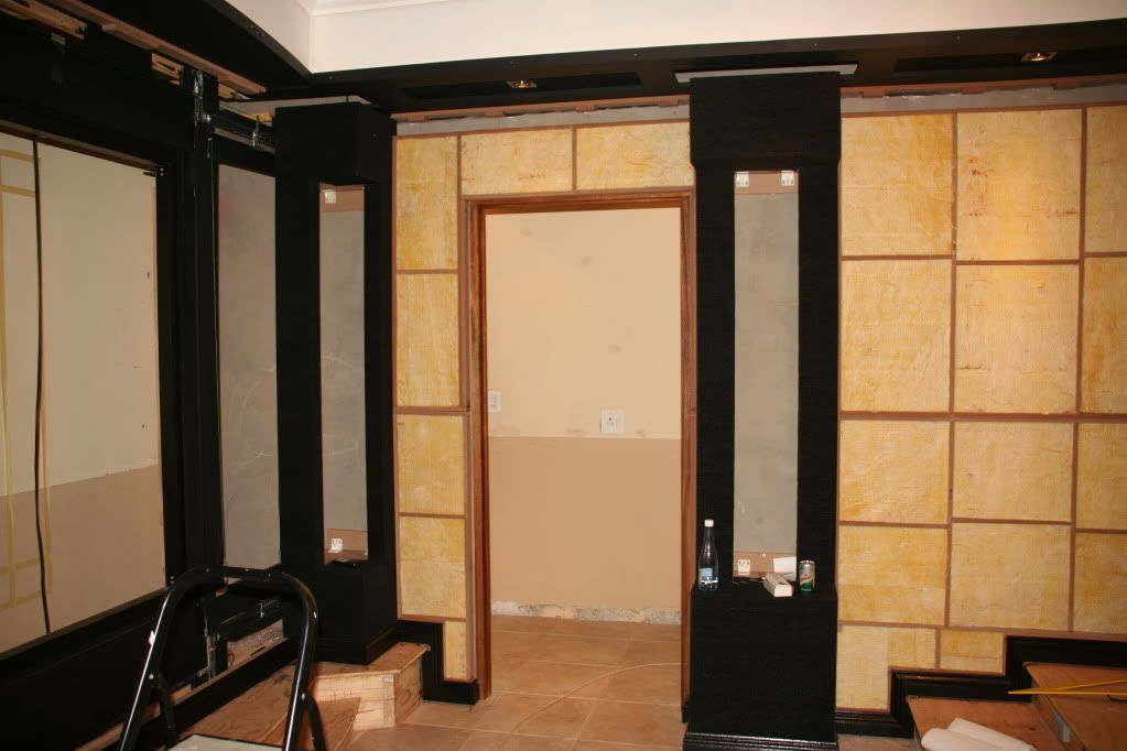

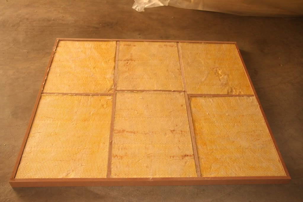

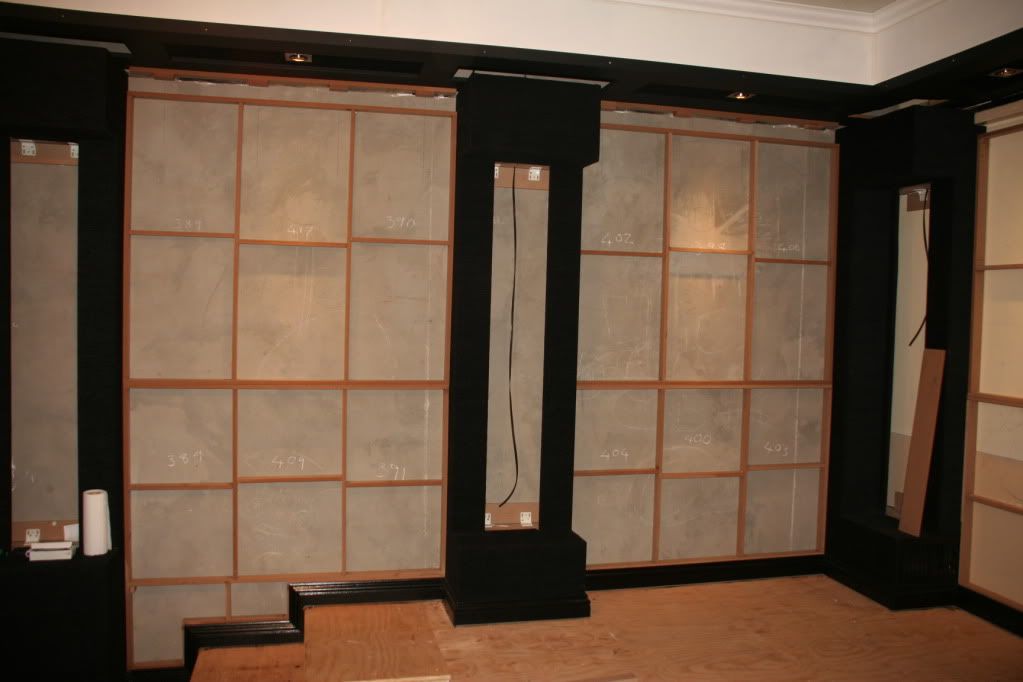

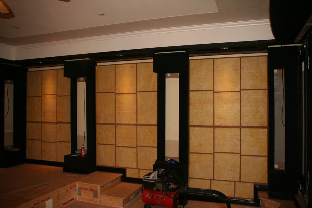

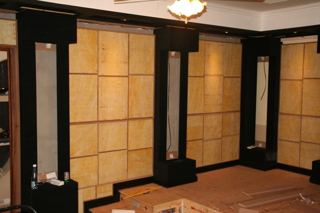

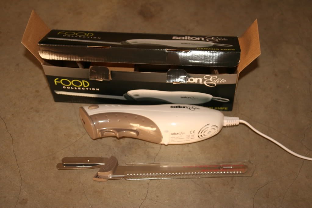

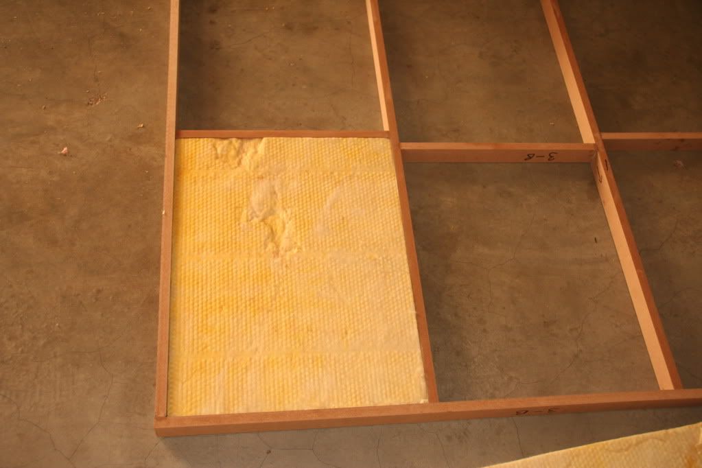

A new phase of the my project started today. I filled the fabric frames with ridgid fibreglass batts. It took me nearly the whole day. You can't believe how different the room sounds now. The screenwall must still be covered as well as the bass traps and a few other places must also get the fibreglass treatment, but it already sounds much better accoustically. The itching is one downside to the whole process.

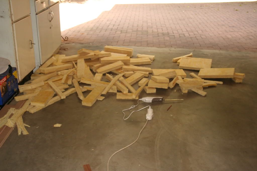

I asked my wife this question, trying to sound as inconspicuous as possible, but she saw me comming!: "Do we have an electric carving knife by any chance?"
"Yes we do, why are you asking........NO sorry!! you're NOT using it to cut anything in your movie room!"
I thought of sneaking it out of the kitchen and just return it afterwards as if nothing had happend, but with my luck the thing will burn out and then there'll be big sh*t!
So, I got my own:

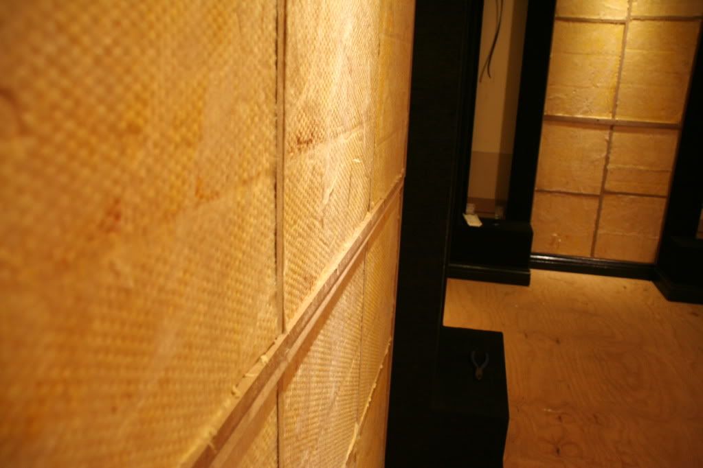

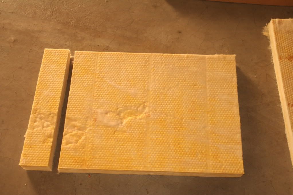

The process was really quite easy and straight forward. I started with laying the frame over the panel and marking, with a pencil, the size to be cut.
The knife really cuts through the panel "like a hot knife through butter" - or an electric carving knife through a ridgid fibreglass panel
The cutouts fit nice and snug into the frame so there is no need to glue them in place.
And here is the first (one of 18) panel filled with the yellow batts.
Fast forward about four hours of cutting, fitting, itching, sweating and breathing through a mask and all the panels are done. Here's a pic of the carnage and the weapon of choice:
I saved the off-cuts for later when the will be used to fill some nooks and crannies in the HT somewhere.
Here they are in place: (once again, I'm VERY happy )
This pic shows how the fibre batts and the braces are 5mm "deeper" than the frame of the whole panel so that the fabric don't come into contact with the fibreglass or cross-braces.
Here is a little TEASER of what's to come!

Making huge progress! Are you planning to add any scrim to the front surface of the fiberglass in some sections? If not I fear that room will sound too dead. You would add it above ear level on the side walls from the main seating position and the entire back wall. From personal experience if will help make the surround sound, sound surrounding.
post #206 of 482 Old 04-13-2012, 05:17 AM - Thread Starter
Bobbejaan's Avatar
Posts: 309
Hello BIG,
By scrim do you mean the craft paper? I was thinking of that but thought I'll have a listen first. The panels are easily removed and the fibreglass batts can be removed from behind, scrim inserted and put back without much fuss.
Do you think the top row in the top panels will be sufficient enough with the scrim and the whole back wall?
Thanx,
Will

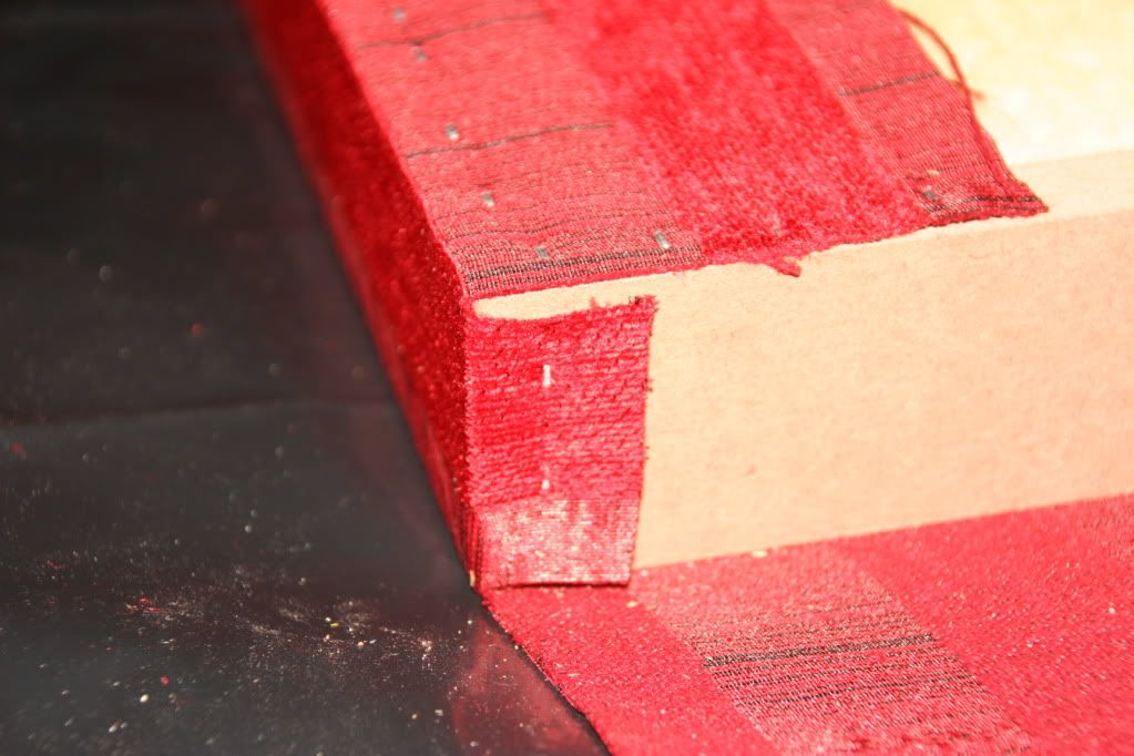

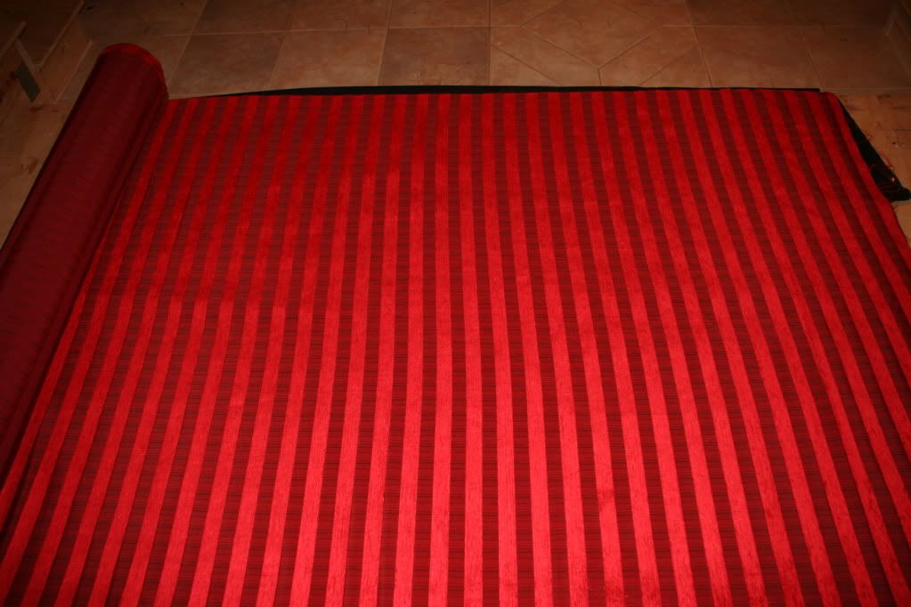

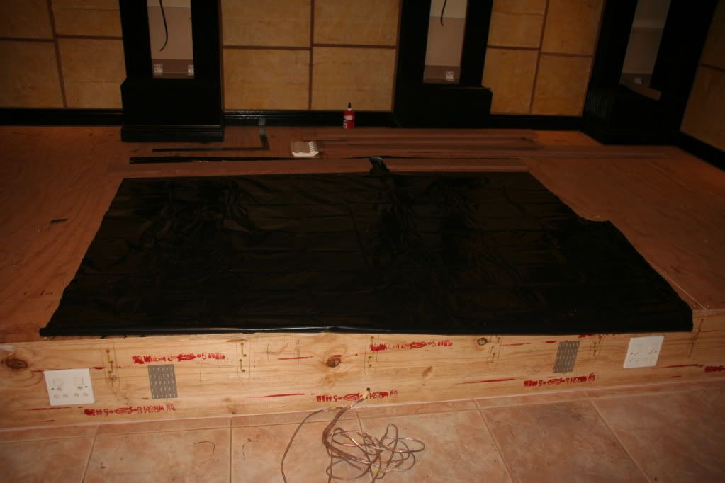

I have waited for the next part for a very long time. It feels if the theater is now slowly comming together. The first bit of colour! Like most folks on the forums say, the colour of the pictures is not exactly how the material look in life. The red is a bit deeper, more like a royal red. I was torn between my favourite colour, blue, and red. My wife said that the red will look more dramatic and "theatery". I'm very glad I went with the red in the end. The material is a very strong upholstery type of material without much stretch so it can be pulled very thightly over the frames.
Here's the first pic of drops sheet I laid down on the riser for a smooth and clean surface to work on.
Material rolled out:
The material looks different from the different sides (top to bottom and not back and front that looks completely different). From the one side it looks like the nice, deep red, but form the other side it looks more like a brighter, tomato red - not what a have in mind

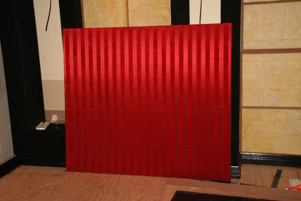

So I have to make sure with every panel that the "right" side of the material will be on the topside of each panel.
Here's the first panel (actually it is the second one, cause I once again got carried away with the production and forgot to take pics but lets assume it's nr.1) laid onto the fabric, ready to be stapled:

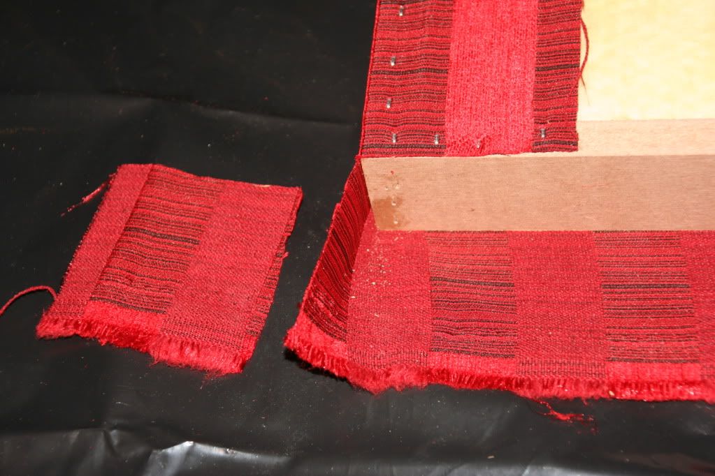

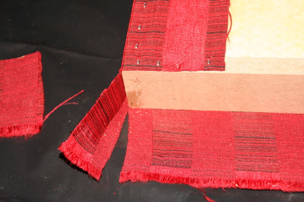

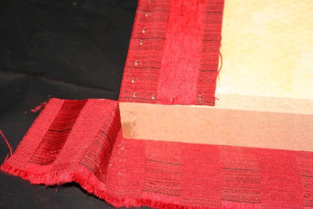

The next few pics will detail the corners. The corners must be relatively flat and not to thick on the back otherwise the panels won't fit into the gap behind the skirtings.
And here is a panel finished!
This one shows how the panels will look in place. The area where the two panels meet will be covered with a type of chair rail that I'm gonna make with MDF and halfround trim and cover it with fabric. The most diffucult part of the whole process is to get the two panels' stipes to aglign PERFECTLY. It will just look sloppy and bad if the stripes don't match especially where the panels and colums meet.
This is about how far I am today. I'll be working again this afternoon (Sat.) between 13h00 and 17h00 and we'll see how far I'll get. BTW, the camera-flash is SO unforgiving and not your friend. It shows every LITTLE flaw and mistake you make. The little wrinkle on the right top panel doesn't look like that in real life and already looks nearly completely flat this morning. I guess it takes a few days for the fabric to "settle" on the frames.
