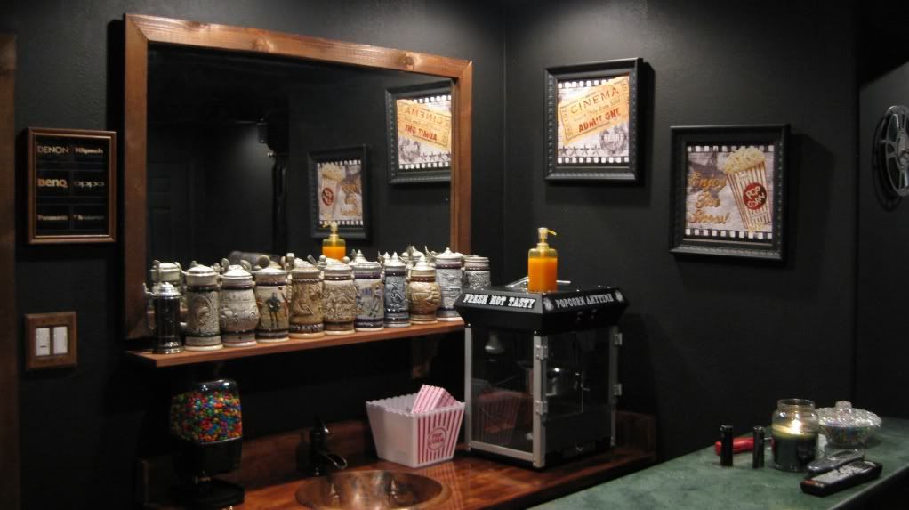

Back in the shop, I prepard the sink and counter made from an old dining table I made 20 years ago from a slab of maple. I stained the door at the same time.

I searched for a photo but couldn't find one (at least one that didn't include other items). At any rate, I built the table in Guam in about 1992 from maple slabs I ran through a planer. Then I just glued them together. I put on the Envirotex coating but a buddy that helped me didn't mix it good enough, and one spot never did completely harden. We used the table off and on for the next 10 years or so, then it was in storage. I spent roughly a year off and on removing all the Envirotex (that's waht I call it...the thick clear resin). It was too nice of maple to just let go.
When I moved in this house and the theater idea came about, the table was getting used in some form or fashion.
To your question, basically all I did was slice one long edge and one short edge to form the backsplash. The are just glued and screwed on there. The table actually warped over the years and I had heavy weights on it in the shop to flatten it out for about 3 or 4 months. I stained it with Early American stain from Home depot. The secret I think was putting 4 or 5 coats of varnish on it and sanding in between each. Gave it that real pop.
The cabinets are just the plain prebuilt unfinished oak from Home Depot. The door of course is pine. And the trim around the mirror and baseboards (and soffit) is rough cedar, all stained the same color. I laugh and point to all the different woods and slightly different finishes they have....maple, pine, oak, cedar.
Cutting the hole for the sink for me was the point of no return. The sink is just siliconed on there with the plumbing kinda holding it down tight.
I do think it came out nice and I'm glad you liked it.

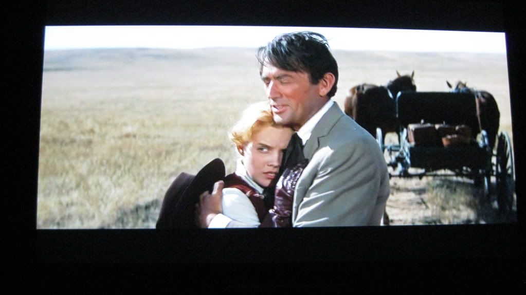

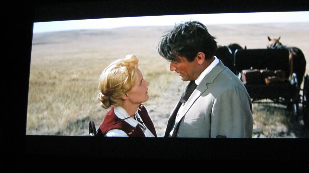

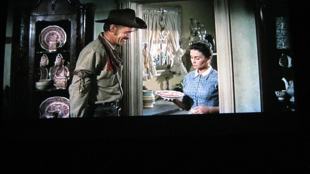

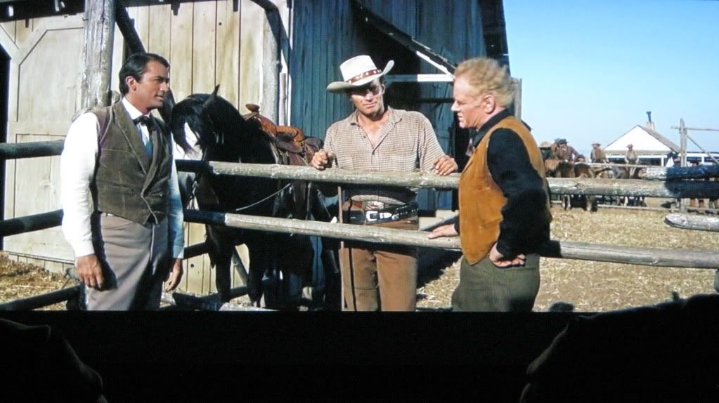

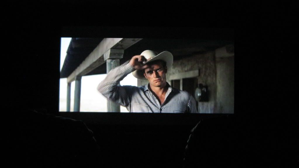

Some screenshots I just took. Not reference quality, but the calibration sure paid off. This is an MKV from the HTPC.
Next project is to wrap the 6 2" OC703 panels and find a place to put them.

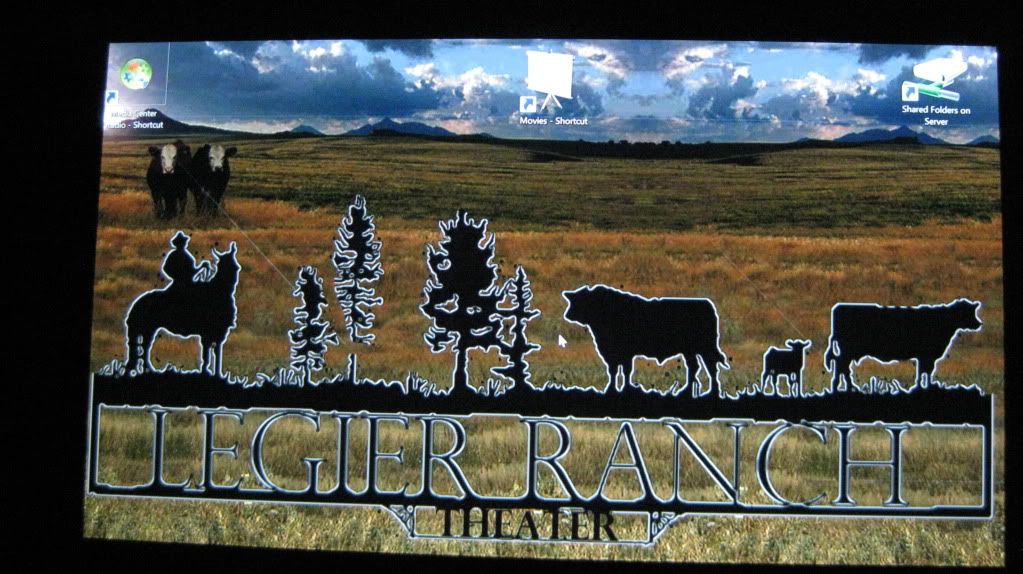

Just a pic of the HTPC desktop. Actually it was the drawing for the entrance sign at the gate. It is 12' wide x 4' tall hanging 18' in the air. I superimposed it over a photo and added some 35mm effects in Photoshop.

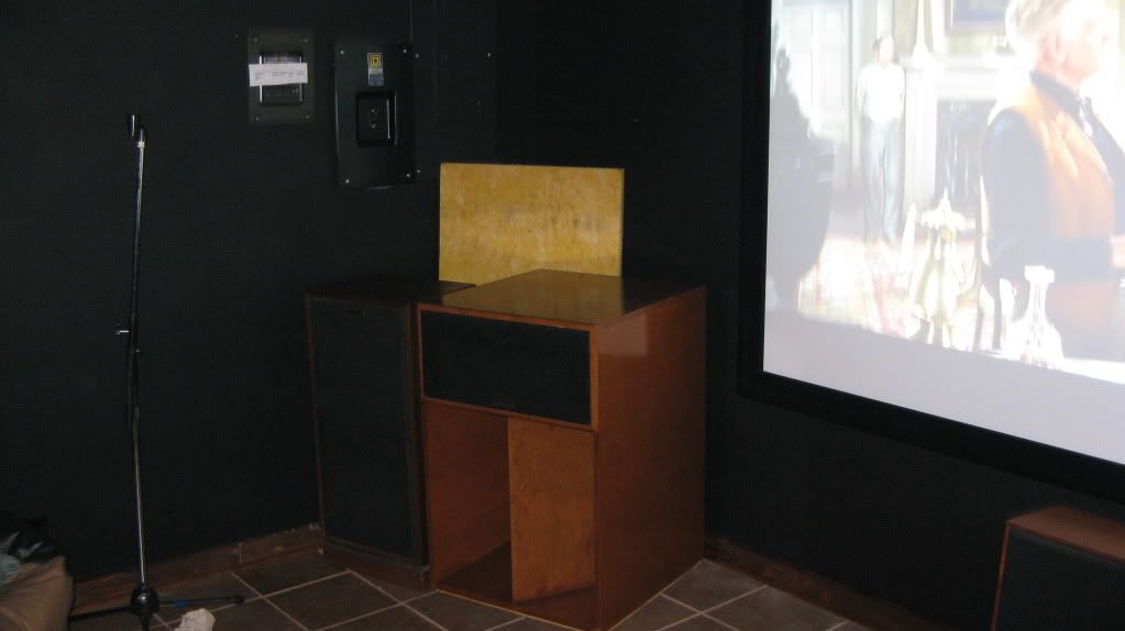

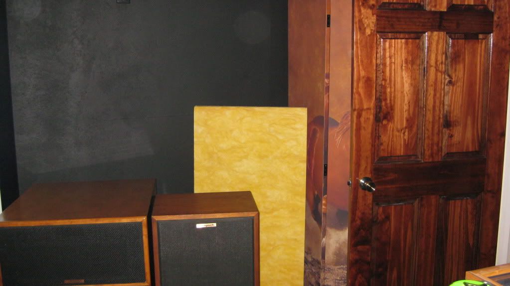

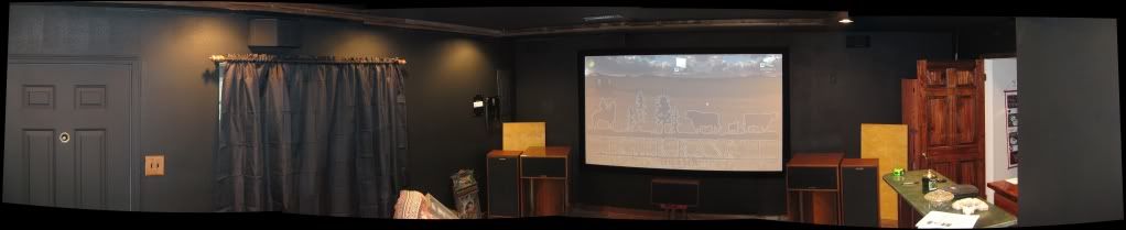

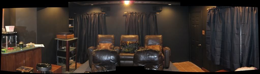

Given the two panaramas, was hoping someone could suggest locations for six pieces of 2' x 4' x 2" OC703. Should I go the Treatment thread for that?
Waiting for that info before I hang some stuff:
legierk is offline

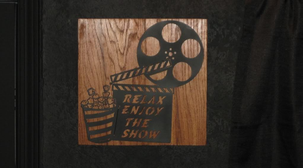

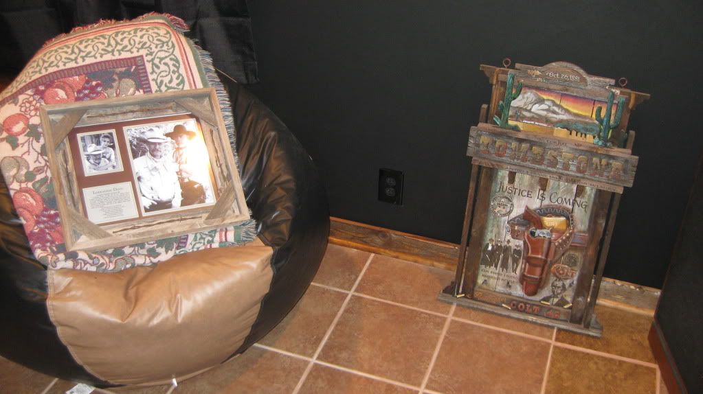

Metal sign. Had to mount this on some stained oak:
Hung the Tombstone plaque (this thing actually looks way better than the photos would let on):

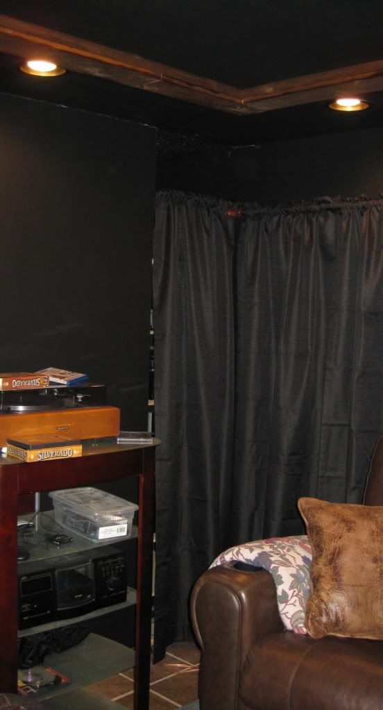

Put curtain over equipment closet. Doesn't block all fan noise, but helps. It does block all equipment lights though. Easily removable also.

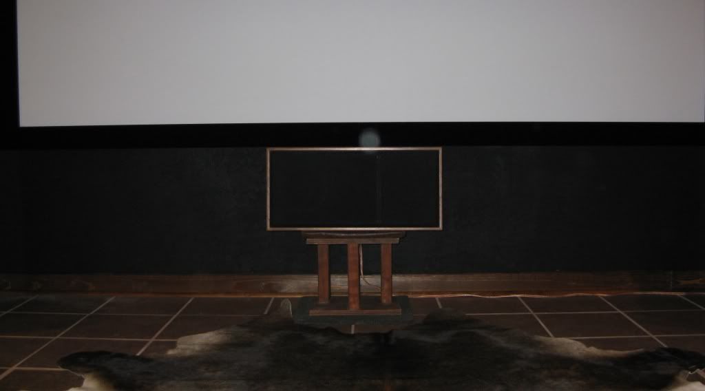

Looking forward to next weeks project. Last week I was running some test tones from the Disney WOW BD, and got some buzzing from the woofers in the Klipsch KT-LCR center. Also, some dialog in The Thin Red Line (awesome PQ from Criterion) sounded chesty thick, making some passages difficult to understand. So, I ordered a rebuilt crossover from the fabulous Bob Crites . Bob also made the crossovers in my Forte IIs and La Scalas. And I also ordered two of these to replace the already mixed woofers in the center. Hopefully these changes will improve the midrange clarity of the dialog. Of course I will have to run Audyssey again after the surgery.
Will probably pull the center out about a half foot also prior to running Audyssey. May try to get one of these for it so it will match the Fortes and La Scalas. More on that next week.

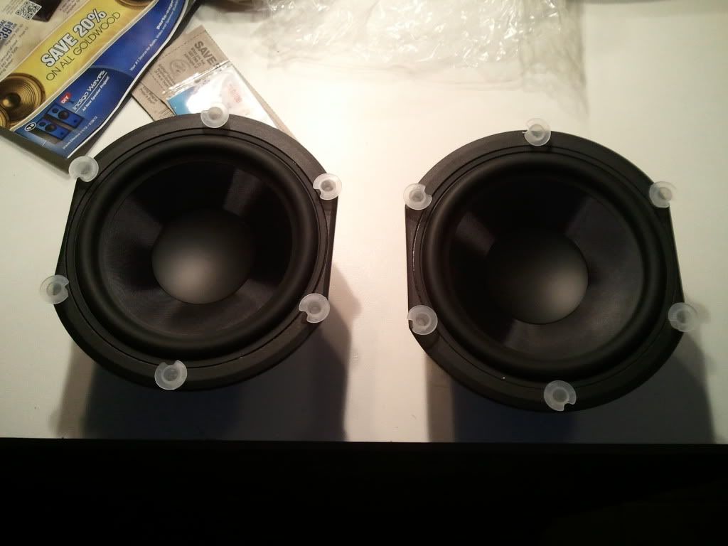

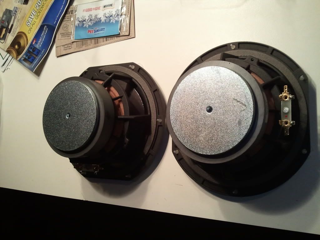

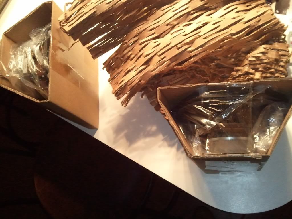

Alright....just got my replacement 6 1/2" drivers for the center channel....Klipsch KT-LCR. Was surprised they weren't even in their own box. Anyhow, no harm, no foul. Crossover due tomorrow so I'll probably begin the transplant then. I chose these Peerless drivers for their flat response in the upper bass/lower midrange. Most of the SPL/FQ graphs I looked at on Parts Express had this hump from about 200hz to 500hz. This corresponds closely with the chestiness I was hearing on male dialog.
FWIW, I did try to run some REW and TrueRTA tests on the center, so I could get a before and after. I was never happy with the results, mainly because it's been so long since I messed with either program that I've lost my touch. Of course, the reason I don't have to use those anymore is because of Audyssey...no more tweaking EQs and running tests after every change!

Got the crossover today, so time for a transplant.
Mismatched woofers coming out. A few years ago, one quite, so I replaced it with I-don't-know-what. Nothing on it either.
What flick is this???
